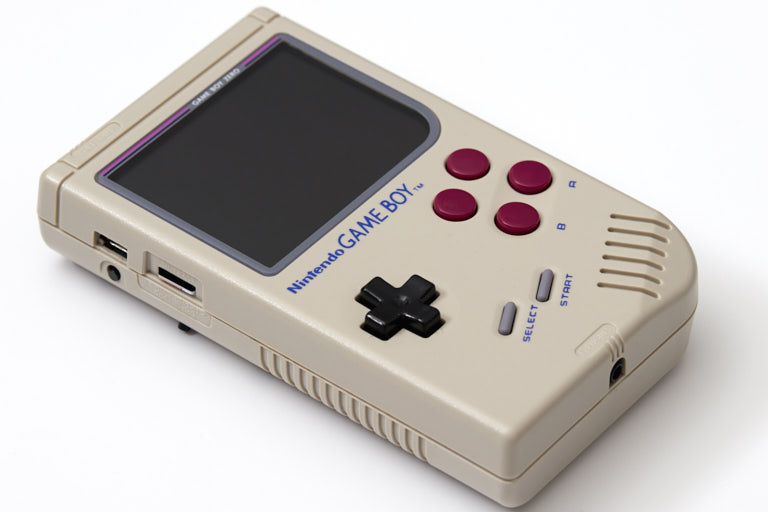

Hi,

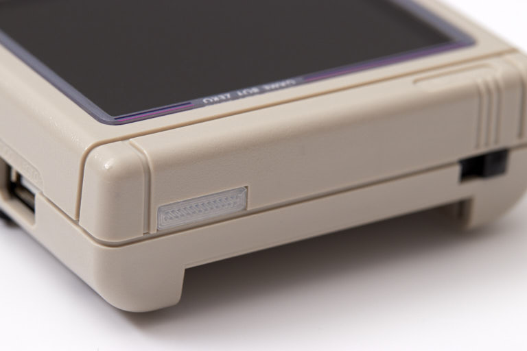

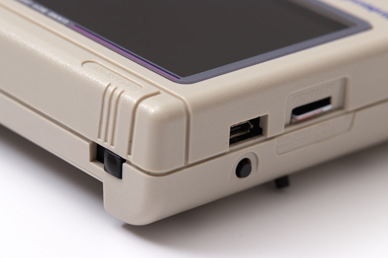

I just finalised my first Game Boy Zero and it is a lot of fun to play around with all the old games. I used Kite's SuperAllInOne board and HoolyHoo's 3d printed bracket which make the whole build really straight forward and clean. The only thing I screwed up are the LED holes. They are not aligned and ugly and I decided to insert a translucent 3d print 'window' here. This has the little benefit that you can also see the green Raspberry PI LED.

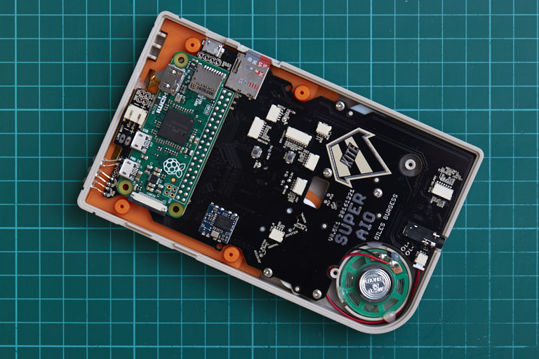

Very nice.. Can you show us the internals? :)

I'm sorry but I have no pictures from the internals. I have just started with the second build and I will make more pictures this time.

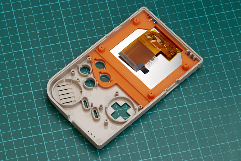

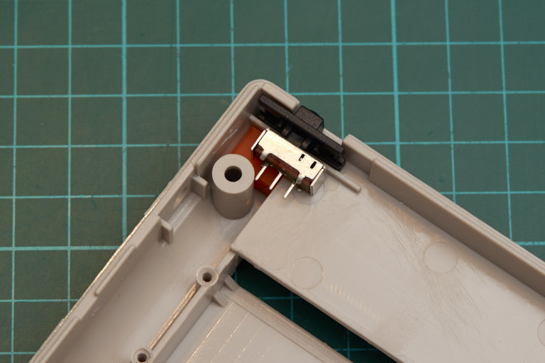

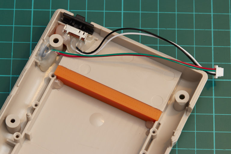

As promised I started the second build and I will make here a little photo documentation of some steps.
First I prepared the front, made the bracket and drilled the holes (this time I did not fail with LED holes)

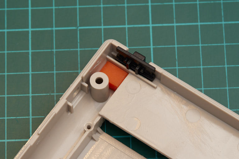

I found some low profile switches and made a 3d printed base for the switch.
.. more coming soon

Here the 3d files for the switch base:
SwitchBase.zip
(2.59 KiB) Downloaded 610 times

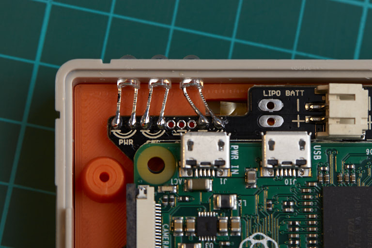

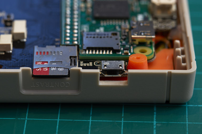

Post by mwx » Sun Apr 09, 2017 7:27 am

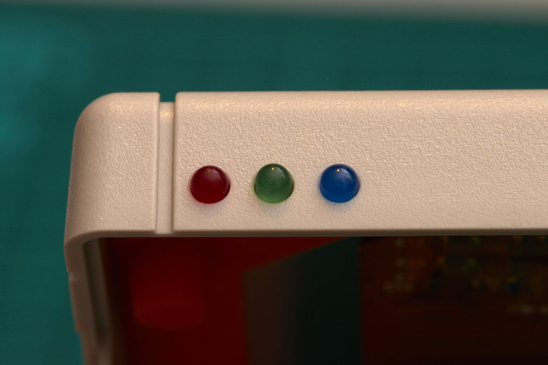

Some new pictures! The front half is now finished and anything is tested together with the backboard. Everything is working and the rest of the build will be a pleasure. On the pictures you can see how I have mounted the LED's and you can see how perfect Kite's SAIO and HoolyHoo's bracket fit (I have slightly changed the size of the bracket, now there is no more tolerance for the bracket and the display with the result that the display is automatically perfect aligned)

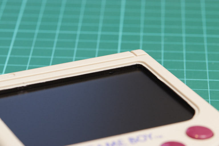

One more tip, I have coloured the border of the display cutout black, this looks much better with the screen protector attached.

mwx wrote:
Sun Apr 09, 2017 7:40 am
One more tip, I have coloured the border of the display cutout black, this looks much better with the screen protector attached.IMG_8317T.jpg
Yep. That's what I did. Used a black oil paint marker. This was a must since my case was white. It looks very nice. :D

Here another 3d printed part. This one is just for closing the cartridge slot.
Cartridge.zip
(1.45 KiB) Downloaded 614 times
