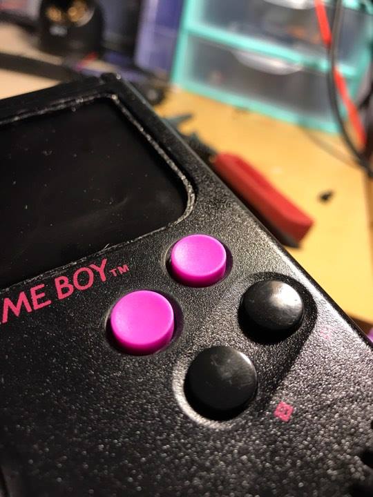

Chrisagu28 wrote:
Sat Apr 22, 2017 2:34 pm
So the best idea is to use a countersink bit. Relithe mentioned a ½ countersink bit. Did anyone else use a different size before I order one? I already ordered a set down/up but to drill the buttons for the holes.
I really like the idea of going it by hand. Didn't even think of that. Thanks for input so far everybody.
Here is my result with a 1/2" countersink and some sanding. This was using a 12v drill,
if done by hand with a bit more care it could have come out a lot better but I'm not too upset. The holes themselves are 11mm,
drilled with a millimeter-sized stepper bit that I got from Handheld Legend. 1/2" equals roughly 12mm so with the 1/2 countersink you're giving yourself about a 1mm bevel.
