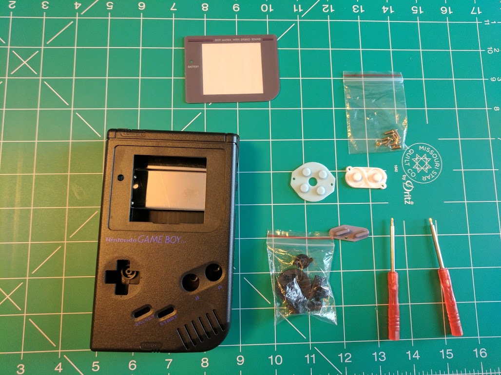

CaseShow
ScreenShow

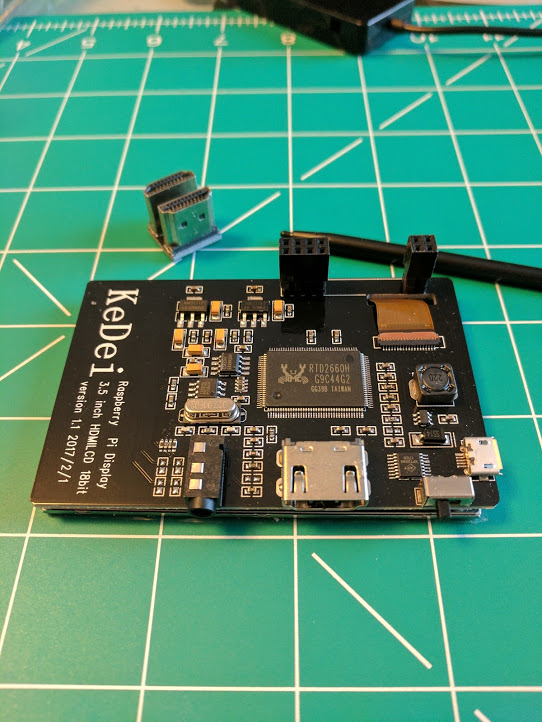

Had to remove a few things from the screen for it to fit.

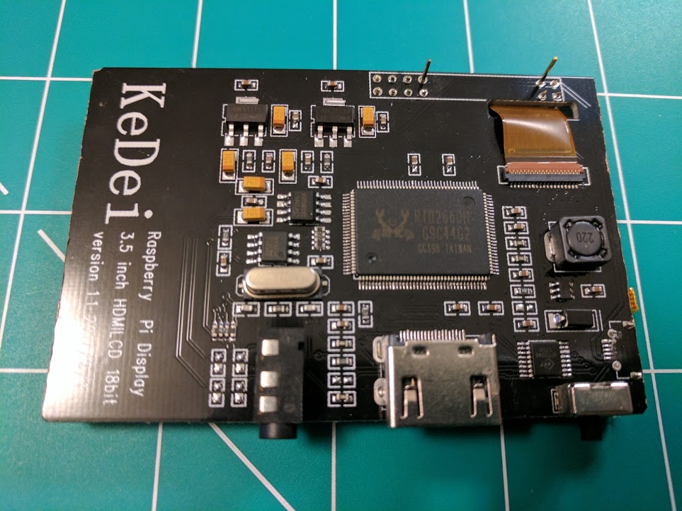

First ModShow
First Mod.jpg (149.17 KiB) Viewed 13843 times

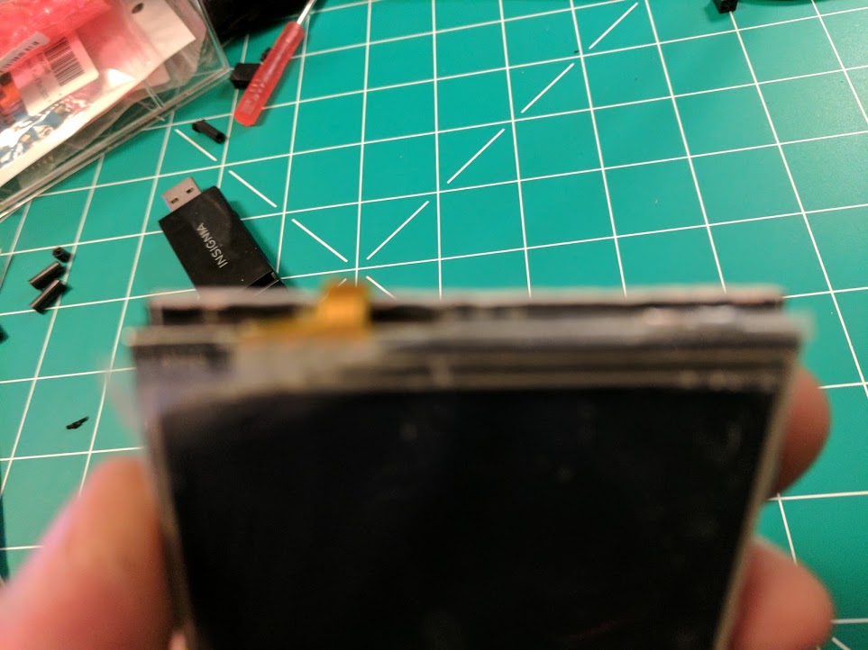

Not a great photo, but had to trim the edges of the PCB off to fit in the case (bye bye touch screen!)
Edge trimShow
Edge trim.jpg (99.15 KiB) Viewed 13843 times

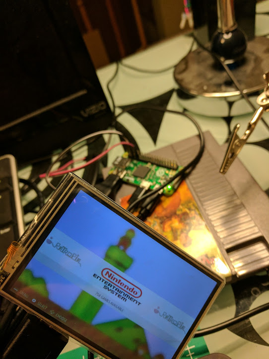

Still works!
TestShow

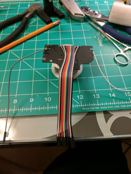

Soldered up the PCB next. Plan is to use a GPIO setup.
Button PCBShow
Button pcb.jpg (109.63 KiB) Viewed 13843 times

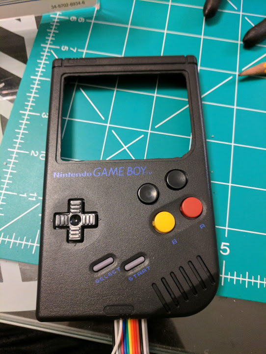

Buttons in!Show
I later swapped out the red/yellow buttons. They came from a Chinese SNES controller and were too sloppy... as you will find out at some point in this build, I am very particular of my neat-ness and plan to make the best looking wire runs possible.
Put the screen back in at this point. I pulled out the testing pin at the top of the screen and soldered in a new wire lead instead.

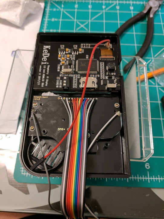

Screen fitShow
Screen fit.jpg (117.66 KiB) Viewed 13843 times
Added the screen bracket from wermy in there. The screen is too tall though, had to modify the bracket (wermy don't look!!)
BracketShow
And that is the current progress...

I have not pulled off the screen protector yet. Was going to wait til I was done cutting on everything... lol. I will keep you updated on the quality. I'll also have to grab a couple pics from the front with the screen in there.
I plan on using the HDMI port for connecting the screen to the Pi, I am using the GPIO for buttons. I found some odd-ball Chinese camera ribbon cable adapter.
The screen fits nicely after some trimming. The picture is slightly shifted to the one side as the border around the screen and the components do that. I plan on trying to play with the config to move it over.
Upside down was no problem. You can rotate the display. Add
display_rotate=2
to the config.txt and it spins 180*. Each # that you put after "rotate=" spins it 90*. Now the port is at the bottom where I want it.

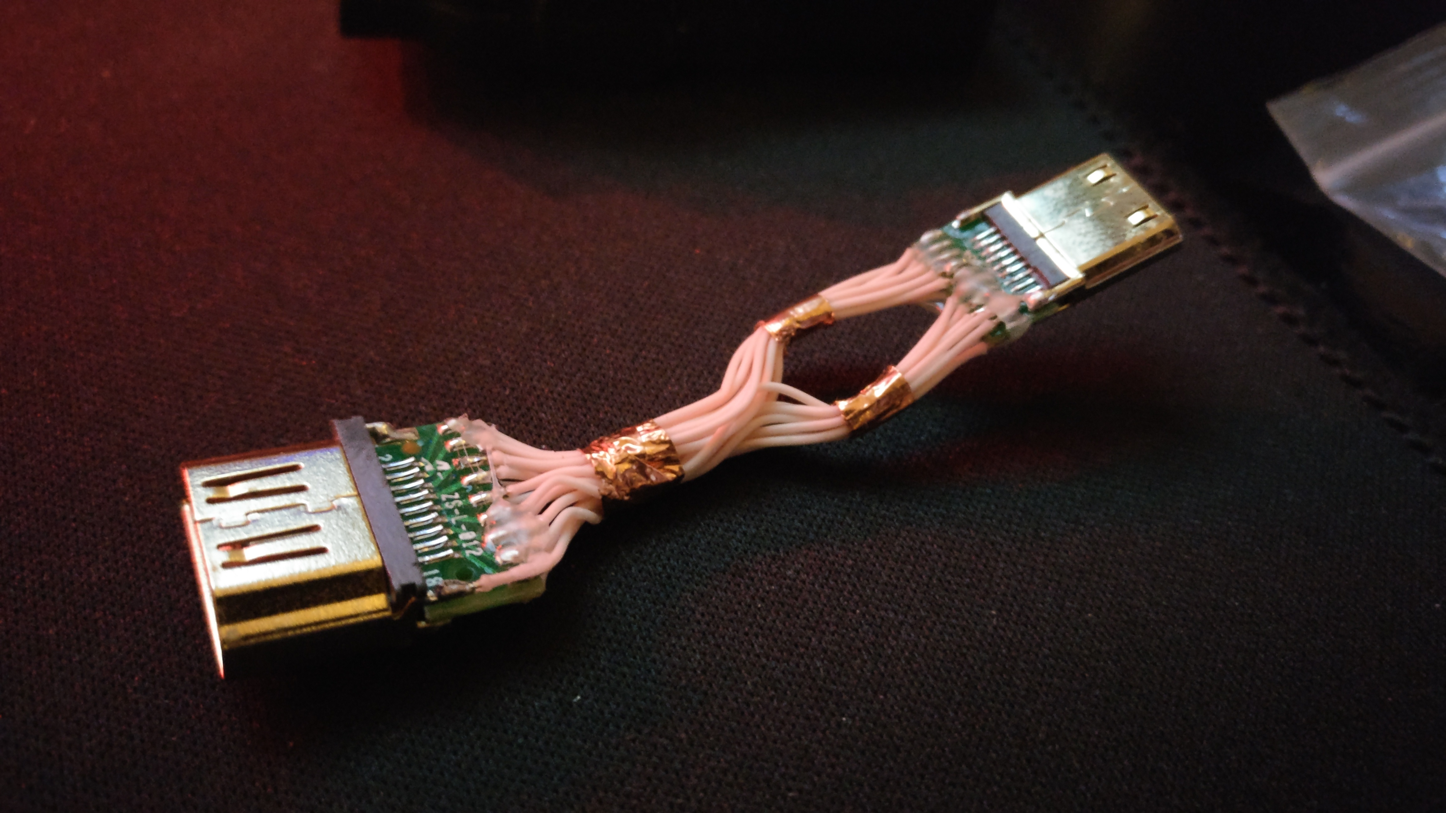

Ah ha. I found this cable... its a flat ribbon cable. HDMI to mini HDMI (at a right angle).
http://www.ebay.com/itm/New-15cm-HDMI-t ... Sw9NdXu0pj
and this adapter will hopefully get rid of the 90* bend...
https://www.aliexpress.com/snapshot/0.h ... 2794897414
My idea came from the Amazon comments where I saw this photo...
