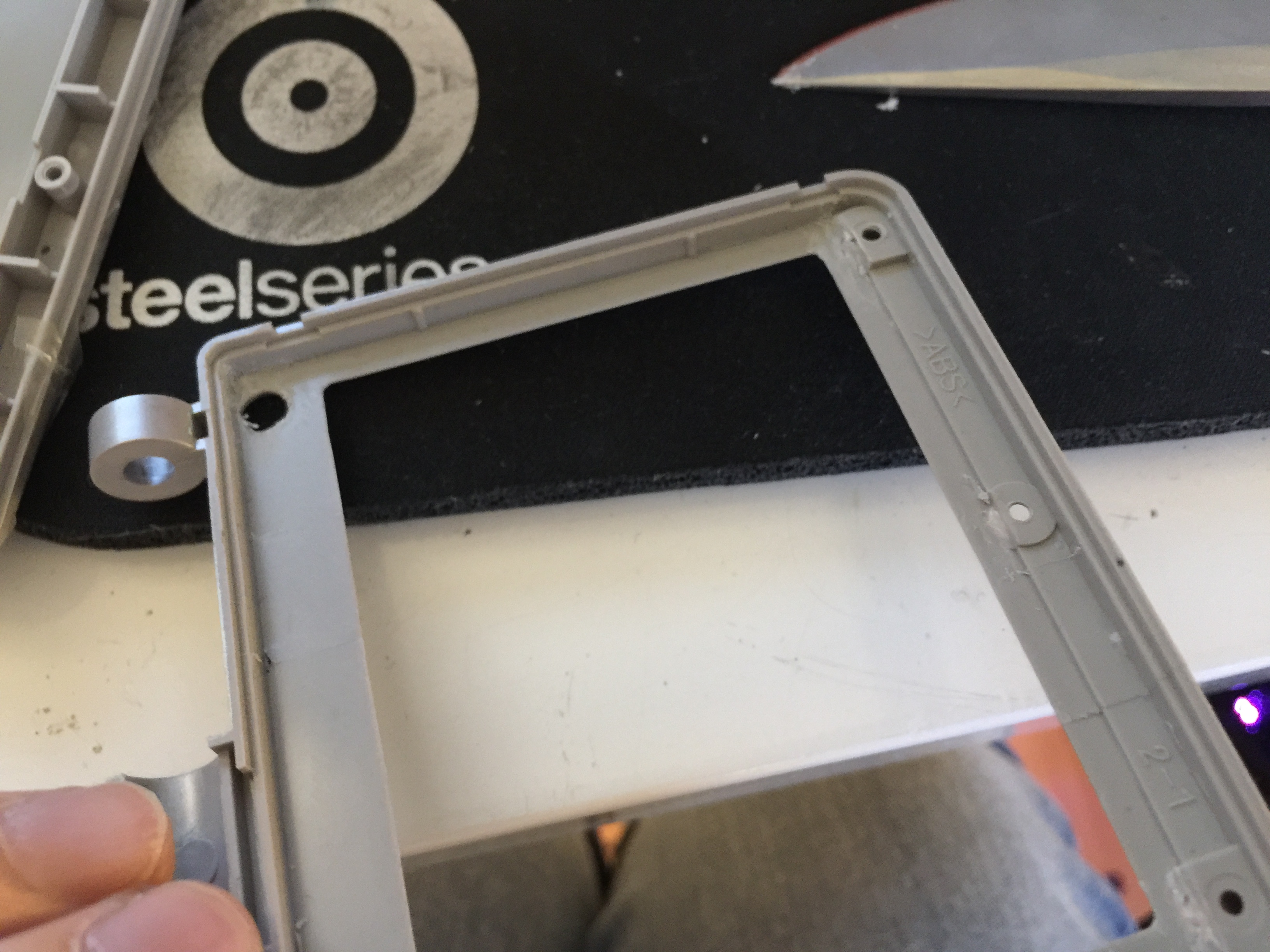

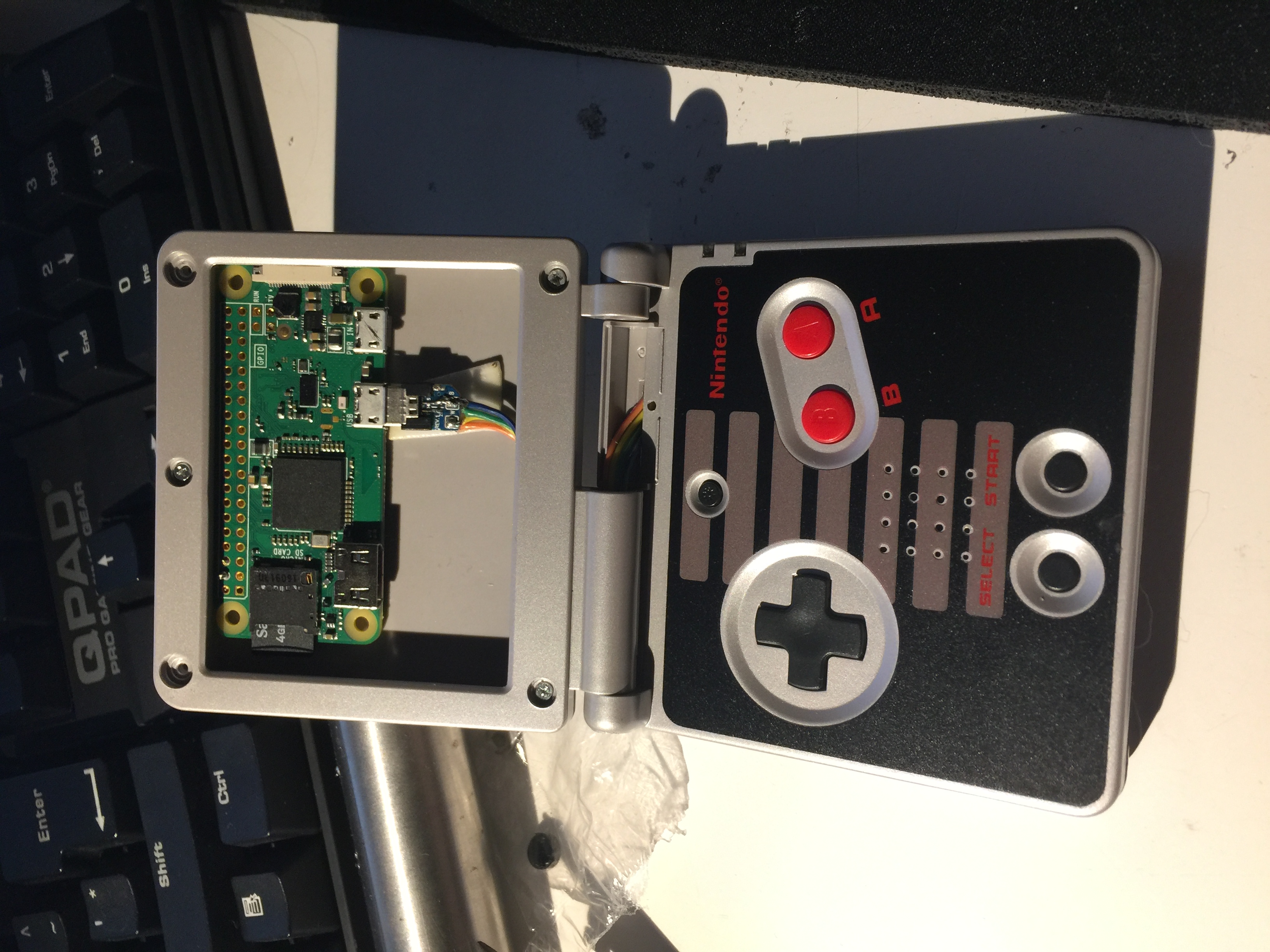

Hello there. I'm doing a GBZ inside a GBA SP (thanks Wermy for inspiring me to do this!)
Obviously, space is an issue. There's even less space than I anticipated at first. So, what hubs, sound cards, microcontrollers, etc. have you used that might fit in here?
I (and probably anyone attempting this in future) would really appreciate it.
Cheers.
Cheers.

I think @moosepr mentioned this in another thread somewhere about the dimensions of the whole case and possible parts that *might* fit. The pi can't be up where the screen is since it has little space there to fit anything thick so it's likely going to have to be some SPI screen with a ribbon or wire install to some extender board and have everything on the bottom part of the case.
Without custom parts or some creative dremeling of off the shelf parts it's going to be tough, and what about a battery to power this thing?

Thanks for the reply.
If I'm lucky, the Pi might fit there. I'll gain a few millimetres later by using something else than thick double sided tape and by possibly desoldering the HDMI and USB ports. I can also move it to the very edge. I just hope that the generic BW-like screen I ordered has a small driver board. If all that fails, I'll cut the bezel a bit to mount the panel further away.
For battery, I'll try something small that'd fit the original battery compartment, even if I have to sacrifice battery life.
Luckily I have experience with "creative" dremeling.

I wonder if it would work better if you approached it more like a 'Minty Pi' than a GBZ. After all, an Altoids tin is smaller than a GBA SP. So, lose the USB hub, go with GPIO controls and just do a simplified, stripped down build.

If you can get it to work, you might want to look into stock DS Lite batteries, they're pretty small. How much of the structural support can you reasonably remove...maybe just leave three mounting bosses for each side?Jack Schitt wrote: ↑Thu May 11, 2017 5:57 pmThanks for the reply.
You may have to DIY some of the components like amp/buffer etc into custom shapes to Tetris into each other. I doubt you'll be able to 'layer' much of anything, so having everything on one plane would probably be the most efficient.
Edit: I'm sure you're also going to use the GBA cart reader space, so maybe the first port of call is to epoxy in a sacrificial cart, then cut out all those walls on the inside for maximum space.
I would draw out a profile of each component you need and the internal dimensions of the case, then tangram it up until it fits!
Love the challenge though, and double love for the NES themed case

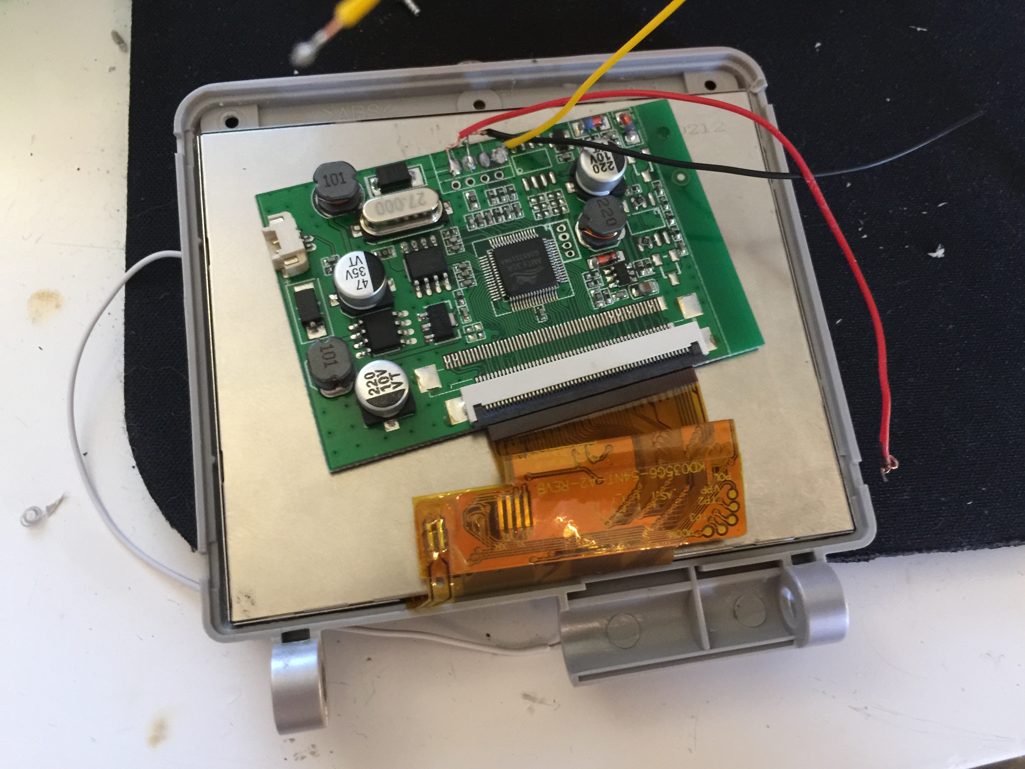

I have extremwly good news. The BW screen just arrived. While it took some precision dremel- and knifework, the panel is an exact fit. Even better, the board will fit on the lid if I solder off the caps, etc. and do extension cables for them to somewhere more spacios place like the edges.
Then, some less good news - the board seems to be a yet unknown variant (I'll give a high res image when I get to my DSLR) and my only available micro SD card died so I can't test the screen.

Jack Schitt wrote: ↑Mon May 15, 2017 6:53 amI have extremwly good news. The BW screen just arrived. While it took some precision dremel- and knifework, the panel is an exact fit. Even better, the board will fit on the lid if I solder off the caps, etc. and do extension cables for them to somewhere more spacios place like the edges.
Looks good! I've been thinking of attempting this as well. I'm just starting building a parts list. Where did you buy that screen?
