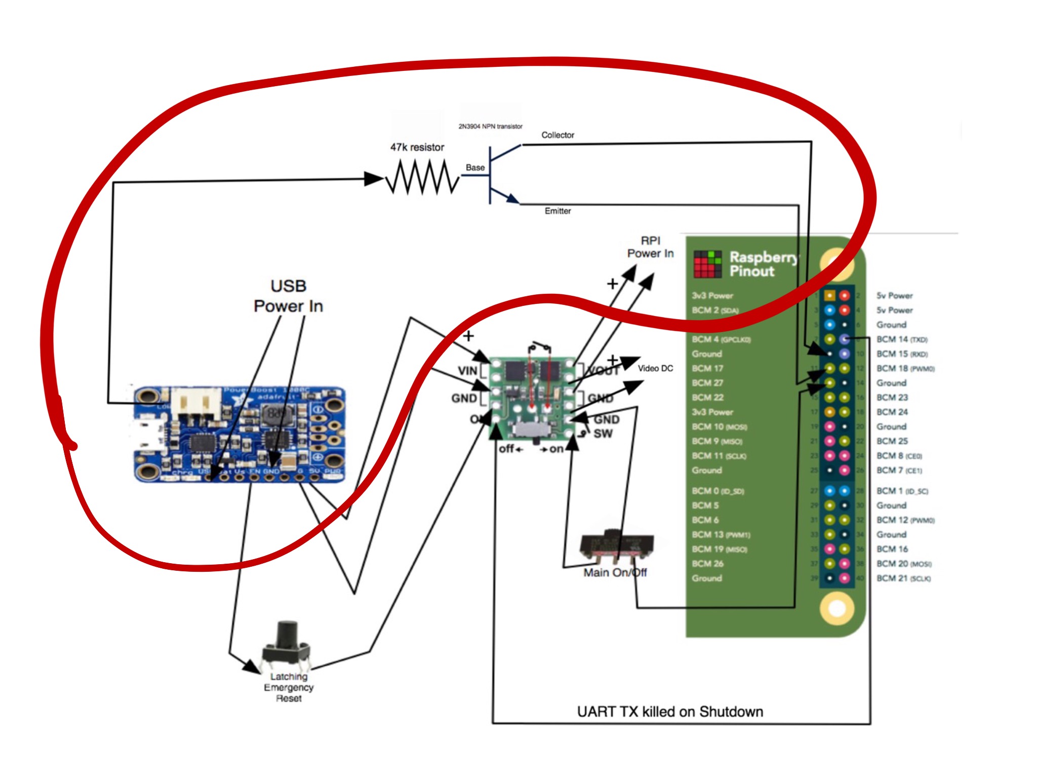

You could do something like this from the LED point itself. Ignore the rest of the circuit, the important part is the 2n3904. So when the Powerboost lights the LED it should close the circuit for the signal that you need.

I got so caught up in thinking about various voltages etc that I never thought of using a transistor. :lol:
That is a great idea! I will start investigating thanks!
