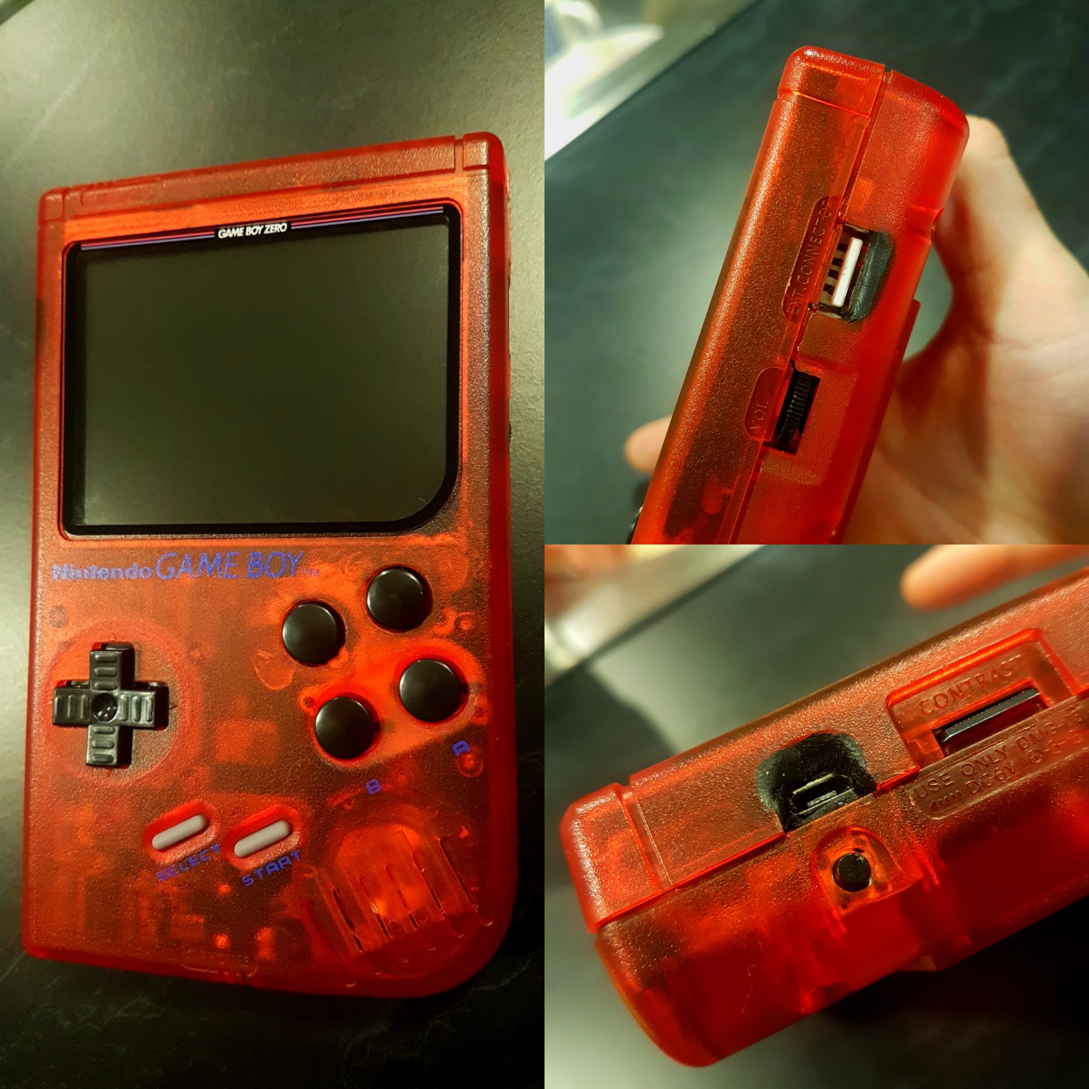

Here it is complete:

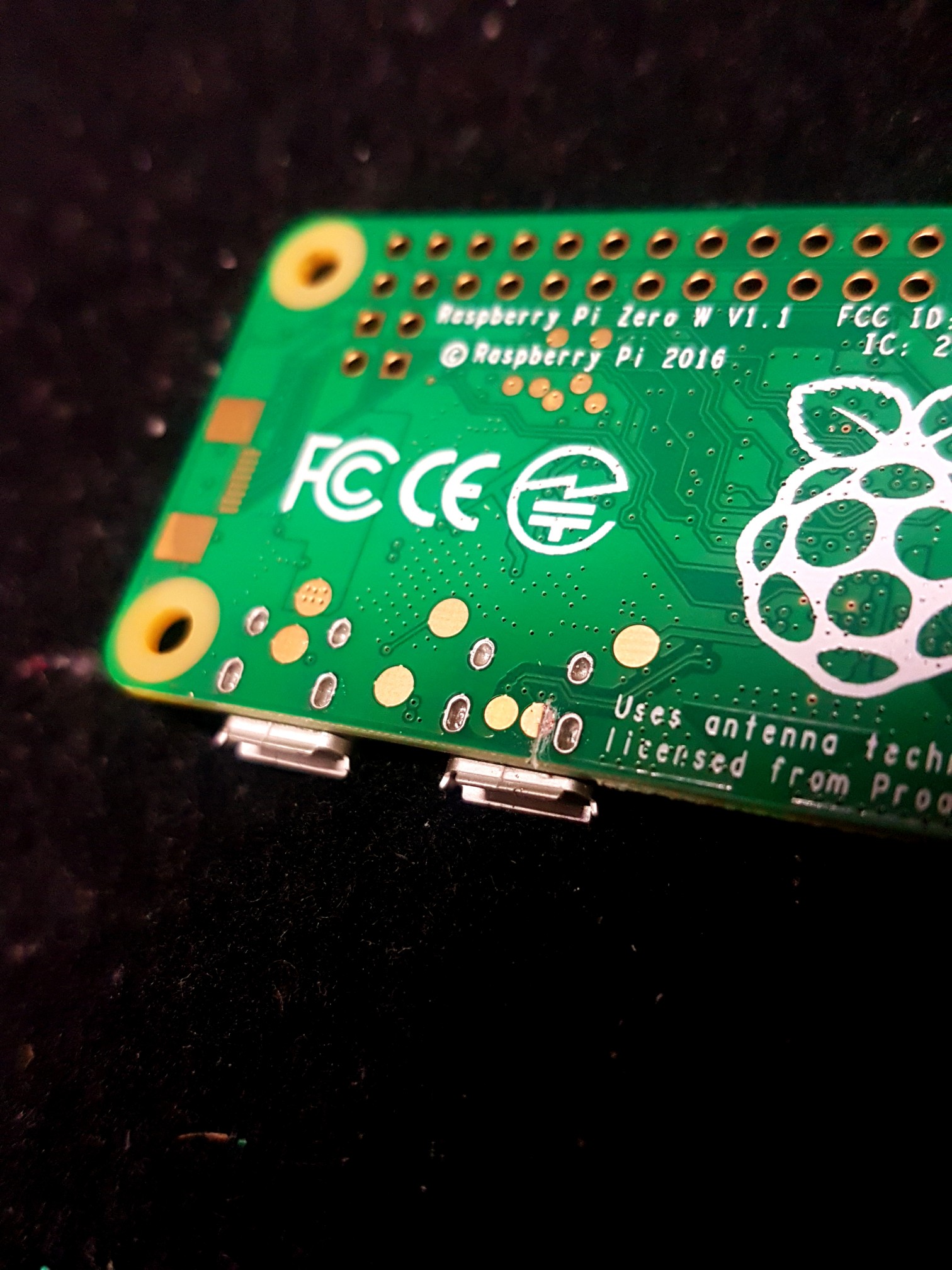

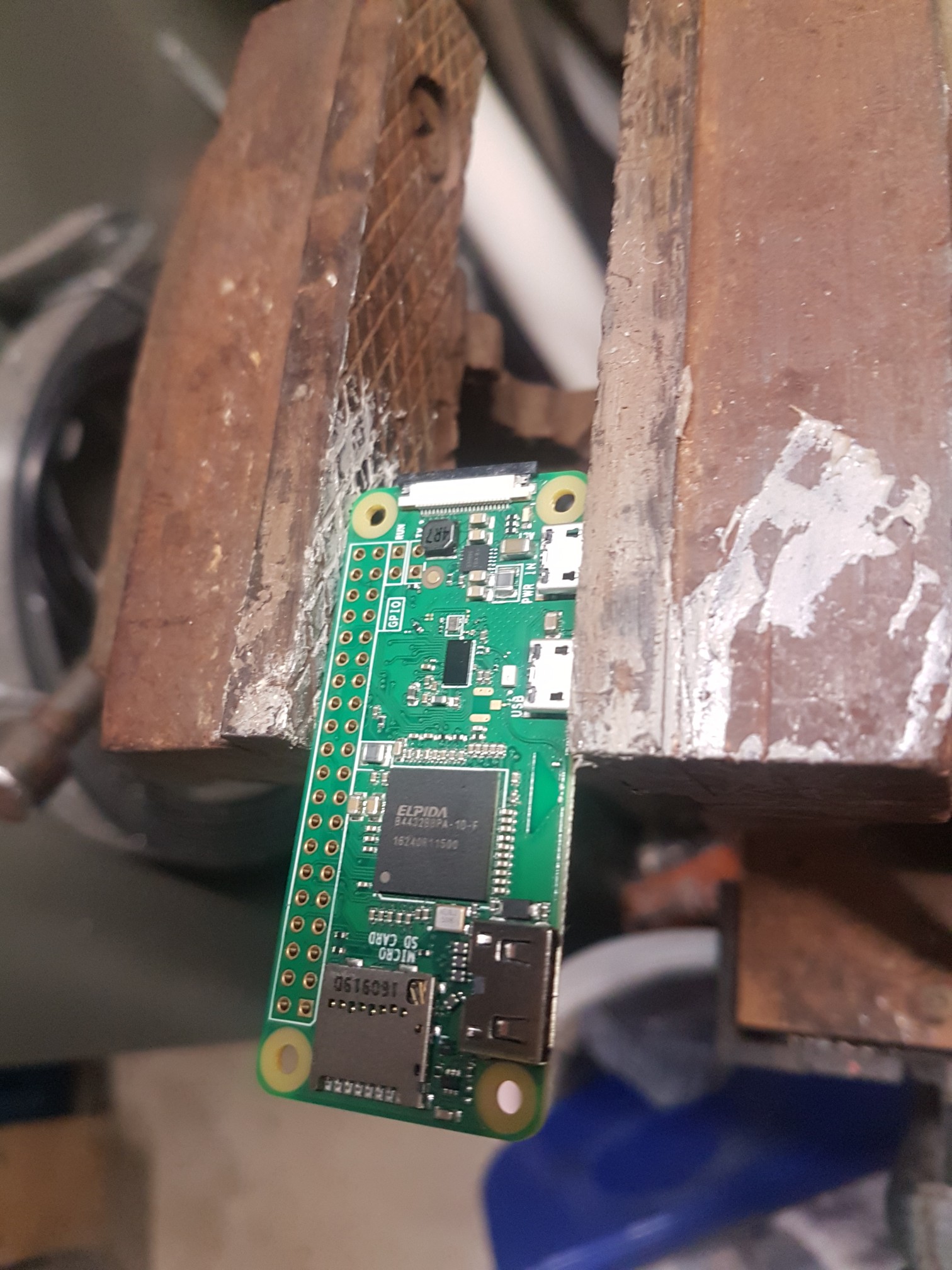

Decided to start with the Pi itself....first things first, cutting the corner:
This was pretty easy and the Dremmel made light work of it.
Secondly, cutting pad23... was careful not to mess up! Used a fresh blade in my Stanley knife and cut away from the Pi as Kite suggests.
Followed up by soldering the pads and applying the long overdue Kapton:

A little late now and maybe Kite should change his guide, but it is not necessary to cut and risk damaging the USB pad. Merely applying the kapton tape over the ground pads will keep the solder from making contact. Looking forward to the rest of your build. :D

Has thanked: 796 times
Been thanked: 527 times
Re: LPs Kite SAIO Build
Post by Lphillimore » Wed Jun 07, 2017 8:46 am
HoolyHoo wrote:
Wed Jun 07, 2017 8:37 am
Thanks, mate. I did think to myself that maybe the tape would do the job by itself but didn't want to not do it and pay the price once the Pi is soldered down.... :lol:
I'm sure it's posted in the forum somewhere and i'll be honest, i've hadn't looked to see if there have been any changes so i'll be sure to do that going forward.
Let's hope i havent killed the pad ;)

I'm sure its fine but it reduces the soldering surface area on that pad by at least half which is already tricky enough since the alignment is not straight on through Kites board (Done on purpose).

We'll soon find out ....when im effing and jeffing out in the shed :lol:

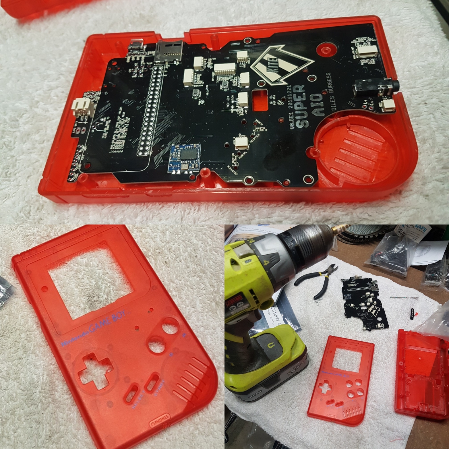

Post by Lphillimore » Mon Jun 12, 2017 10:33 pm
Case mods underway.
Button holes marked and drilled.
Screen prepped for cutting and screw wells saved :P
