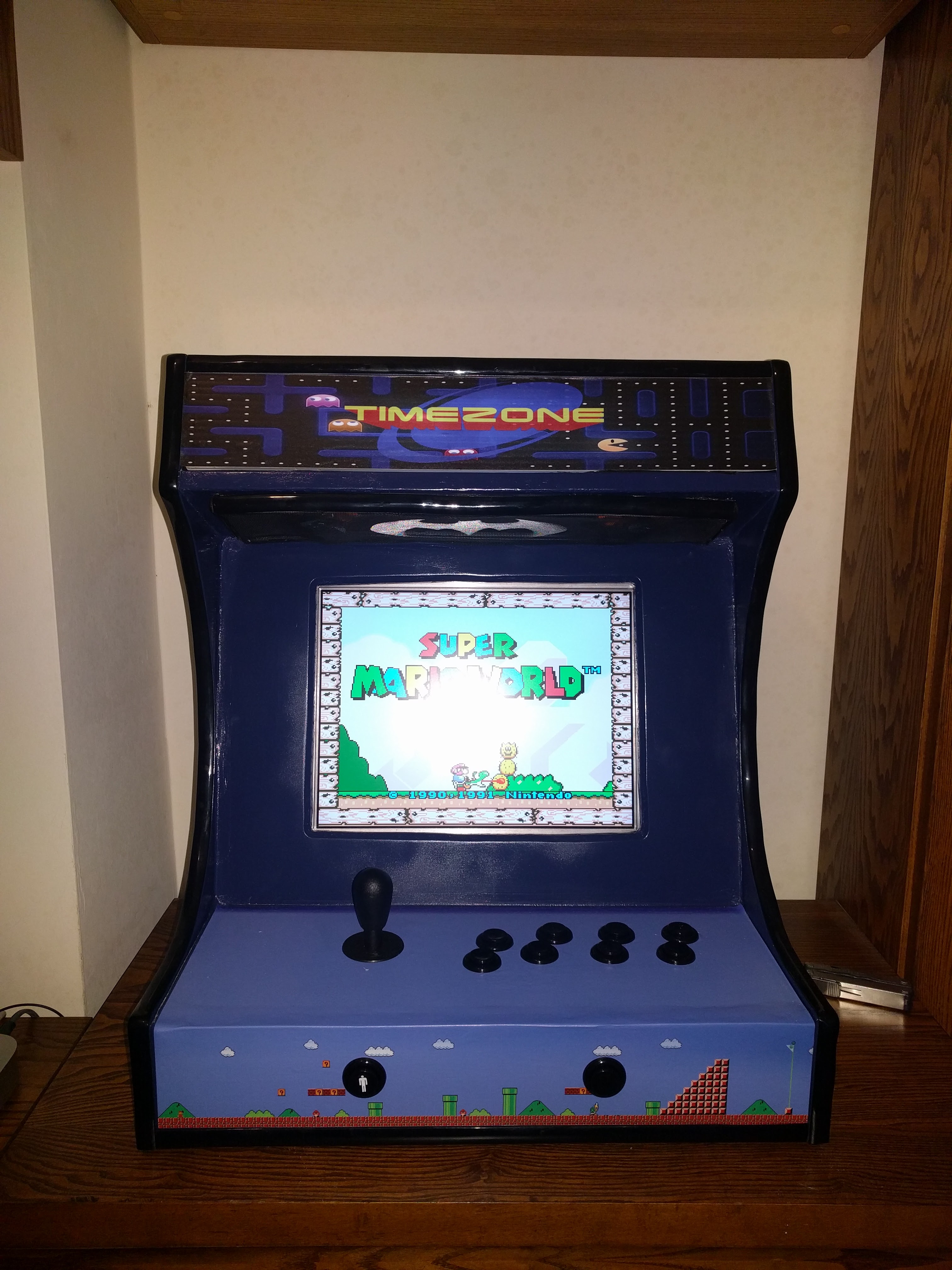

Hey guys just showing of my bartop arcade...anyone from Australia who was a teen in the 1980s and 90s will know where I got the marquee name from.

Very nice setup. Did you cut the cabinet yourself, or was it a flat pack? I ask because I'm considering making a bartop with some salvaged laptop lcds but all the flat packs I've been seeing are for 17,19 or 21/22 inch monitors.
Thank you very much. I did cut them myself, not sure if i can post direct links to what i based it around, but I found most of the things i need on http://www.instructables.com/

Very nice! What do you have running it?
Going to move this to the project show-off area where more people will see it. :)
Thanks for the reply. I used a Raspberi pi 3 with Emulation Station. For a screen I cannibalized an old 15 (or 17?) inch monitor. For controls I bought:
http://www.ebay.co.uk/itm/2-Player-Arca ... SwYIxX4lGl (Surprisingly good quality)
If i want player 2 i have an XBOX 360 wireless controller dongle connected and configured
For audio i bought a cheapo €15 amplifier and €10 speakers
As for tools all i used to cut the wood was a jigsaw and MK1 eyballs nothing elaborate (sandpaper,screwdrivers etc)

Here's one I put together a couple years ago using an ion iCade as the housing: https://instagram.com/p/BUUqVhjF8dL/
Still works great, upgraded it with a pi 3 recently. :)
So cool and original, what screen did you use ?

Thanks! It uses an old, used 12.1" Dell laptop LCD panel, along with a controller board for it (I think it was about $50 together, so not too bad). Also uses one of these for the controls: http://www.ebay.com/itm/251241991403?_t ... EBIDX%3AIT
