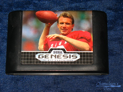

I'm using an original cart. Here's a picture (not by me) of what it looks like.
I might use something like this for the cart slot, but I'm not sure if it'd be a good idea.
https://www.ebay.com/i/172228886777?chn=ps&dispItem=1
Suggestions on what to do is appreciated. I'd eventually like to know how to make a PCB (as I hope to make a hard reset and hard power on/off button using the original power and reset buttons from the Genesis and make use of the Genesis' original AC Power cord.) If you know where to start learning, that too would be greatly appreciated!
