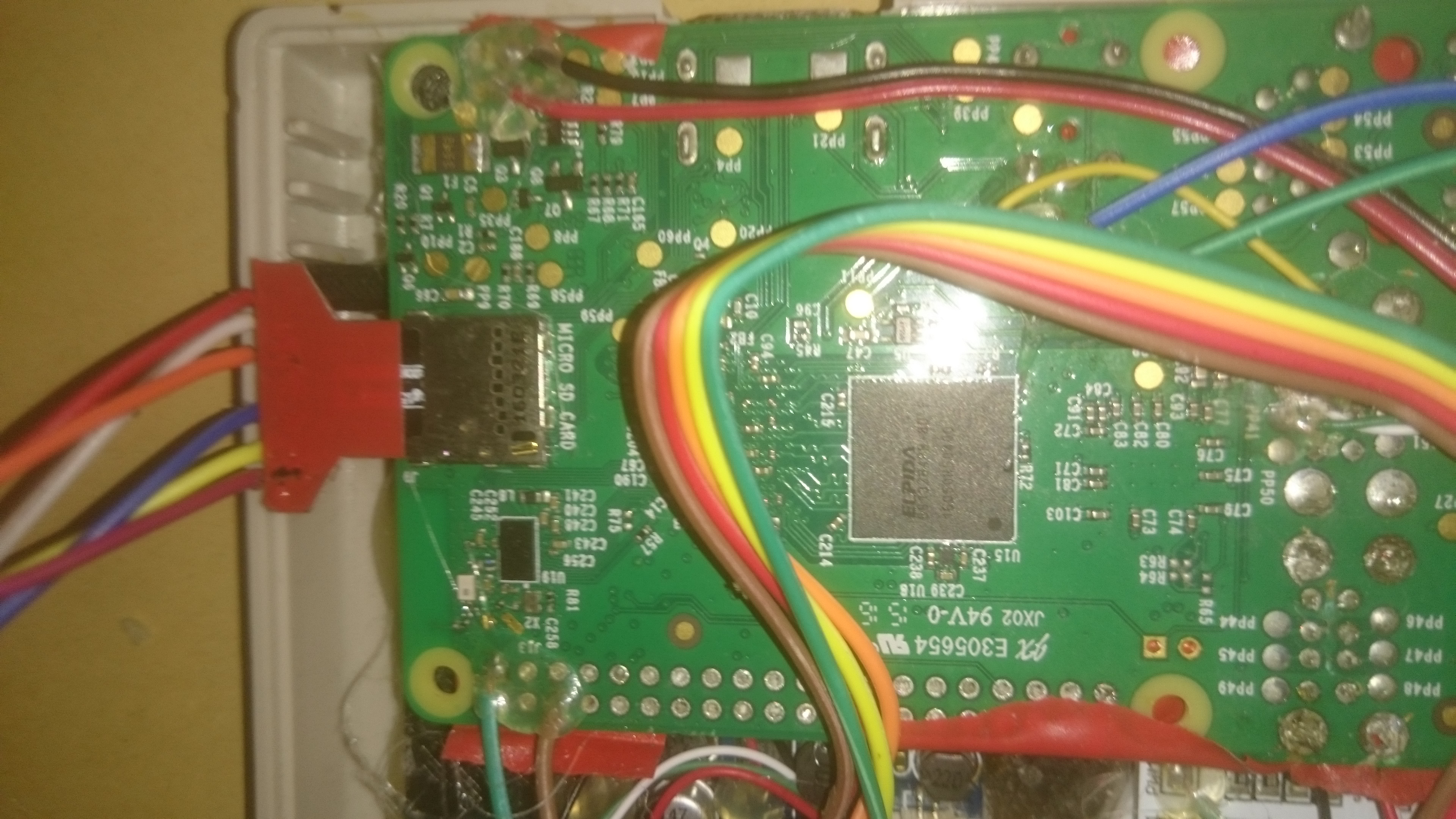

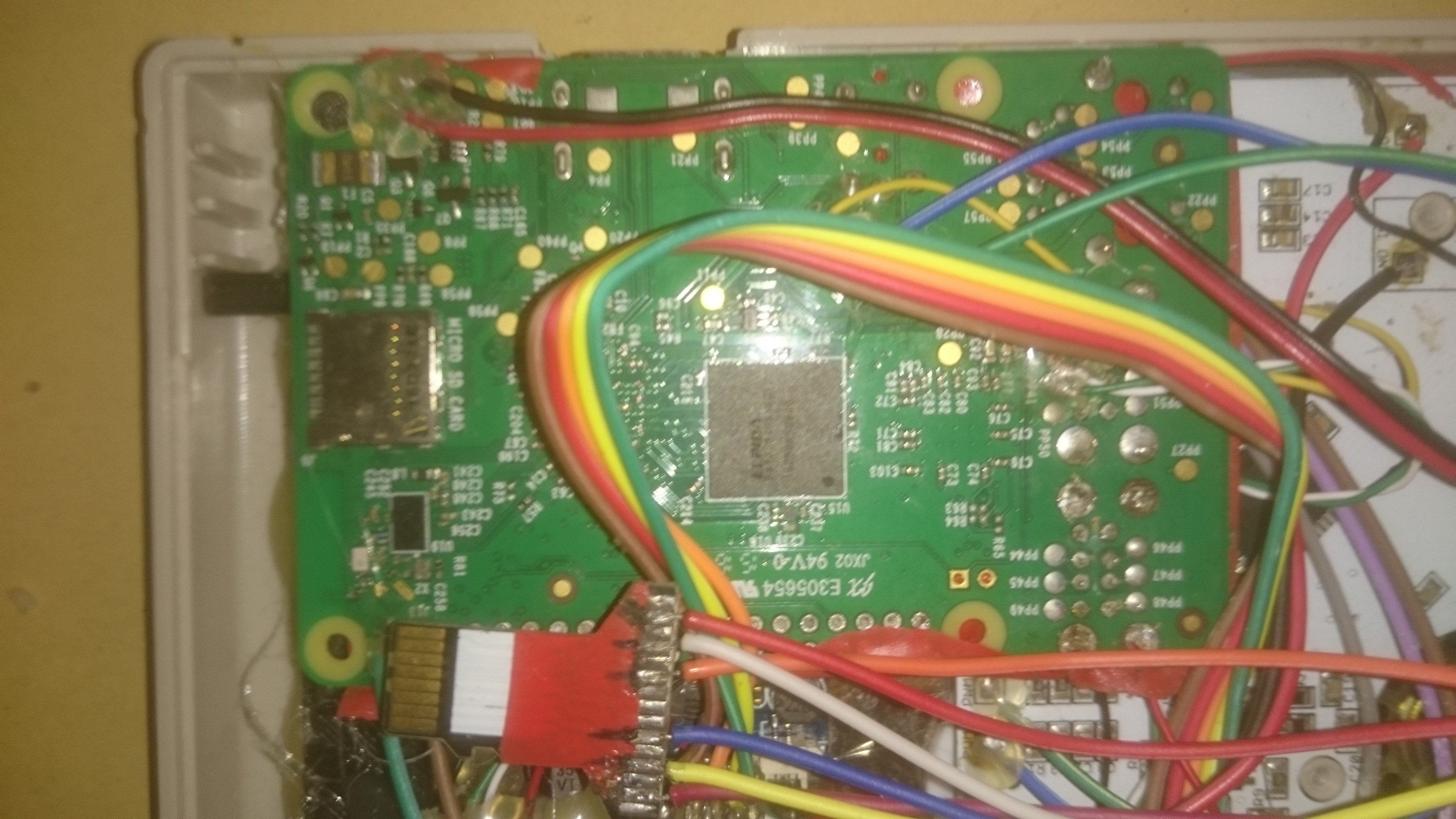

i have some trouble by booting my Gameboy from my SD Card. I wired everything up correctly but the screen stays Black (HDMI don't work too). Iam powering the SD Card reader with the GPIO pins from the Pi3. (Everything works fine if i boot directly from the SD Card Reader from
the Pi itself). I have measured everything, it should work. I despair of it, I have already checked it all over several times.

Wires are way too long. Twisting the data lines helps. Shielded cable is always the best.

First of all, cable length is a very recurrent issue trying to get PRS's cartridge reader working. That I can tell from experience. The shorter the better.
Second, regarding twisting the data lines, I haven't tried it for PRS's cartridge reader but it also something that comes up a lot for USB ports and AIOs (typically Helder's board). My guess would be that it doesn't hurt.
To give you some personal insight, I realized shorting the data lines was essential, but not sufficient. I managed to make it work once, out of a gameboy case, but once assembled it didn't work anymore. My next step is to try some shielded/twisted cable that my roommate got me 1m of and experiment that to connect the PRS's board to the RPZ. Also, I am assuming you didn't have any shorts and that everything is wired correctly. The former is pretty frequent as the RPZ pads are VERY close to each other.

I have only shortened the wires and twisted the data wires :). Now i have a Gameboy with Raspberry Pi3 and working Cartridge 8-)
