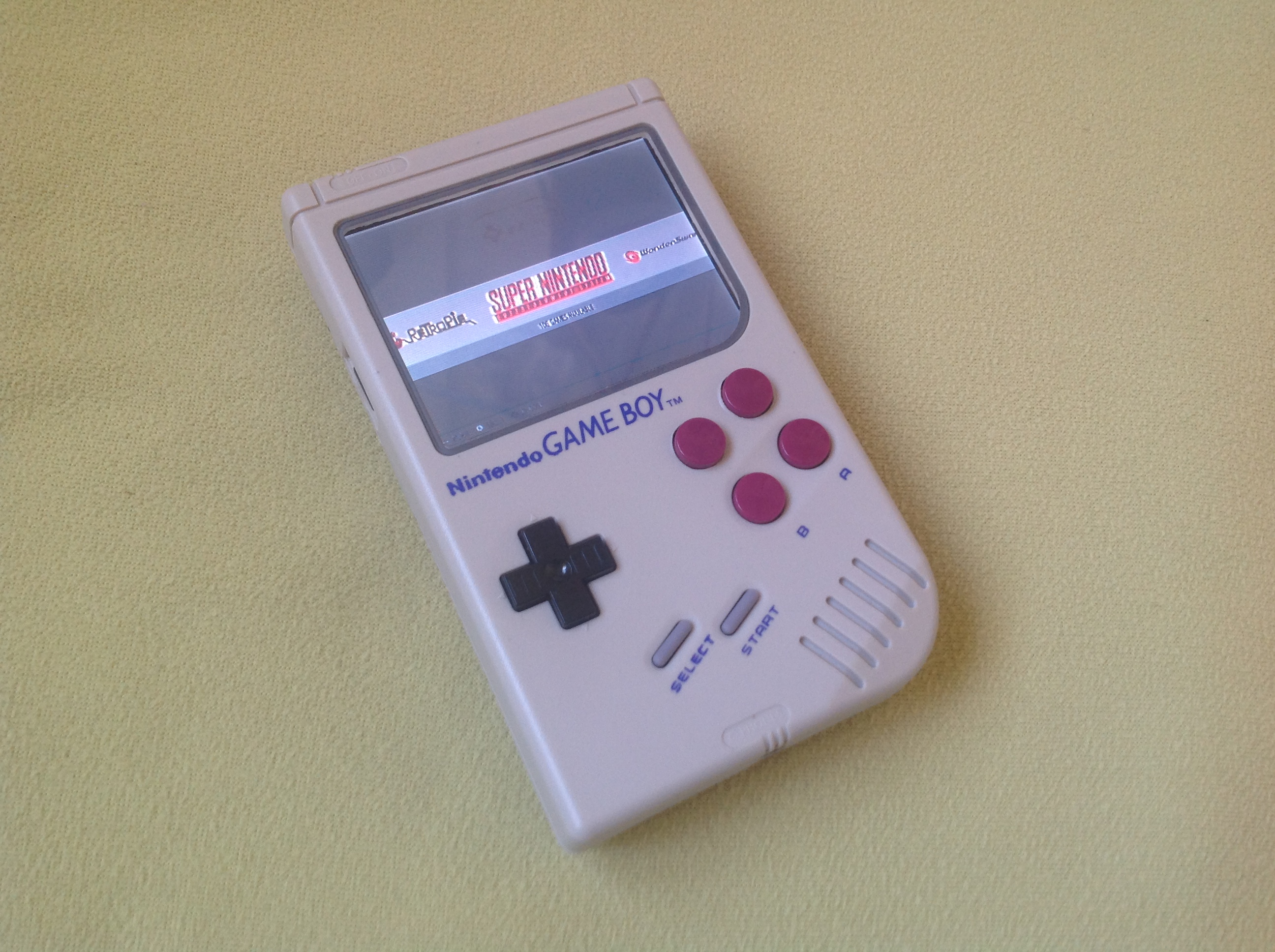

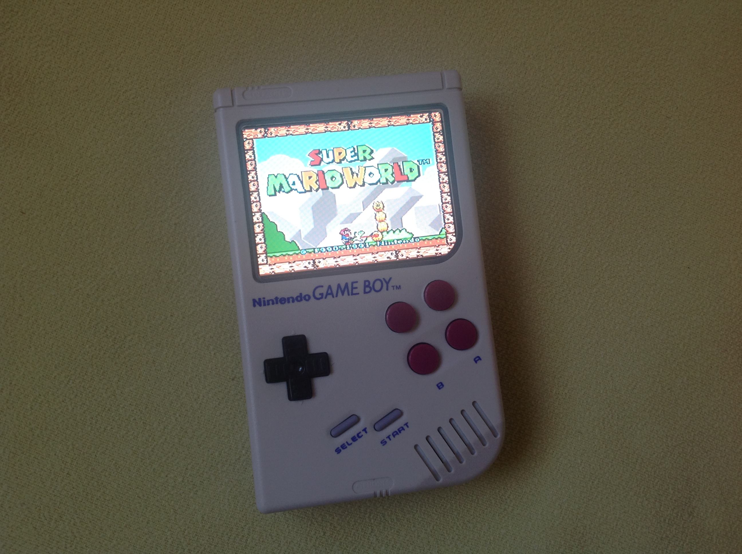

Here is my first Game Boy Zero build. I'm using the GPIO pins for the buttons instead of the teensy which I think is very easy to setup.
GBZ RetroPieShow

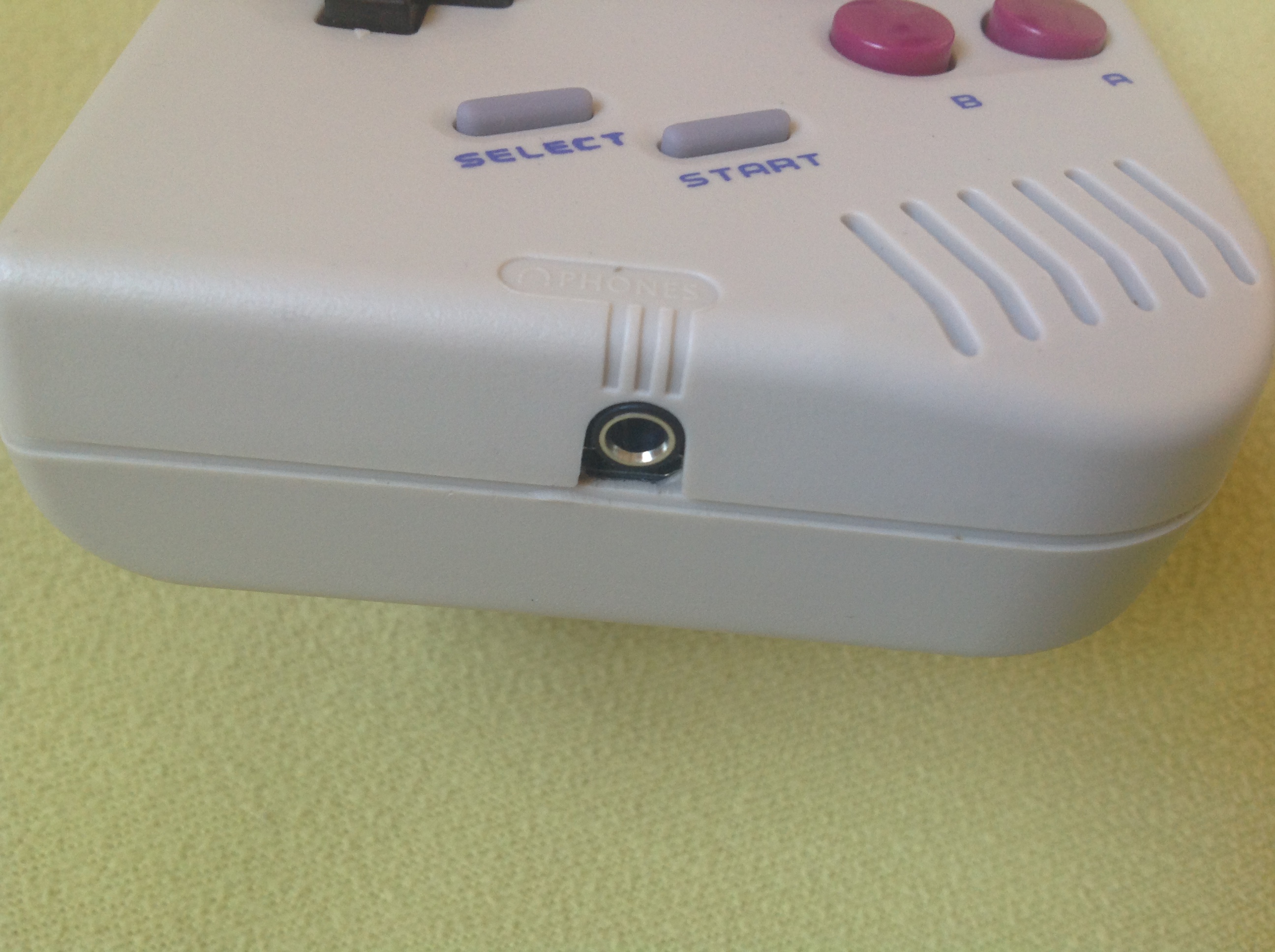

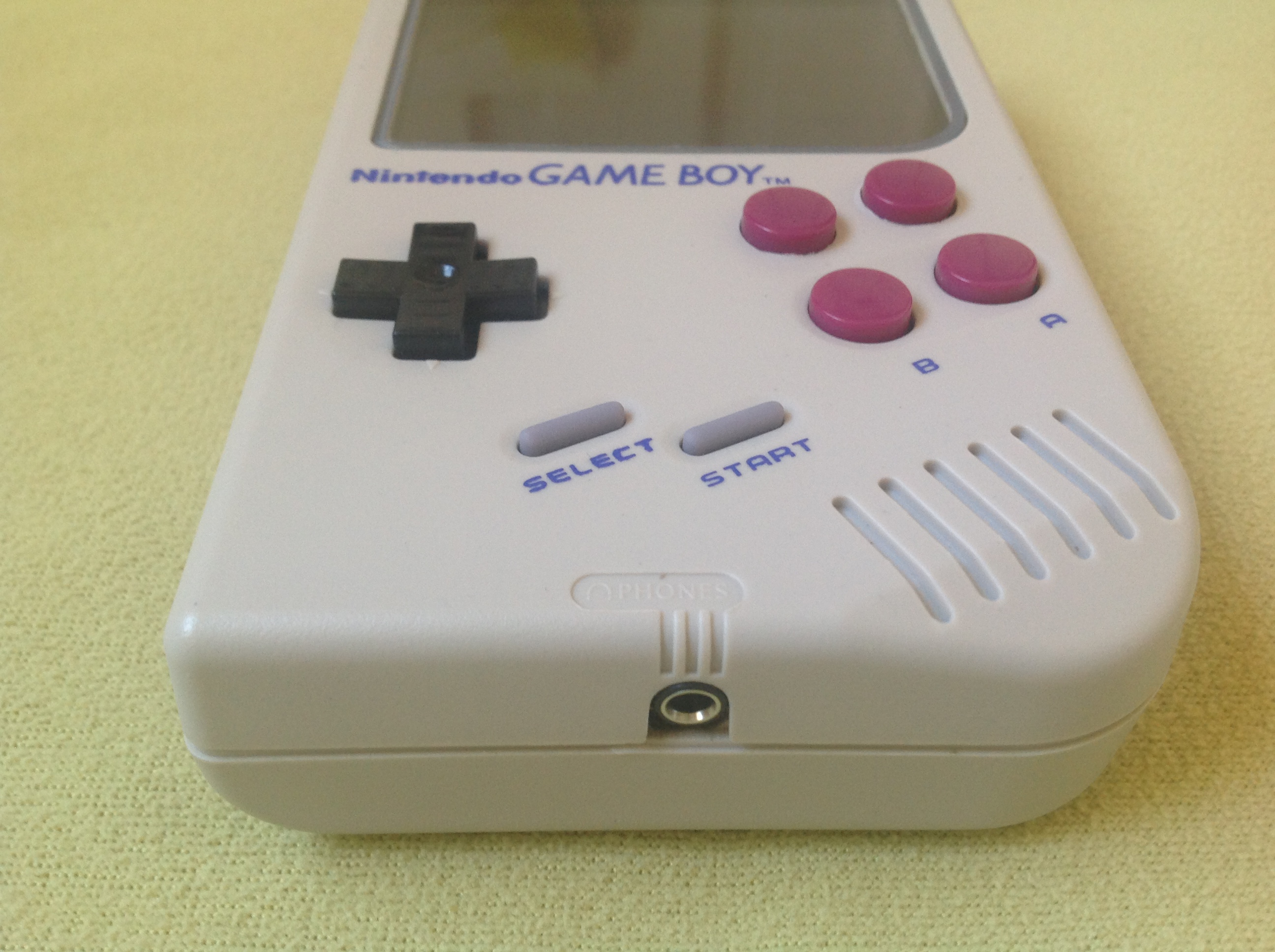

I placed the micro usb charger port just under the audio jack which makes it hardly noticeable. The PWM Audio is built using this guide.
Micro USB Port & Audio Jack.Show

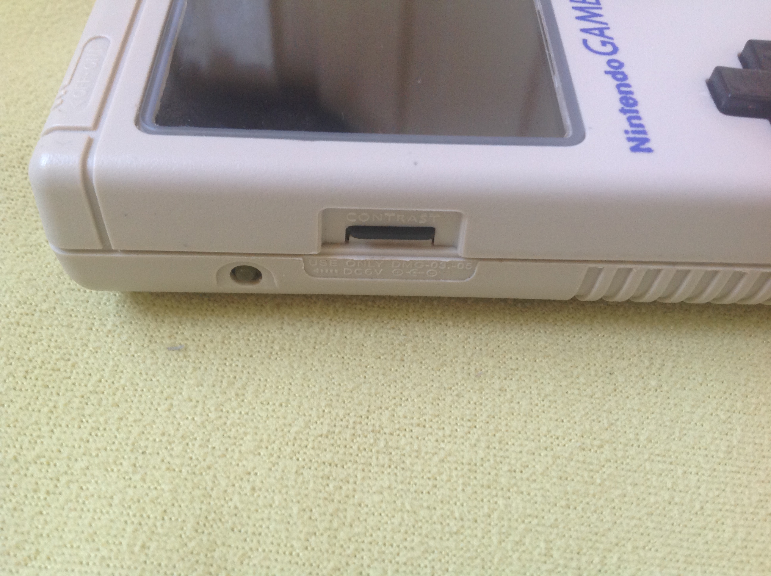

Instead of the usual HDMI port in the "CONTRAST", i positioned the Raspberry Pi Zero's sdcard port in there. And also a low battery led light in the "DC6V" where the usual micro usb port is placed. I built the simple low battery led using this one which draws very little current.
SDCard & Battery LEDShow

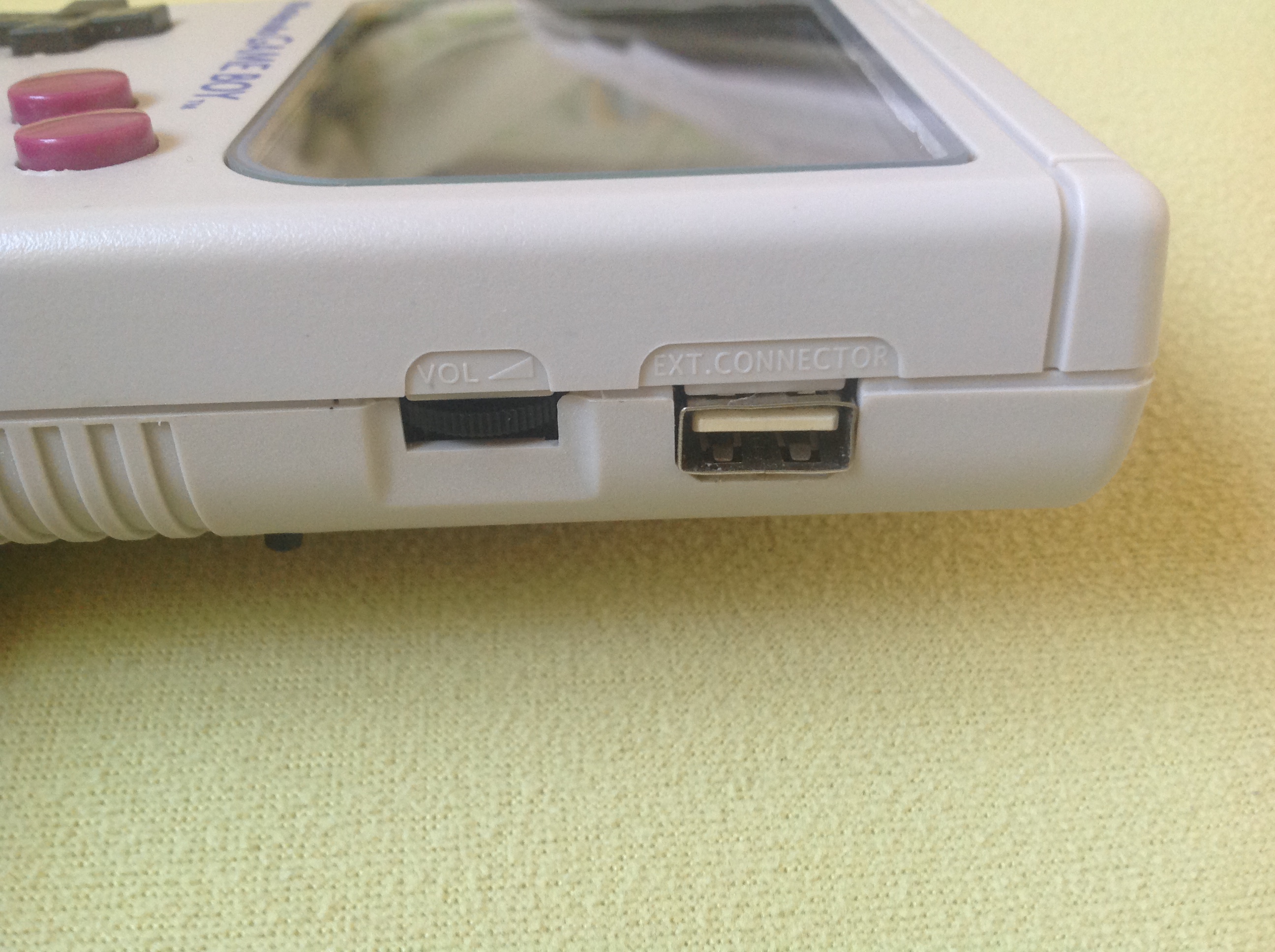

Volume & USB PortShow

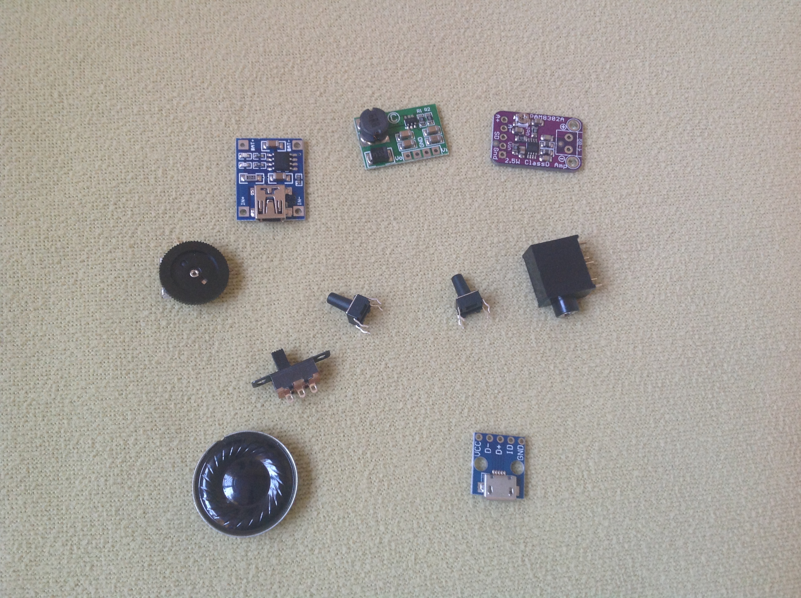

I used two separate modules for the 5V Boost converter and the 3.7V Battery charger because its way cheaper than the Adafruit Powerboost.
5V boost, battery charger, audio amp, etc..Show

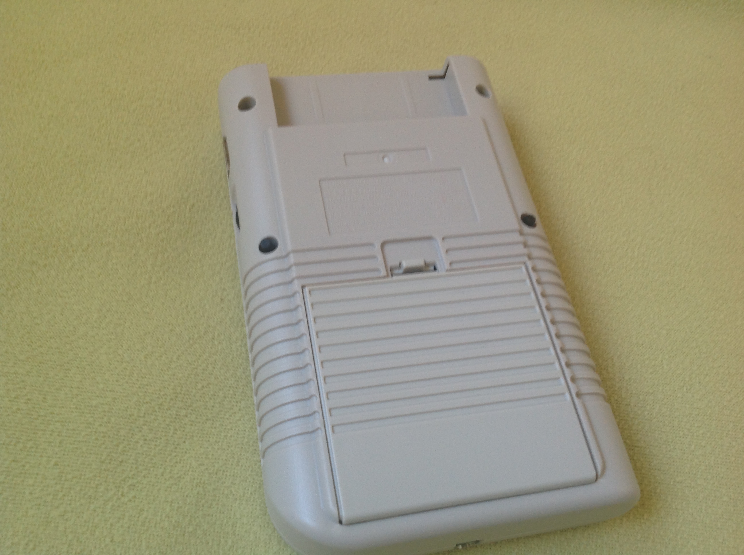

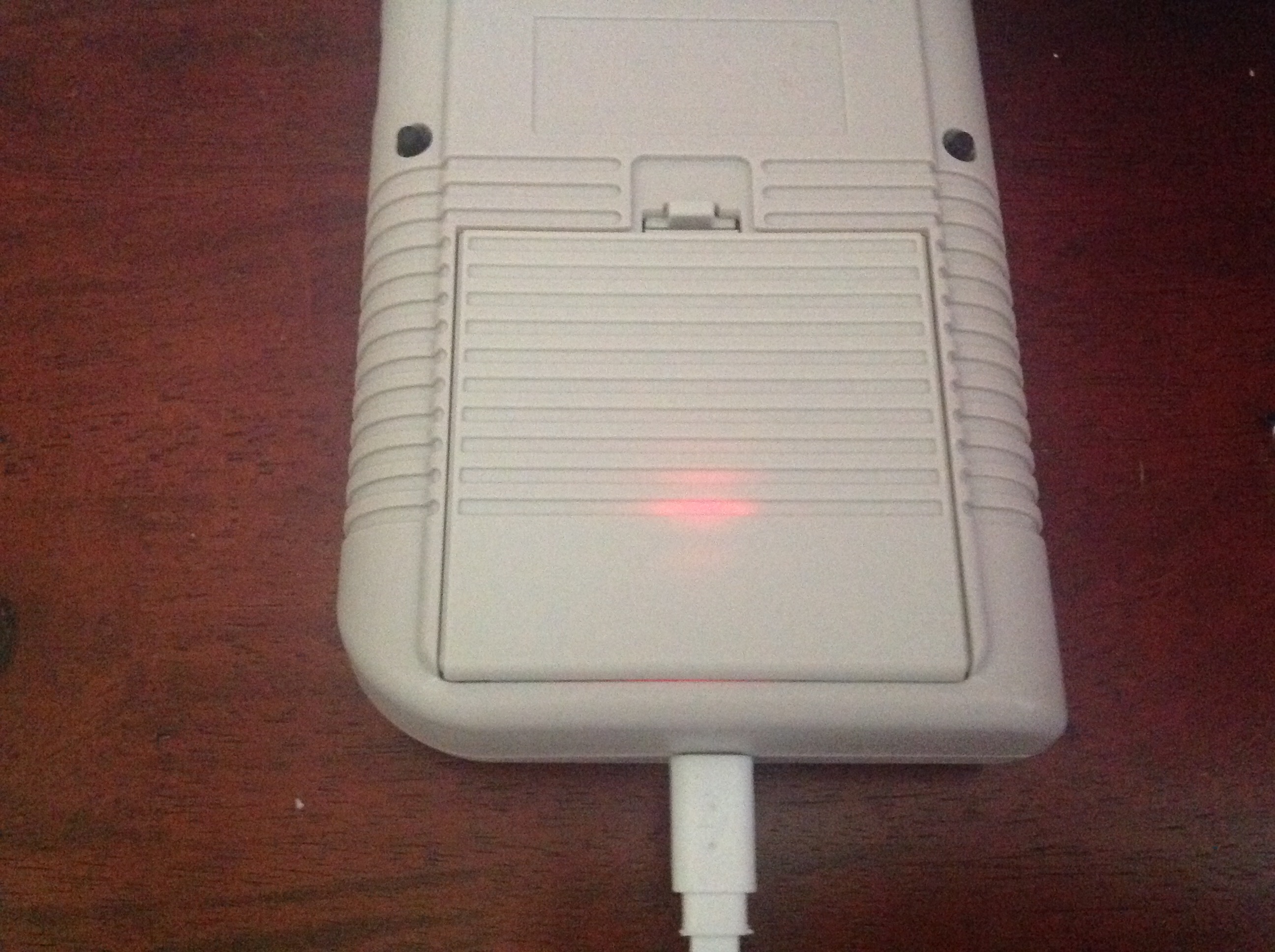

The 3.7V battery charger has two led indicators when charging and fully charged so i just placed it inside the battery compartment which makes the led light visible from outside the battery cover.
Charging LEDShow

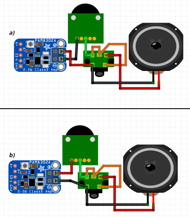

Hey would you mind showing the audio wiring? I am having trouble making my headphone jack and speaker work together I also have a radio shack pontiometer volume wheel I also have the same AMP as you.

Post by tinkerBOY » Tue Jul 18, 2017 6:50 pm
firestw152 wrote:
Tue Jul 18, 2017 6:00 pm
I followed a diagram i saw here in this forum. I followed b
