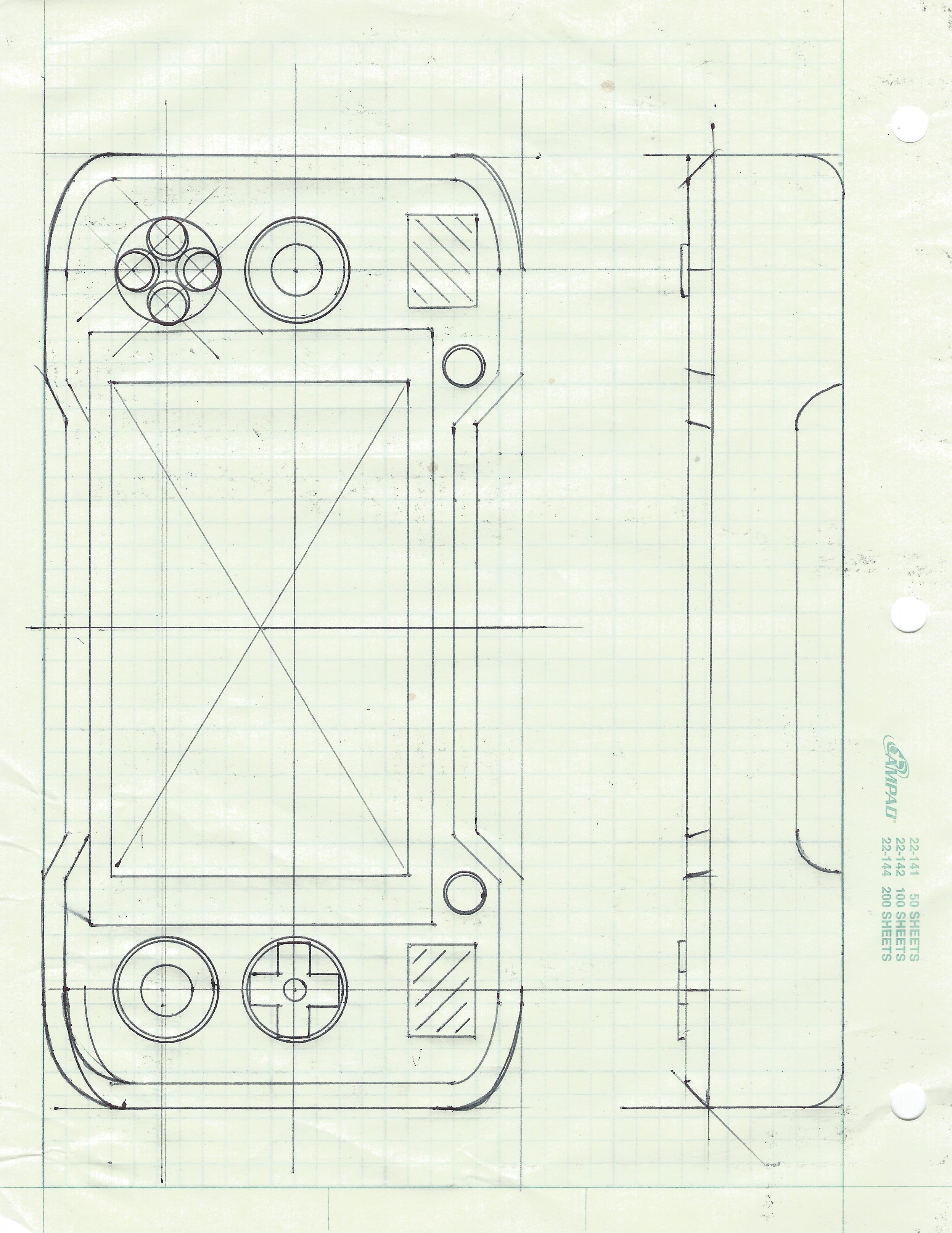

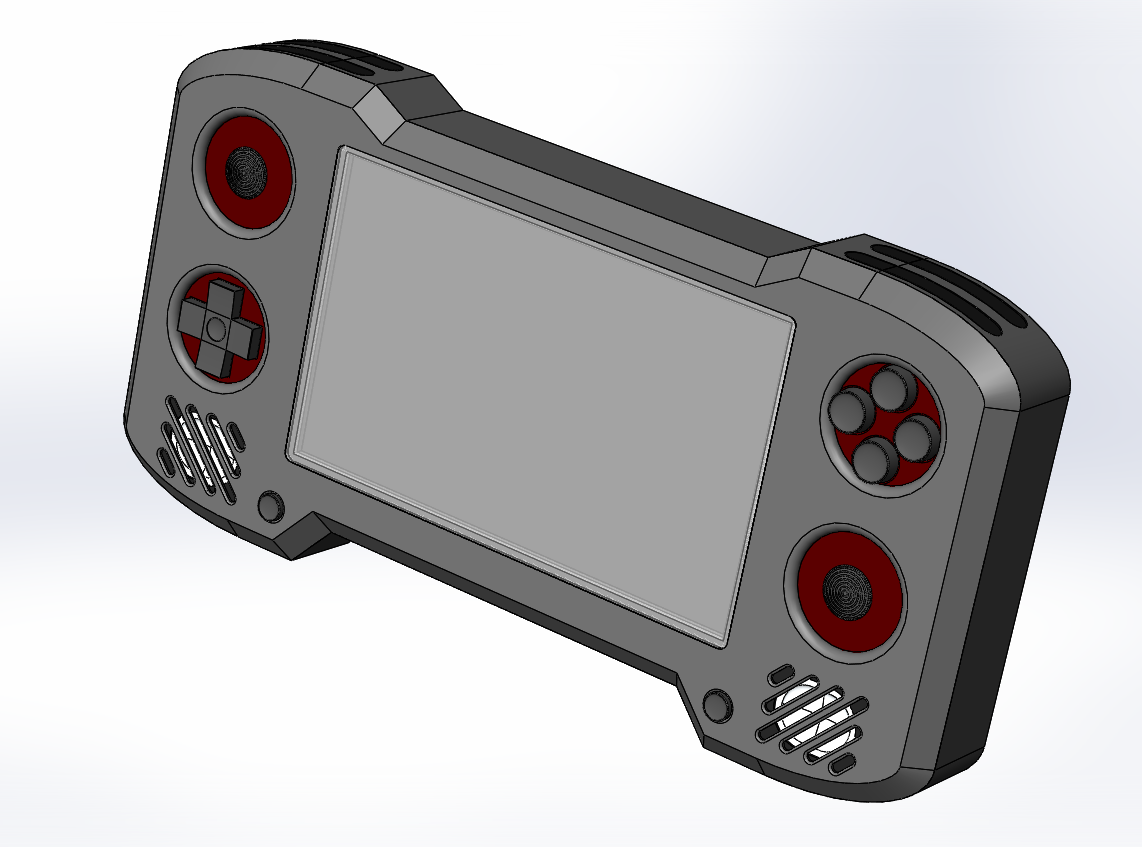

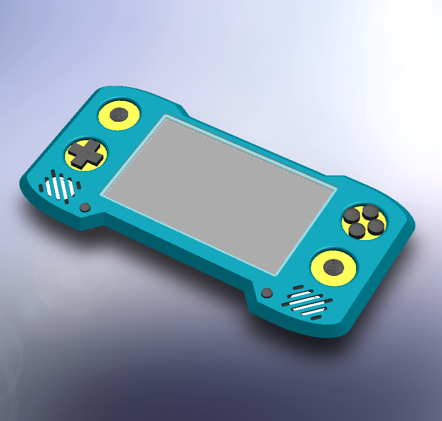

While my two GBZ builds are nearing completion, I began to play around with the next project: Making a portable from scratch based around the potent Orange Pi PC! Because of the size I need to CAD up a new housing, and to support dual analog sticks for N64/PSX etc. I thus decided to go whole hog and put my design skills and training to work. I've gone through several iterations of ergonomic revisions and am very pleased with...the front.

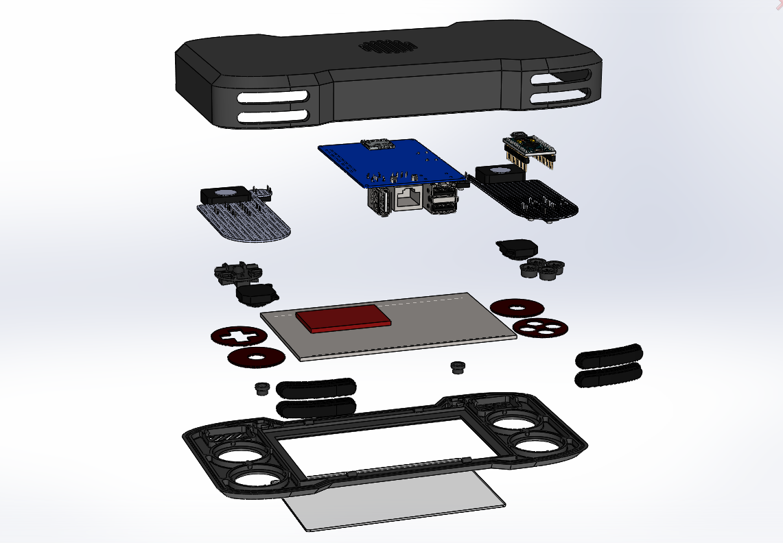

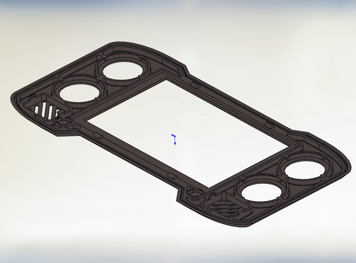

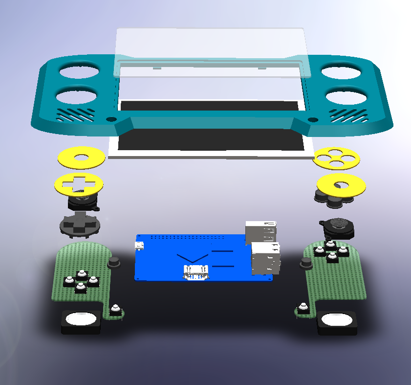

So I went ahead and organized the components with mounting bosses, clips and supports
Final Sketch
WIP Assembly
WIP Exploded View (With Orange Pi PC modeled)
RetroBro-Exploded Teaser.png (227.79 KiB) Viewed 19930 times
The back of the shell needs more work, but I have enough to get started!

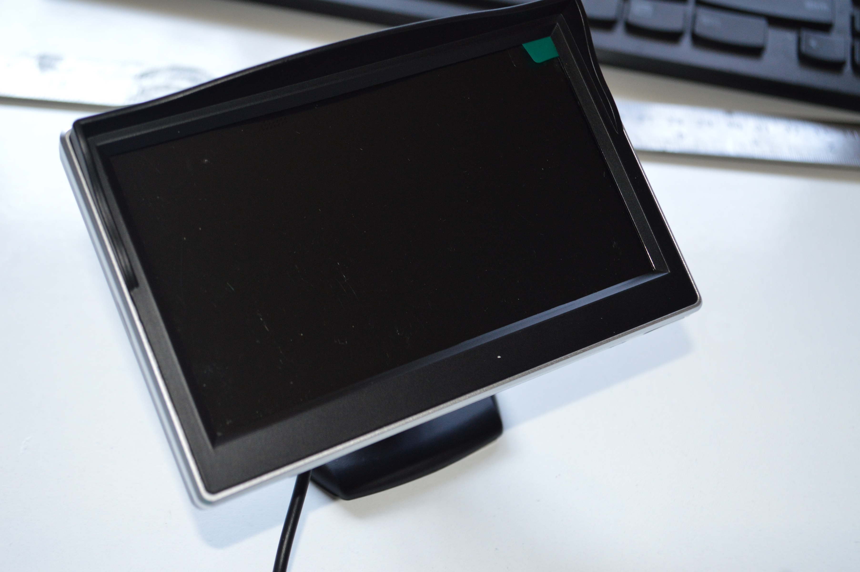

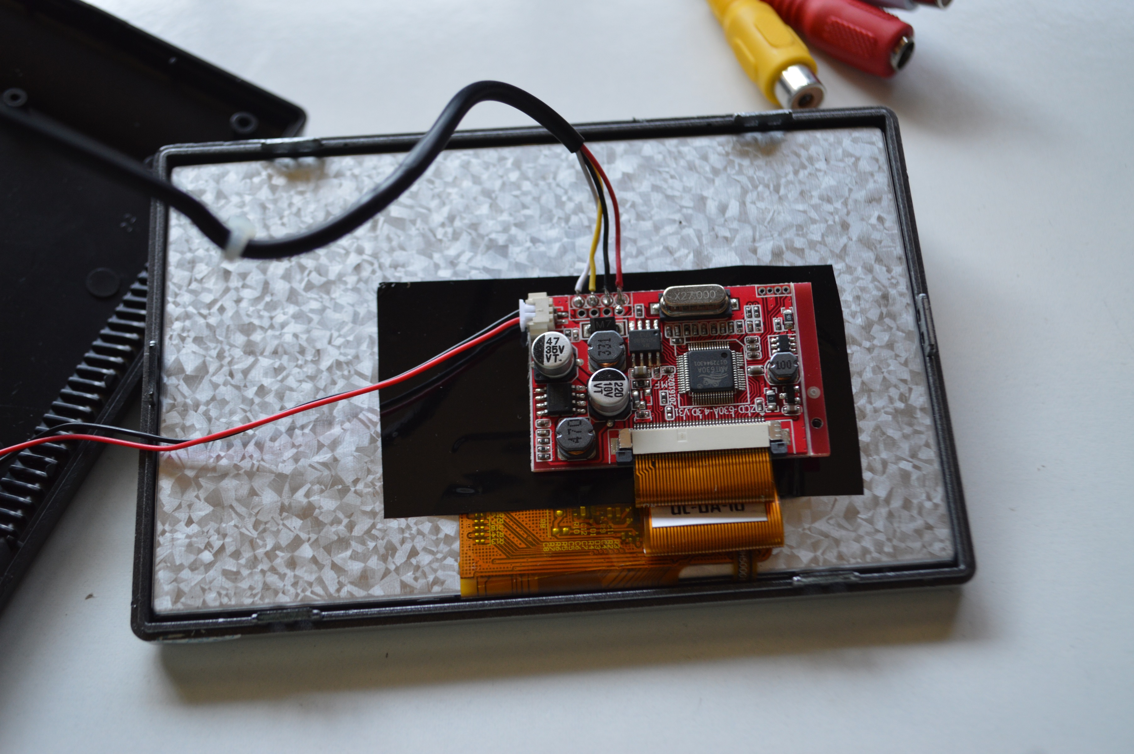

I based my design around a bigger screen to make for the most appealing interface and efficient use of space and settled on this 5", 800x480 resolution screen. Without being able to find the true dimensions I guessed and when it arrived I found I was only .5mm off!
I was also pleasantly surprised that the controller board is absolutely tiny.

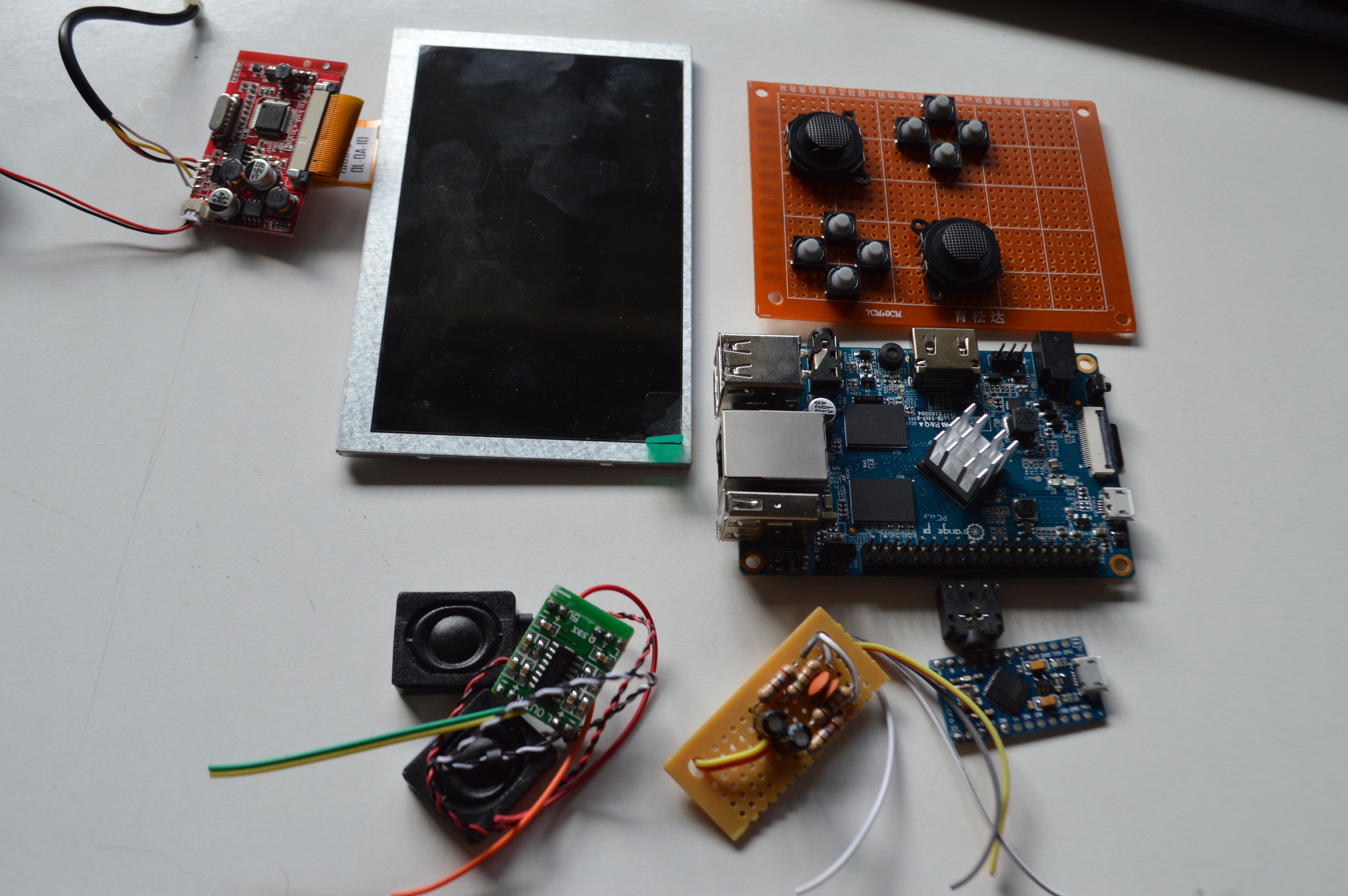

So far I have collected the screen, some wonderfully soft silicone tactile switches, two PSP analog sticks (will be replacing the tiny nub caps), speakers from a portable DVD player, stereo amplifier, DIY stereo low-pass filter, and the Pi.
I still don't know how I'm going to power this thing, but I'll be experimenting with a couple different pass-through chargers...highest I've found is 3A. Should be a fun ride and I look forward to any and all suggestions!

Nice to see a distinctively non-Nintendo take. Yet it still looks like an early 90's handheld. Very cool.
But.
The teal/yellow colour scheme... I hope that's just for the render? :?

Haha, yeah; it's my default while modeling for ease of viewing. I originally wanted to cut this out of a beautiful slab of purpleheart wood and those yellow bezels would be brass...But I got carried away with the details...

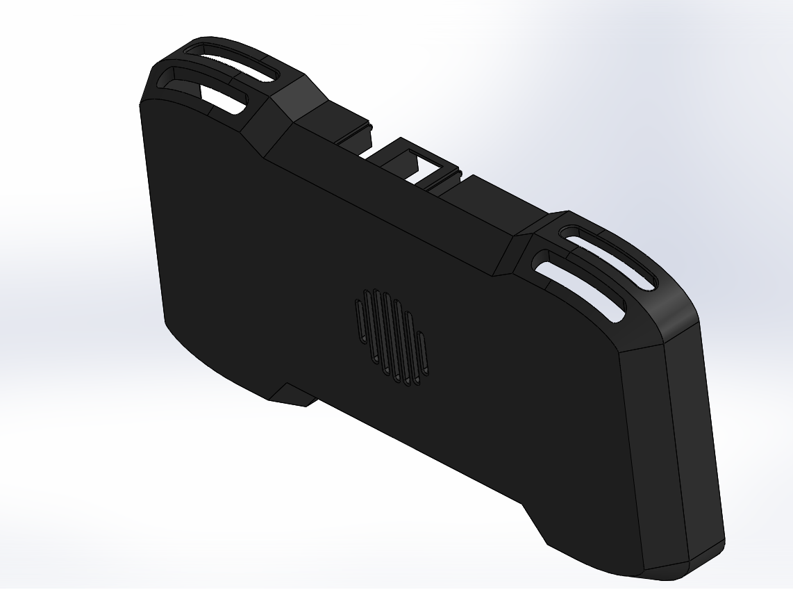

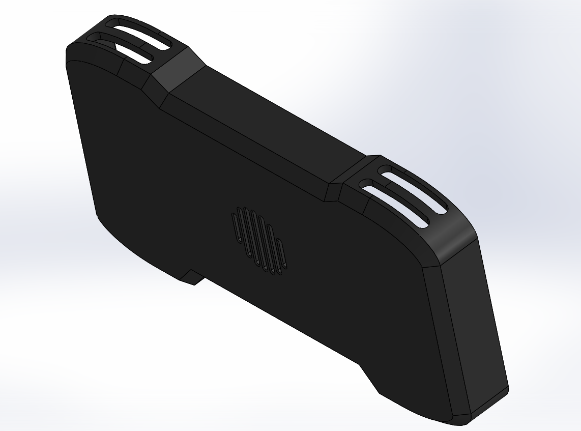

This is where I'm at with the back...Still pretty chunky but I like the chamfer for L2/R2

So I didn't like the bulkiness of the first back panel. Experimenting with a few more revisions, but I found a miscalculation in the depth I would need to I was able to chop 20 mm off without issue. I like the chamfer better, but it's still a bit too blocky...but it's a good starting point. I also started building the components (arduino) to figure out placement and mounting bosses/structural ridges and toyed with mounts to secure the Pi PC's USB and ethernet ports. Ideally some of these would be removed/relocated but I'm hesitant to risk desoldering them.

Just thinking about the positioning of the left joystick and D-pad. What systems do you plan on playing mostly? Most retrogames only support the D-pad. Even for the PS1, there are just a few games that use the joysticks. I would put what you think would be used more in the top circular area of the left side.

I bought a dirt cheap Anet A8 and have a long list of upgrades and modifications. I got it mainly for the price and the relatively huge print area (220x220x240mm) which is 10mm wider than my shell, so I can do it all at once.
This is the exact screen I purchased. After scouring eBay and Aliexpress, it was the cheapest 5" screen with that resolution. It works great and I love how tiny the controller board is.
Word of warning; this one took over a month to get to me here in the US. Also, the OPi PC doesn't have pads to solder A/V wires to, so I had to use a workaround using the 3.5 mm jack and a Nokia CA 75U video cable and add a bit of boot code to the micro SD.
Alternatively; you could use the HDMI port, but I wanted to leave that accessible in case I want to plug it into a separate monitor.
