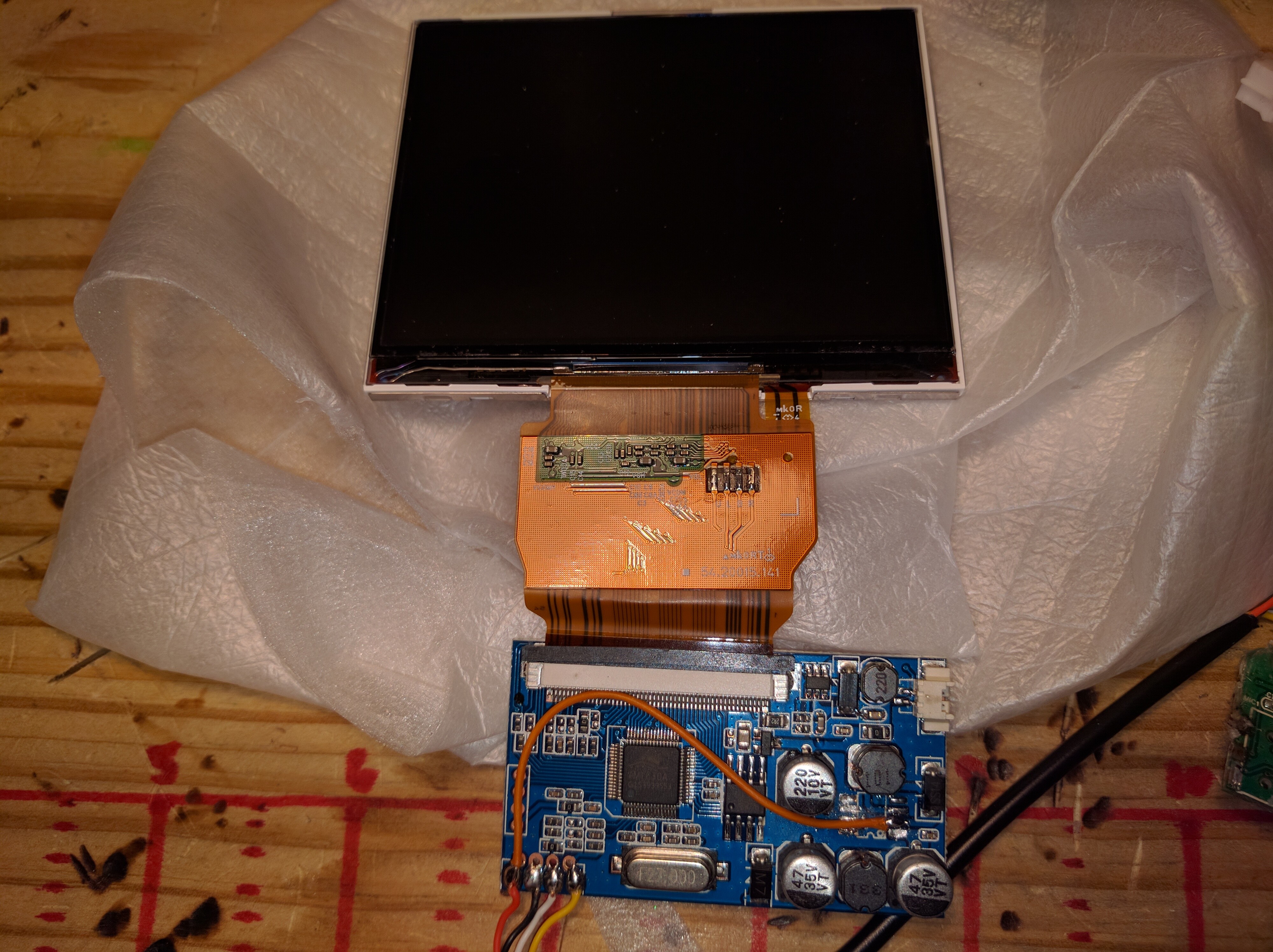

Here my screen :
- Shop : Amazon.de
- Seller : EPATHDIRECT
- Brand : ePathChina
Should I do any modification on the PCB, or can I solder directly the red/black/white & yellow like on the Pi0 in the tuto #3 ?
Thank you very much... :)
Hi there, take a look at the wiki, you can find your answer there :)

Yes, i do and i wrote this tutorial. So yes, it works with those modifications, at least on mine :D

Could you visit my help topic here http://www.sudomod.com/forum/viewtopic.php?p=3812#p3812 please ? I have a black screen and I don't know why... My solders aren't beautiful but I tested all the connections with a multimeter and it should work !

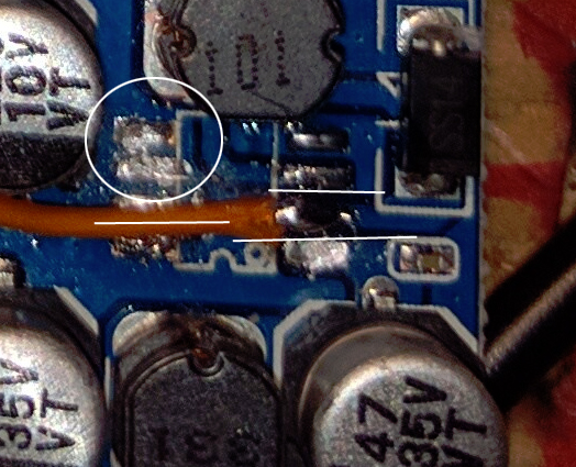

I tried this and could not get it to run off 5v.

dirtybeagles wrote:I tried this and could not get it to run off 5v.
check to make sure none of the contact points are touching each other where you removed the regulator. it looks like 2 points may be touching. opposite row where the orange wire is connected.

dirtybeagles wrote:hmm, ok. I thought they were all ground connections. Let me check it out.
not sure if thats whats causing it to not work, but i would try wicking off all the solder in that area with a braid, and then just soldering the orange wire back
