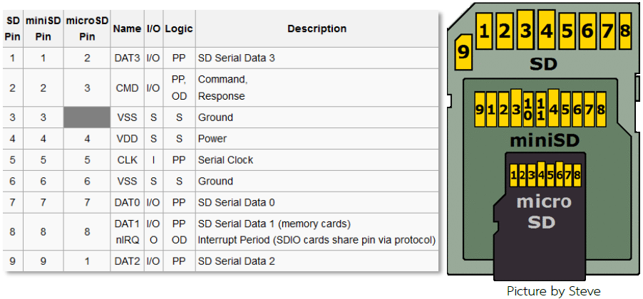

Hi guys we all know the amazing work of @wermy (honor to chief) adapting the SD adapter to original GB cartridge.
The principale question that is making me mad is "which pads of the SD adapter must be connected to the cartridge board?" since there are 9 pads behind the SD adapter bit in the wiki i sede only 8 connection to the cartridge.
Any help would be apreciated. :geek:

Hi,
There are two ground pins on the full-size SD -- I only connected 1 of them, so that's the missing wire. :)
A table of which pads go to which SD pin can be found here:
http://hackers.gallery/841/misc/raspber ... ad-probing
This might help:

Kitsch-bent also provides this image which i think should help.

Just because i'm using as guide the image posted by the chief in the wiki (i'm a bit profane to all this technicism) i must NOT connected the pad number 3 of the SD adapter?
Thanks :roll:

CicciOPiK wrote:Just because i'm using as guide the image posted by the chief in the wiki (i'm a bit profane to all this technicism) i must NOT connected the pad number 3 of the SD adapter?
Thanks :roll:
Either ground pad can be used or both it makes no difference as long as 1 GND is used.

Okok but I must want to know in the picture of the wiki(the first one where is the cartridge splitted) which pads from the top(normal edge) to the bottom are used so i can do it simply looking at that XD. Sry for Bering so rude :oops:
