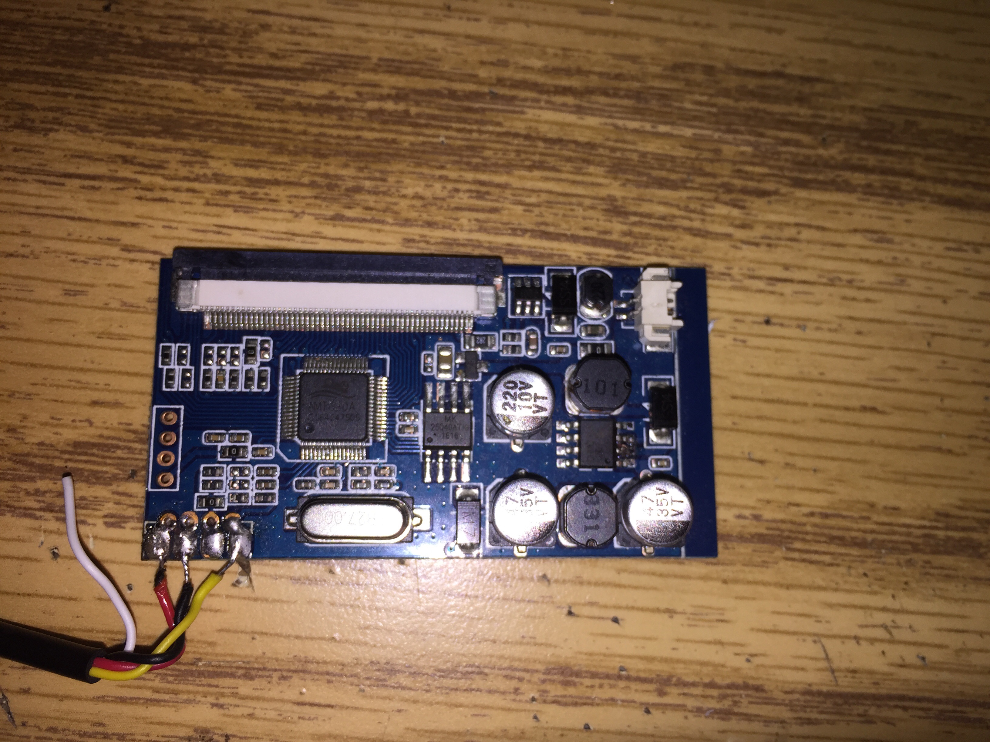

Hello Everyone. I'm trying to convert my BW board. I've looked around on the forums and haven't really found anything on this board. Also, without converting and using powerboost 1000c, I just get a black screen.

Thanks much for the reply, I tried that a few times, but every time it seems to "overdraw/overheat" the power boost. Any ideas?

Please post some pictures of the connection to the powerboost.
It seems something is wrong there. Like a shorted joint.

Just used one of these variant 7 screens with powerboost fine yesterday.
Tried with the voltage booster in place then removed it. Both methods work fine.
Be sure to link the 5v pin on the booster to power.
Side note powerboost shows low battery with screen and overclocked zero running off lipo.
No overclock runs fine.
