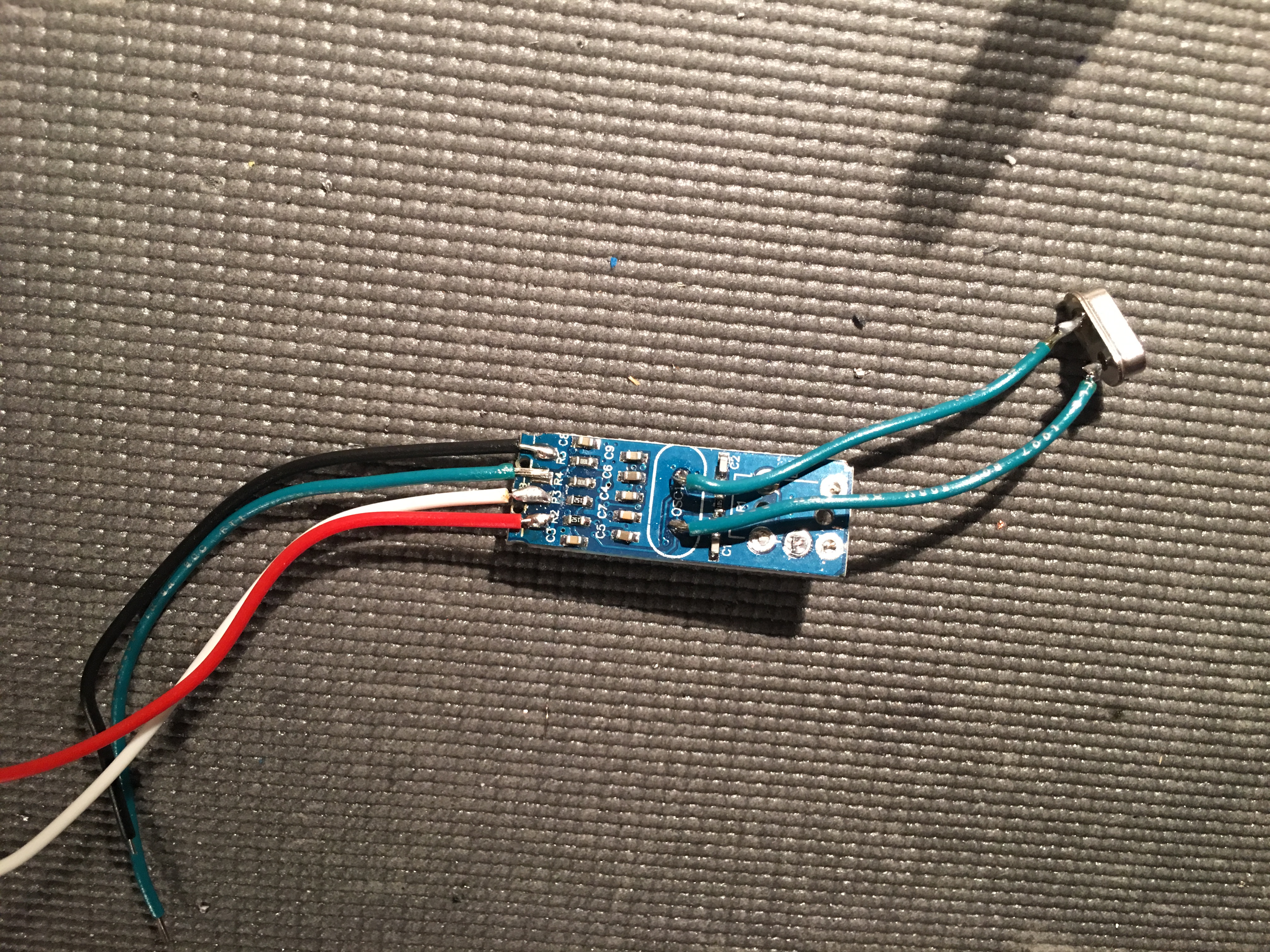

My guess is that you fried your crystal or damaged some components on the board. If it was just the crystal you can get the for cheap of the internet. You send a picture or the card closeup :p

Re: Troubleshooting USB sound card issue
Post by rednakes » Fri Jul 21, 2017 12:01 pm
Adim01 wrote:
Fri Jul 21, 2017 11:57 am
This is what I had before I attached it to the tin (see pic).

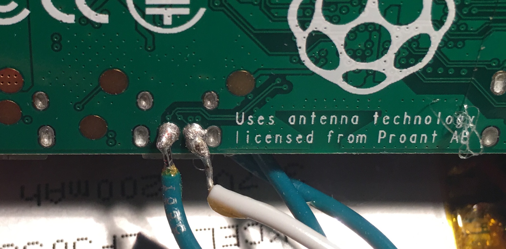

Also I wired the USB green and white here:
EDIT: Actually, now that I look at this picture, it looks like I have shorted the white wire with the hole on its right. Confirmed with multimeter.

Post by rednakes » Fri Jul 21, 2017 12:12 pm
Bingo, that was the problem. It was a short ;-(
