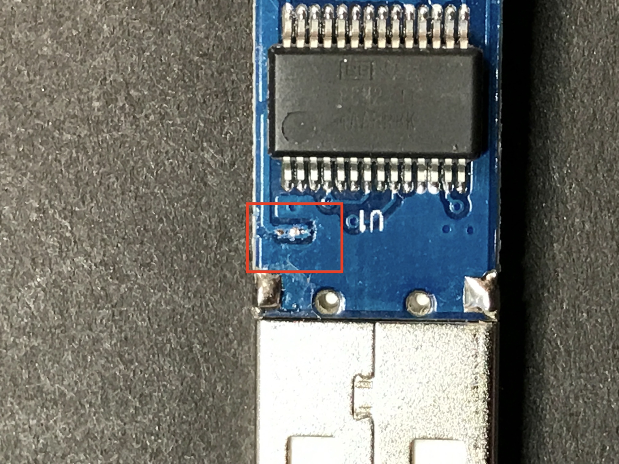

Post by Dukana » Sat Jul 22, 2017 4:27 pm
Is there any chance I can recover from this mistake, or should I just get a new one off ebay?

Post by wermy » Sat Jul 22, 2017 5:16 pm
This is just from a quick look with a multimeter, but it looks like if you flip it over, you can scratch off a bit of the PCB coating and connect the wire to this spot in stead. It seems to just connect straight through the board to the pad you ripped off.

Post by Dukana » Sat Jul 22, 2017 6:33 pm
Success! Just tested the end of the wire and it looks like it's working good. :D :D :D

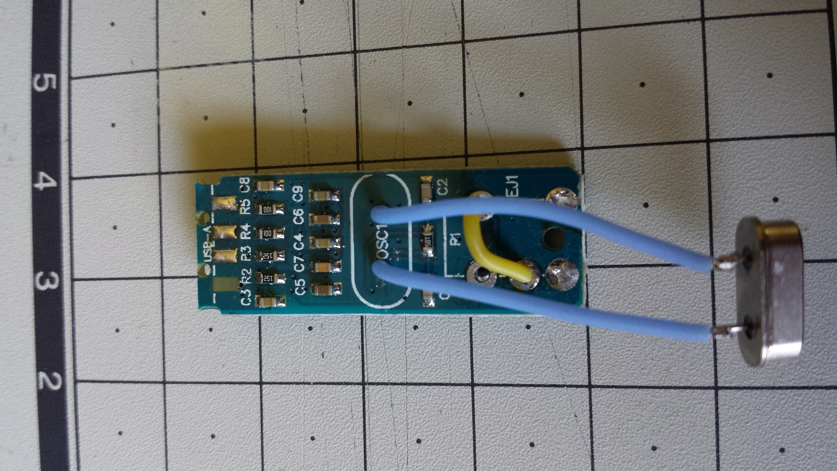

Post by Orangebuster » Sat Jul 22, 2017 9:09 pm
I just ripped off the one next to that one (data minus?) Do you think you could help me find another trace?

Post by HoolyHoo » Sun Jul 23, 2017 6:39 am
You can use the top part of the R4 resistor. That connects directly to the second pad you mentioned.

Post by Robochris » Sun Jul 23, 2017 6:12 pm
I pulled both data lines off.. 😖
.. top of resistor.. as in lettering upright?

Post by HoolyHoo » Sun Jul 23, 2017 6:26 pm
Top when looking at it in OP post photo. Yes lettering. R5 is the other data line by the way. Also the top.

Post by Robochris » Sun Jul 23, 2017 7:02 pm
Great! Thanks. I've ordered others but there's still hope for this one!
