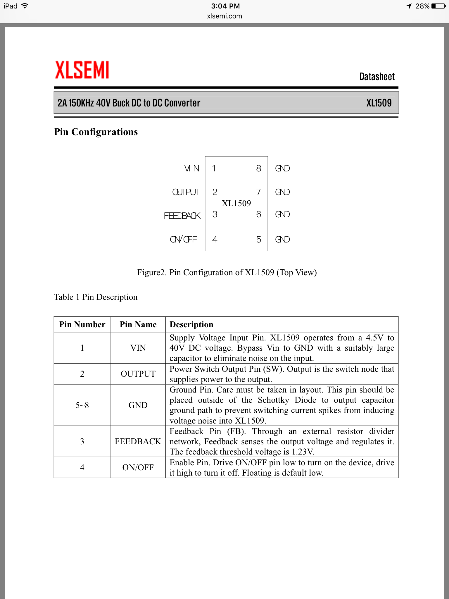

Your board looks like its using XL1509, the same dc regulator as mine.
Look for the chip circled here
Desolder the positive red wire and directly connect it to PIN 2 of XL1509 chip. After this you can connect a 5v power but NOT 12v.
If you're not sure which one is the pin2, use a multimeter to check for 5v output voltage from each pin of XL1509.
Tried that. the screen blinks ones after that nothing happends
