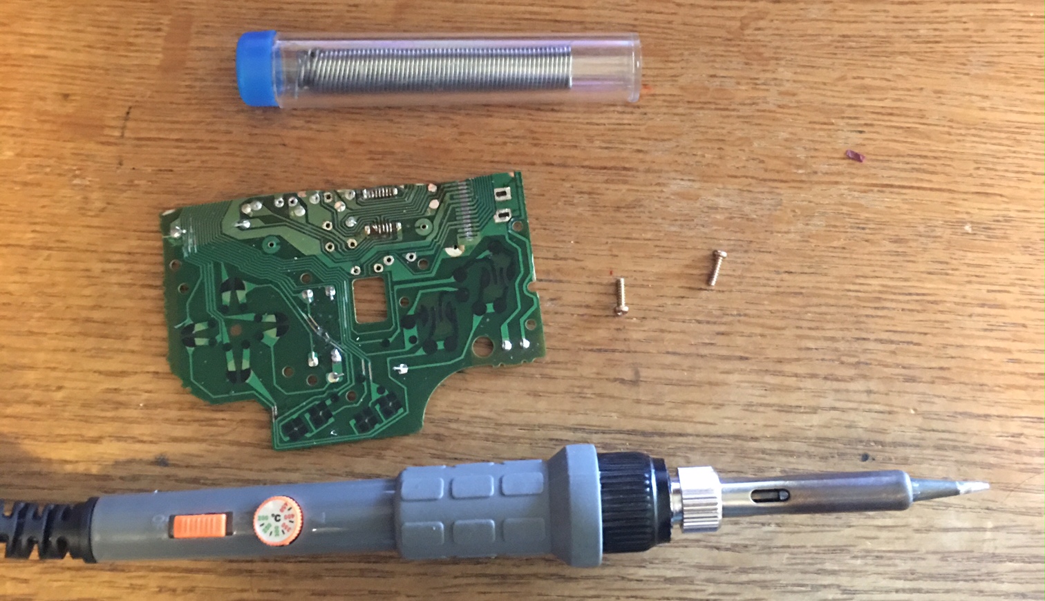

60W 110V soldering iron. But it has a little temperature dial on it and I usually keep it at about 400°C. But it's a sorta cheap soldering iron, so I wouldn't be surprised at all if those temps were inaccurate.
I'm using the solder that came with the soldering iron, so I'm not sure what kind it is. I looked at the product's page that I bought it from and it says the diameter is 1mm and the melting point of the solder is 183°C.
Soldering Iron & Board.jpg (428.58 KiB) Viewed 9517 times

Okay, well your sodering iron seems to be o.k , but the tip can be alot smaller (usually such irons are coming with alot of extra tips right?)
If so you could use the hoof shaped tip, and 400c is a little bit hot, maybe you burn up the flowing materials inside the core of the solder wire.
Make sure where you have to solder is clean, you can also use a glassfiber pen, that's like a little brush and you can scrape the pcb blank and clean to bare copper wich makes it alot easyer in certain cases.
However, i like how you try to make the button pcb from a dmg pcb, (i think that's what you are doing, correct me if i'm wrong)
But i would advice to get a nice common ground button pcb on ebay, they go for like 10-15 bucks.. saves alot of work.
Anyway good luck.
