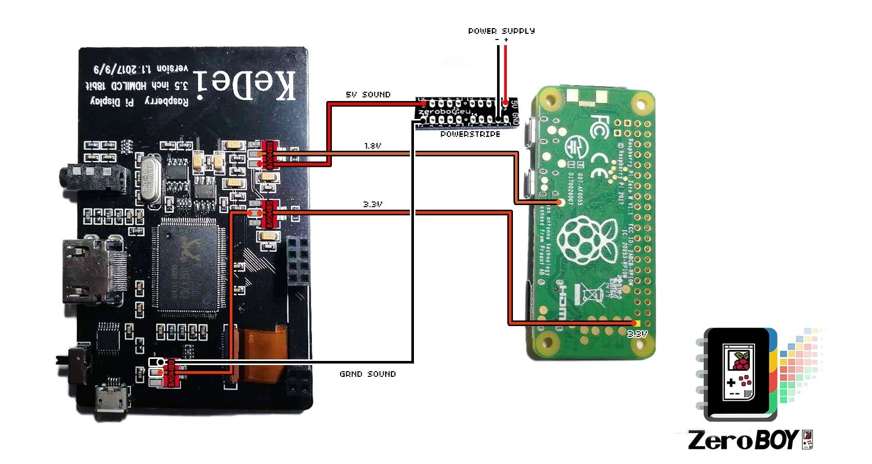

ZeroBOYmod wrote:
Thu Jun 07, 2018 9:52 pm
There is also a diagram on the new RTFM (should be finished the next month and translated until August) section, which illustrates the "power-saving mode". I have attached a picture
description from one of our members, you know him here with the name floppes:
"We usually supply the display with 5V. The display shows inefficient linear regulators to produce 3.3V and 1.8V. You can remove the voltage regulator and pick up the required voltages directly on the Pi. In my test setup, I was able to reduce the consumption of the display from 1.955 W to 0.95 W. This extends the battery life and reduces the heat in the case. The only downside is just two more cables from the Pi to the display. The 5V to the display will continue to be needed for the soud."
IMPORTANT: The 3 linear regulators (red marking with inscription "REMOVE") must be removed, otherwise there will be nasty short circuit!
Awesome! I'm using a RP3 so where can I find a 1.8V output on my board?

1emerson1 wrote:
Sat Jun 09, 2018 5:56 pm
Hi,
according to the list on: https://www.raspberrypi.org/forums/view ... 13#p628505,
it has to be PP9 1V8 and PP8 3V3.
But this can be outdated documentation, so please check with a multimeter between PP9 and GND, if this is a stable 1,8V and between PP8 and GND - stable 3,3V - BEFORE connecting the display. If you are unsure, ask me or other members before burning your board, we will help you.
