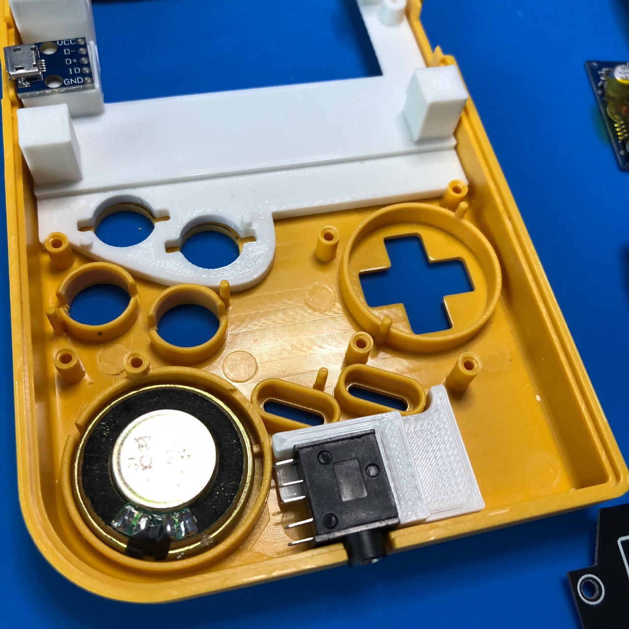

Hey guys! here are a few parts i have made to help with building your gameboy zero.
Audio bracket, hold headphone jack and amp. Also allows for you to hide your wires underneath through the tunnels to make it look much cleaner. Only works for one channel, however. I do all my builds with mono sound so this is how i designed it.
The audio bracket is meant to be printed without supports, except for the little tabs that hold the amp. If you have s3d as a slicer, I'd recommend doing manual support. Delete all the support under the tunnels, and just leave the support in the tabs. If you are using a slicer without manual support, you will just have to have it turned on everywhere.
If anyone would like one but doesn't have a printer, you can try a local 3d hub or library with 3d printer. Or, I can print one for you for 5$ plus shipping if you'd like. Not really trying to sell it, thats why I'm offering the files for free. But if you don't have a printer, and would like to throw a few bucks my way as a thank you, then I wouldn't mind printing one for you haha I'm sharing the file for personal use and to print for your friends. Please do not sell commercially, or mass produce for resell
Audio bracketShow

Yeah when I started I think the only third party items for sale were helder common ground boards haha things have certainly been developing and there are a lot of great guys around here to thank for the hard work.
Let me know how the audio goes if you try it out! I tested alignment but I've never actually wired anything up so not sure if the wires can all fit.
Also, the little pegs for the audio amp, probably have to be shaved a little bit to allow the amp to slide in and still retain some pressure. Will need supports

Modified this a little bit for the jack that I use so I figured I'd share.
Audio Bracket.stl
(21.76 KiB) Downloaded 486 times
I use PJ325 which is a little wider. I also removed the area for the amp since I normally don't use one.

I've made a really quick and dirtry mod of Eric's audio bracket to use with the following jacket:
https://de.aliexpress.com/item/10PCS-L- ... 4c4du2CXod
Maybe it's usefull for someone....
Audio.stl
(63.85 KiB) Downloaded 385 times
