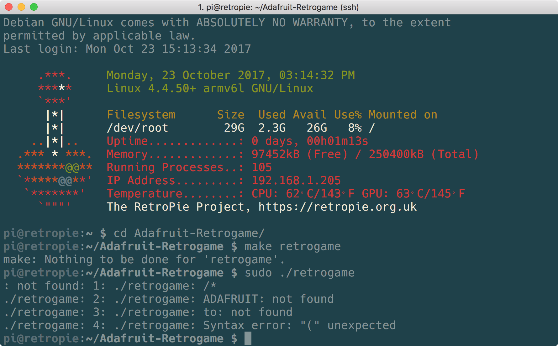

Ok got keyboard hooked up and wifi connected. Copied retrogame to /home/pi/Adafruit-Retrogame and ran the following
make retrogame
Got the following:
make: Nothing to be done for 'retrogame'.
I'm getting a syntax error with the following:
sudo ./retrogame
Any ideas?
Screen Shot 2017-10-23 at 3.16.24 PM.png (336.25 KiB) Viewed 7712 times
Edit:
Looks like i needed to save the original file as retrogame.c then when you run make retrogame it makes the executable.

try this i only use this method
cd
curl -O https://raw.githubusercontent.com/adafr ... trogame.sh
sudo bash retrogame.sh
https://learn.adafruit.com/retro-gaming ... s-software

Thanks @Codemaster123 but it looks like i have it working. So I'm gonna roll with it for now. If anything screws up I'll try the method you listed.
Holy cow, i'm so happy to get past this hurdle. Now onto hooking up battery, power switch, and audio!

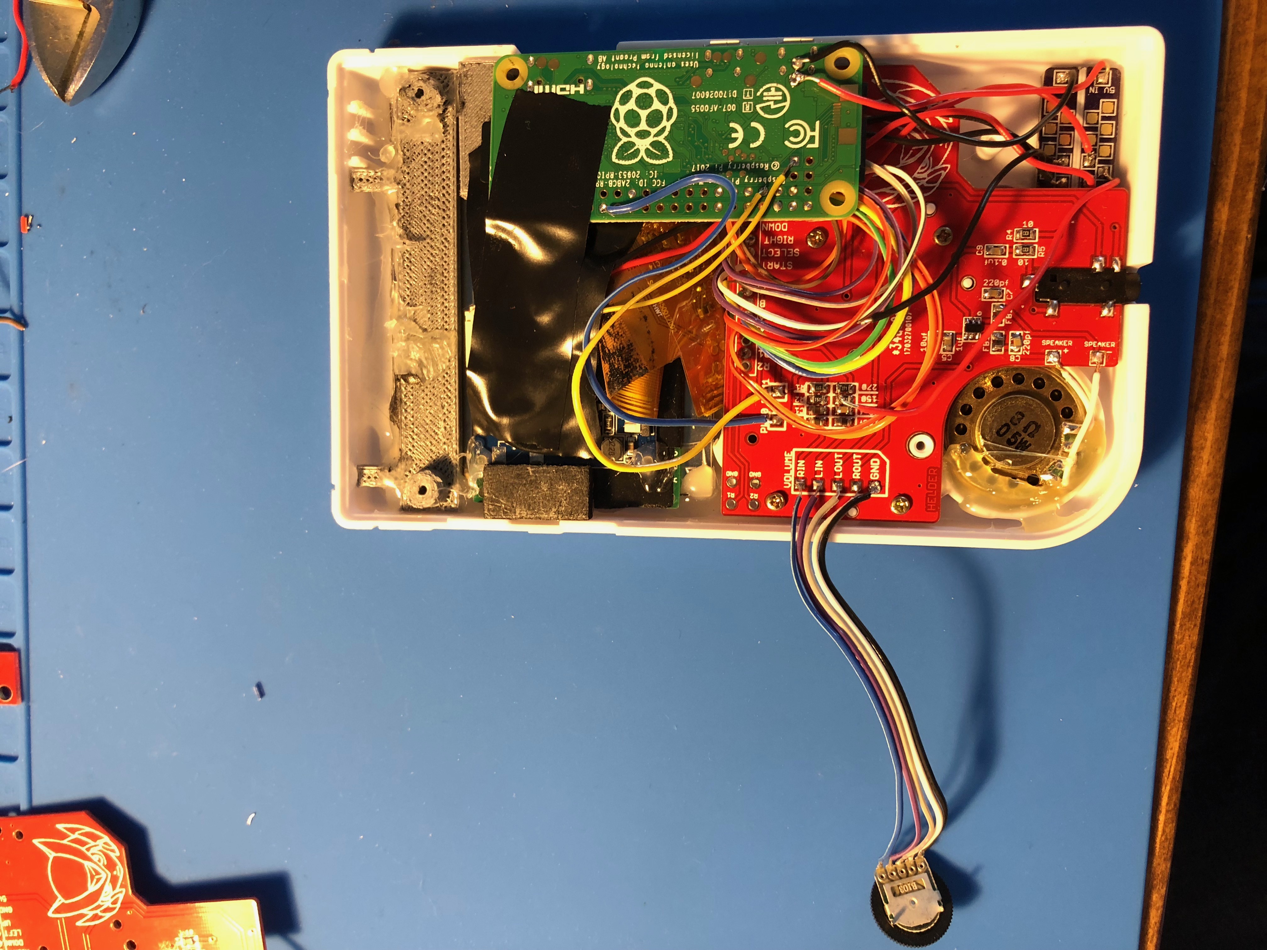

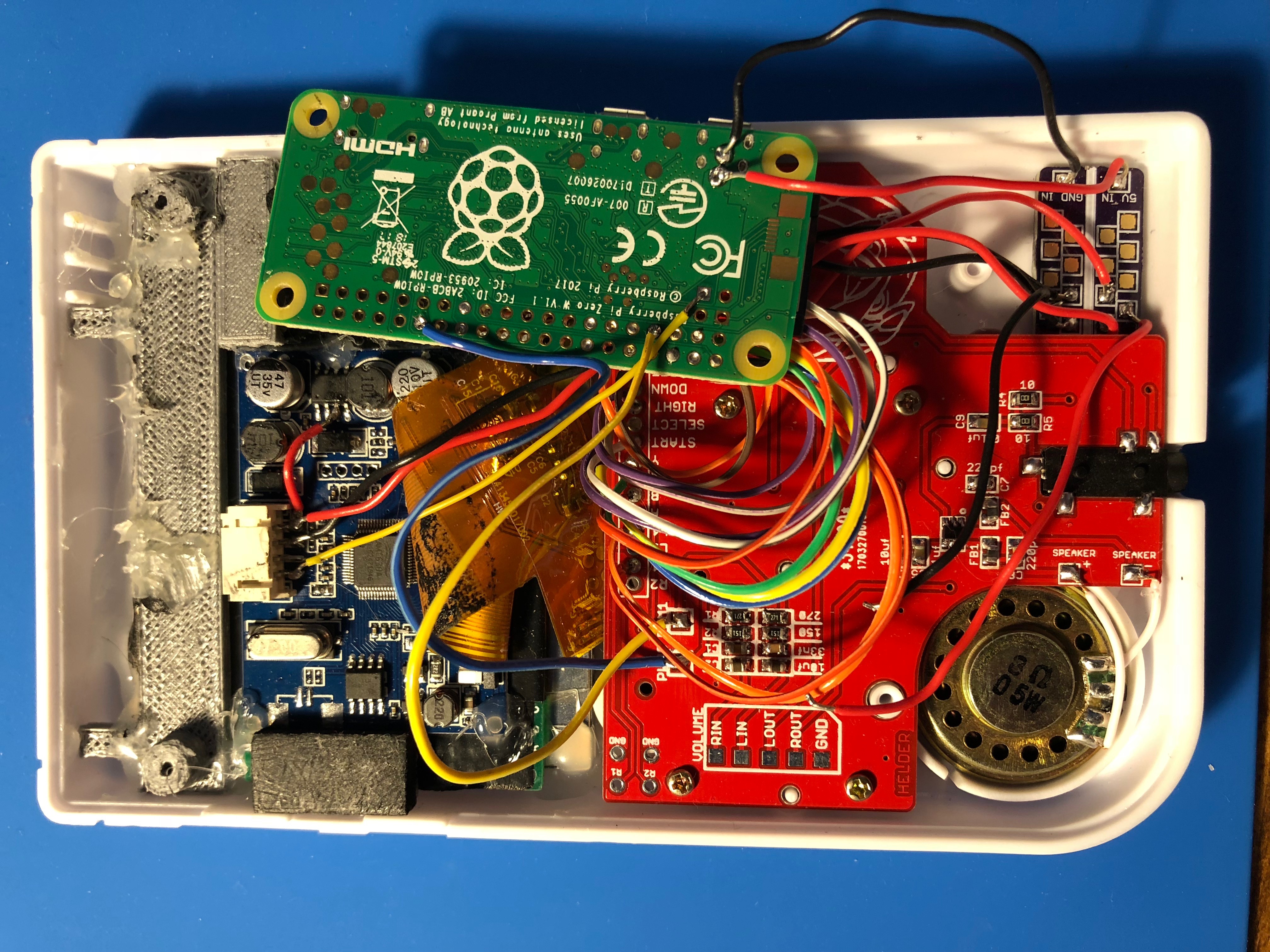

Buttons are working and I've moved onto wiring up the speakers. I followed this diagram:
I'm hearing noise in the speaker but not audio.
Re: So close to finished with my first build
Post by VeteranGamer » Tue Oct 24, 2017 12:31 pm
sixteenbit wrote:
Tue Oct 24, 2017 11:32 am
have you enable pwm audio in the config.txt
disable_audio_dither=1

Again, thanks VeteranGamer, that was it.
Once I get batter and power switch finished i'll be done!
