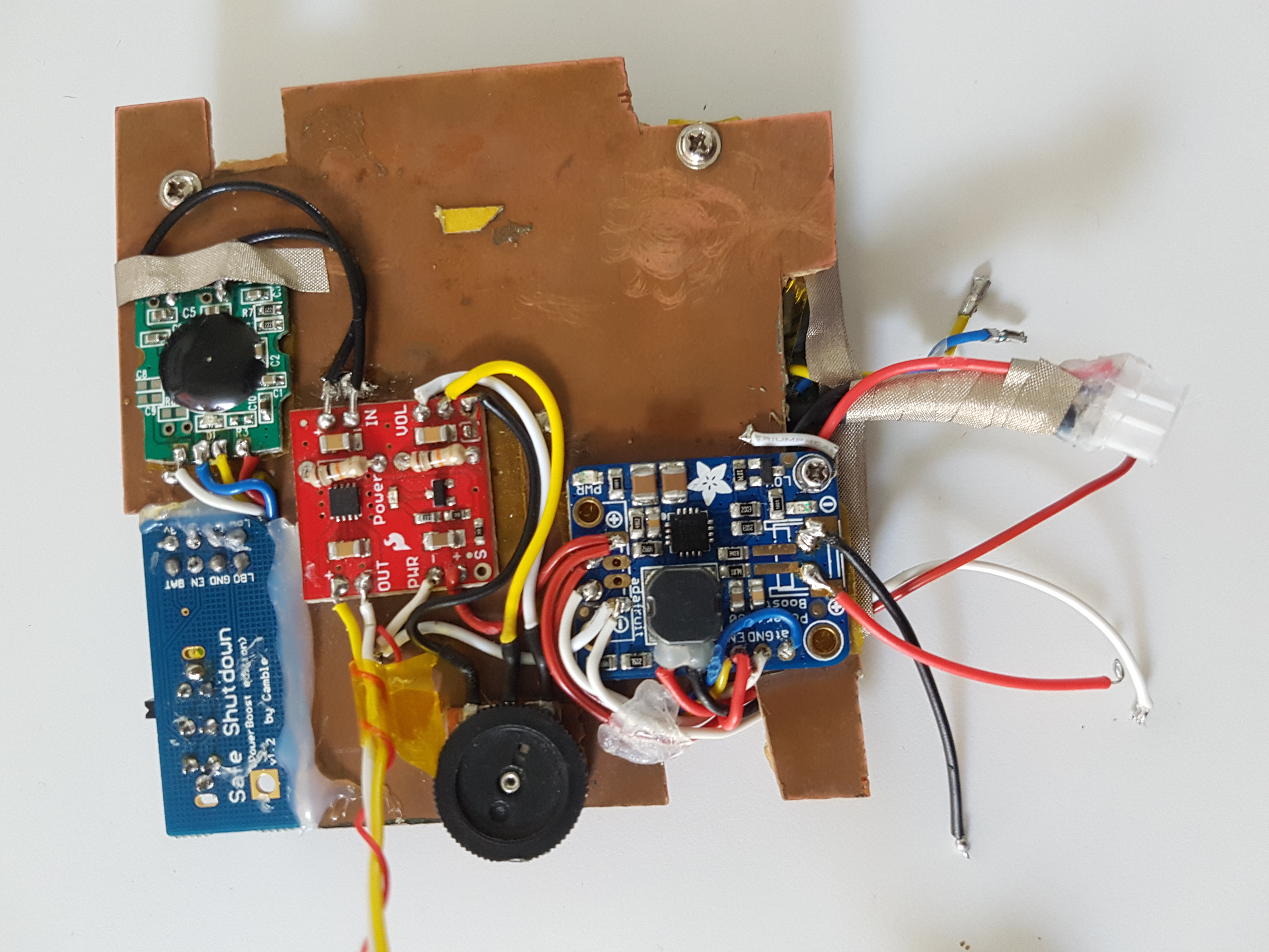

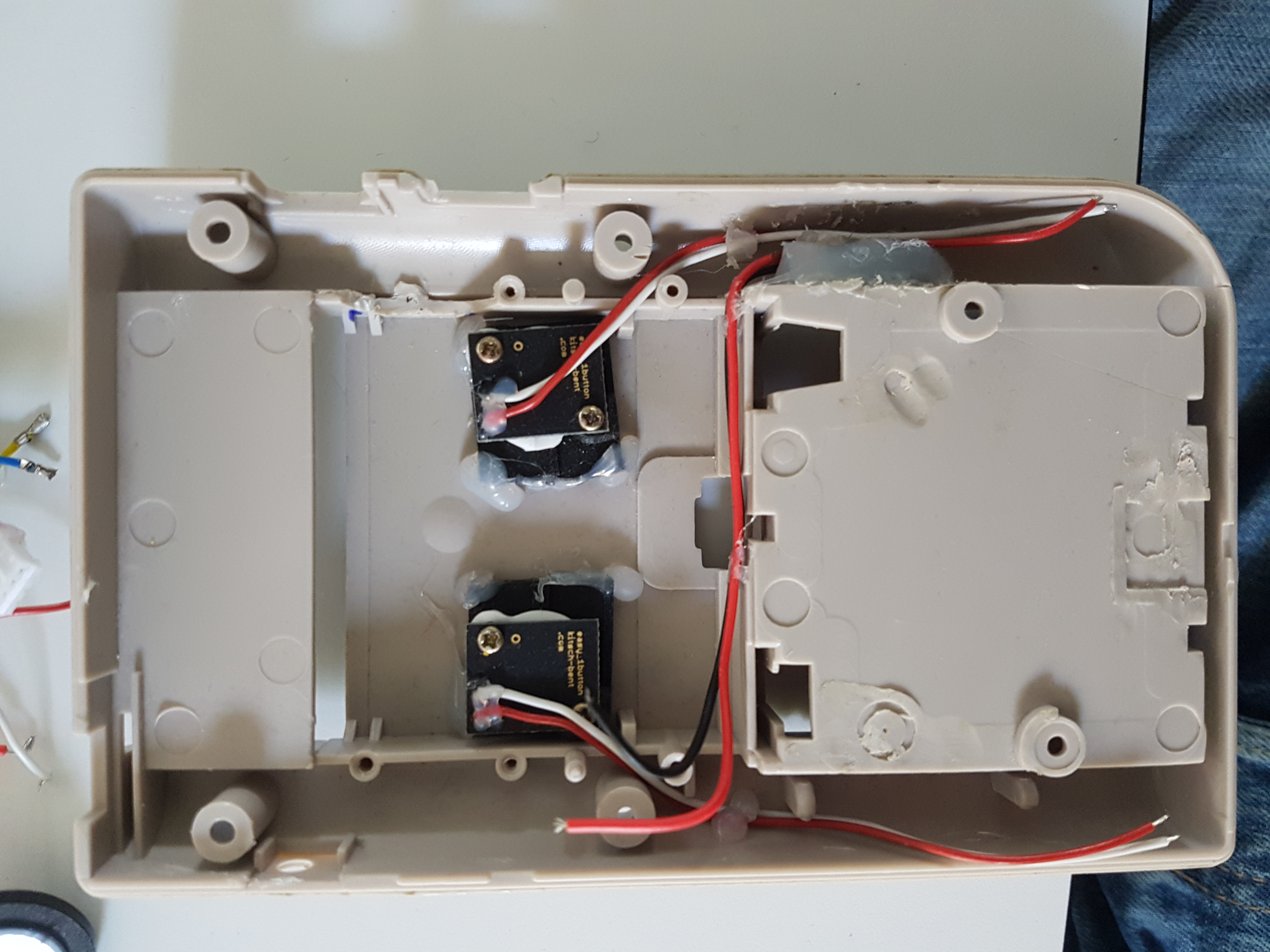

I do not have much time to summarize now but I already put some pictures because I arrive at the end.
I will complete the topic at the end of GBZ.
Thanks again to all.
#UPDATE 1
Like everyone else, I have power problems when I add the screen to the circuit.
I found on the internet, a tiny supercaps (I took one of 470mF and 1F):
I added it to powered the pi3 and now everything is perfect!

#UPDATE 1

Hello,
sorry, I do not know much about it but here is a link:
http://www.instructables.com/id/Lets-le ... actical-G/
I added that because I had freezes in Emulstation and since everything works perfectly.
there is still a slight problem is that the consumption has gone from ~ 1A to ~ 1.8A :-(
it leaves me an hour of games with a battery of 3700mAh
