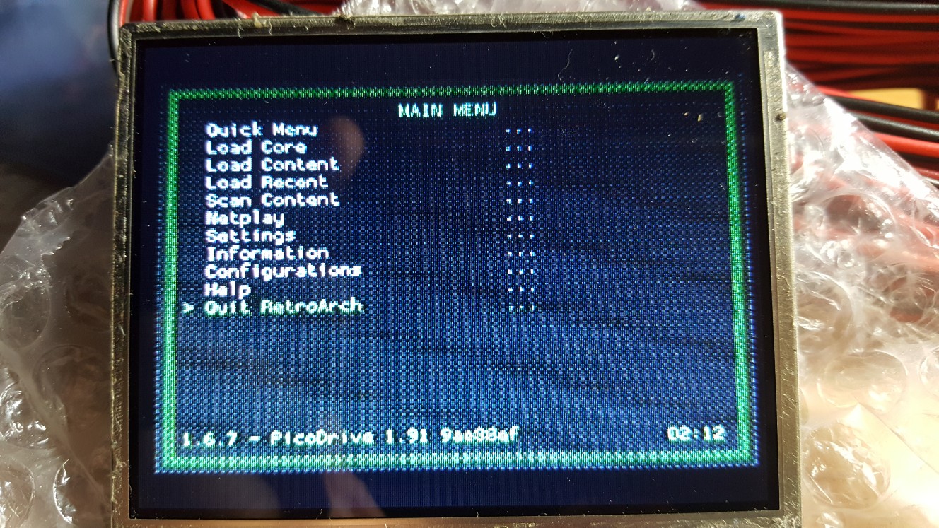

I am testing things and am noticing a pronounced rolling flicker or screen redrawing or tearing. Hard to describe. It goes in waves that slow, then speed up, then slow down again, etc.
All that is hooked up is the screen to pi0 and both connected to power strip connected to USB power port.
This screenshot seems to show it quite well. It's not just a product of the digital camera. :)
Is this normal with the BW screens and I just need to deal with it?

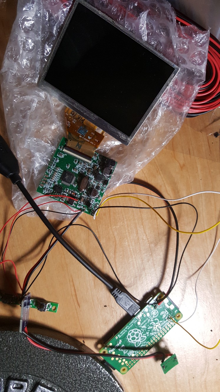

Can you post pics of how you soldered it to the pi.
Here ya go.

Post by vnman » Wed Nov 01, 2017 3:08 am
It has been said before, you only need ONE cable for composite, please remove (unsolder) the yellow wire. Only the wire that soldered to the "TV" on the pi is connected to one of the inputs of the driver board.
Also the interference could be due to "noisy" power supply and this leads to noise to the screen.
I was following a wiring diagram. I changed to one (tried each separately) and the interference is still there. Maybe when it's running thru the power boost it will clean up?
Is there any chance that using a thicker guage wire might help, for either the LCD power or signal?
I'm not sure what to do about a noisy power supply. I'm using an OEM Samsung USB adapter and a nice Anker cable. Or did you mean something else?
