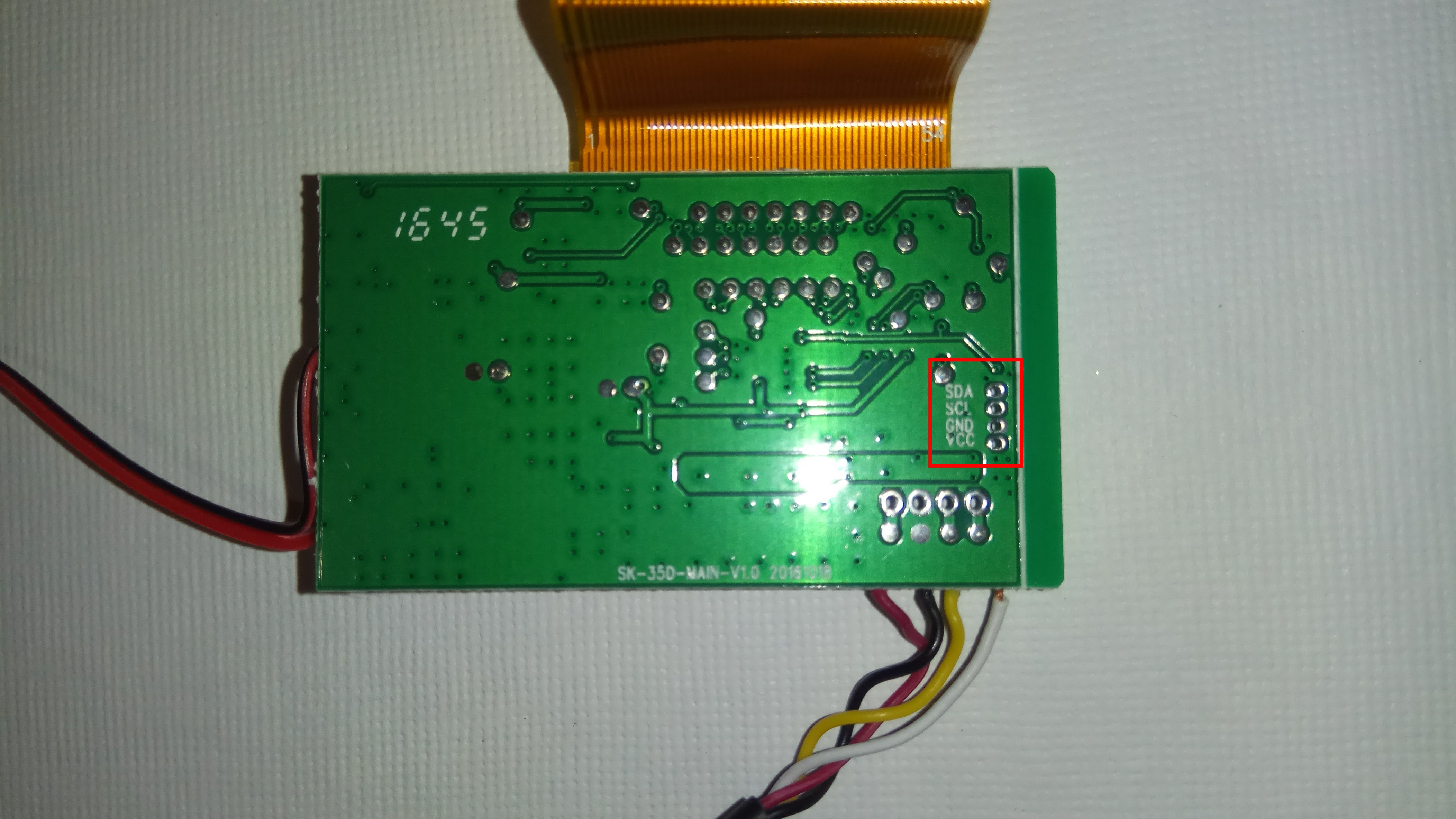

On the back of the board there are alternative points for VCC, GND, SCL and SDA similar to the red Ebay screen in the wiki that allows 5V there.
So, novice question... Can I route 5V power and ground to these VCC and GND points in a similar fashion? Is there any way to check that this may work? Any guidance would be appreciated.

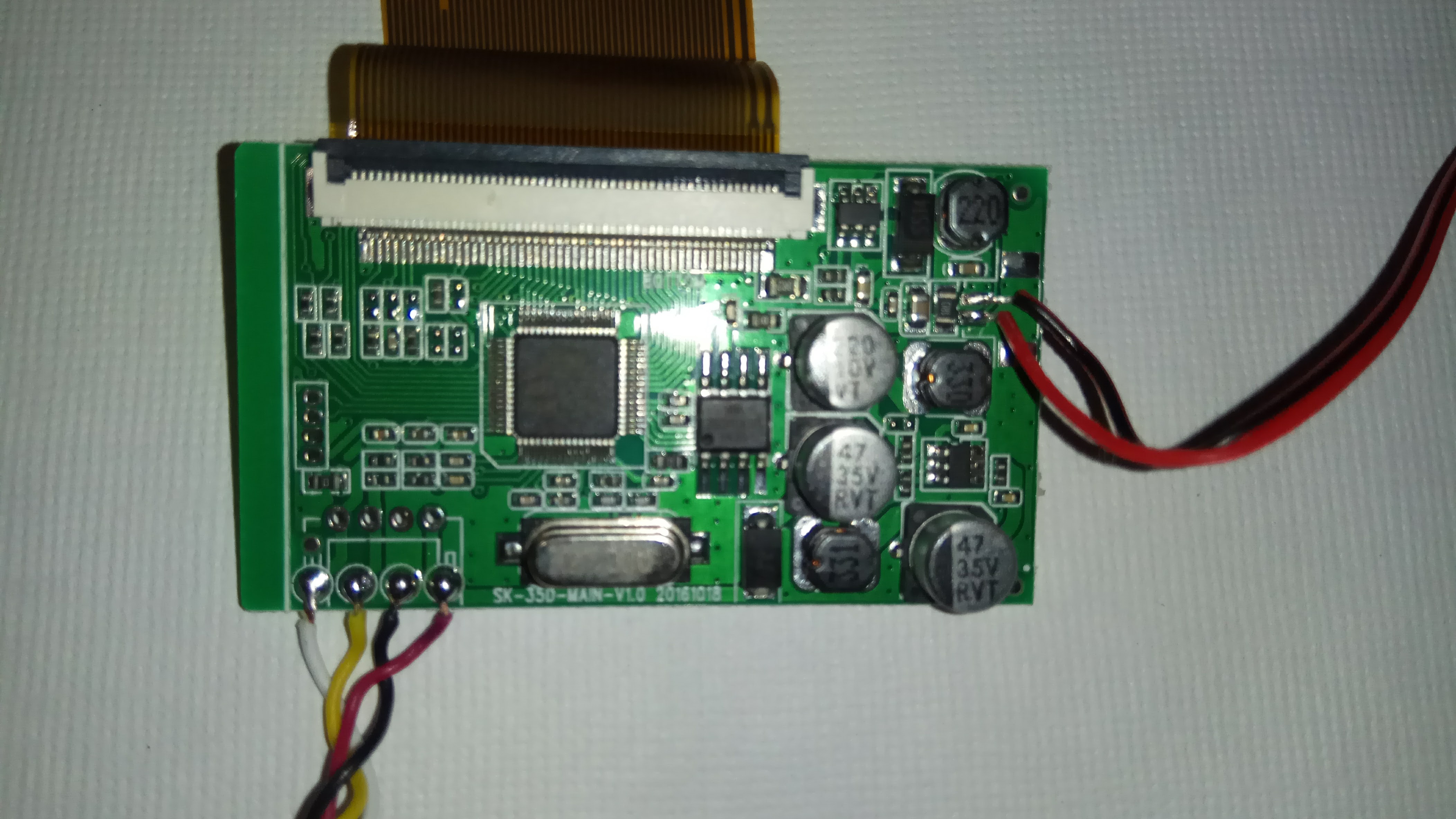

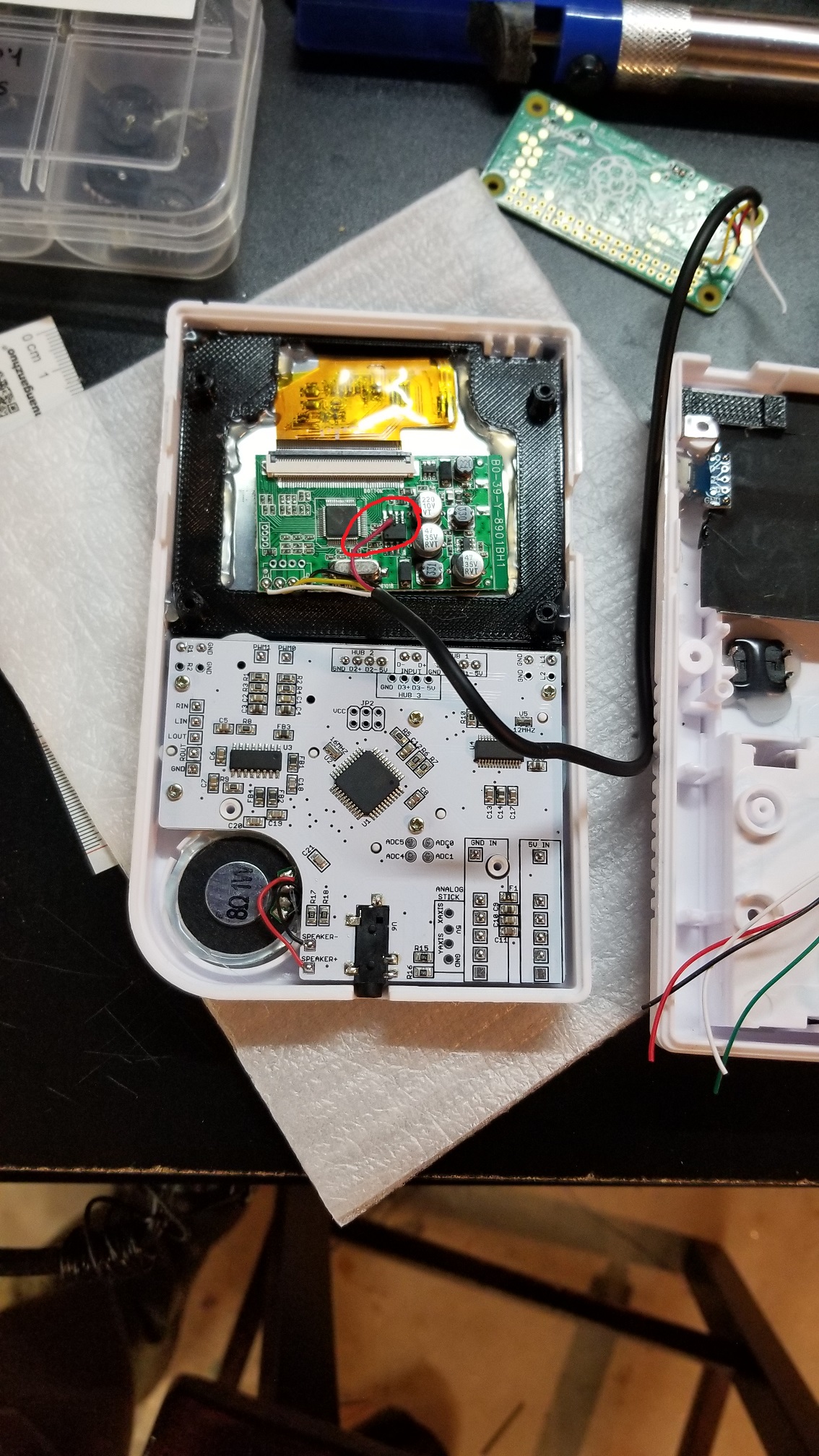

Looks similar to the last BW Screen I received, here is how I modified it to 5v, hope this helps .
GBZ BW Screen.jpg (751.87 KiB) Viewed 7670 times
Gus 8-)

Finally got around to testing this with a multimeter. There's continuity between the alt VCC point and the relevant pins of the IC's used in both 5v mods described in this thread. Wiring power directly to that point seems to work without any modifications required.

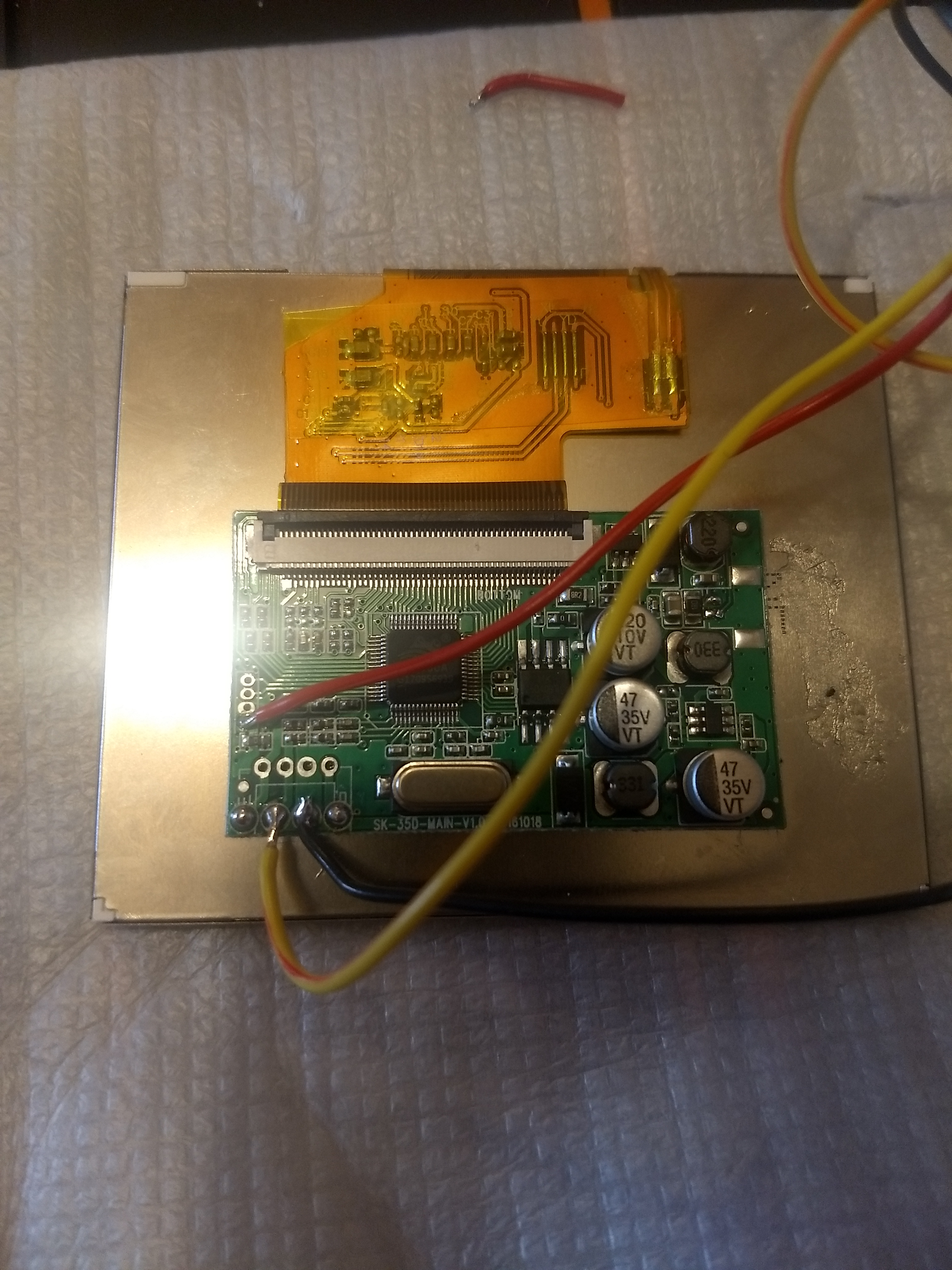

Post by Dannyzic » Thu Apr 26, 2018 4:10 pm
Okay so I tried 3.3v to the pin with no success. Screen did not turn on. 5v to the pin works. I have attached the picture to show that this has worked for me too.
