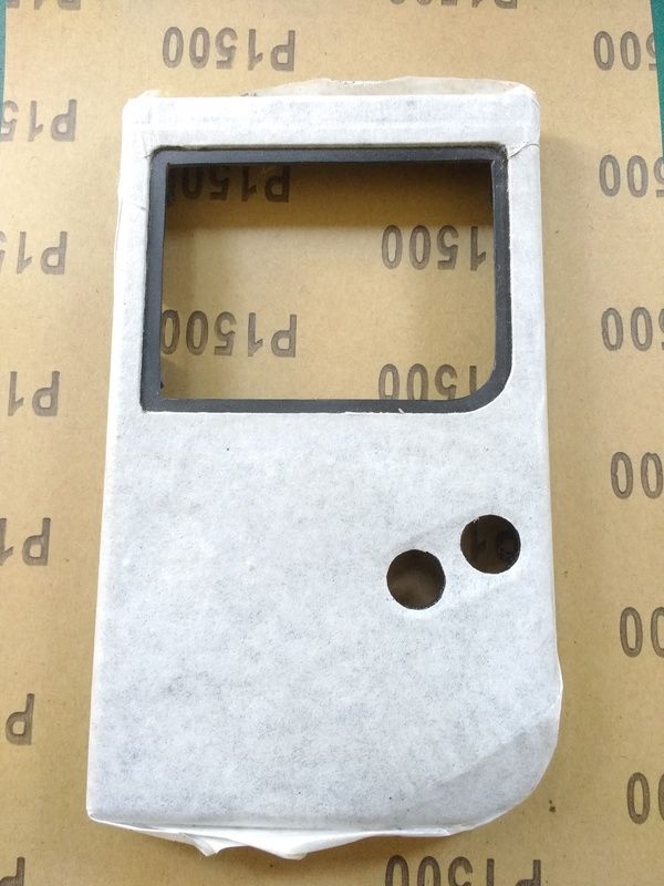

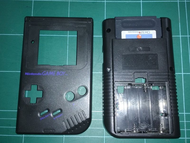

I received the case:
It's a start, though it has the wrong colour printing and some silver paint on the cover. i have ordered another case in red.

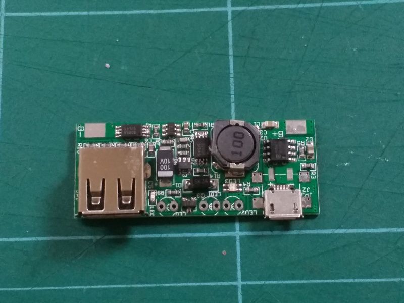

The powerboard i will be using:
I suppose it is possible to have a usb port on the side and connect it to the hub and this power board as well. Can anyone confirm this?

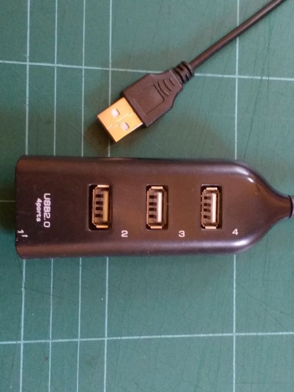

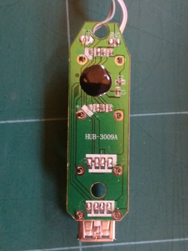

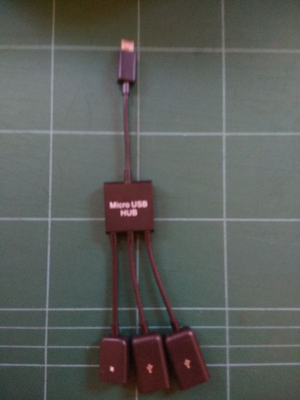

Cheap usb hub looks easy to cut down:
Do not buy this hub as it doesn't work with the Zero:

dominator wrote:I suppose it is possible to have a usb port on the side and connect it to the hub and this power board as well. Can anyone confirm this
Yes its possible as you can power many things from this if the hub uses external power source then you may need to look for another one that gets power from the device,
is that board from a power bank?

DirtyBullets wrote: Yes its possible as you can power many things from this if the hub uses external power source then you may need to look for another one that gets power from the device,
Yes i think it is from a power bank. It is the one that Wermy suggested in the Wiki. Looks like you have to have 2 usbs on the side with this power board.

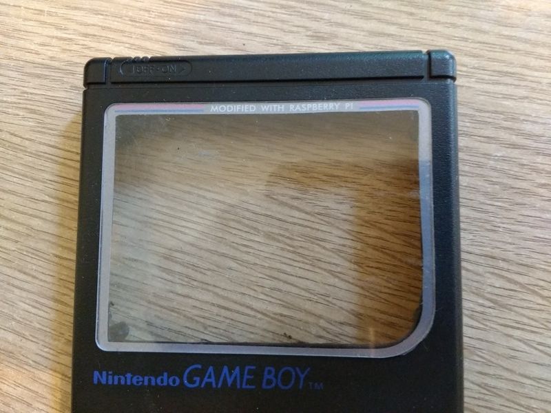

I cut the screen surround with a dremel;
One thing I noticed - either mark the plastic or scribe a line(cut) through the tape, as the plastic is softer than the tape!!
And another thing is that the black colour shows up every mark!
I used a straight piece of metal as a guide to try and keep the line straight.
I used a scapel and scraped off the print on a screen surround, with mixed results. I think it can be saved with a bit of polishing.
I still might need to remove more plastic from the case, as I don't have a screen to check the size.

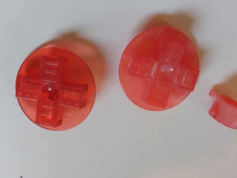

I didn't like the colour of the buttons, they were a orange/red, instead of red. So I tried to dye them and bought some red dye. The dye didn't take to the plastic, so I tried it with acetone...That is why they are milky. So I'm going to buy some clear ones and either paint or led them.
Also my cheapo usb hub stopped working. Time to find another one.

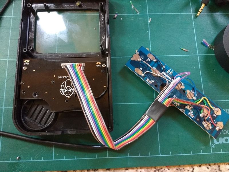

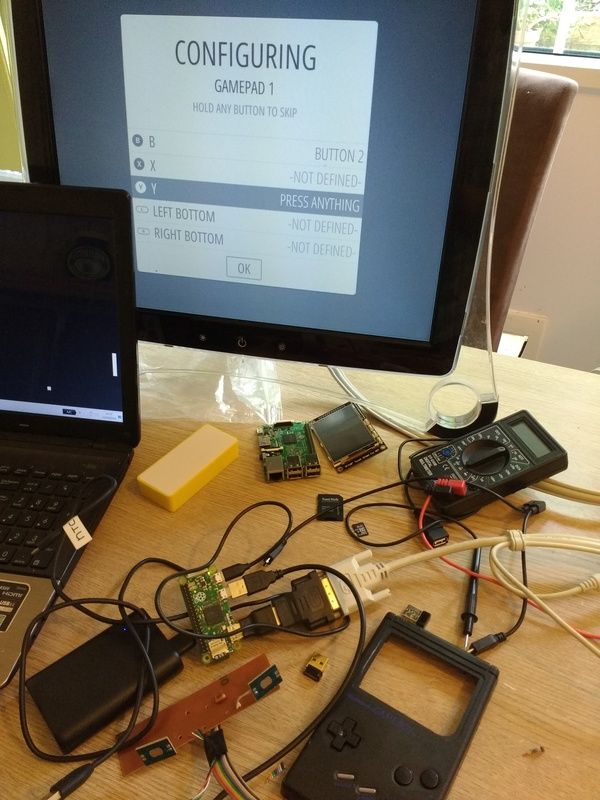

I tried out my new button pcb:
I wired it to the cheapo nes controller to test it. The wires lead off diagonally, as that is where I think the teensy will go (not that I have bought one yet).
Success!!

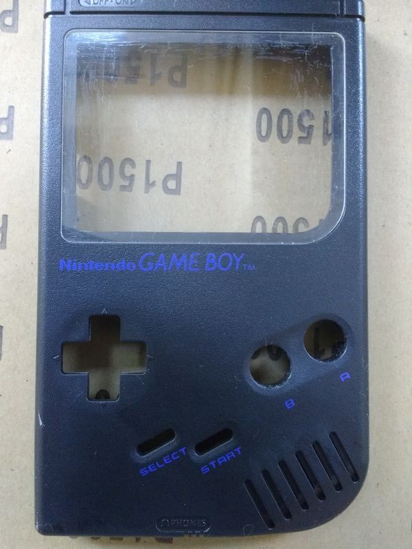

I clearanced the case some more for the screen (not that it's turned up yet, still waiting!)Image
It shows up my stretched and wobbly sticker :D :D
And I realised that I had made the button template wrong as there is a 1mm difference between some button pcb's (kitsch bent x y buttons are 17mm, Helders is 16mm). I am making another sticky template, it's a good job I realised before drilling the hole.
