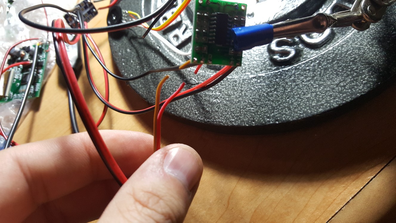

So I tried and failed at audio apparently.
I'm hoping someone can help me figure out where I went wrong...

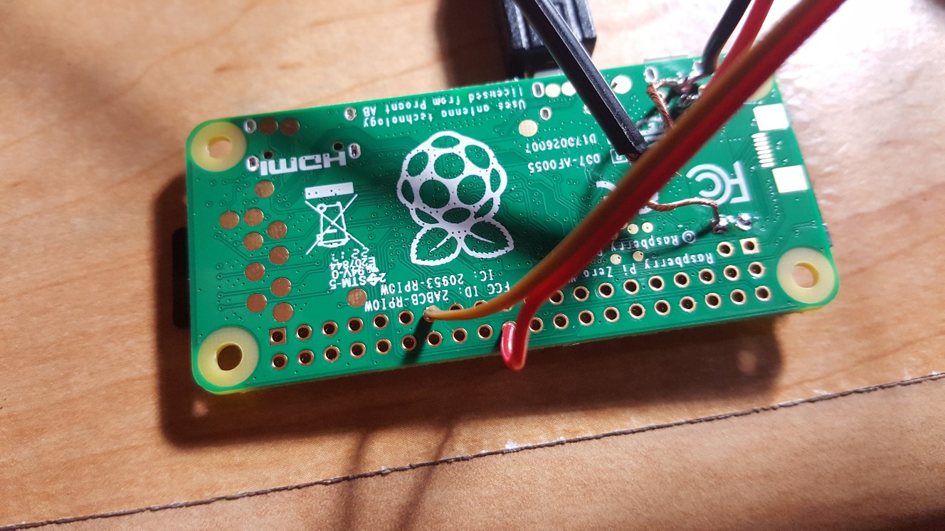

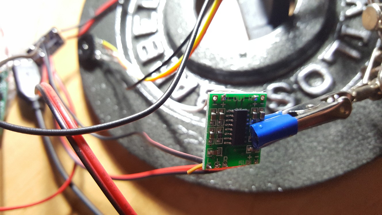

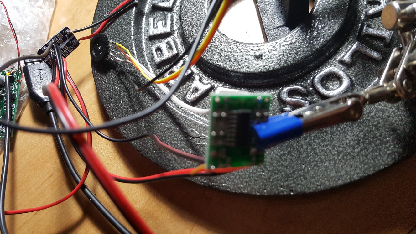

I added the PWM lines to the config.txt. I then wired the new L and R out to the L and R in on my PAM8403.

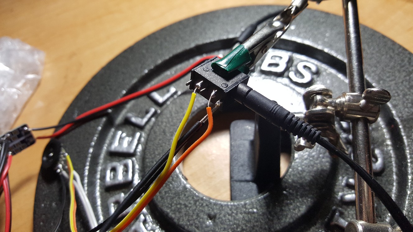

I then wired the amp L and R +'s to the pot ins. Then I wired the L and R pot outs to the headphone left and right in.
I wired the pot ground to the headphone ground and headphone ground to the power strip ground. The PAM8403 is powered and grounded to the power strip as well.
I then proceeded to generate smoke from (almost positive) the potentiometer. I cut the audio from Pi to test that nothing was fried on the Pi. Lucked out there. :)
I used the pins from wermy's vid for the pot and the headphone diagram from Felder.
I didn't put my low pass filter together yet, but I can't imagine that would have helped. Did I mess up some pins somewhere?
Pardon my rats nest. It will all look about 30% more organized when I start putting it in the case. :P
Thanks all!

Pretty sure you have the wrong gpio pins used. The yellow (pwm1) and blue (pwm0)wires are the pwm (see photo) Are you doing mono audio? If so you only need one of the pwm wires. It seems like your red wire is at ground, and that yellow wire is not on a pwm pin.

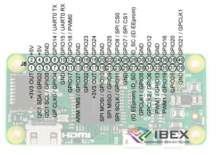

I'm trying to do stereo. I used the 13th and 18th pin per the PWM audio guide. I found this and it looks like I should be using pins 33 for L and 12 for R. Right?
Do I have the pins on the pot right? It was hard to tell if ground was left when looking at the wheel head on or looking at the back of the wheel.
Re: Smoke coming from potentiometer? Uh oh.
Post by rodocop » Sat Nov 11, 2017 9:07 am
That diagram is right. But your wiring does not match. Double check you gpio wiring.
Yes, I used the 13th and 18th pins, which it turns out are NOT GPIO13 and GPIO18. :)

Yeah. You can try it. But if it was smoking....might be toast. Also for the pot when looking down at it. With the black wheel on top, use this diagram. Ground is the left pin

Moved over to the correct pins (and a new potentiometer) and all good now. Hooray! Thanks, rodocop!
