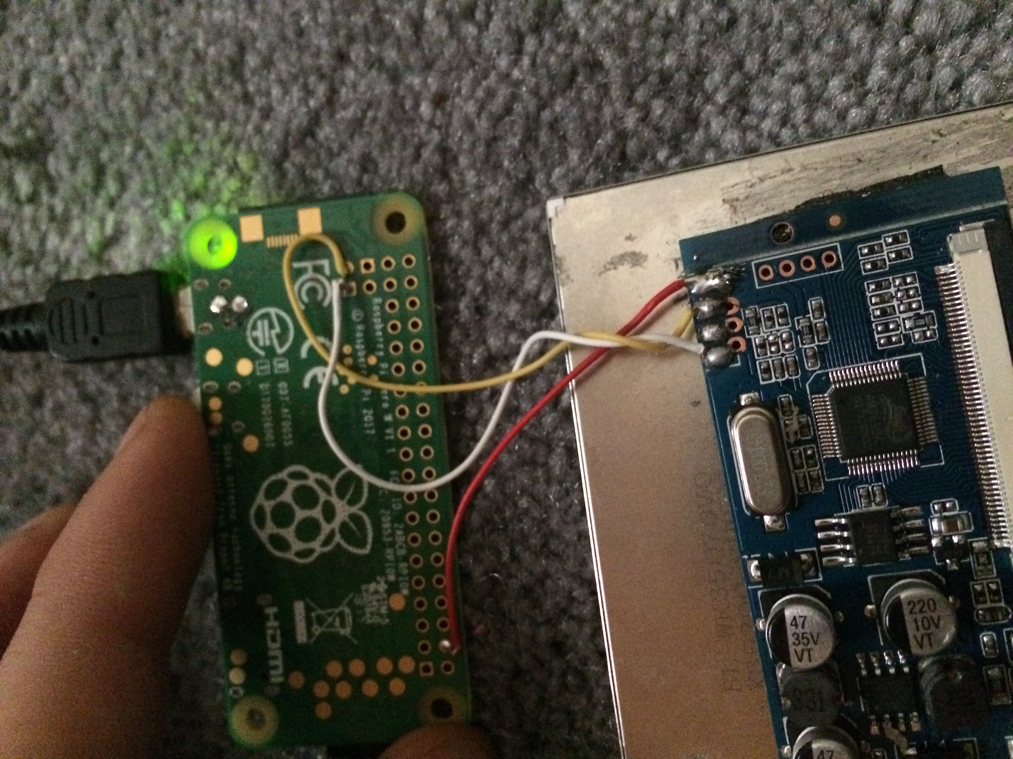

Screen not turning on helppp
Yellow-channel white-ground red-power

Okay, so your yellow wire is actually ground, and your white wire is signal. According to your picture you have it wired properly, but according to the wiki that screen needs a 5v mod which I don't see. I am also seeing some very similar images on FB retropie handhelds, is that you as well?
whatever wiring you are using just make sure signal wire goes to the square pin, ground goes to the round, and get 5v from the pi or your power source.

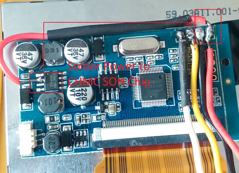

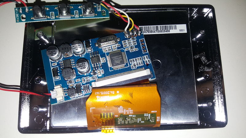

Hey i have the same board do you need help ?
- Posts: 16
- Joined: Thu Oct 05, 2017 10:43 pm
- Has thanked: 1 time
- Been thanked: 3 times
Re: Screen not turning on helppp
Connect like this
Do not forget: the screen shows only a picture if a signal arrives to it. Meaning: make shure your Pi is running and is NOT connected to HDMI
