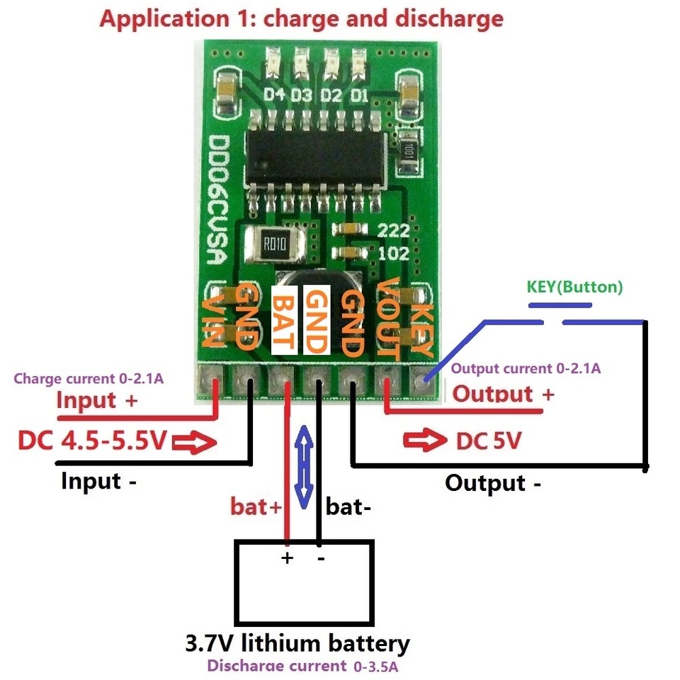

Hello everyone!

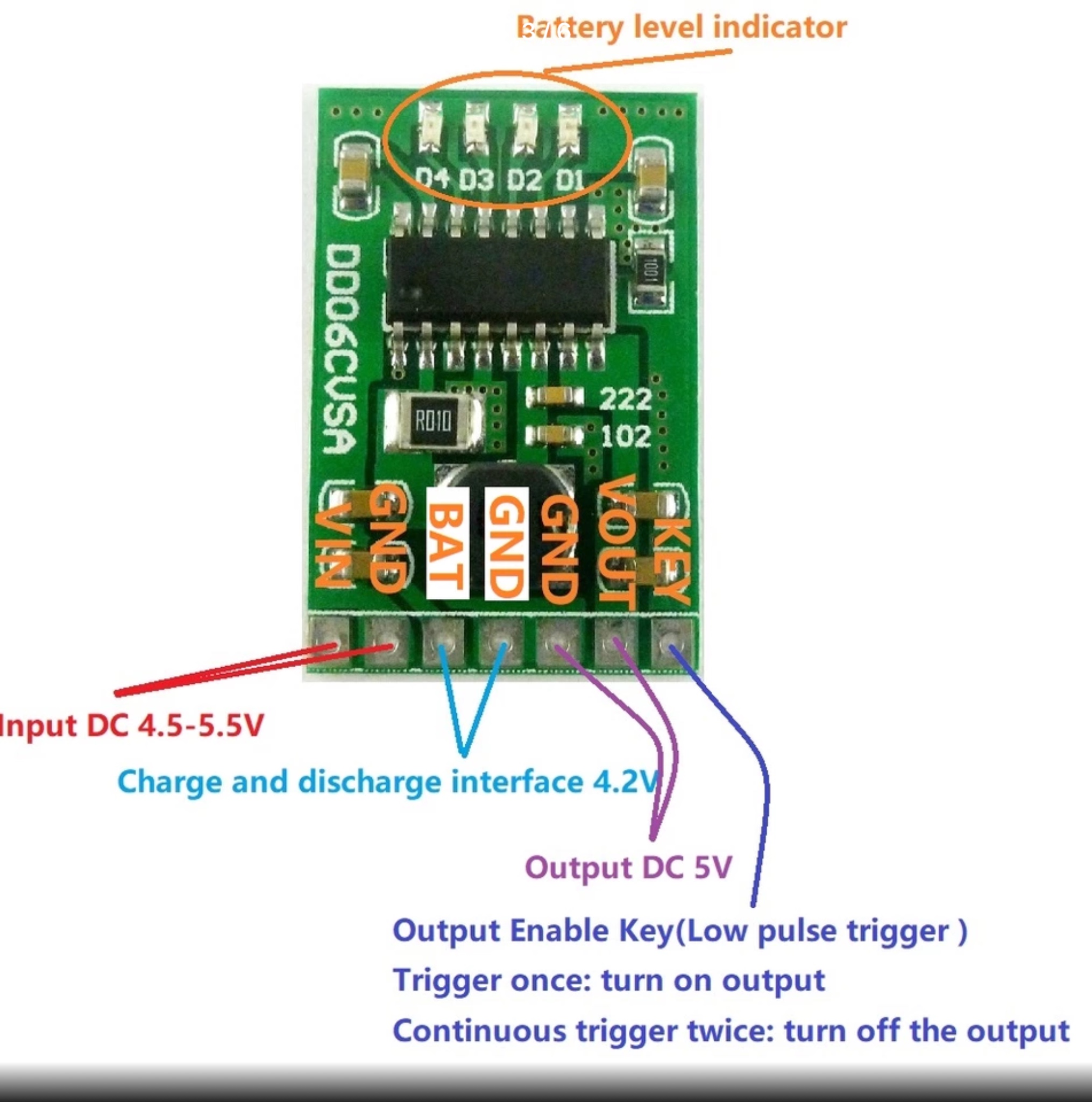

I have a question about the new powerbooster, from the photos i can see a KEY (button)... what does it do if i may ask?
The powerboost
here is the link from ali : https://www.aliexpress.com/item/DC-5V-2 ... autifyAB=0
Thanks in advance!
With Friendly Regards,
Beautjes

Based on the photo from the link you posted, it seems like it’s a ‘switch’ to turn output power on and off.

Thanks for your reply HoolyHoo,
So i can just leave it empty?

I would assume yes but you will only know for sure once you receive it and test it. ;)

Easier to test with multimeter. Just check if your getting 5v between gnd and vout. If your not then short key to gnd and see if it works then.
