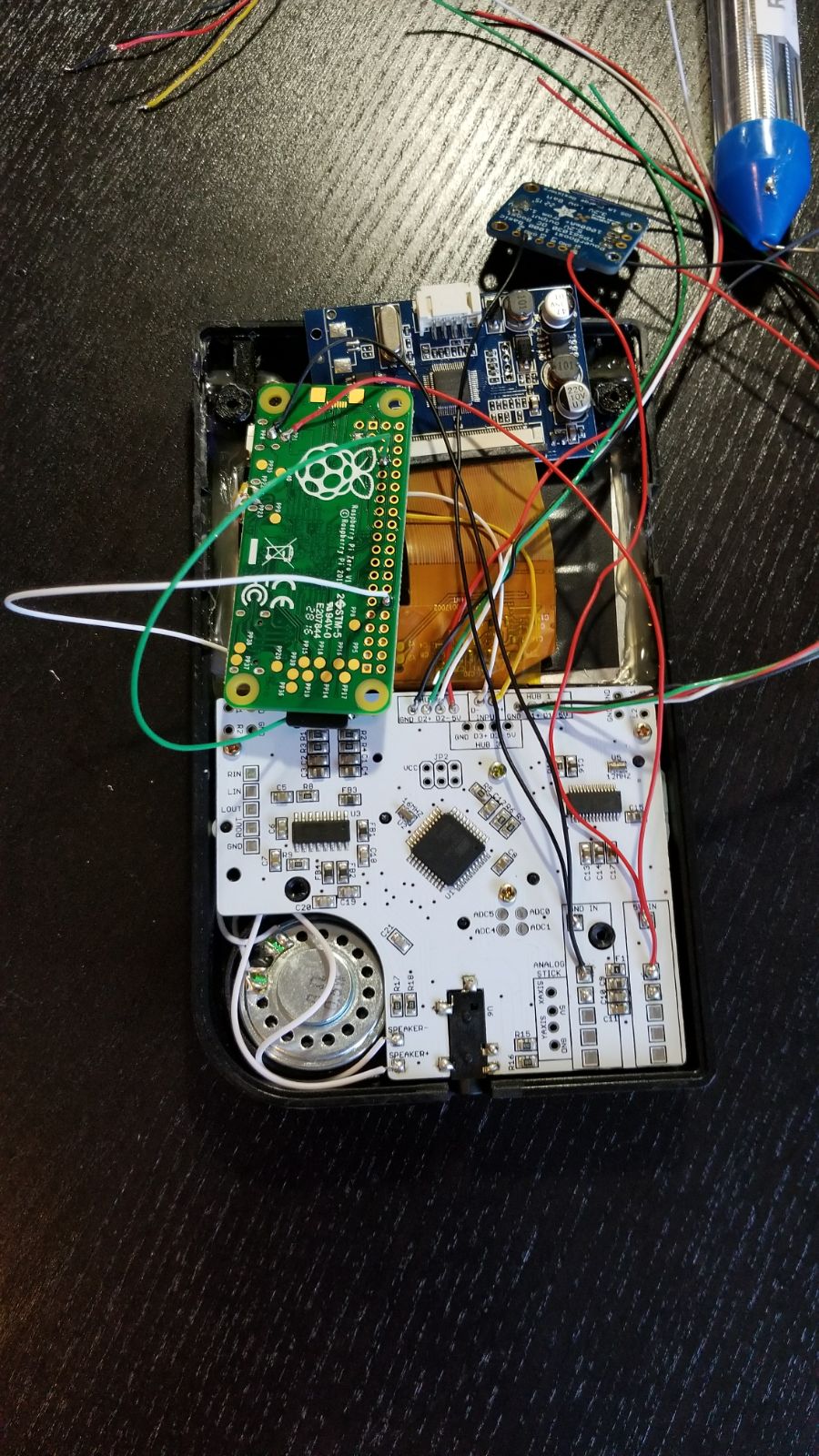

I'm making a game boy zero and, I've been testing it and everytime I boot up retro pie It dosen't recognise my button PCB

Re: Game Boy Zero Board not working
Post by rodocop » Sun Jan 21, 2018 12:36 pm
Make sure the data wires are wired properly, and the board is getting power.
Do you have any pics? The d+ and d- on the pi are very close to each other and very easy to bridge if not careful.

Post by GameBoyMaster » Sun Jan 21, 2018 1:12 pm
I've checked and they're not bridged but here's my pictures
Post by rodocop » Sun Jan 21, 2018 1:19 pm
Okay. Looks okay....
Make sure pp23 is not bridged with the little hole beside it (to the right)
Do you have multimeter to ensure the board gets power when the pi is on (5V) Also. Where is your powerboost. Maybe try powering the all in one from the powerboost (or equavalent) not the pi's power test pads.

Post by GameBoyMaster » Sun Jan 21, 2018 1:26 pm
Yeah my partner checked with his miltimiter and they're not bridged
Post by tinkerBOY » Sun Jan 21, 2018 2:12 pm
Any other thoughts @rodocop ?
You can test if the atmega32u4 is working by connnecting it to USB on a PC. It should be recognized.

Post by GameBoyMaster » Sun Jan 21, 2018 2:50 pm
But would how would I go about doing that?
Because I'd like to verify
