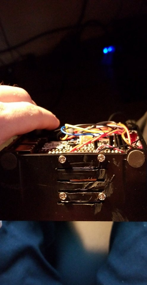

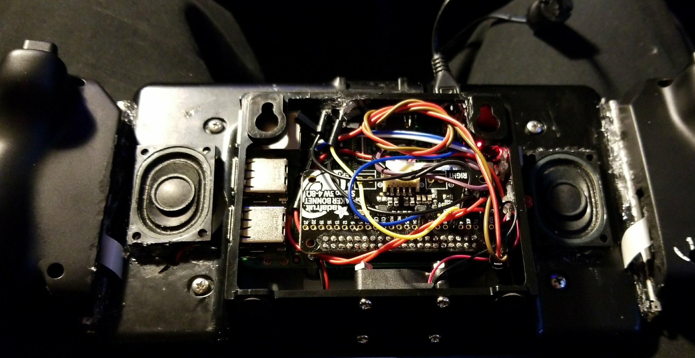

This is a little project I have been working on for the past few months, also it is my first build as well as my first time getting to play with a raspberry pi. Its still on going with some tweaks here and there as of writing this I'm trying to adapt the MintyPi Battery Monitor to work with it. Ill start with what I currently have in the build. Started off with the Raspberry pi 3 (mostly due to the power of it) and have it connected to the official raspberry Pi 7" touch screen. On top of that I have the ADA Fruit Audio Bonnet with 2 8 Ohm 3 Watt speakers (mounted on the rear for now) for stereo sound. On the top I mounted 2 push buttons wired to the audio bonnet (which sits on top of the GPIO Pins, so tech its wired to those) for volume controls without any special button commands. Added a push button on the side for quick on/off (depending on power state) with a shutdown script attached to it so its not just cutting power off. On the bottom I mounted a small 3 w fan to help with cooling as this was giving me a overheat warning after a few minutes without it. There is a small red LED on the side that is next to the ON/OFF button but I haven't reconnected it yet, it was used to show power state (if it was on or if it was ready to be unplugged completely), and i may yet remove it altogether. For the controller I took a Bluetooth telescoping controller and cut it in half and mounted it onto the sides ( you will notice the Nintendo Switch railings mounted as well), I first tried the NS Joy-cons but i couldn't get them both to be usable as player one so I scraped that idea and added this one. I have it all inside the official raspberry pi 7" case (its getting a little crowded in there now) I am hoping to eventually make my own case, but have also toyed around the idea of getting rid of both USB hubs as well as the Ethernet port to add more room for things. Its being currently powered by the PB1000c and PB1000b wired together (have to still test this though i had them separate before and would just switch them off from charging and use). Let me know what you guys think of it so far or any feed back or suggestions would be greatly appreciated! ^_^ if anyone has any other questions on the build on how i did a certain thing let me know, or any of the scripts or what i have inside (its a 200GB sd card so lots of stuff! ^_^) I will be more than happy to share as well as the specifics on the controller and parts and what not (I apologize for this being so long again first build and first time posting anything like this). Also I might post a small video of it running and a full better look at it a little later. Thanks again everyone for the help especially VeteranGamer HoolyHoo 144TECH for helping me with the Battery Mod.
where the fan is mounted
What the guts look like inside

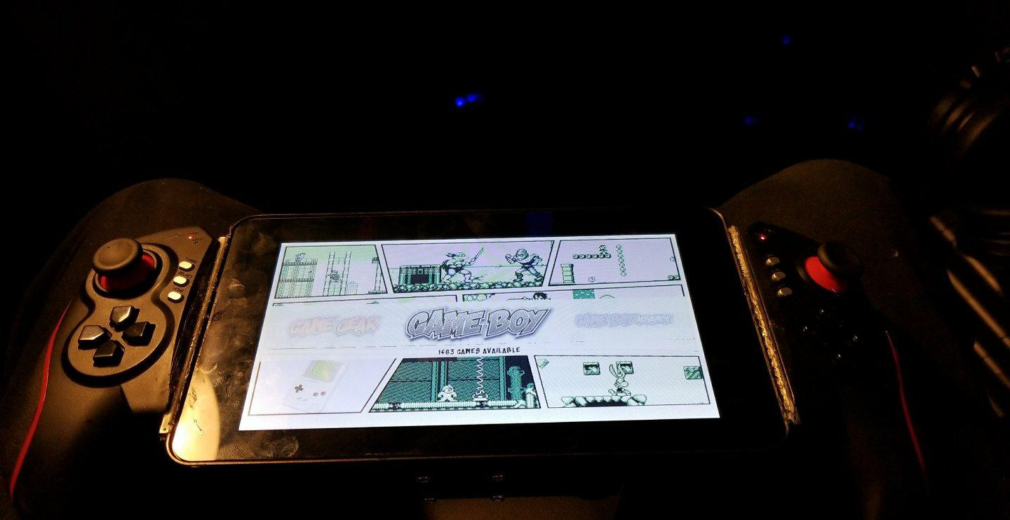

Powered up and Front of handheld
