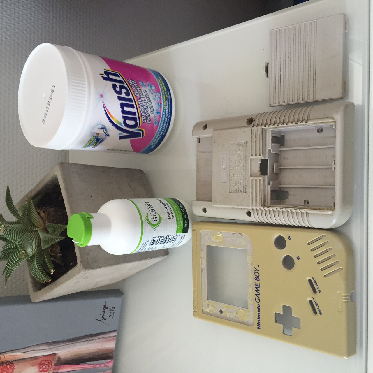

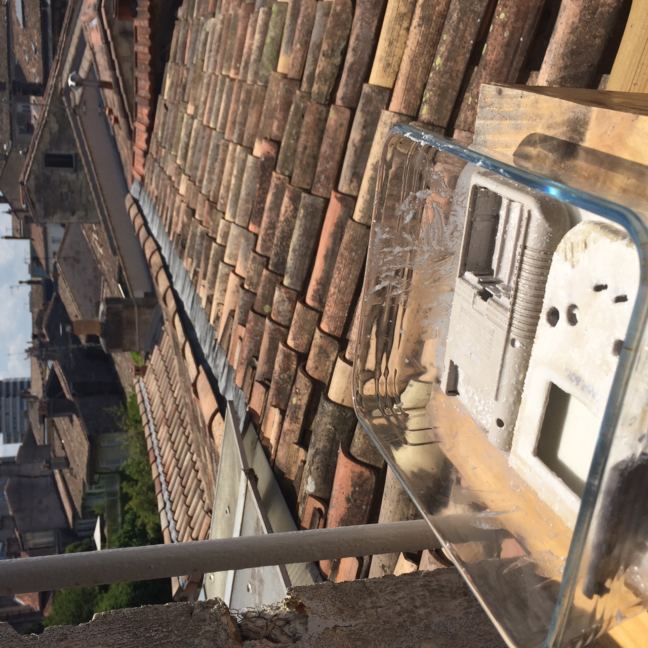

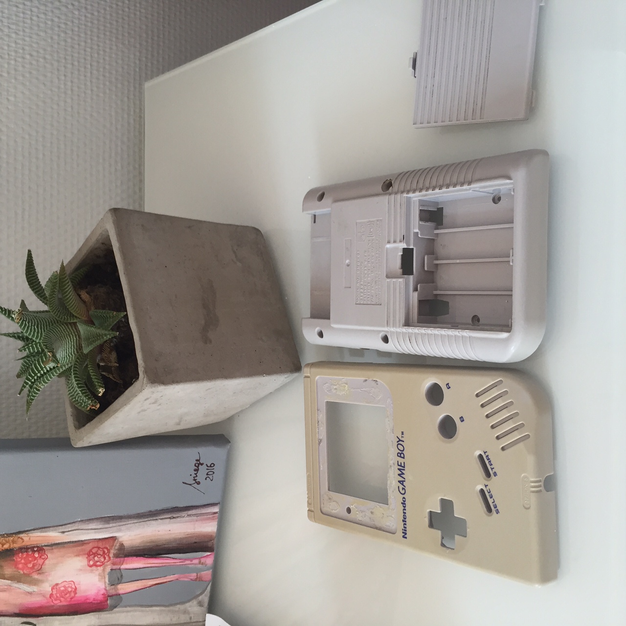

So...this afternon, I don't work and the weather is good. The shell of my DMG-01 is yellow and dirty.
This is the shell and the magic potion ( H2O2 + Vanish Action....???)
I use gloves.
Waiting for ... (rooftops of Bordeaux, FRANCE ;) )

Vanish for clothes only :lol:

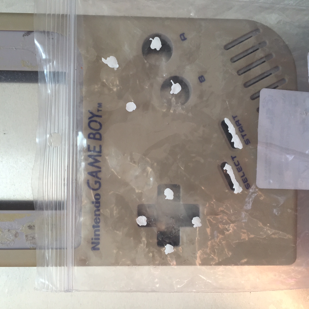

After 4h, and a sunny day, I can say that...
I have a clean shell but not new as the first day!
PS: I don't understand why the pictures have made a -90° on my macbook and there's not problem when I am on a iPhone?

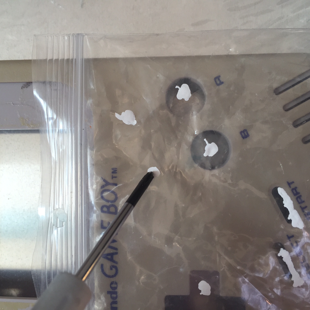

Buy this: https://www.amazon.com/Salon-Care-Clear ... de+volumer
Mix with Baking Soda until you get a paste. Spread it on. Wrap in a couple layers of saran wrap. Let it sit in the sun for 4 - 5 hours. It'll look like the day you got it.

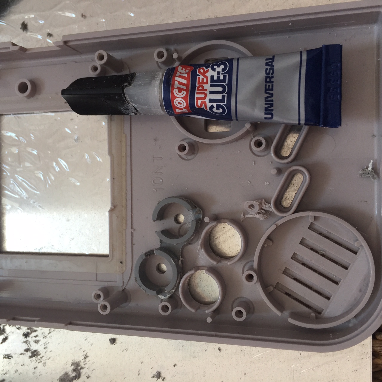

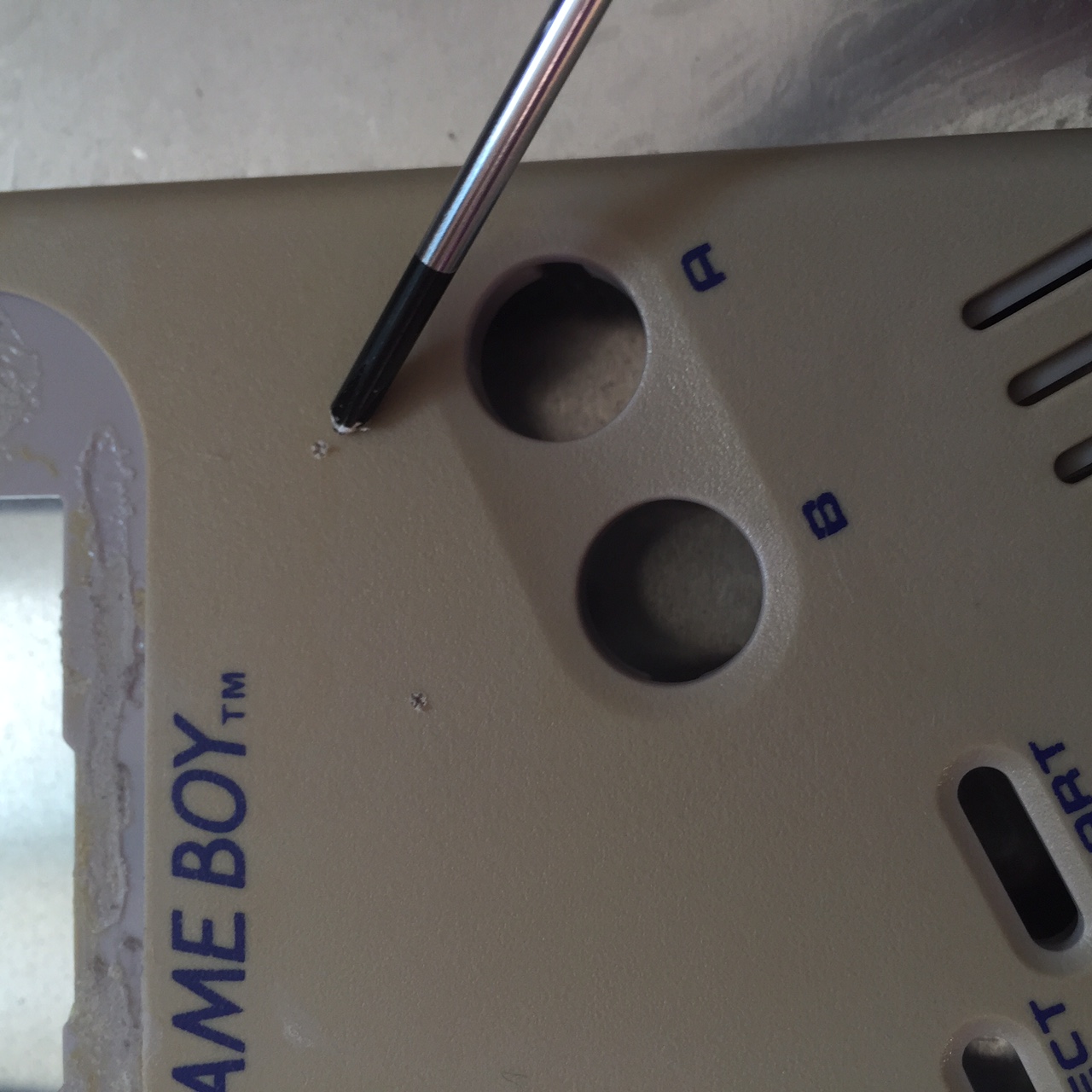

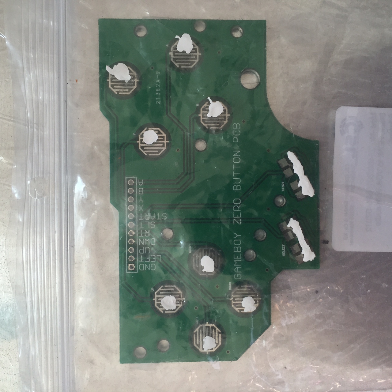

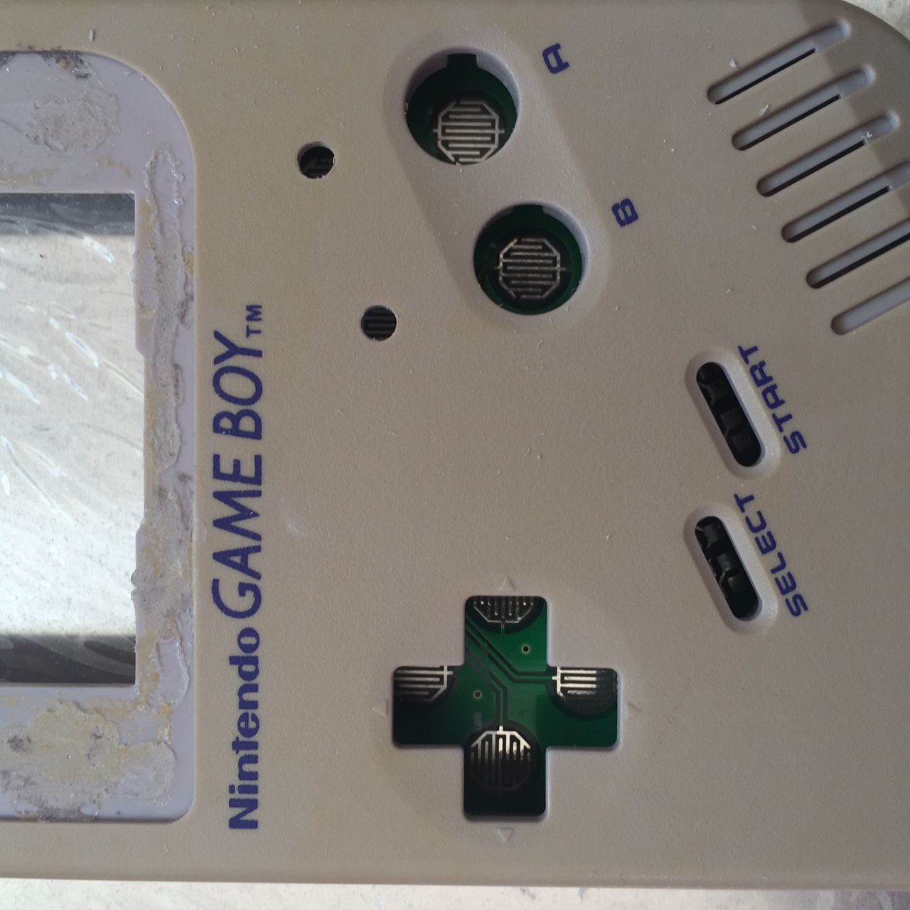

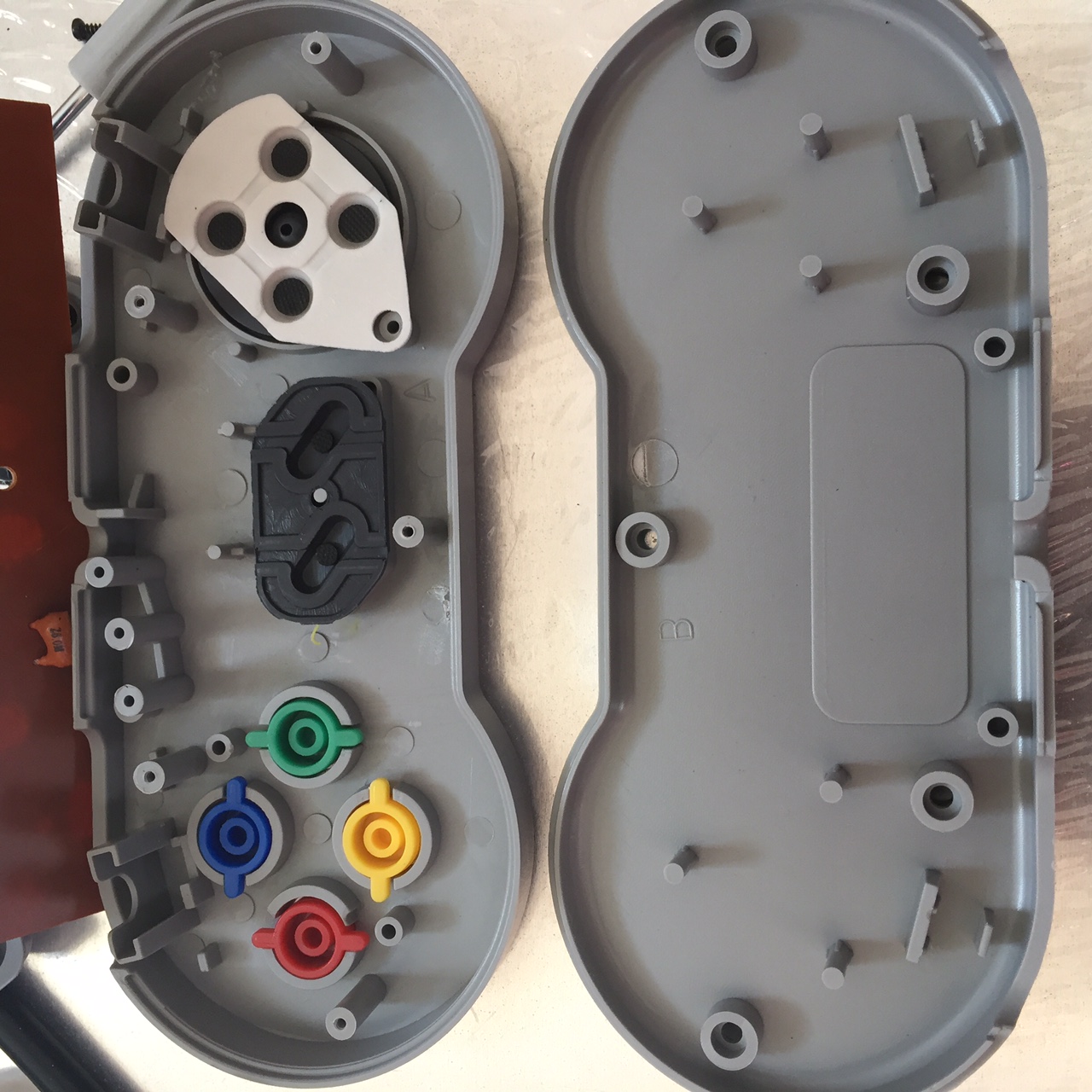

I want to play Street Fighters on my GB Pi so I'm interested when I read a post where a GBZero had 6 buttons... Let's go:
Original shell (DMG-01 - PCB from sudomod.com - SNES-usb-controller):

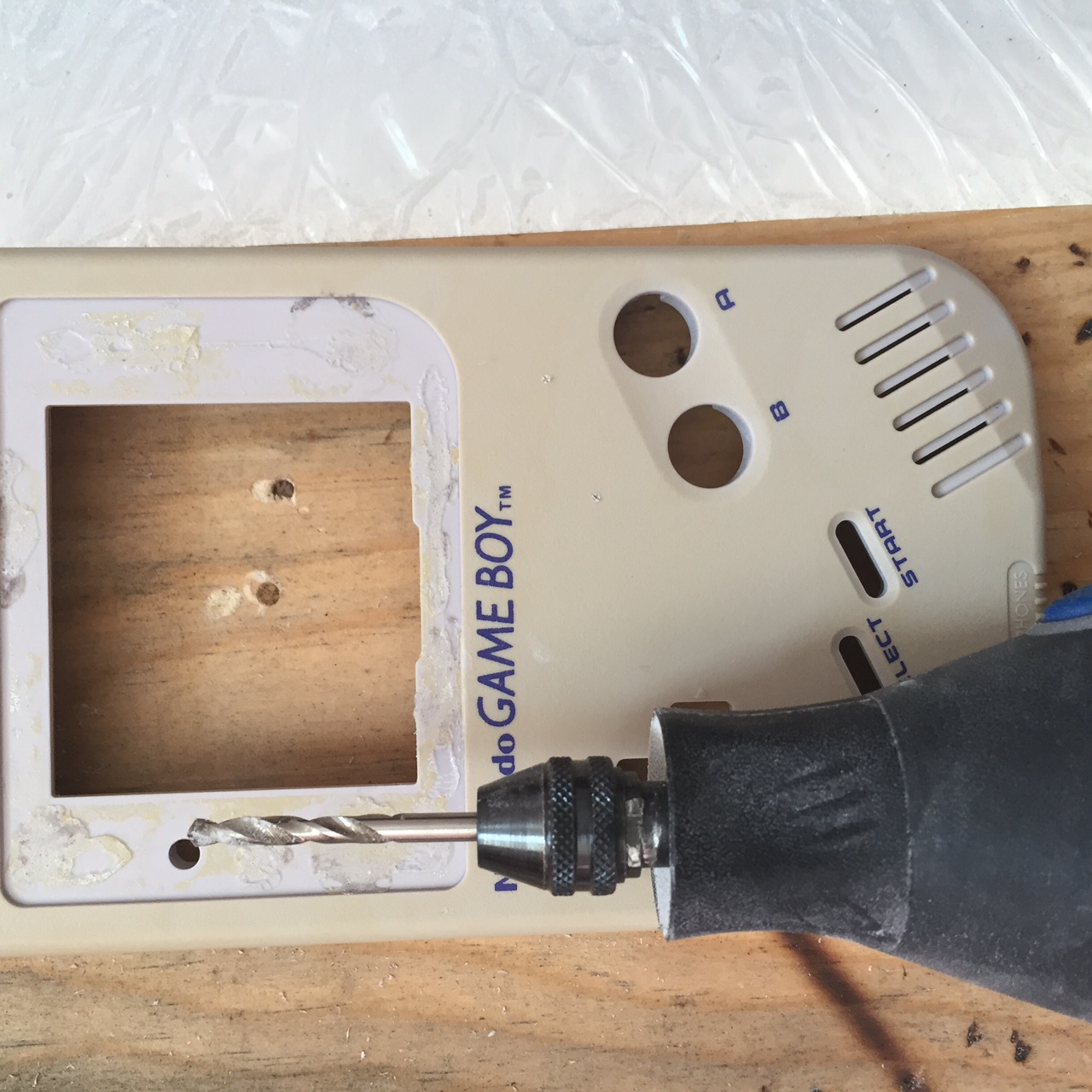

Make a mask:
Take a Dremel and make a little hole
IMG_3809.JPG[/attachment [attachment=3]IMG_3810.JPG

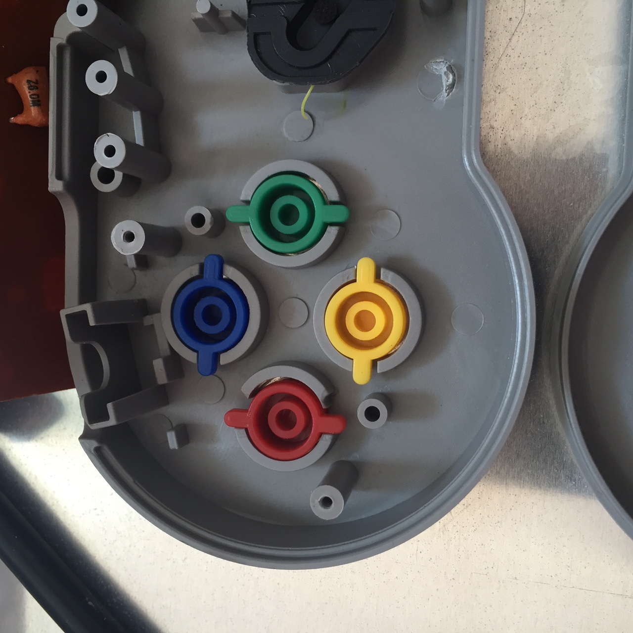

From the controller, take the part which is marked

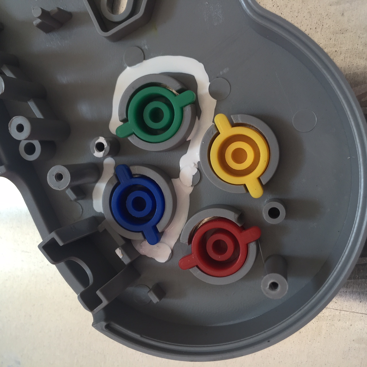

Aiolia33Fr
Posts: 30
Joined: Tue May 10, 2016 12:35 am
Re: AIOLIA'S GB-Pi

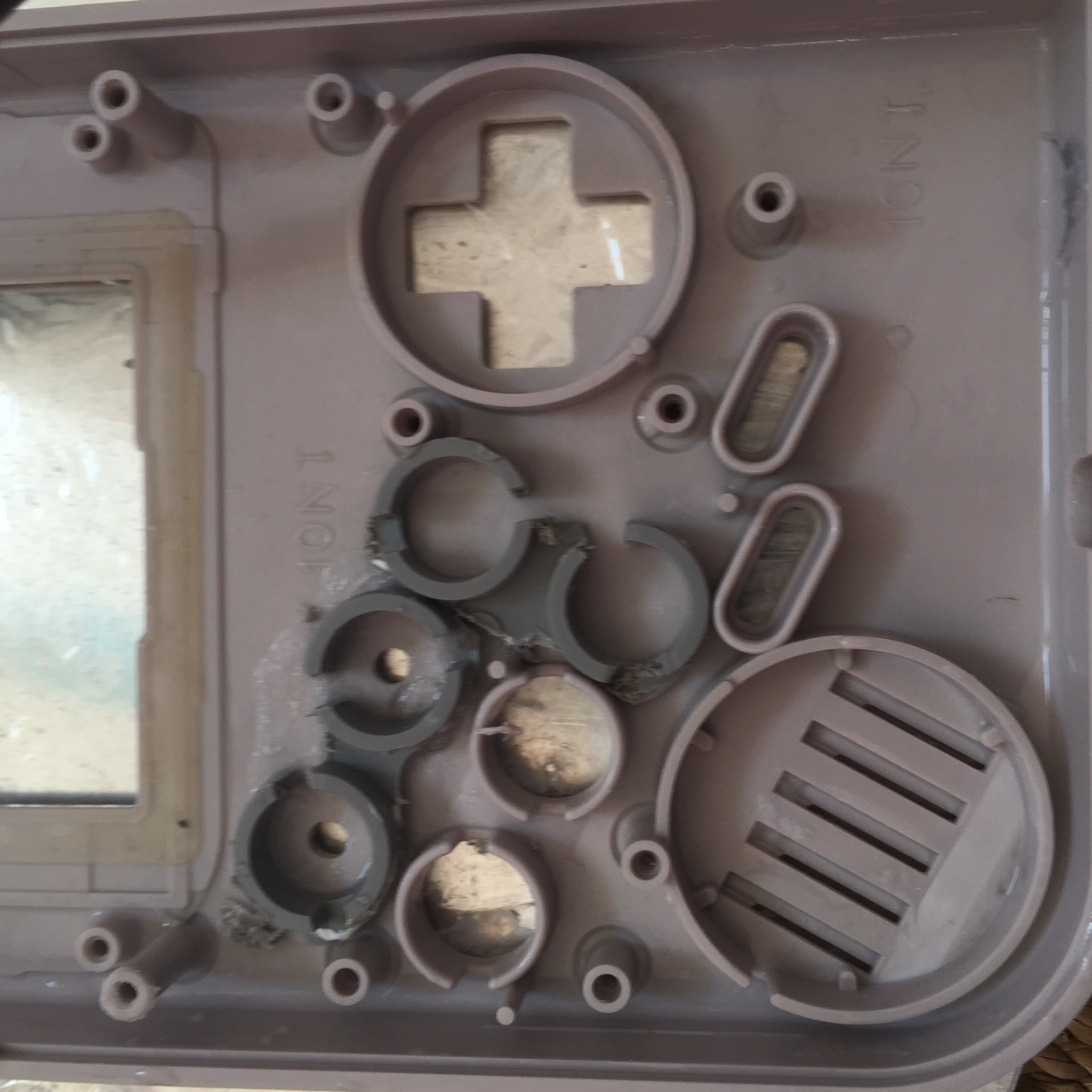

Post by Aiolia33Fr » Wed Jun 08, 2016 12:33 pm

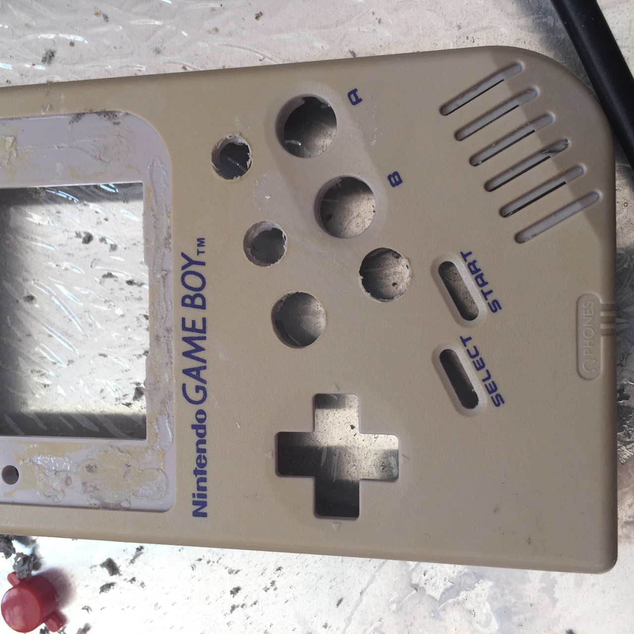

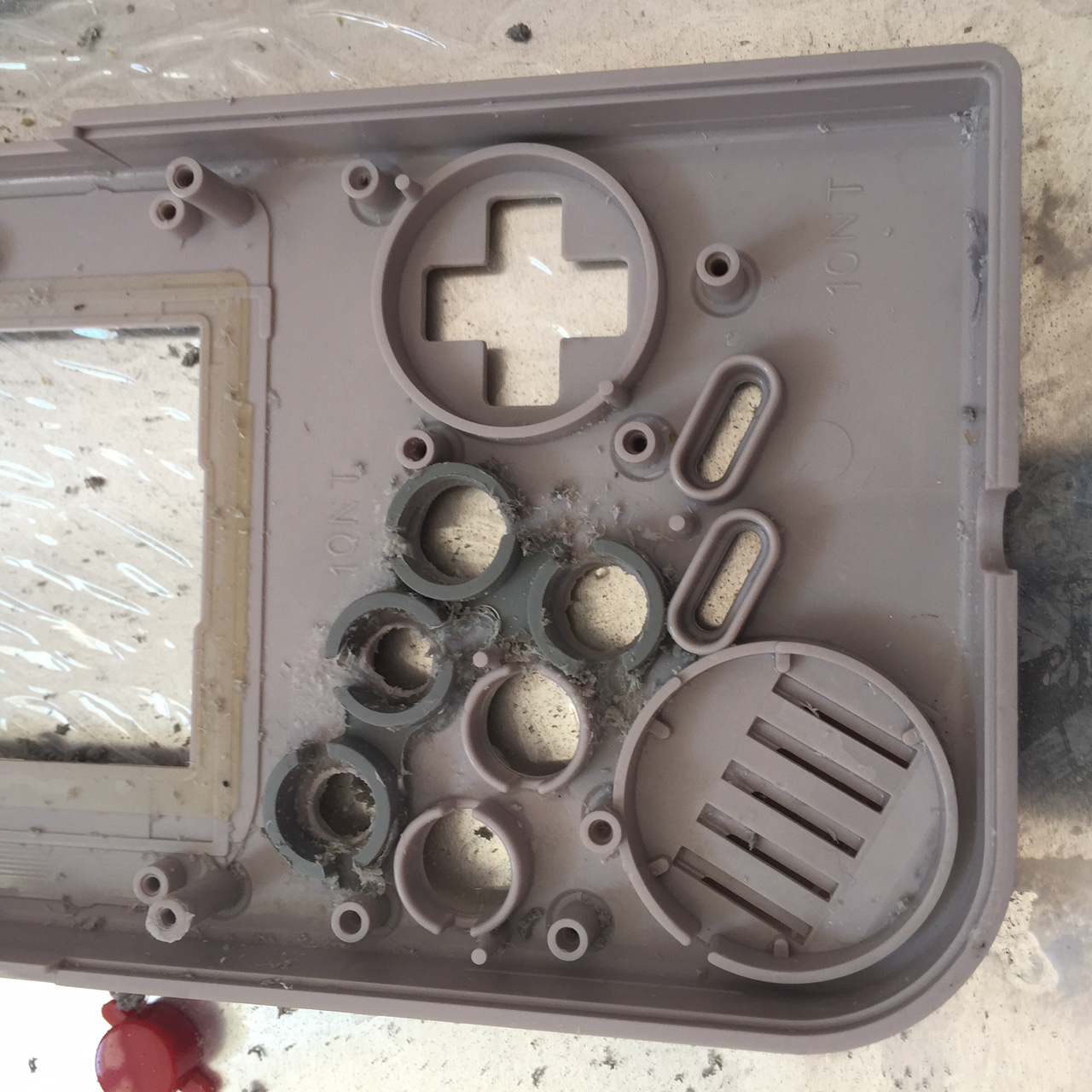

Centre the piece, and glue it:
Make a little hole
And wilder and wilder...
