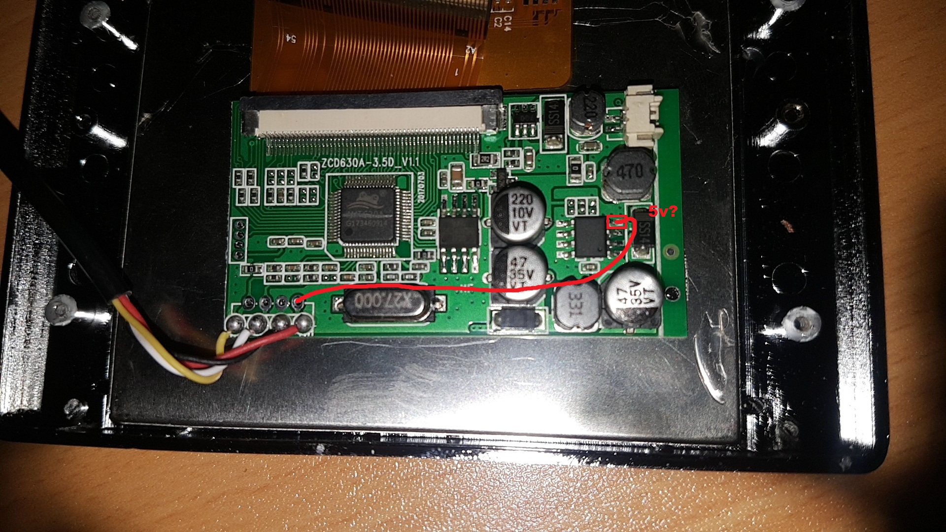

Hey all :)
so i got all my parts pew pew
and opened up my LCD screen to find out its a BW V10 i think?
wiki doesnt really help much ( as im a noob)
Please if someone could help me out , i think this is how it goes? but if its wrong let me know rather not wait another 4weeks for a new screen :O
do i need to unsolder the 5v pin and lift it up? and then run a wire from it to 5v pin (like in my pic)
thanks! can not wait to have my GBZ finished xD

Connect this chip 1,2pin together and then wire to 5v.
> 1-■-2 <--To 5v
3-■-4
5-■-6
7-■-8
Do the pins count like that?
And do they still need to be touching the board?
(Sorry very new to this)
Thanks
