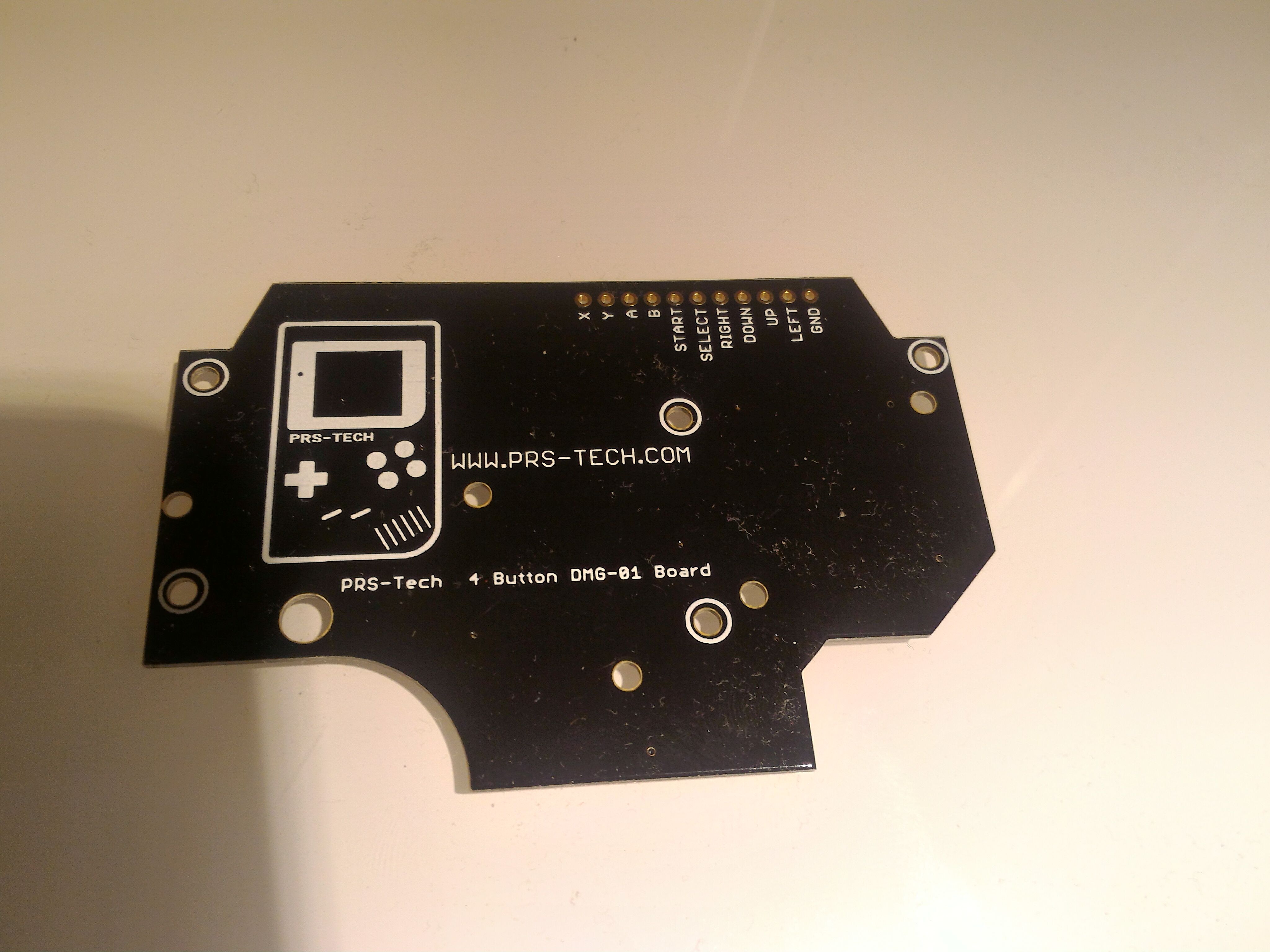

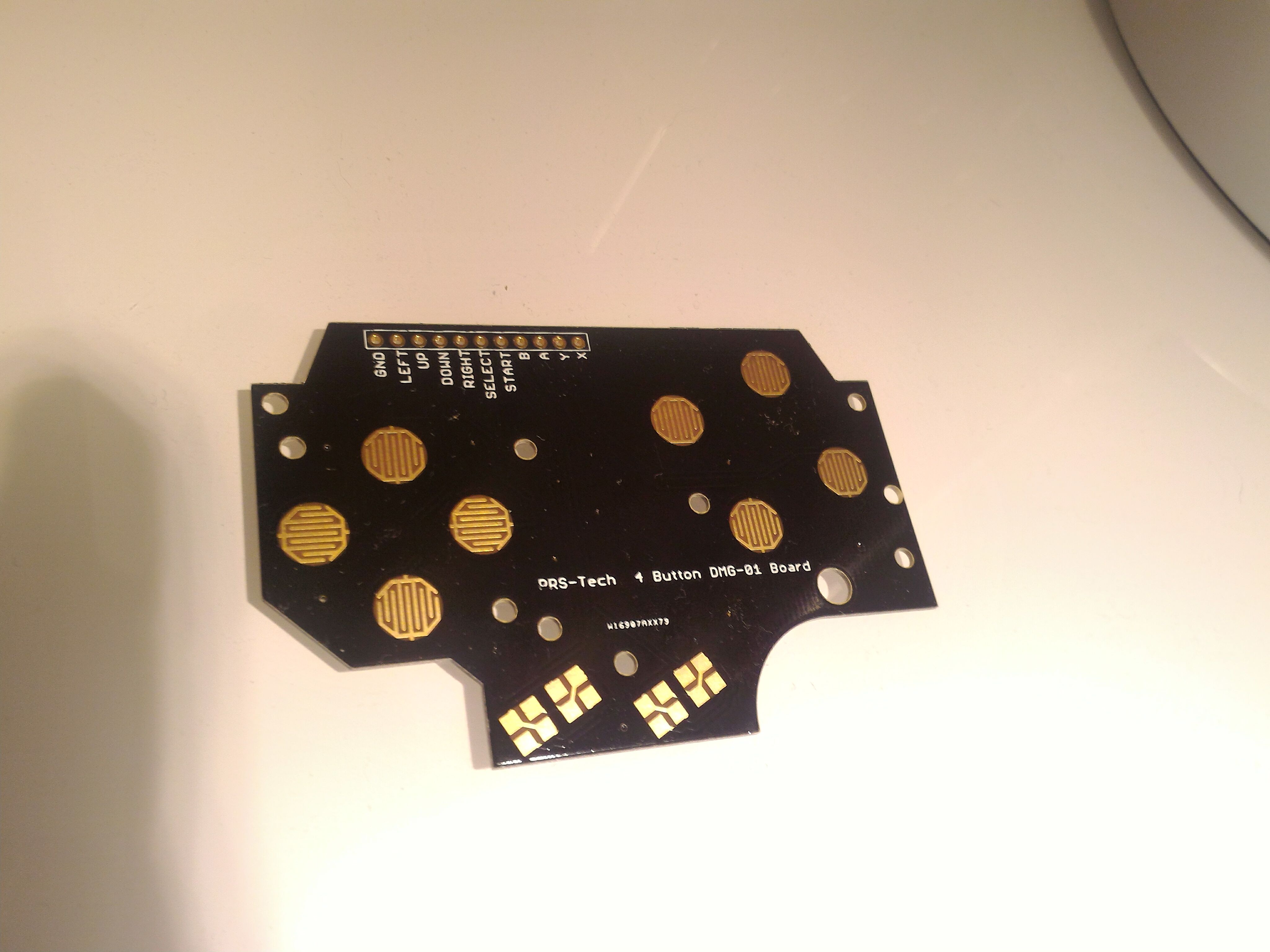

I've just recieved this pcb with some gameboys buttons buth without any wiring indications.
Does someone know how should I wire it to my RPi zero? I'm new to this stuff and all I've found are PCB with chip on it. Do I need an arduino between the pcb and the pi zero?
Thanks

I have the same board and use this pinout:
Left Trigger button is on BCM14. You can see all pi zero pins on https://pinout.xyz
In /boot/retrogame.cfg you need to add this:
UP 0 # 'UP' button
DOWN 5 # 'DOWN' button
LEFT 1 # 'LEFT' Button
RIGHT 12 # 'RIGHT' button
A 19 # 'A' Button
B 16 # 'B' button
X 26 # 'X' button
Y 20 # 'Y' button
ENTER 13 # 'ENTER' button
SPACE 6 # 'SELECT' button
L 14 # 'Left' Shoulder button
R 21 # 'Right' Shoulder button

Re: Gameboy Zero 4 buttons PCB wiring
I always follow this guide. Similar to what is seen above
https://sudomod.com/forum/viewtopic.php?t=57
Yeah. You can use a teensy if you want. But the guide I linked is to be used instead of the teensy.
Wermy wired up a teensy in part 2 of his guide. Check it out here.
https://www.sudomod.com/game-boy-zero-guide-part-2/
I am also planning on doing this project, but what pins are for the left and right trigger? and do I just ground the buttons to the ground pin right? Also after I wire it up will retropie automatically recognize the controller?
In the example given above by snoek09 L is 14 and R is 21.Hunter Miller-Moreno wrote: ↑Sat Sep 15, 2018 1:39 pmI am also planning on doing this project, but what pins are for the left and right trigger? and do I just ground the buttons to the ground pin right? Also after I wire it up will retropie automatically recognize the controller?
For grounding the buttons you should just need to connect the ground on the pcb to one of the grounds on your pi.
Retropie will not automatically know to accept controller inputs through the gpio pins. So you will need to install Retrogame (https://learn.adafruit.com/retro-gaming ... s-software) You might need to edit the Retrogame configuration file in order to make sure all your buttons work with the gpio's you chose.
