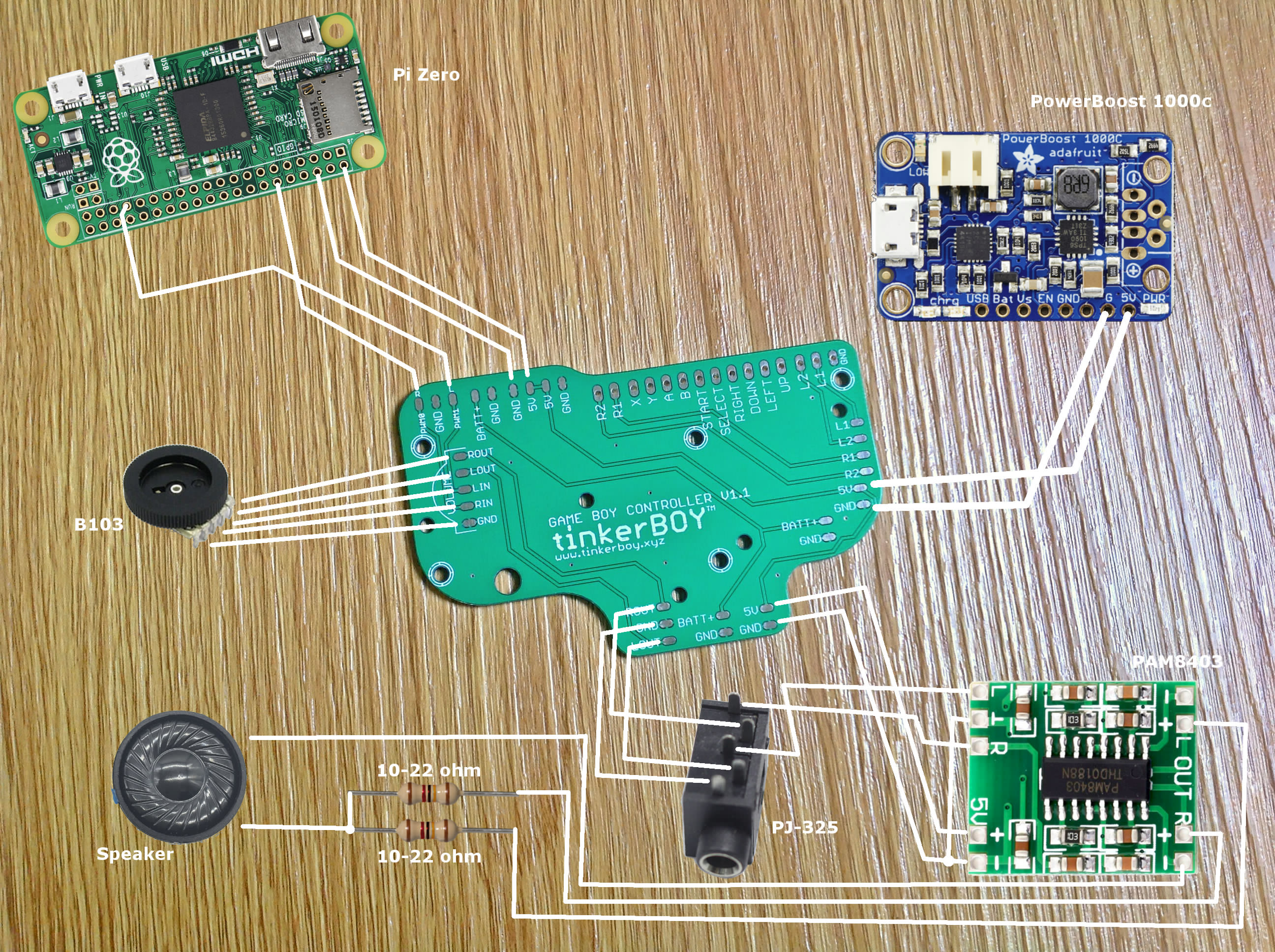

I made a diagram for my simple v1.1 board but can also be used for other boards.
1. Power strip makes it easy to distribute power to each devices.
2. You can connect to any GND on the Pi, battery, etc.

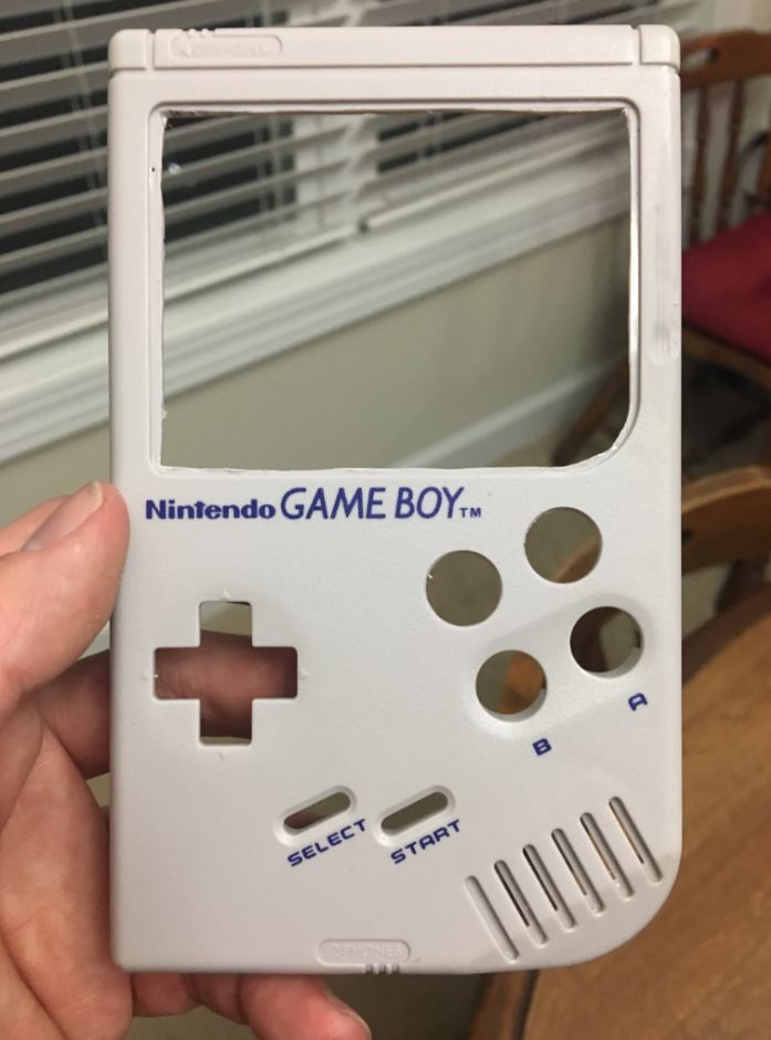

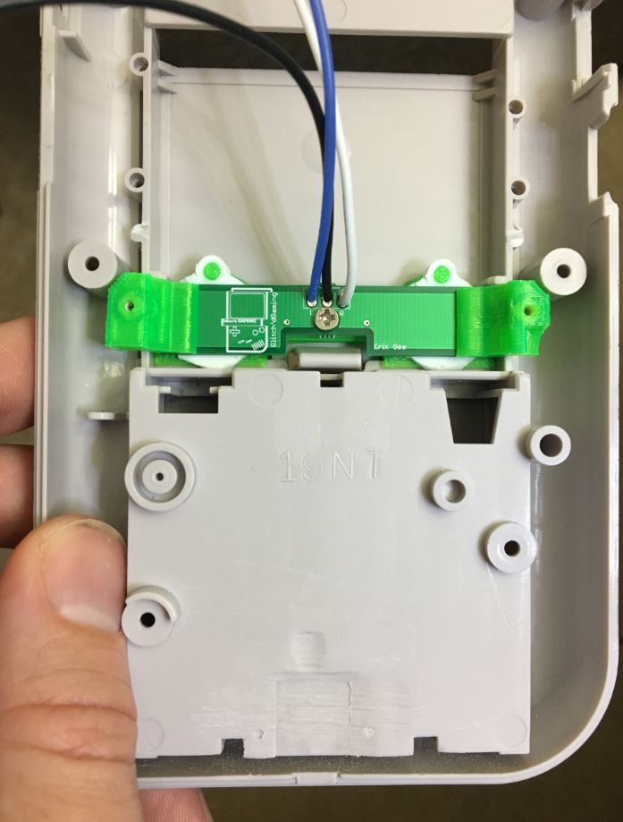

I got my case modded up to my liking and have installed Wermy's button wells, my Kitsch-Bent controller board and Erik Gee's L/R button brackets. They look great! I've also soldered up the wiring, which I will trim to size once I get everything where I like it. I'm sort of staging everything in the meantime.

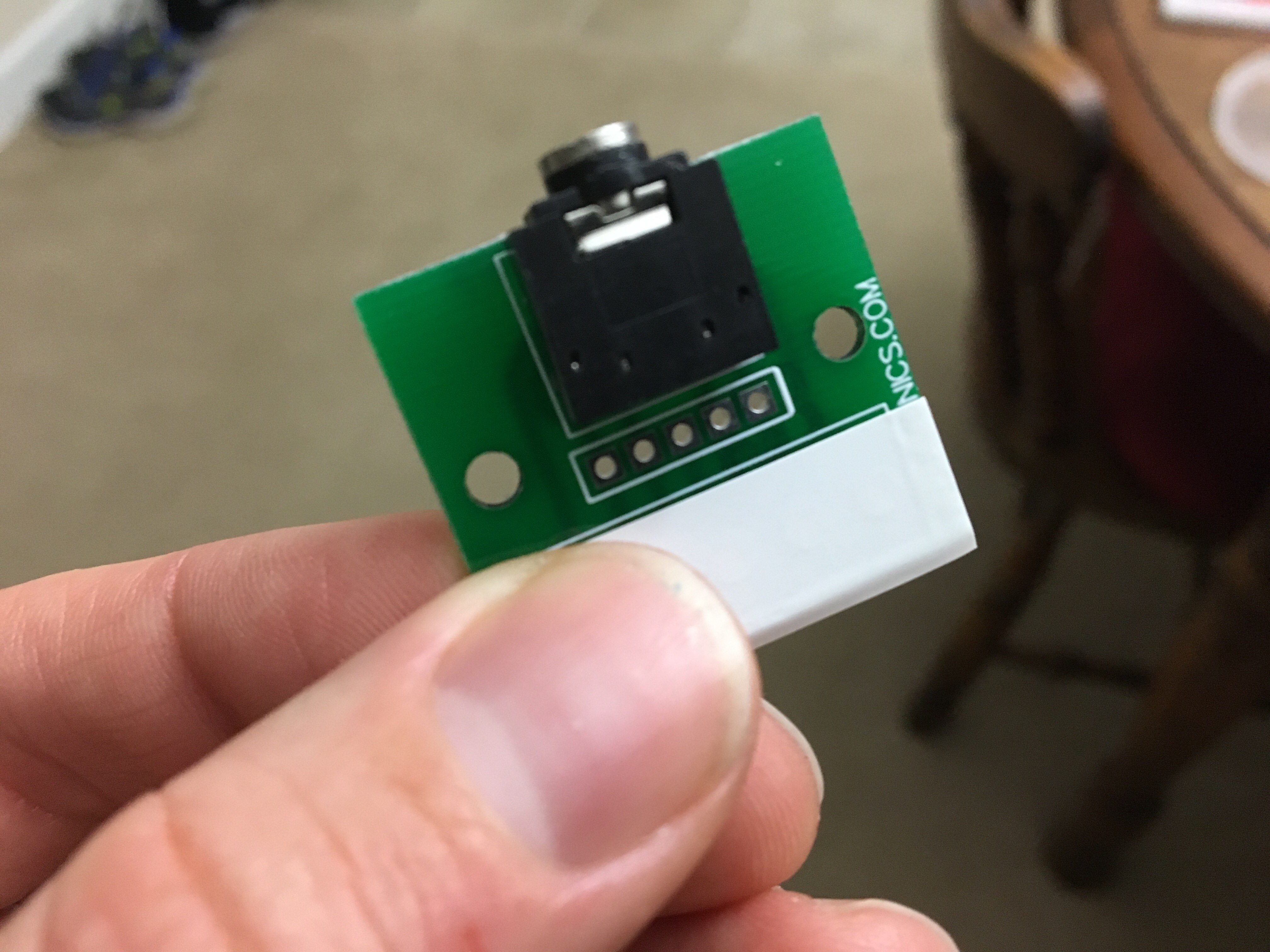

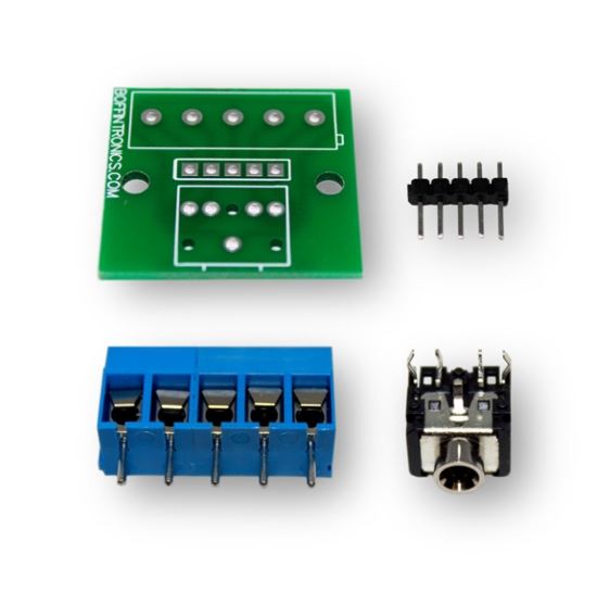

I also had a horrific time wiring up the headphone jack. I'm good at soldering to breakout boards, but far less so with standalone metal contacts. I either get goopy, sloppy solder joints or melt away half the plastic housing in the process. I'm opting for breakout boards wherever I can as a result. Has anyone had any luck with a headphone breakout board like the one pictured?

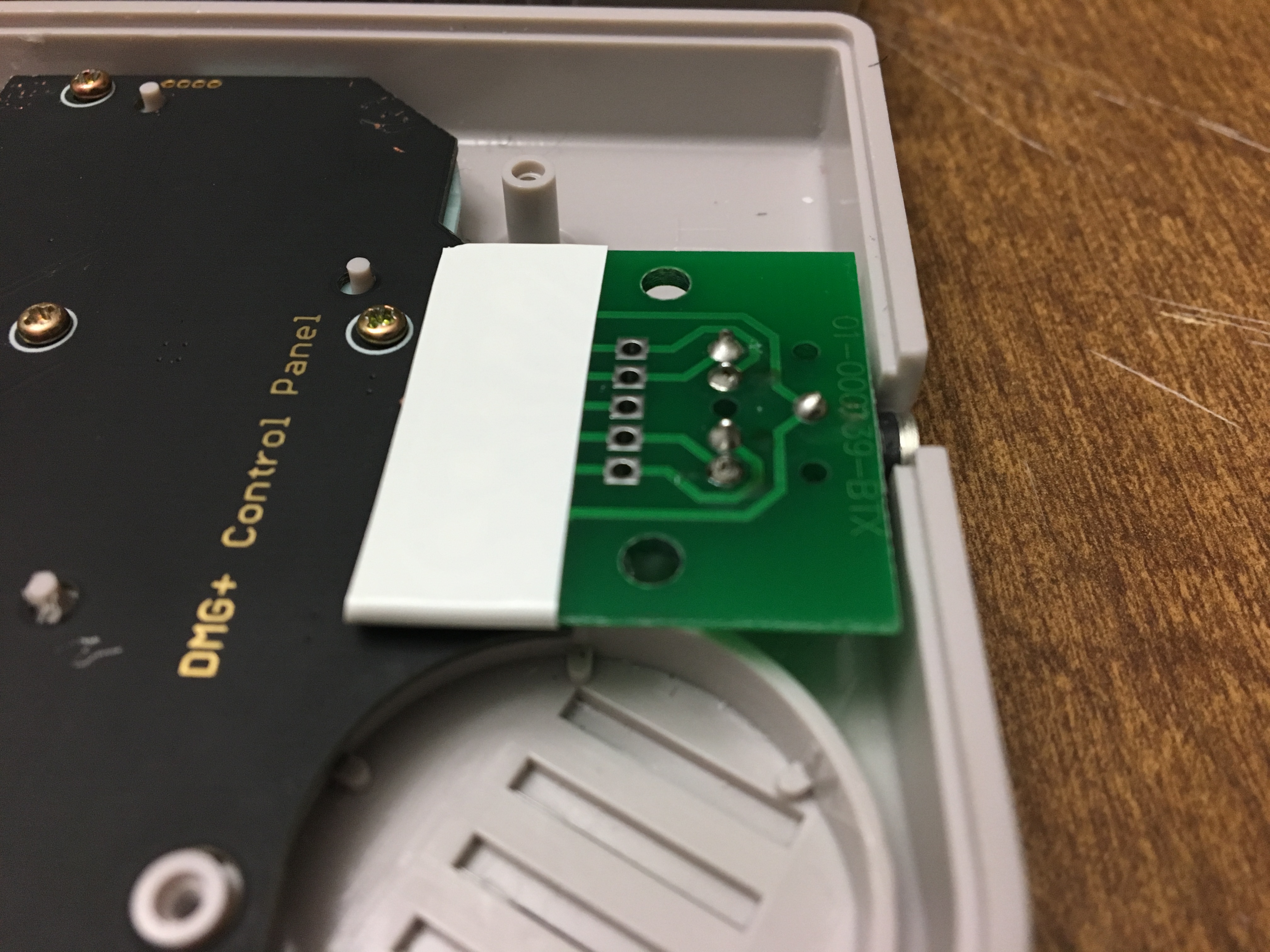

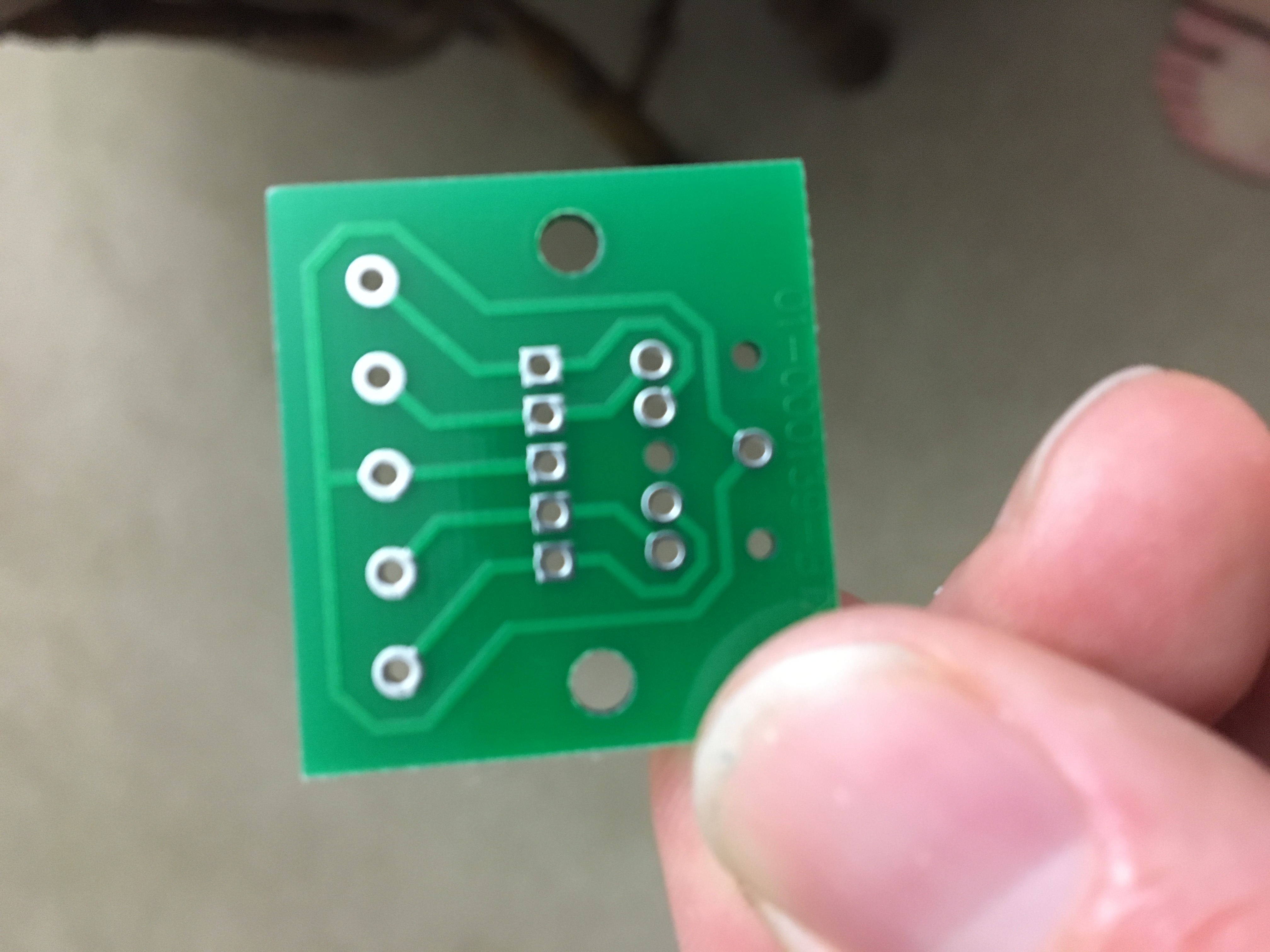

My headphone jack breakout boards arrived today, and I'm pleased to say that I think these will work out great!

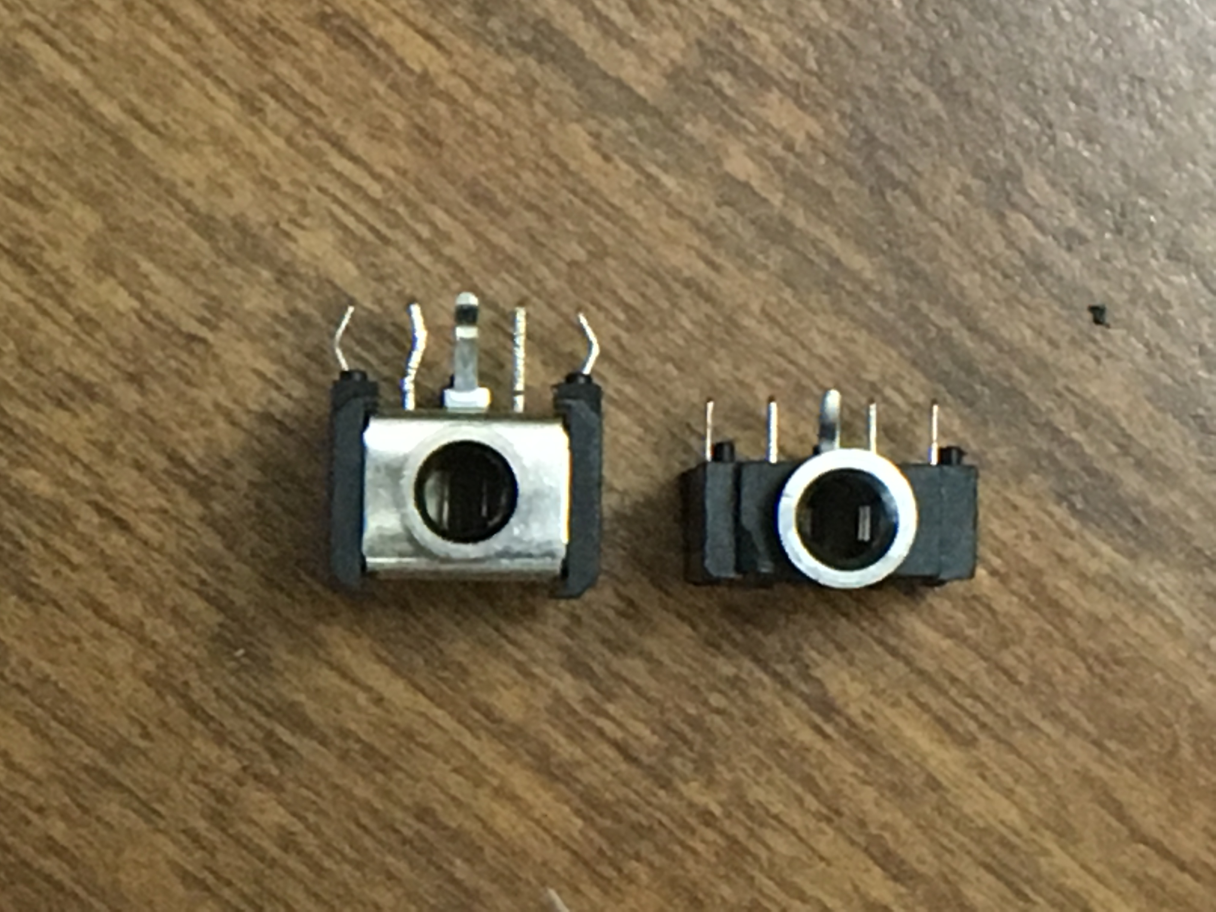

The one problem I did have to solve was the size of the jacks they came with. As you can see from the photo, they're bigger than the jacks I had ordered off of Amazon, with much longer pins. I did a test fit, and the case wouldn't close with this configuration. The solution? I used the shorter jacks I already had with the board instead of the jacks it came with. :D
The end result is a headphone jack attached to a breakout board, which was an absolute JOY to solder.
The one drawback is that the board is a bit large, and winds up sitting on top of the end of the controller board where the plastic peg pokes through that holds the start and select button membrane in place. I ended up using a hobby knife to make that peg slightly shorter to accommodate the board. I did a test fit in the case and it's a very nice fit. The fit wouldn't be a concern if I had Dremeled out the battery compartment, but as I left mine in to accommodate the Li-on battery, there's not as much clearance when you close the case. In order to make this work with the battery compartment intact, you have to shave off the raised supports that held the old GB headphone jack in place. I did this back when I was modding the case just so I'd have some extra room to play with. It JUST fits, with the board sitting pretty flush against the back of the battery compartment when the case is closed.
That lack of clearance means I'll have to solder the wires to the underside of the fitted board, but I can live with that. Just having a breakout board to attach it all to makes it all the nicer.

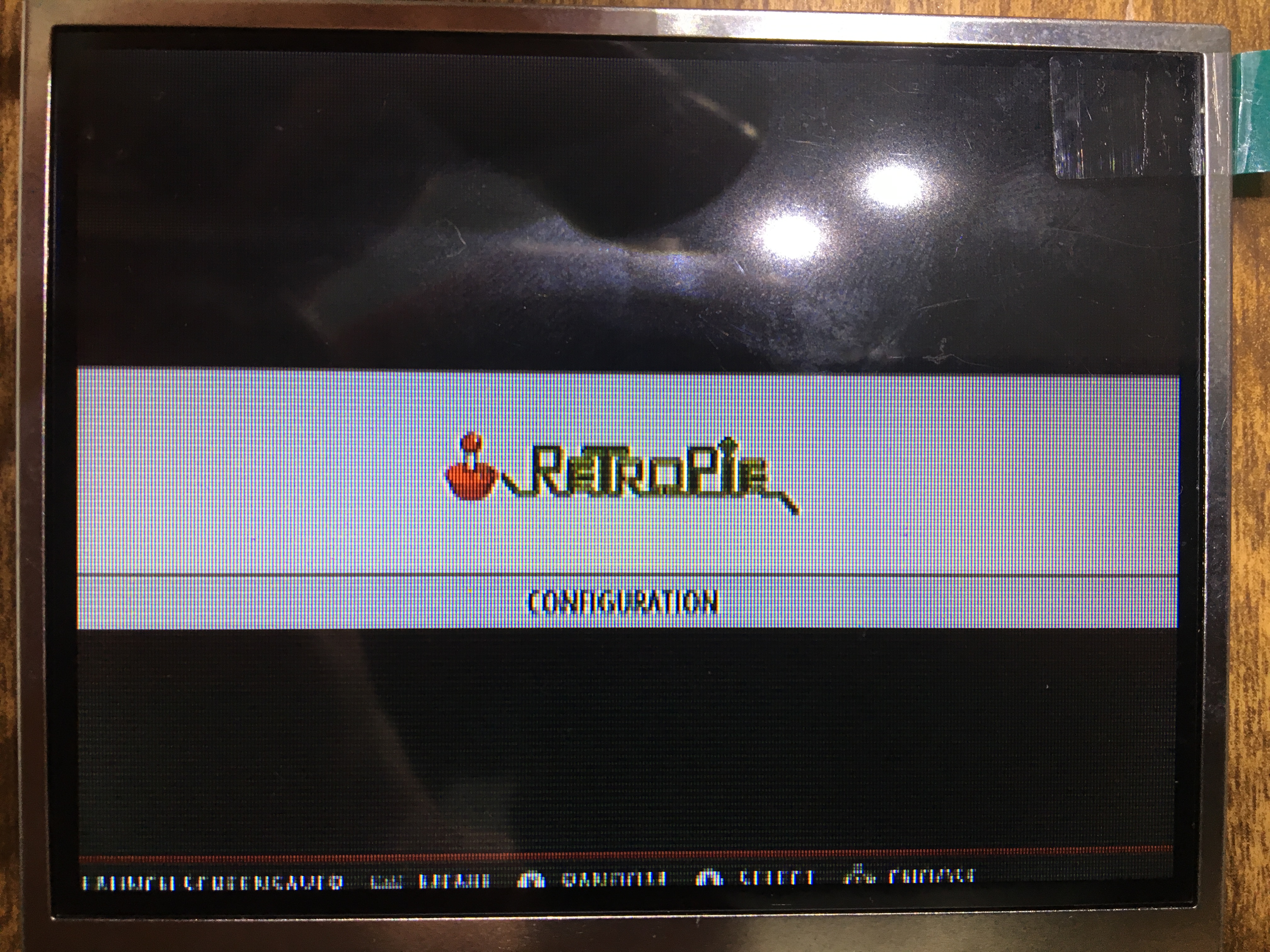

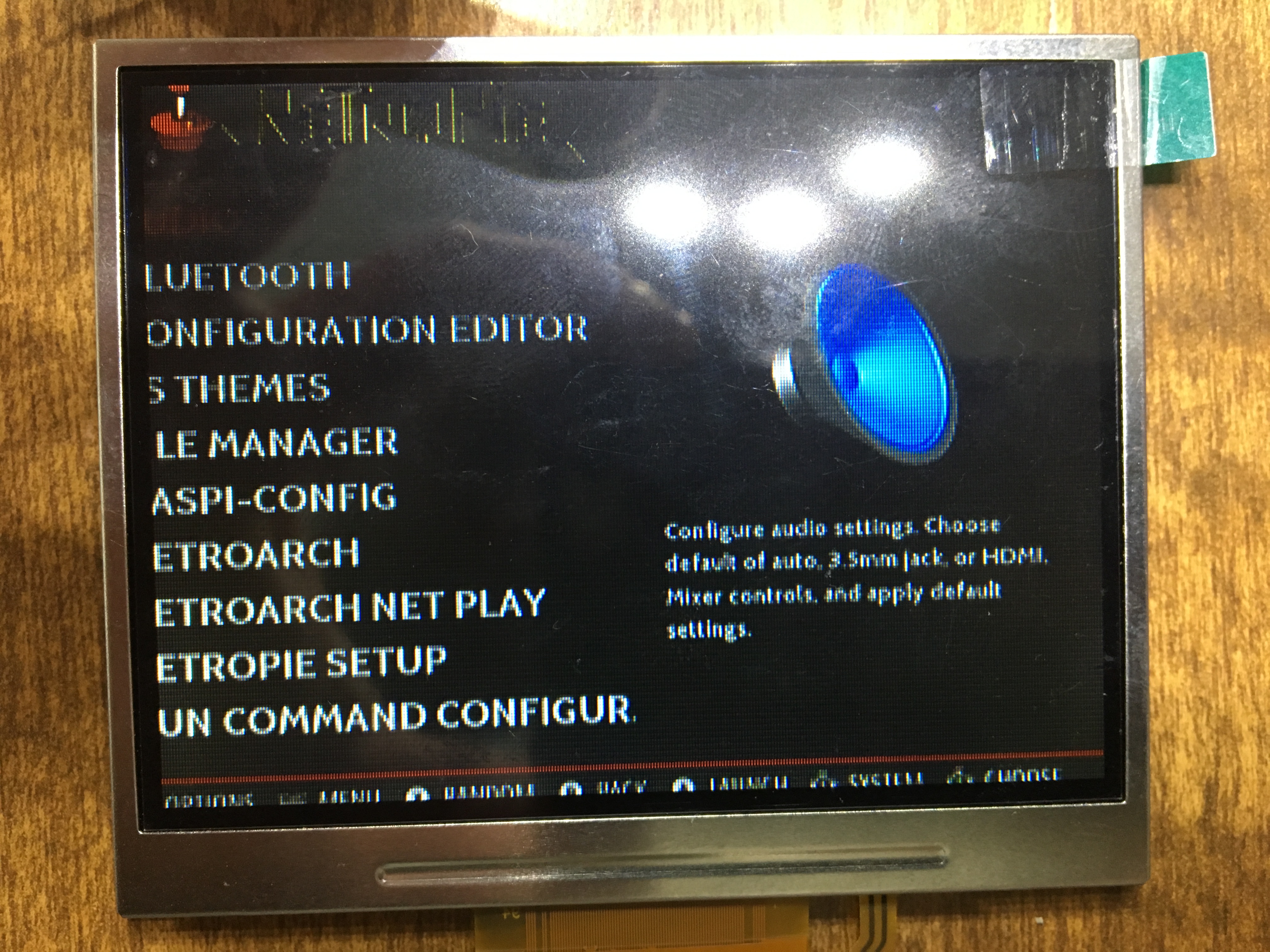

I have a working screen. Huzzah!
It looks like a little of the text is getting cut off though, especially in the configuration menu. Overscan is turned off and the screen has been forced to 320x240 in the /boot/config.txt file. Anybody know how to get that to fit more nicely?
