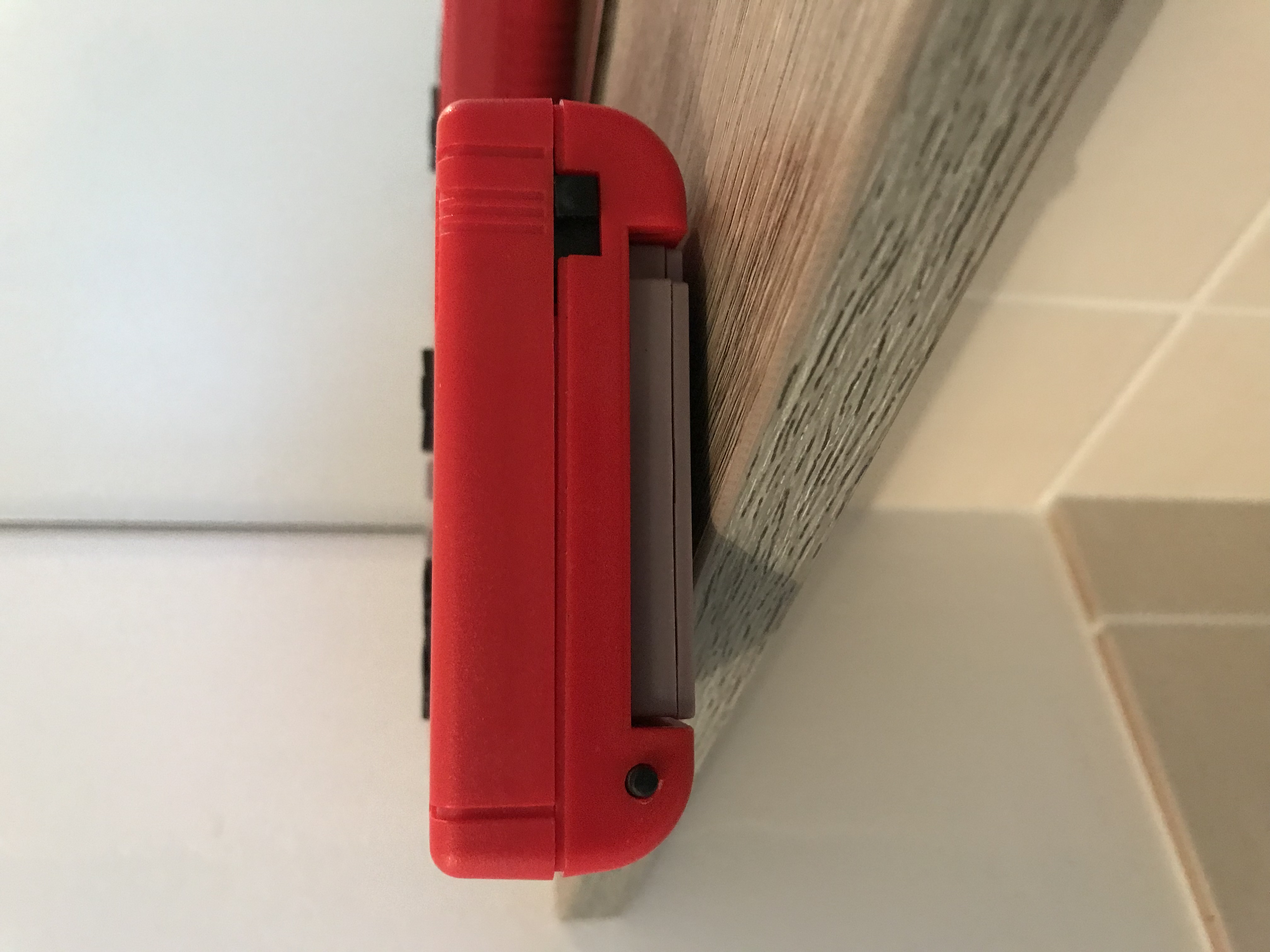

I think I found a minor issue with the mode button. When i fitted it into the gameboy case, the button was not long enough to push in. If I need to adjust the volume or something its not going to work well. So basily I soldered it out for a longer one I had.
https://i.imgur.com/f7rWi3M.jpg
Stock button on top, replacement on the side
https://i.imgur.com/4QoVhWl.jpg
https://i.imgur.com/w0cLQKE.jpg
New button in place
Besides not having a battery I am pretty much good to go, but I do think for future versions having a longer tact switch for the mode button would make things lot easier to use.

You can still dremel it to shorten. That’s what i do to all the tactiles and it allows me to curve the sides of the top so that it does not hurts my finger when i press them.
Zoom in to see the rounded button :mrgreen:
