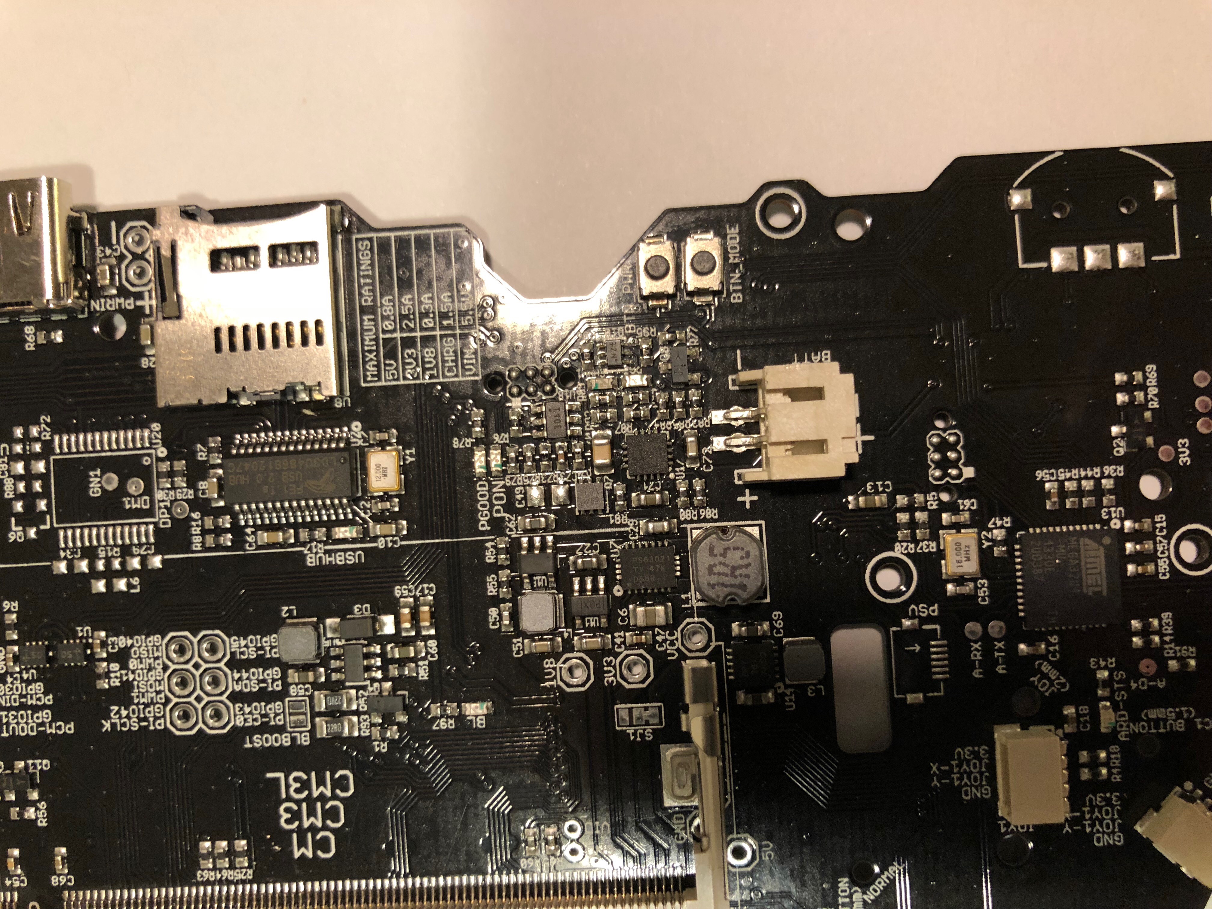

Can you let me know what happens when you now put the correct battery in? And also send some close up (in focus and in light) pictures of that whole power circuitry area (around where the batt connector is) as I can assess what chips may have had it. It SHOULD already have reverse protection built in on the main charging chip.. it should be possible to repair if there is damage, especially as I'd be interested in seeing what happened in this case!

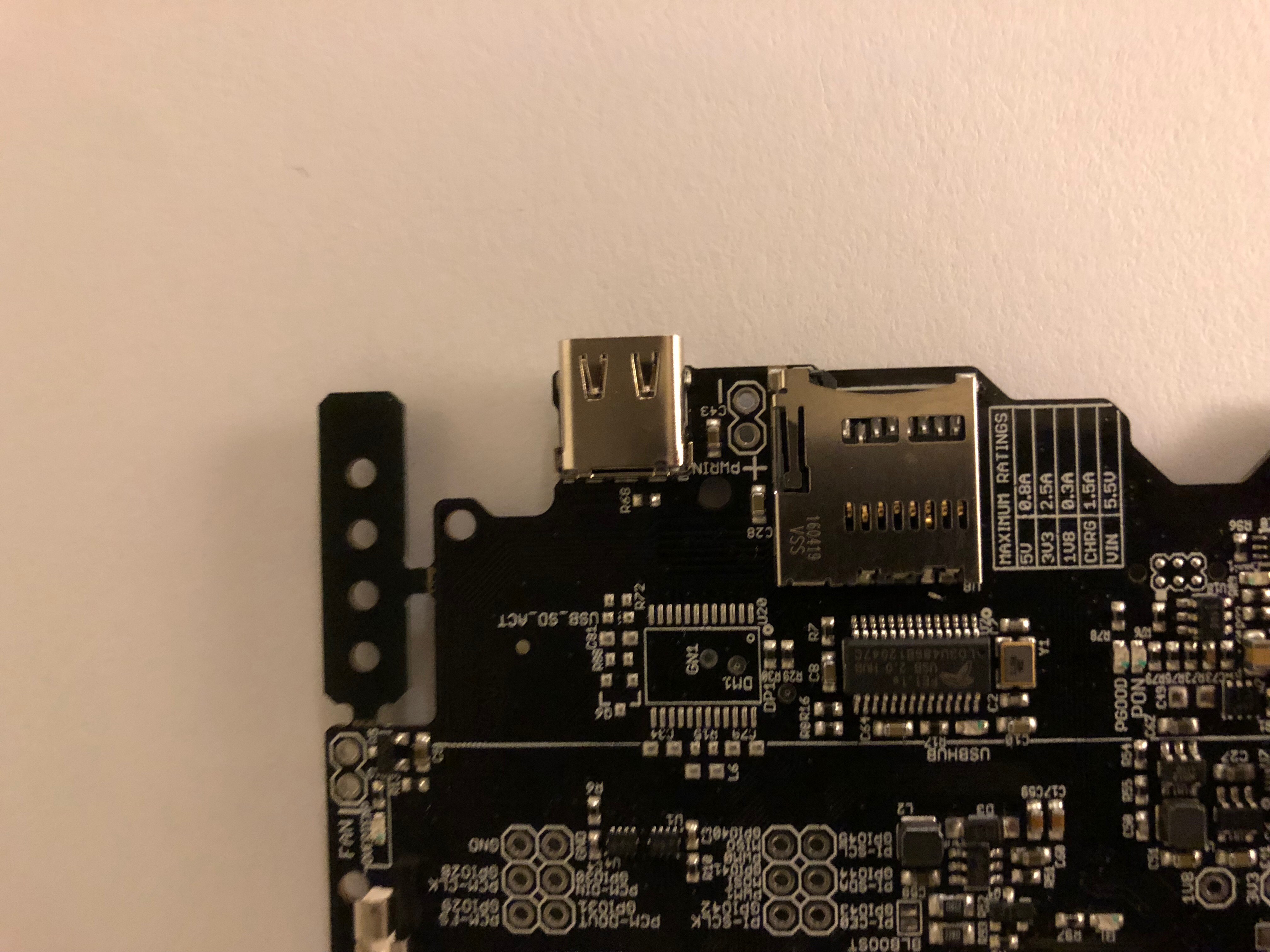

When i disconnect the battery and connect the USB-c everything is back to before like a flashing christmastree. so the problem seems to be with the USB-c and powersupply circuitry. I've tried 2 different USB-c cables and poweradapters with the same results.
here's a video how it looks when USB-c is connected:
https://youtu.be/K2cehhQ2NhI
To shine some light on what I did in order for all of this to happen :( , here's the steps in chronological order in detail:
1. connected USB-c to the mainboard (no other components attached)
2. verified the PG RED led lit up
3. Pushed the powerbutton and verified all the leds lit up inkluding the 5x power leds
4. disconnected the USB-c
5. connected the faulty polarity battery (noting happened, ie. nothing lit up)
6. connected the USB-c (noting happened, ie. nothing lit up)
7. disconnected the battery and the USB-c
8. connected the USB-c (PG RED flashing and pushing powerbutton starts flashing the leds intermittently as shown in video above)
closeup of USB-c connector and surrounding components
closeup of batteryconnector and surrounding components

Post by kite » Tue Feb 20, 2018 2:51 pm
Hm, with battery in and USB C, does it look like it is charging or does it still do the weird flashing thing? Do you have one of those USB power testers that show the current reading? If so use that and see how much power it is able to pull..
The only thing in between the USB C and the rest of the board is the battery charge IC, I suspect that is the only casualty here.. if you PM me I can repair that board for you (£15, includes return postage)
