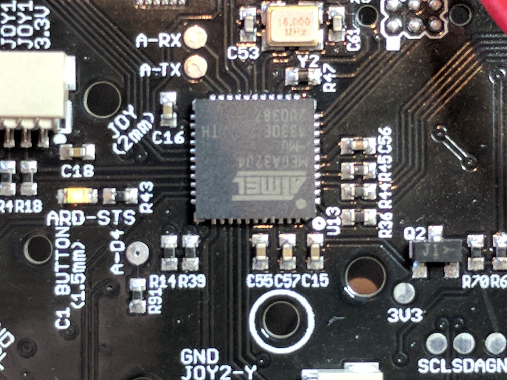

Can you measure the voltage here (next to the arduino chip) when the screen is WORKING and also when it then fades white. Also can you show a closeup picture of this area?

It booted once into emultation station, faded white and the screen hasn't displayed anything since. Just the backlight turns when I turn the device on. I'm getting 3.3V between that pad and ground. Also, here's the requested picture.

Hm, might be best to send me an email and send it back as I don't know what the issue is. It sounds like the Pi is freezing or crashing perhaps.. the LCD seems ok and that pin is the reset pin and it's still 3.3v which is good.. If you're running it with a battery, and a freshly imaged SD card.. and still doing it, then send me a mail and we'll sort out a return!
