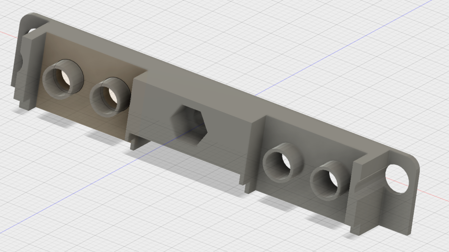

First off, I need to thank kubino for sharing his 6mm L1,L2,R1,R2 bracket, which my bracket is a remix based off of. Now that I have my hands on one of Kite's gorgeous CSO boards, I really wanted to take my time and figure out a back button solution I like. Most people around here agree that regular tactile buttons require a lot of force and do not feel great on the fingers. Inspired by Hoolyhoo's new soft tactile solution and Kubino's bracket I decided to mash the 2 together.
I present you the soft tactile button bracket and buttons:
soft tactile bracket.png (307.63 KiB) Viewed 5461 times

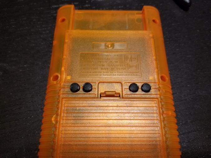

dmg w bracket.jpg (46.85 KiB) Viewed 5461 times
Everything goes together nicely, with no hot glue :mrgreen:

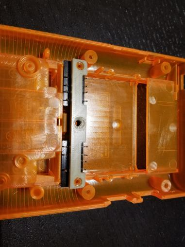

dmg back.png (316.17 KiB) Viewed 5461 times

Awesome, I've been looking for a layout like this without the noisy click. This is for the 8x8mm buttons right?
Yeah, the bracket was designed for 8x8mm buttons.
