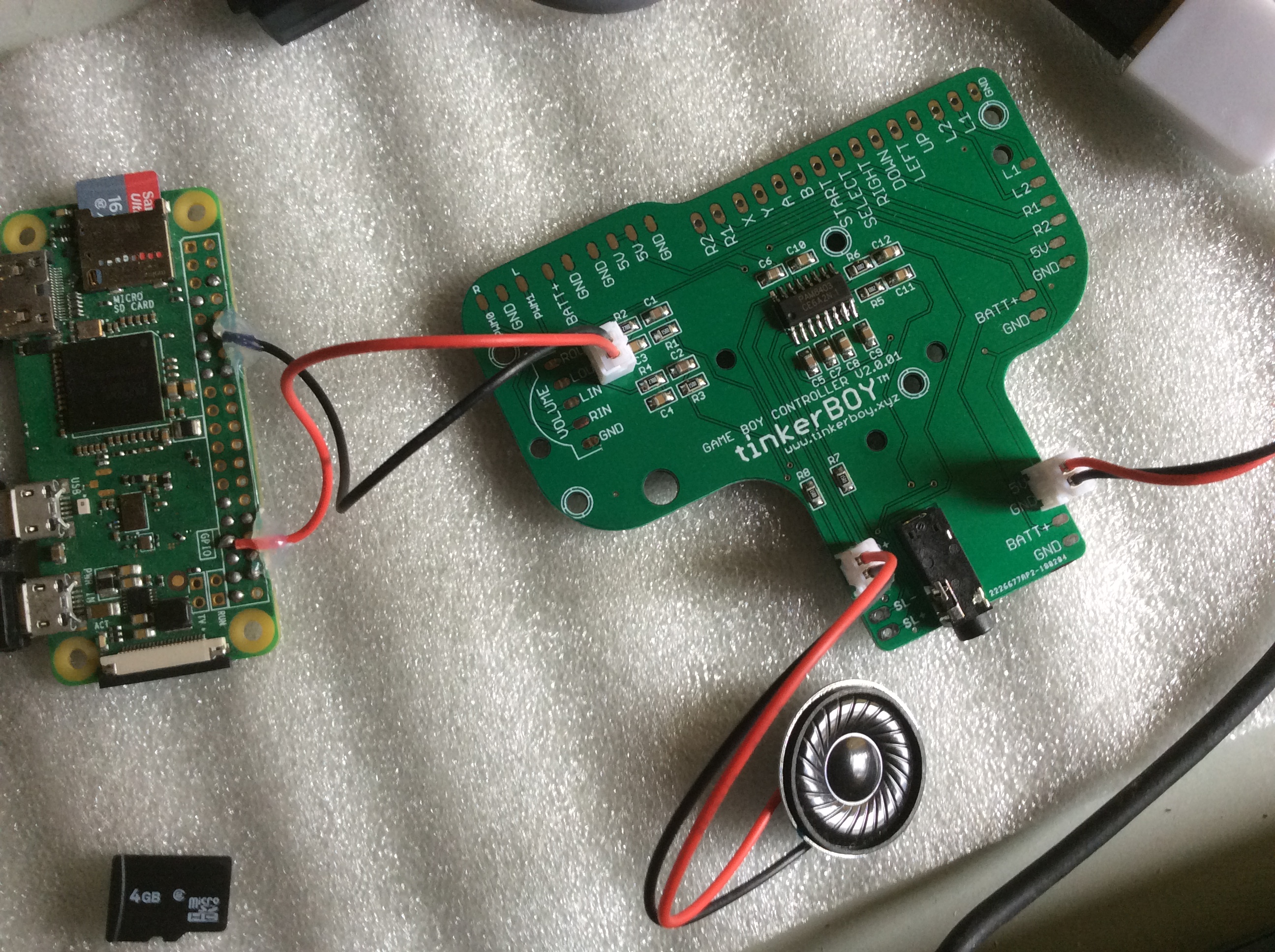

I always test every component before putting them all together. I start with the Pi by downloading and installing the OS, connect a keyboard and a monitor. Most of the 3.5" LCD screens have the video cord you can connect to a tv with av connections so you can test it if it works. These two, the Pi and the screen are the most important parts so make sure you test them. Same with the other parts, just find a way to test them individually if you can.

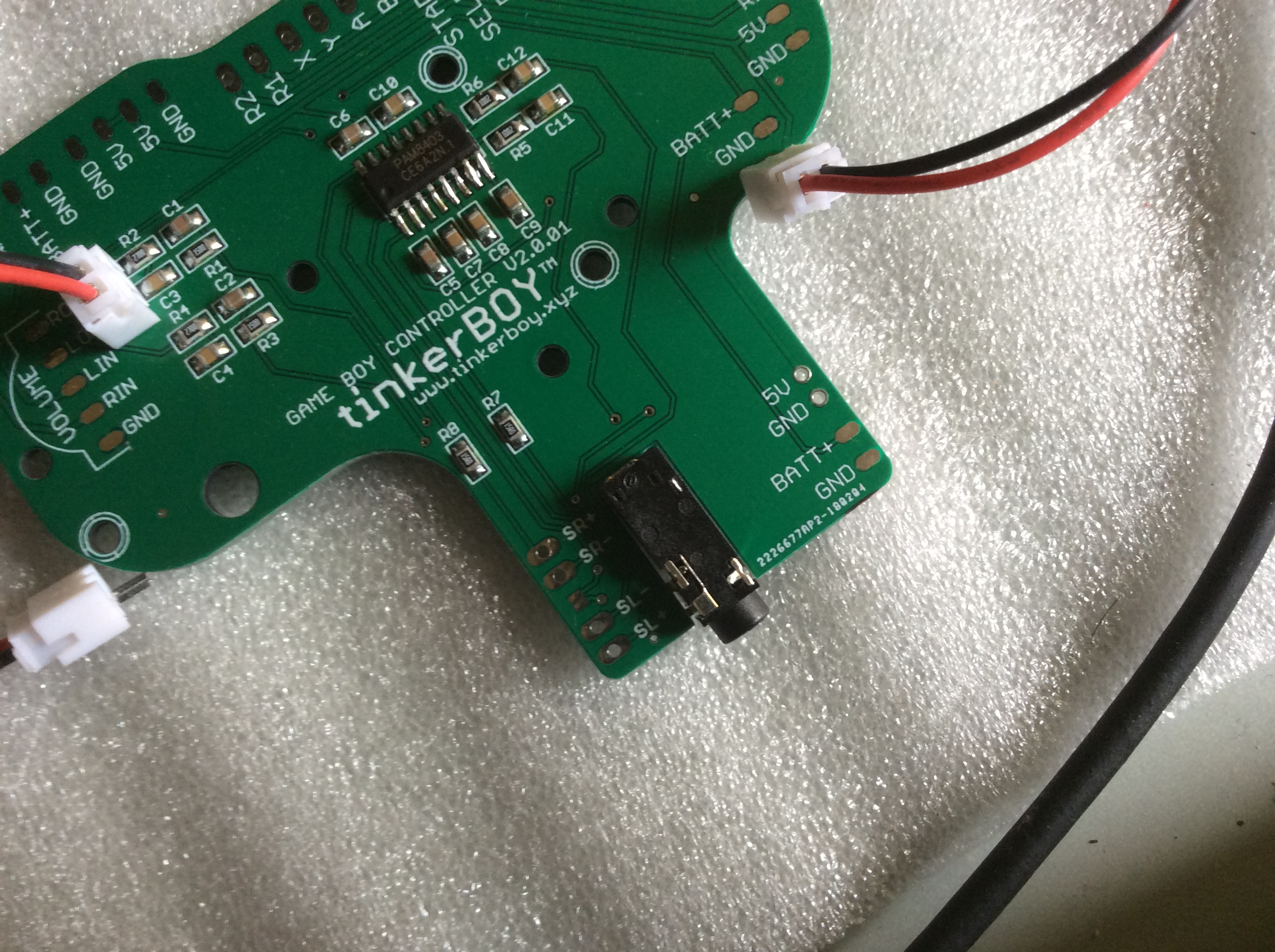

On my v2.0 and v2.1 boards I made some of the pads so I can easily put in a jst connector without having to solder it for testing purposes.

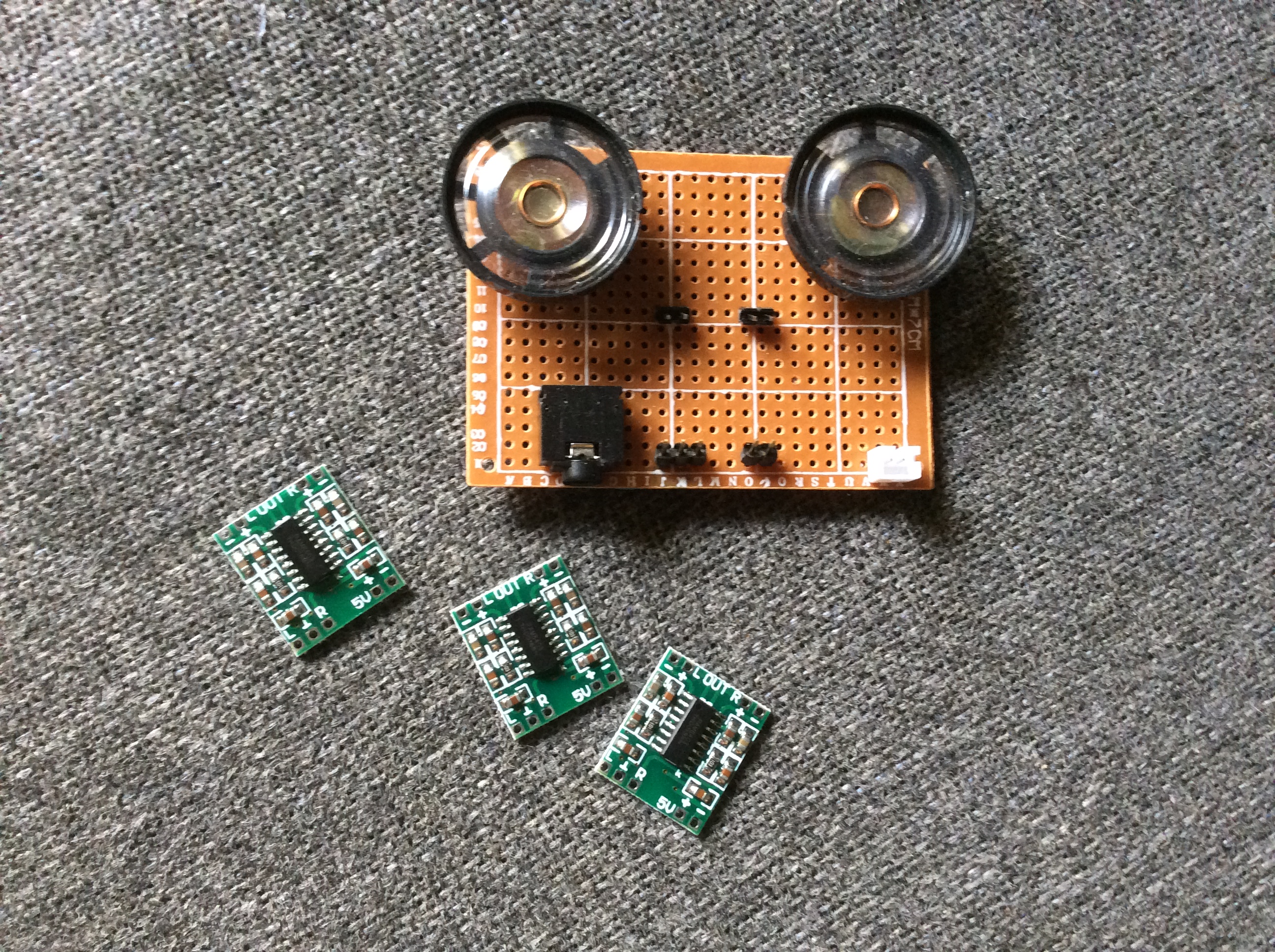

I also made a simple board for testing the audio amp pam8403.
