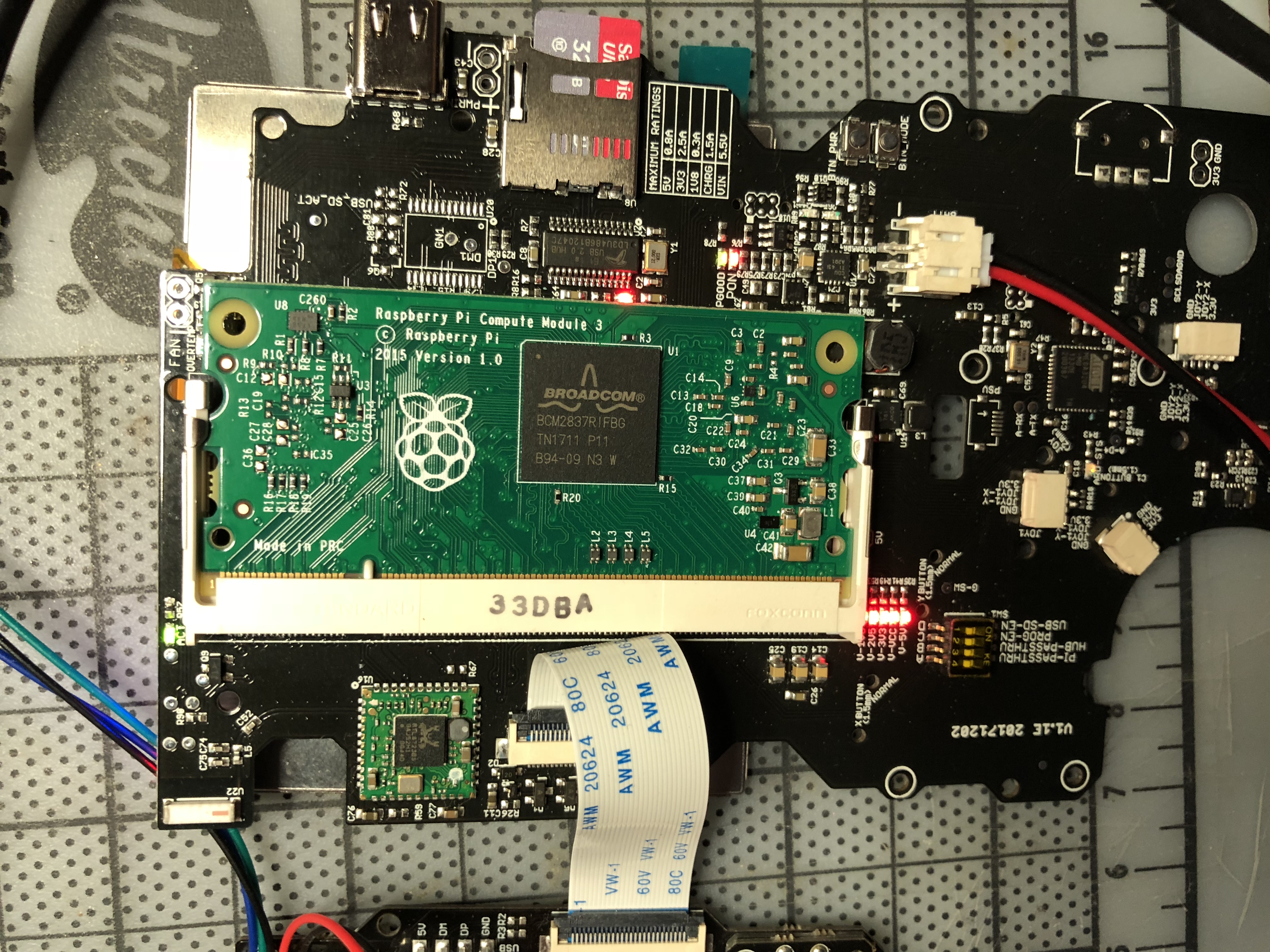

Hello, I'm having an issue with my Circuit Sword 1.1e connecting to my wifi network. I tried to search the forums for answers, and even though there are similar problems, none of the solutions seem to work.
  • onboard wifi able to see list of available networks, but is unable to connect to my network when i input the password
  • using a USB dongle wifi worked (rules out keyboard issues since password worked this way)
  • blue wifi light is on
  • tried changing keyboard language to 104 English keybaord
  • tried wpa_supplicant.conf method but didnt work
  • tried using wifikeyfile.txt with no luck

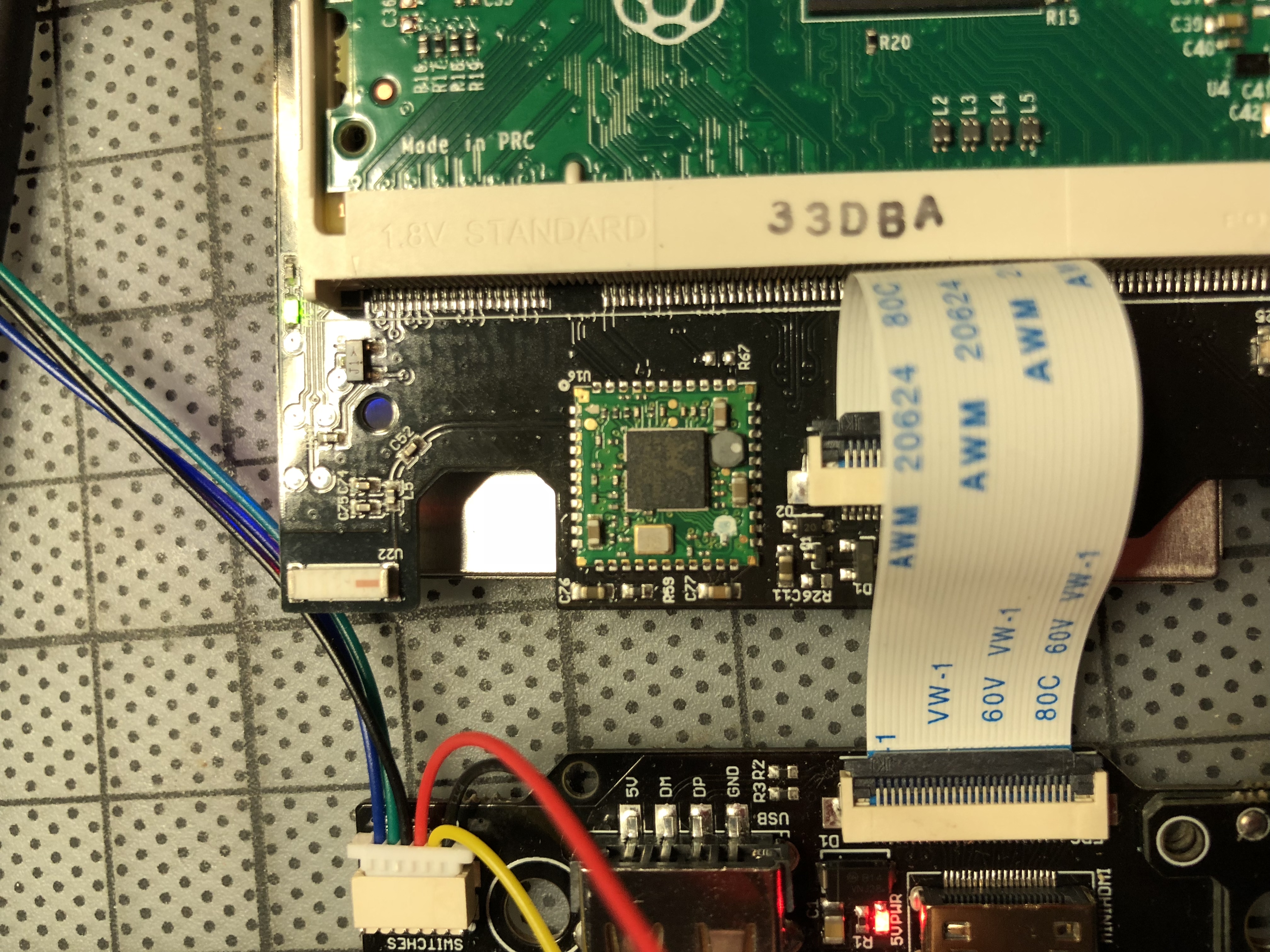

  • tried adding Keplon tape to wifi module but i dont have the board in a case so shorting by USB can't the problem
  • using retropie-4.3-rpi2_rpi3_pi_4.14.14-v7+_CSO_CM3_20180212-074145.img
  • tried flashing card with fresh install several times to same result
It just doesnt want to connect... Is there anything else I can try?? Am I missing something?

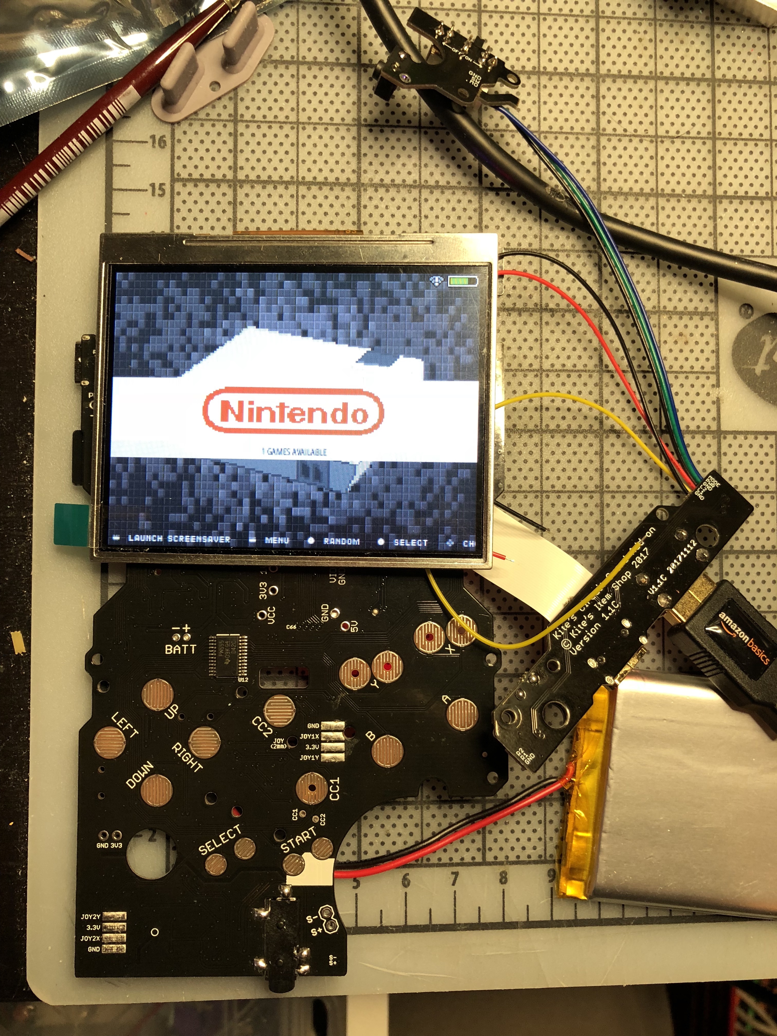

Ive attached a bunch of pictures so you can see if there are any lights not on or something.
Thank you in advance!
back shot
Blue wifi light is on

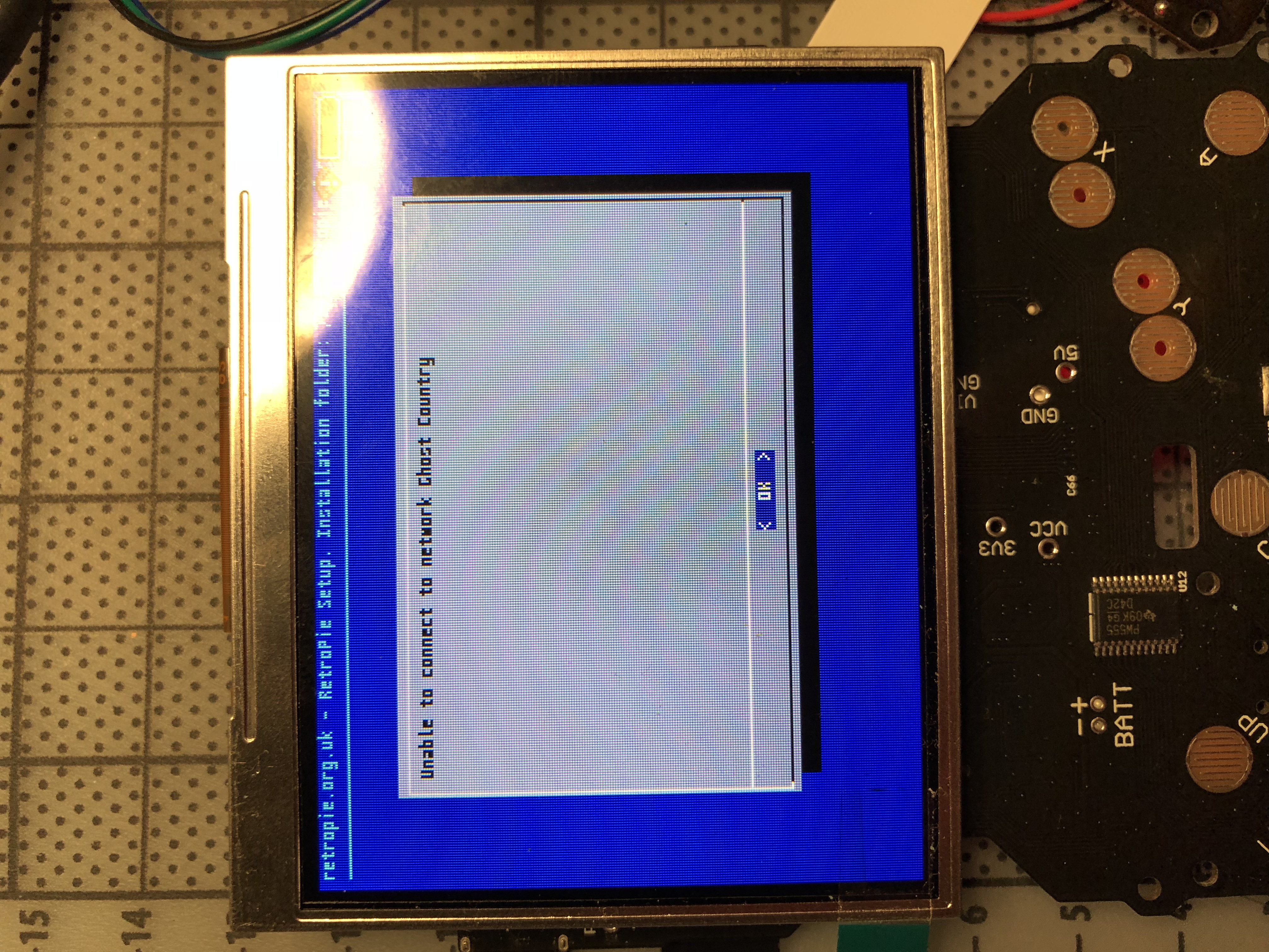

Ok so I tried disabling the wifi module in config and it still prints the error in the messages.
Then I used a fresh SD card and tried to start over to udpate the kernal. I tried to run rpi-update using usb wifi and it installed the update but it seems to have turned off the wifi module. I unplugged the usb wifi and turned on the board, so while the blue light is on the wifi icon is crossed out, pic below. Using the MODE + A buttons doesn't seem to turn it on. It still prints the error in messages, link below.
