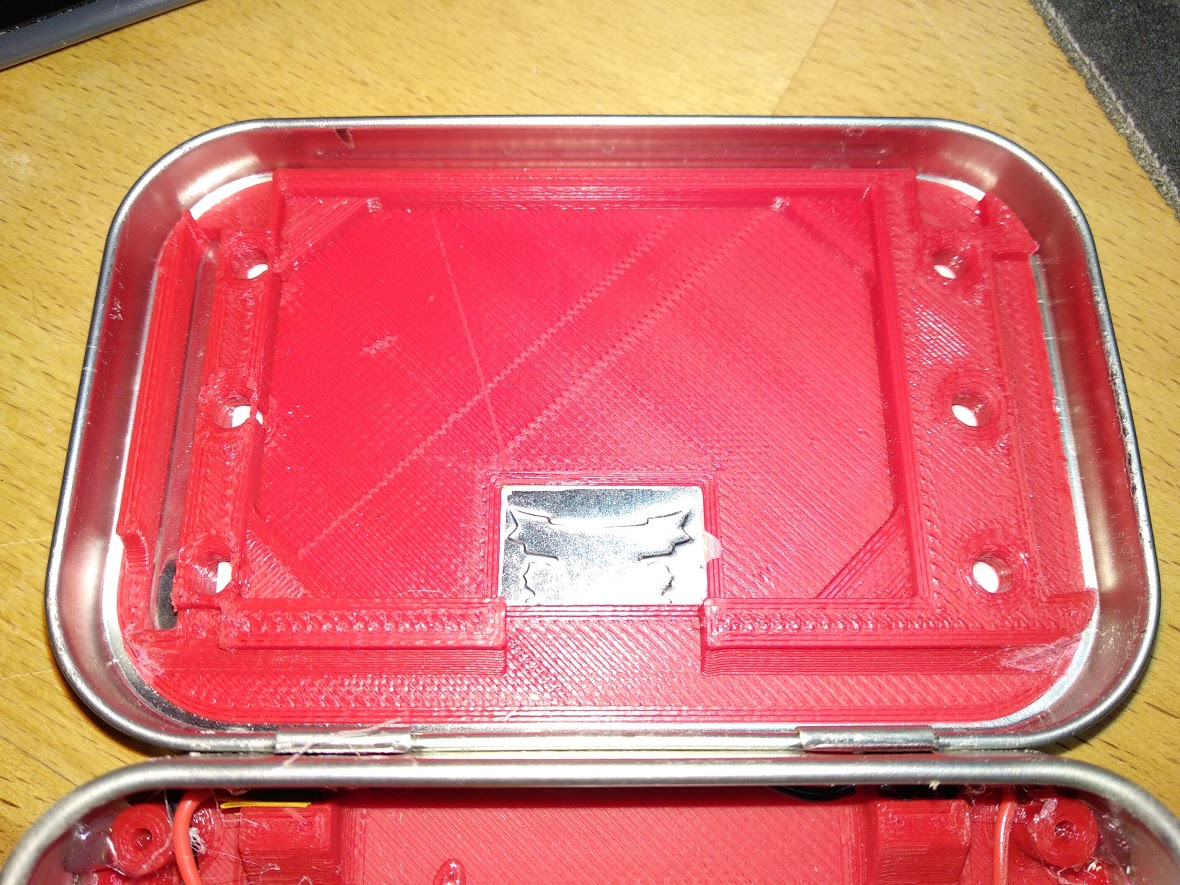

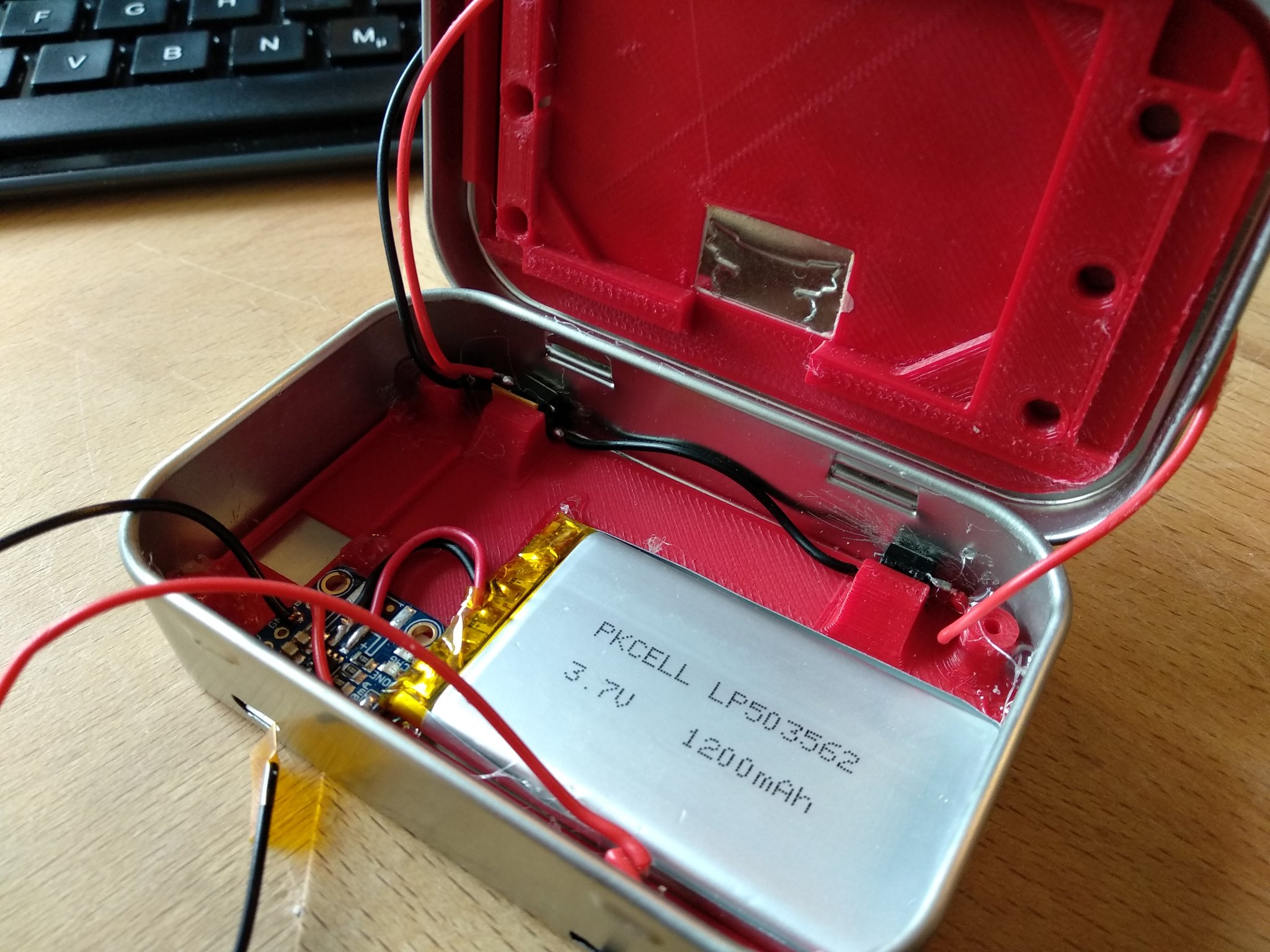

today i got the Battery and the MicroLipo-PCB from Adafruid and decided to start my build.
Here is what i have done so far.
DZDS8YuW0AACYhU.jpg large.jpg (389.05 KiB) Viewed 5517 times
DZDS-AkWAAAmn9w.jpg large.jpg (411.88 KiB) Viewed 5517 times
Maybe i used a little to much hot glue. But better more then less. :D

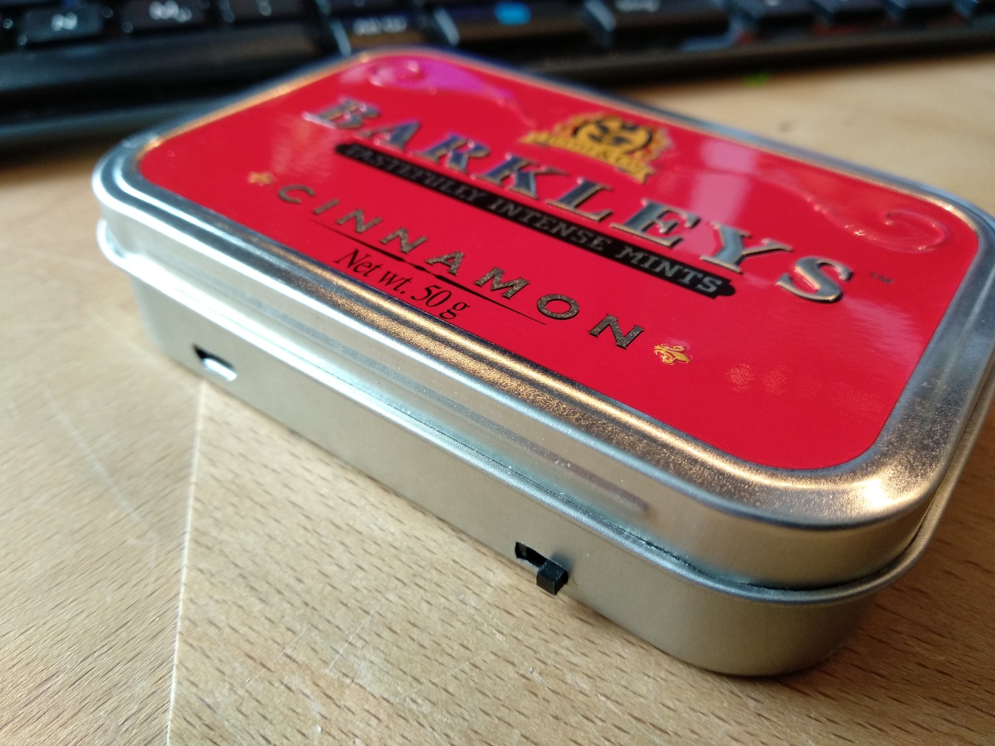

I used the stock files (updated ones). I had to file down the edges of the screen backplate and the bezel. It seems like the "edge" on these Barkley-Tins is a little bit bigger then on the Altoids tin. But it's not really a deal.
Maybe you can see what i mean in this picture. Look at the lower corners. I had to file a little bit more on the right side.
I'm not really sure if this is because of the edge, tolerances on my printer or if i positioned the backplate wrong when i glued it in place with double sided tape. If i will ever find a Altoids tin i will do another build just for verifying this. :D
