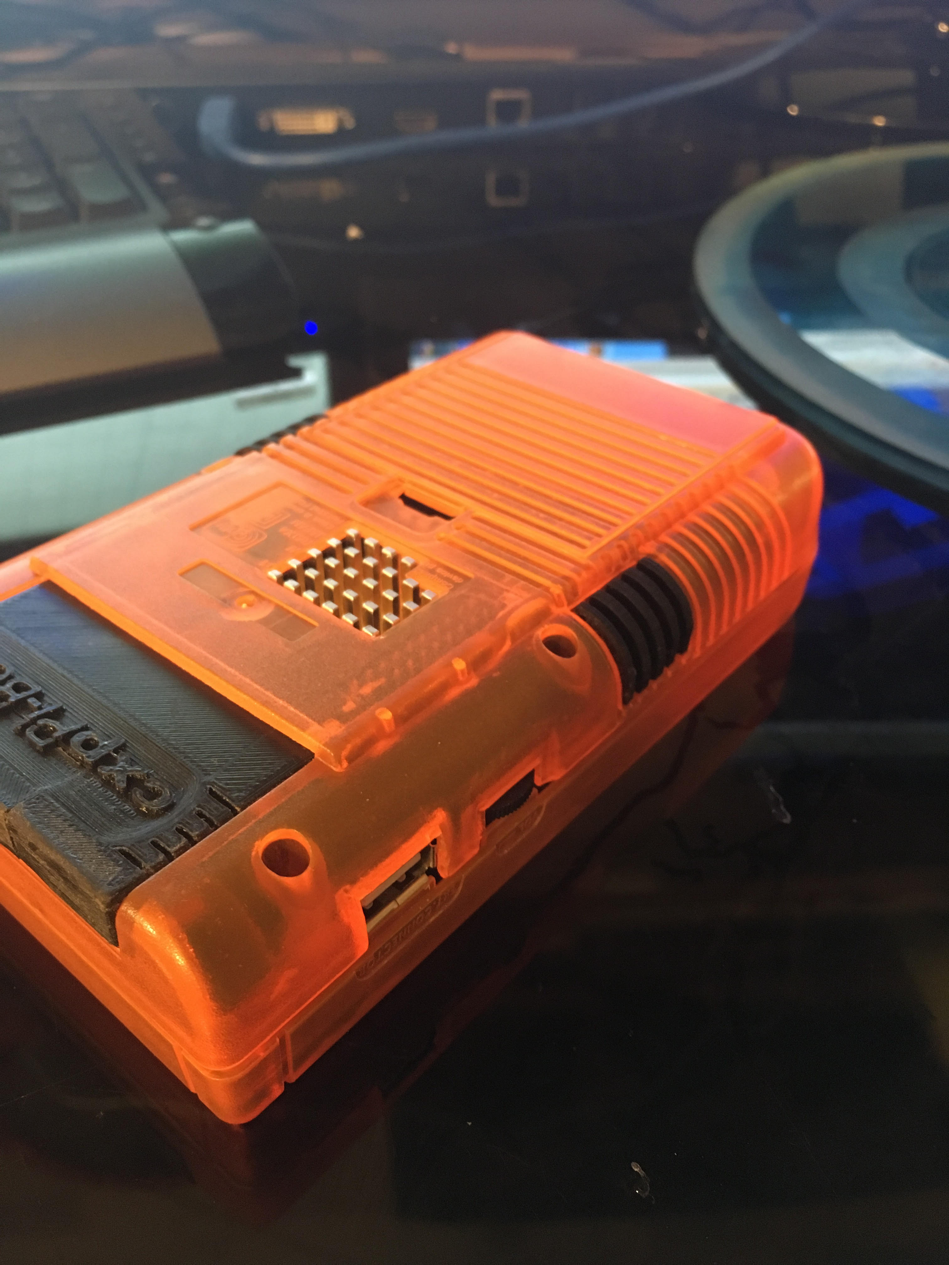

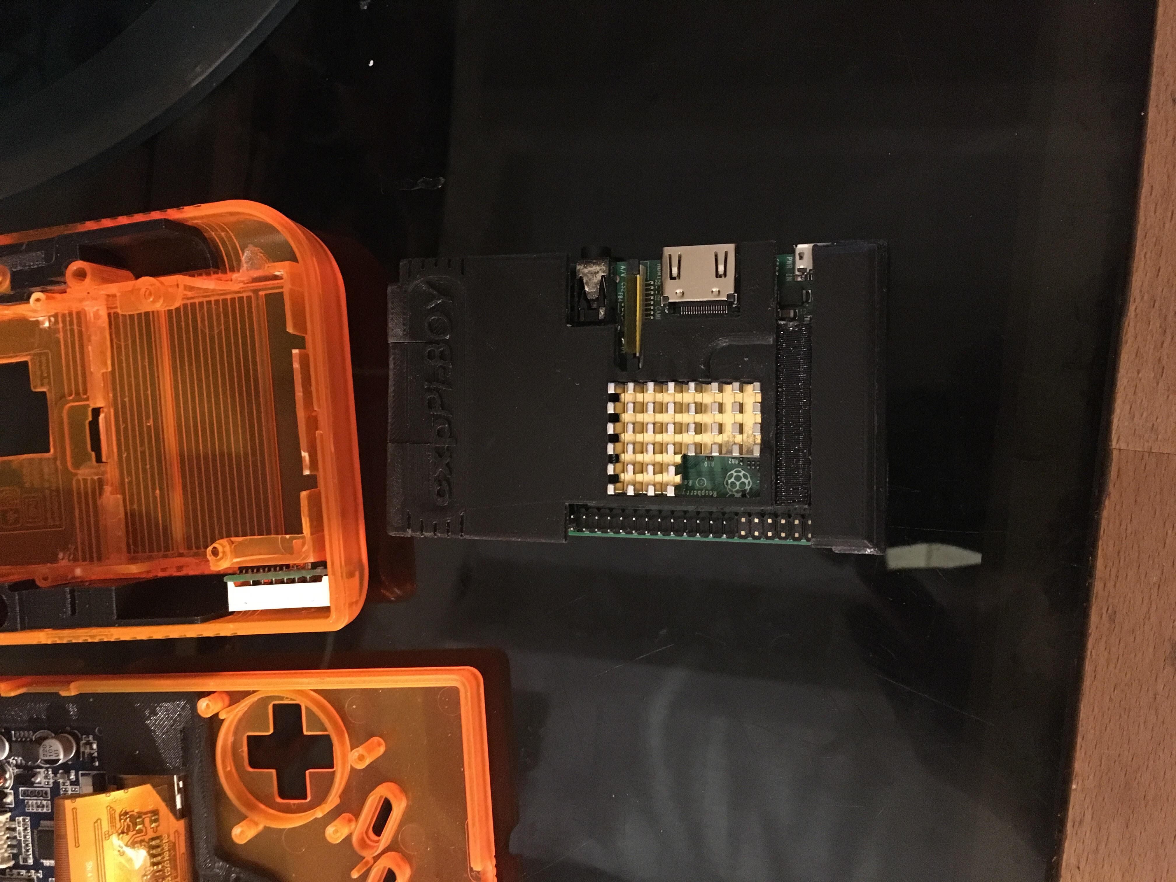

- the L and R bottom buttons and the cpu's heatsink
- pi6.jpg (1.01 MiB) Viewed 8555 times
- pi2.jpg (1.22 MiB) Viewed 8555 times
- and the roms usb "card"
- pi7.jpg (1.27 MiB) Viewed 8555 times
- the raspberry pi "cartridge "
- pi8.jpg (1.38 MiB) Viewed 8555 times

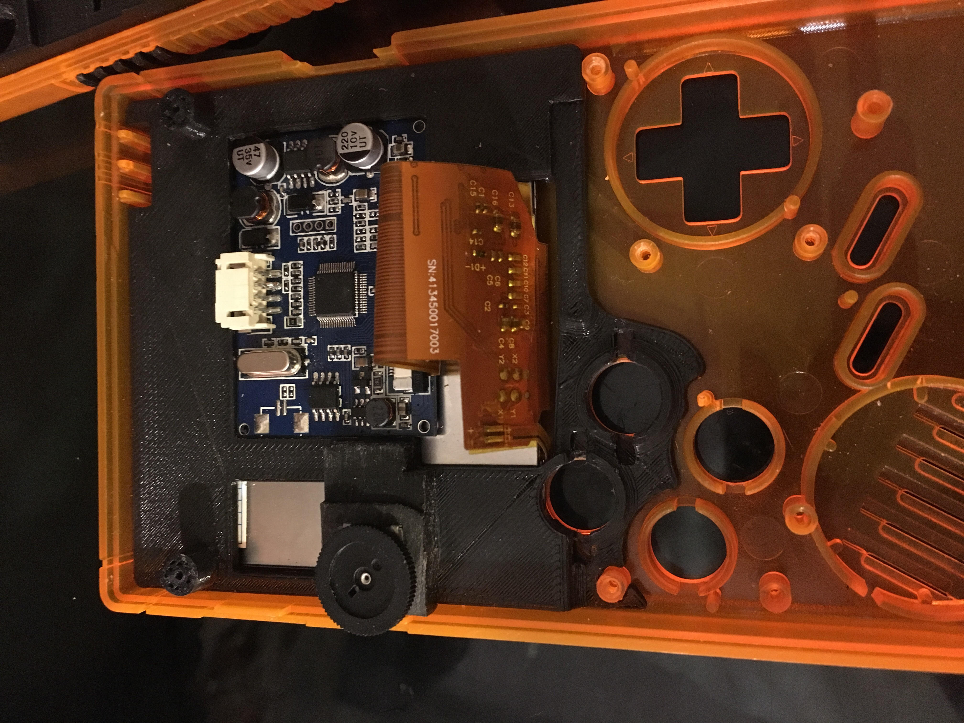

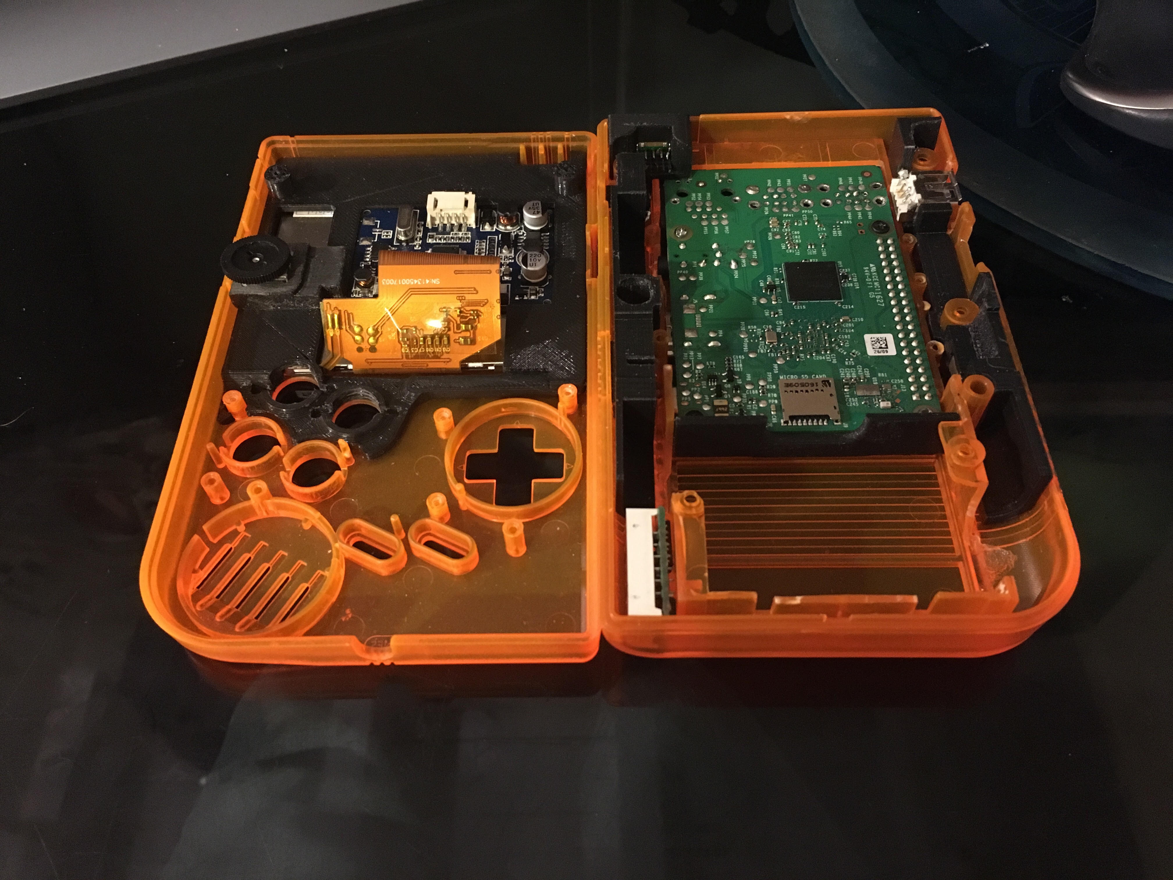

- screen attachment with volume control and x y buttons casing
- pi11.jpg (1.51 MiB) Viewed 8555 times
- actually inside
- pi10.jpg (1.39 MiB) Viewed 8555 times

wow. very cool idea for L/R buttons !!
can you show me more detail for those buttons?

I'm very much interested as well!bigteddy82 wrote: ↑Wed Apr 04, 2018 8:35 amwow. very cool idea for L/R buttons !!

as for the sharing of stl, I agree but they are modeling adapted to my parts.
I work a lot with recycling parts.
the stl are also tailor-made for cable runs.
if you really wanted, I would share the most relevant ones.

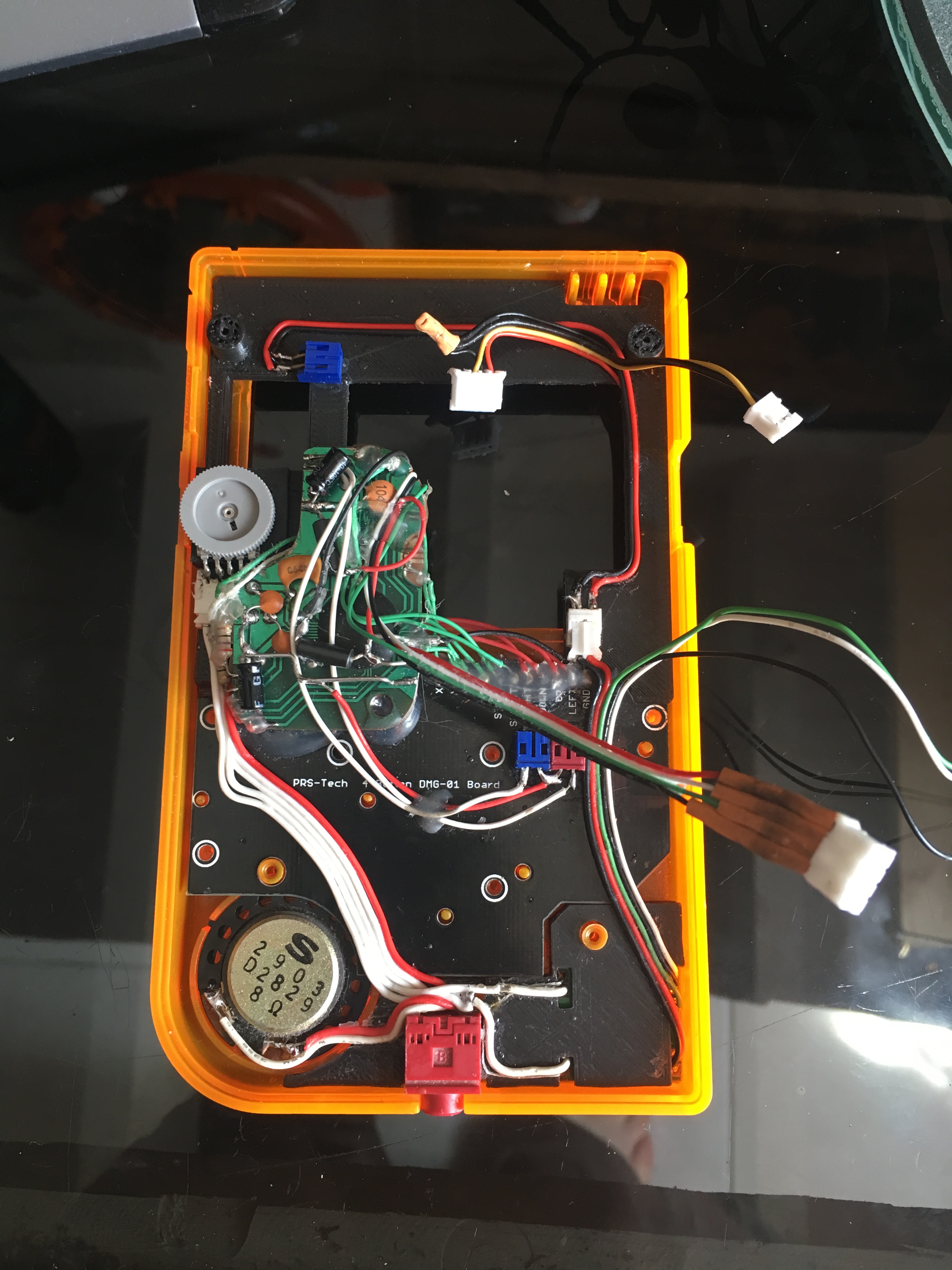

otherwise, the build has progressed well, I only miss the screen and lipo to finish.

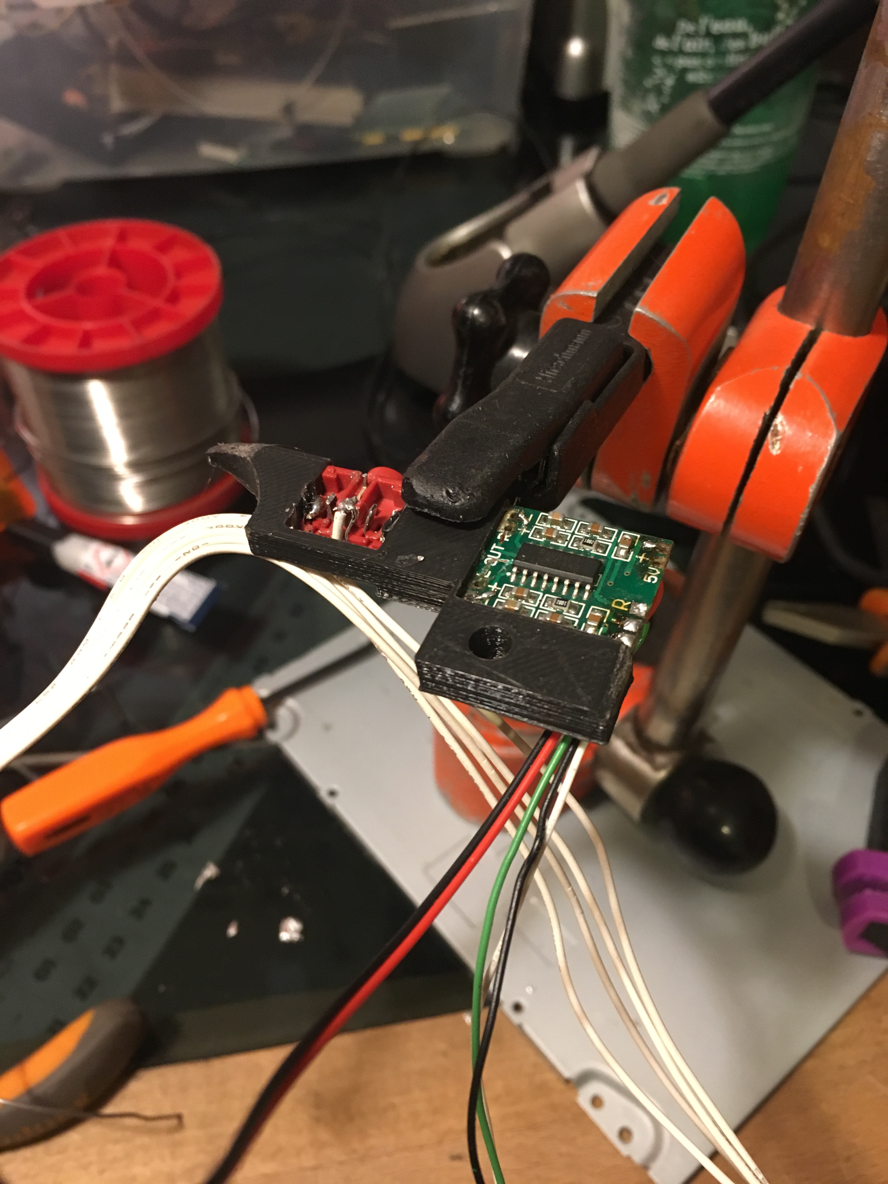

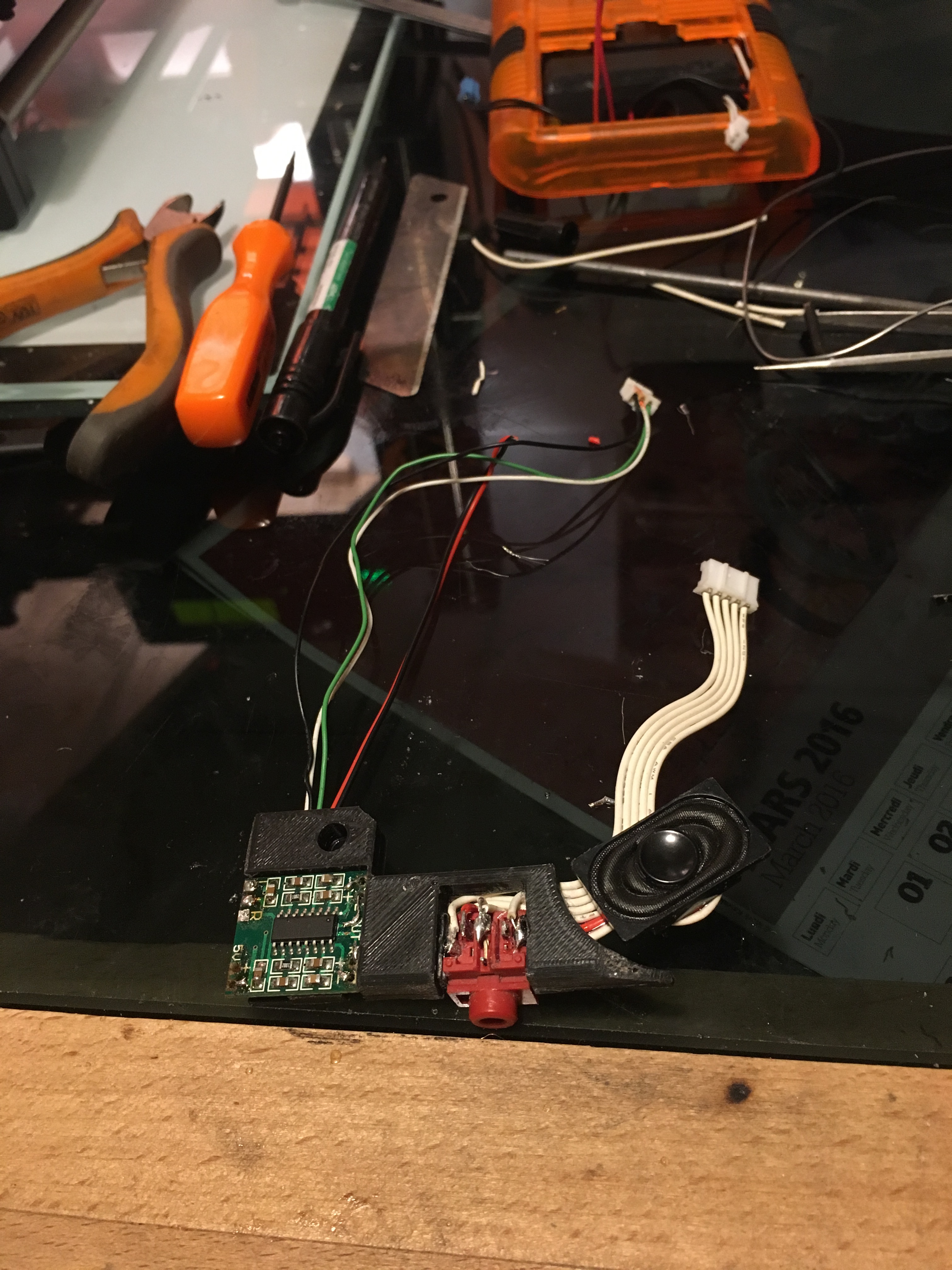

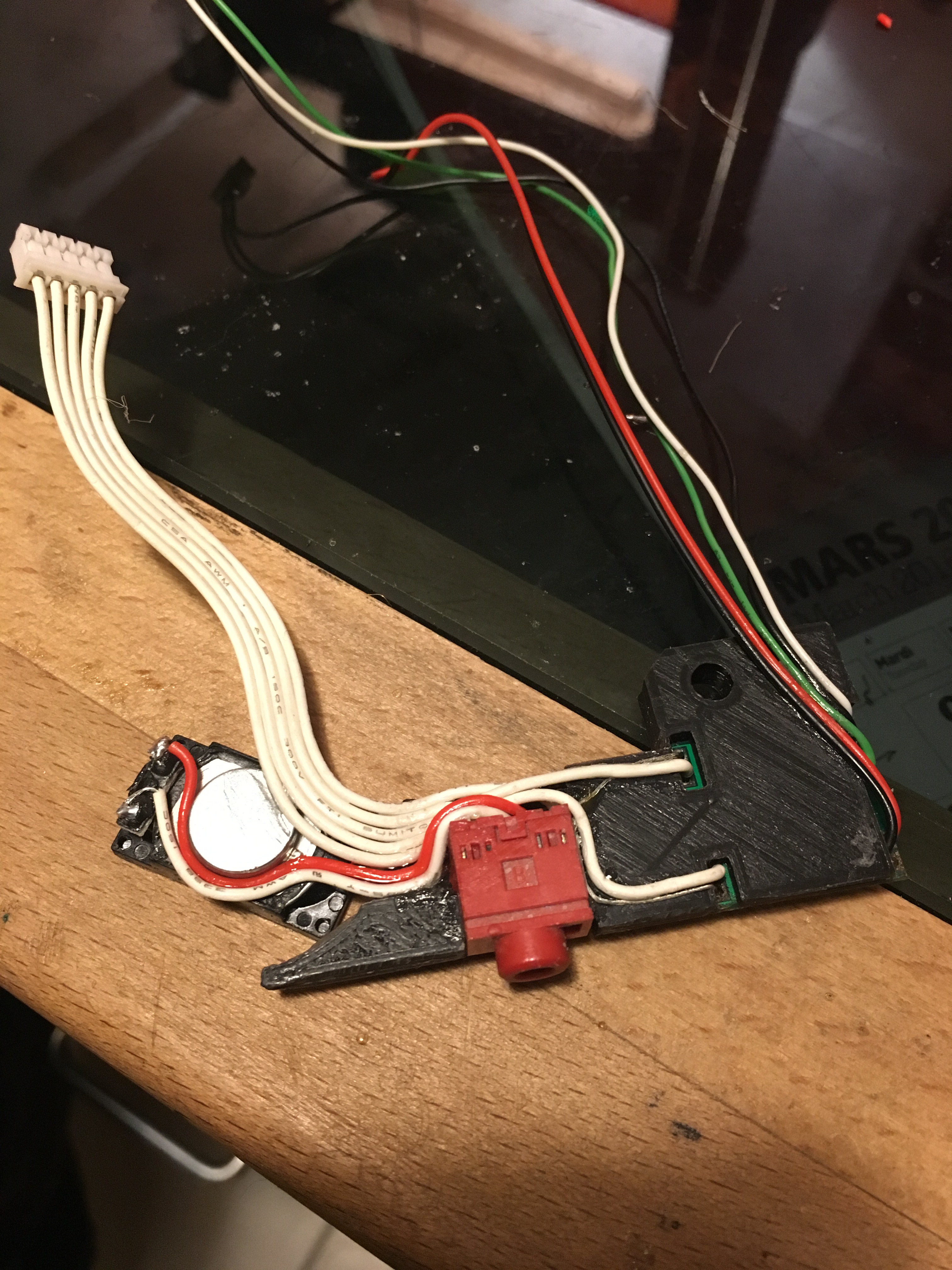

I did the audio part:
the square speaker was for testing, the one in place comes from a gameboy.
2x3w ebay amp (there was mistake because i was using this board for another project) ,
pc sound card jack connector,
3d printed support,
cable glued to make rigid ribbon.
the volume button is fixed on bezel
all parts are dismountable.
for all the project i was using fax connector
the set is perfect for maintenance and the interior is clean!

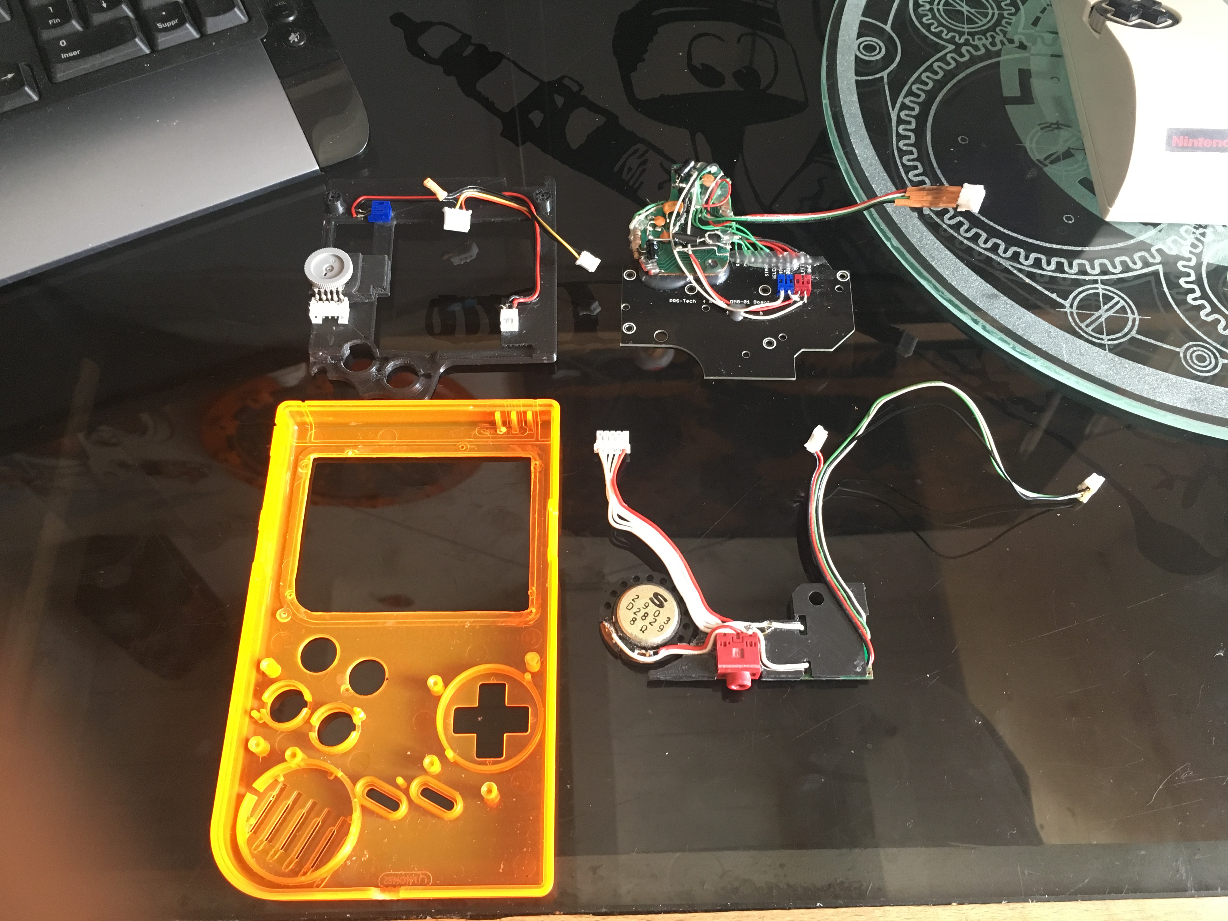

here is near the final.
this is the final color's button configuration.
the lens is a test with cd case..... it's poor quality!
(i have order a gorilla glass on ebay)
