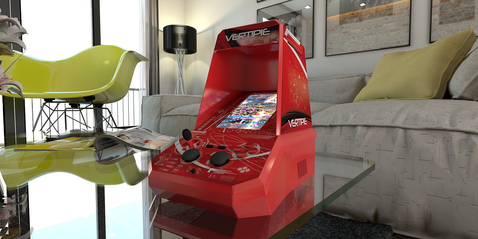

vertipie red.jpg (210.64 KiB) Viewed 12060 times

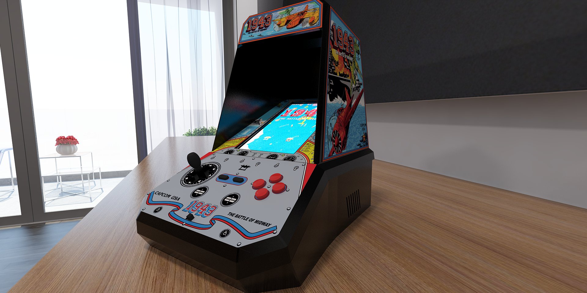

final render.jpg (559.96 KiB) Viewed 12060 times
fix it felix jr full version updated.jpg (602.23 KiB) Viewed 12060 times

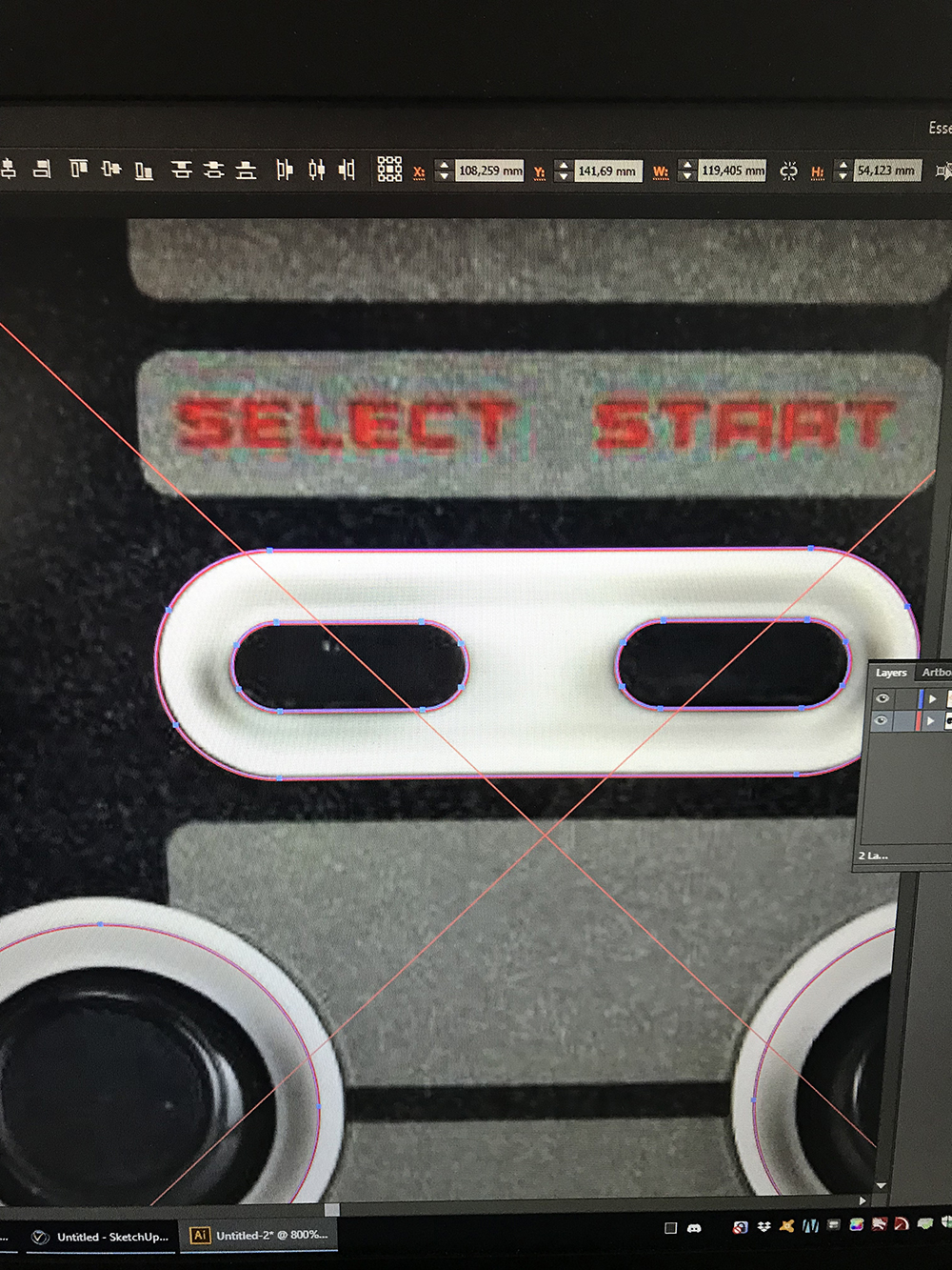

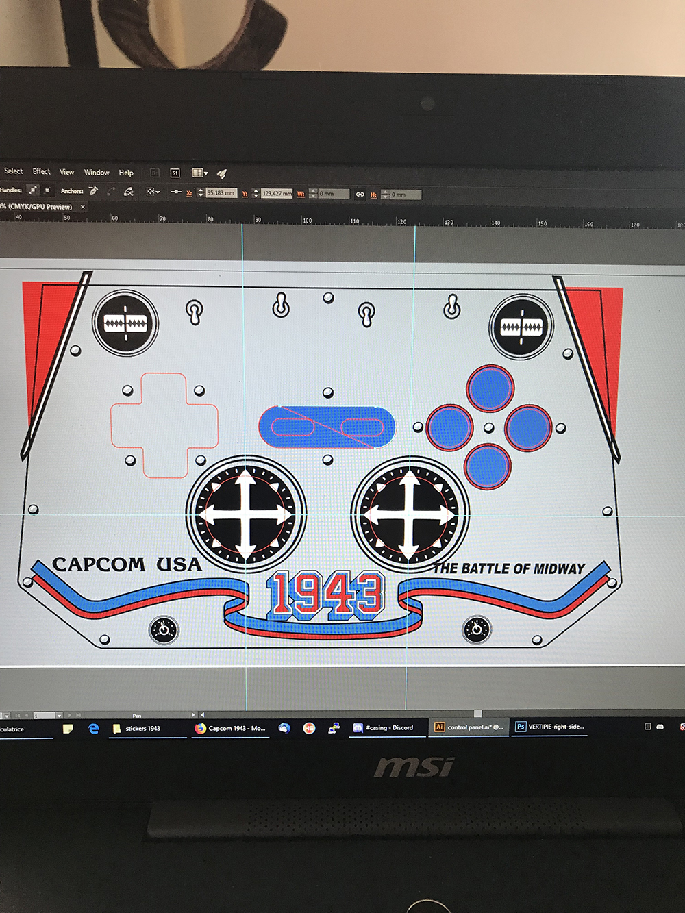

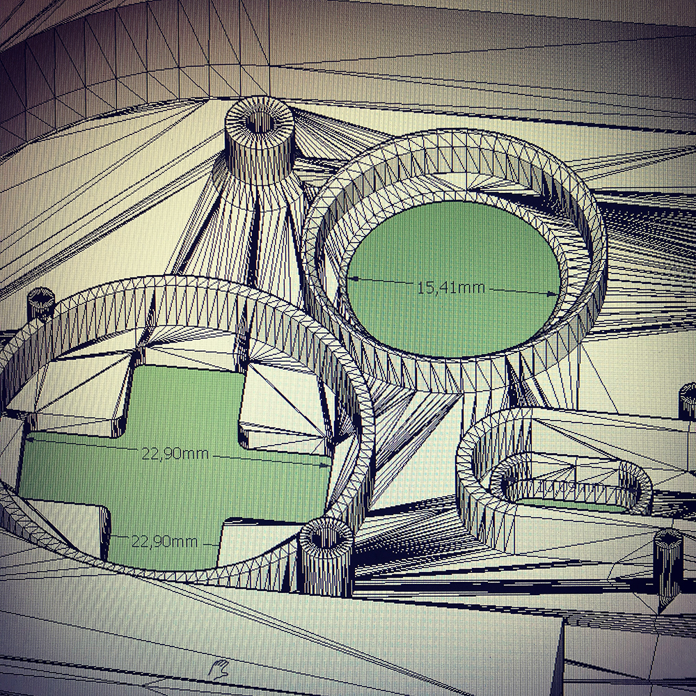

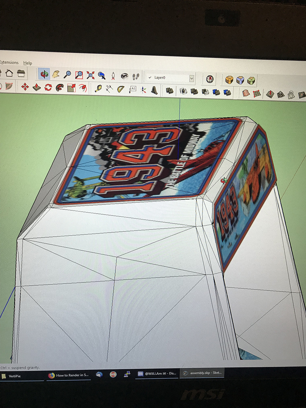

The process was a bit complex.

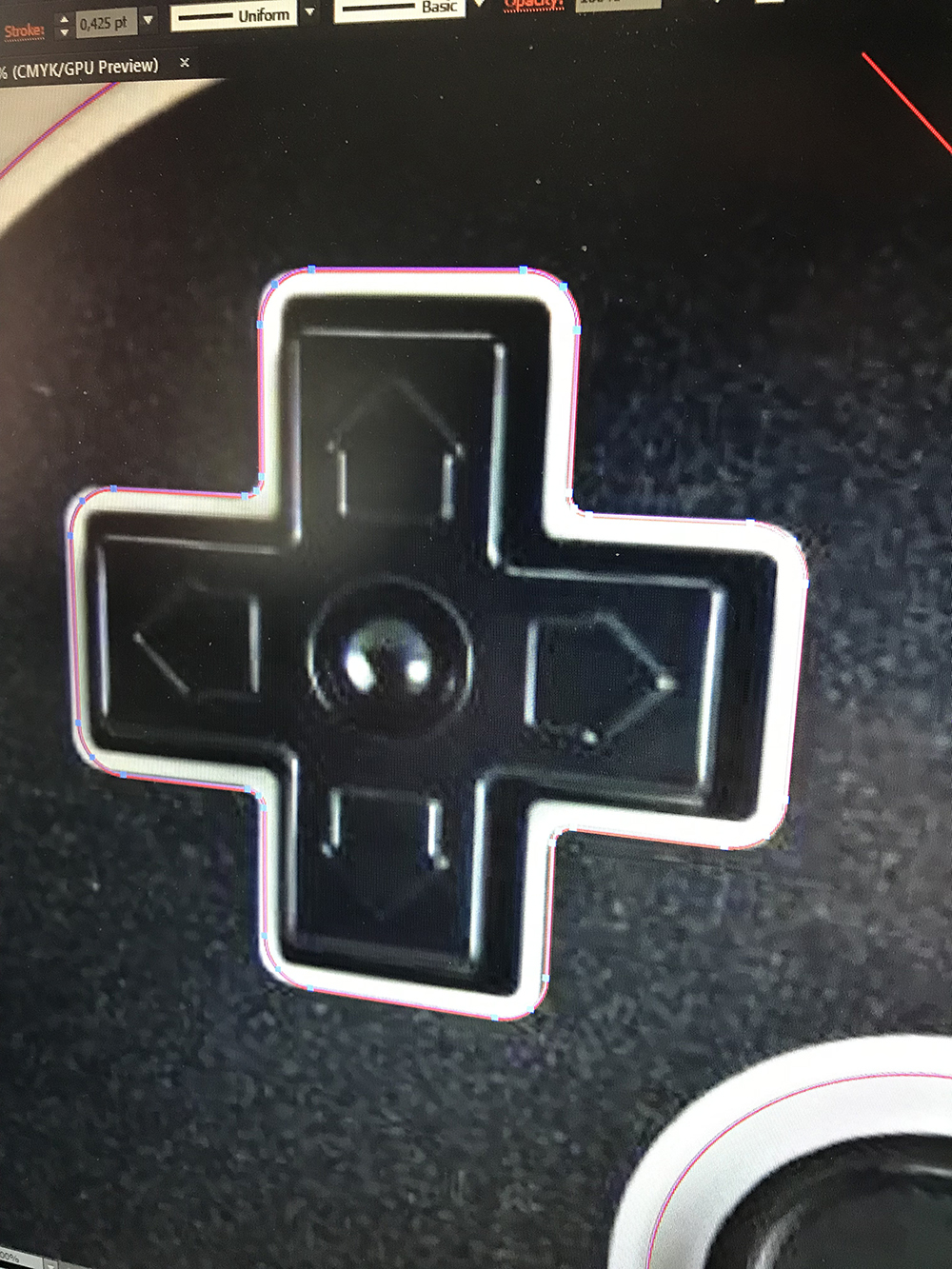

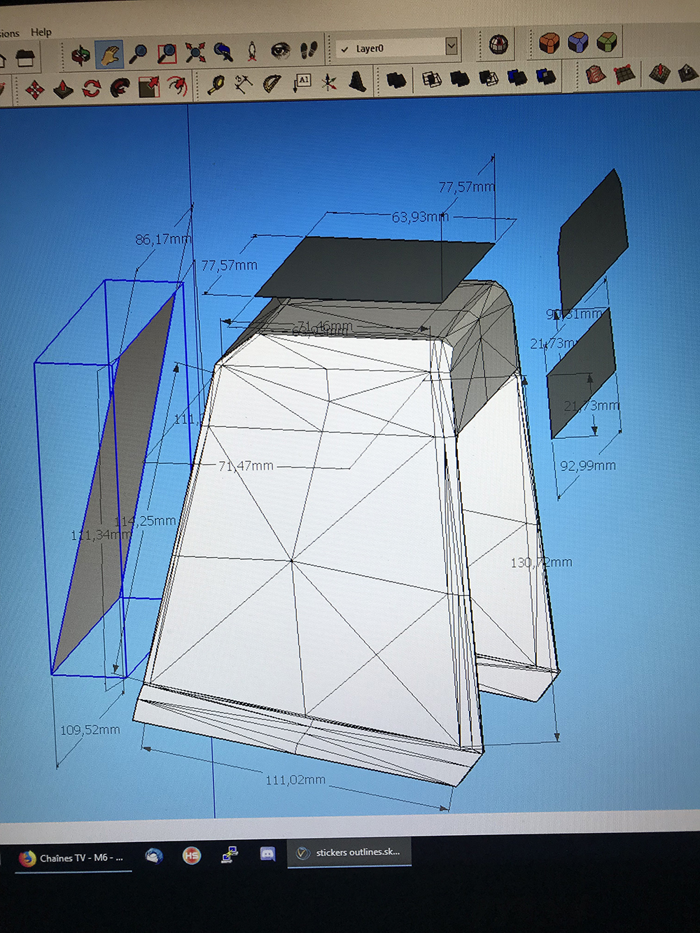

I had first to dismantle the 3D model so i can have flat surfaces
Then i retrieved the outlines of the controller (an 8bitdo NES 30) from the 8bitdo pdf manual
I put all the vectors in illustrator and started messing them around (obviously they were not exactly the good size) by superposing them on a controller picture taken from internet so i was able to align correctly the outlines with a "real" controller :D
Then when the outlines were set, i've started the design process in photoshop and illustrator by using vector dynamic objects and i've double checked that the outlines were the same as the 3d model.
Then finally, i have worked on the 3D model to make placeholders for the image exported with transparency so i can hot swap the decals as i want :mrgreen:

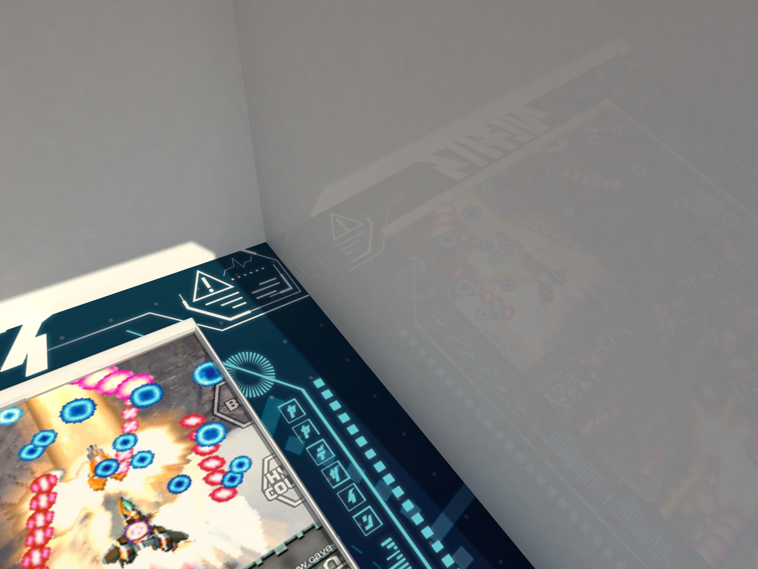

Then it was some 3D skills to work on materials to make everything more real, work on vray rendering engine to give a stunning picture quality.
Like the screen that is emissive to create a real tv effect
control panel.jpg (563.72 KiB) Viewed 12060 times
screen reflection.jpg (270.5 KiB) Viewed 12060 times
Early stage renderer to show how things have evolved
front view.jpg (433.36 KiB) Viewed 12060 times
