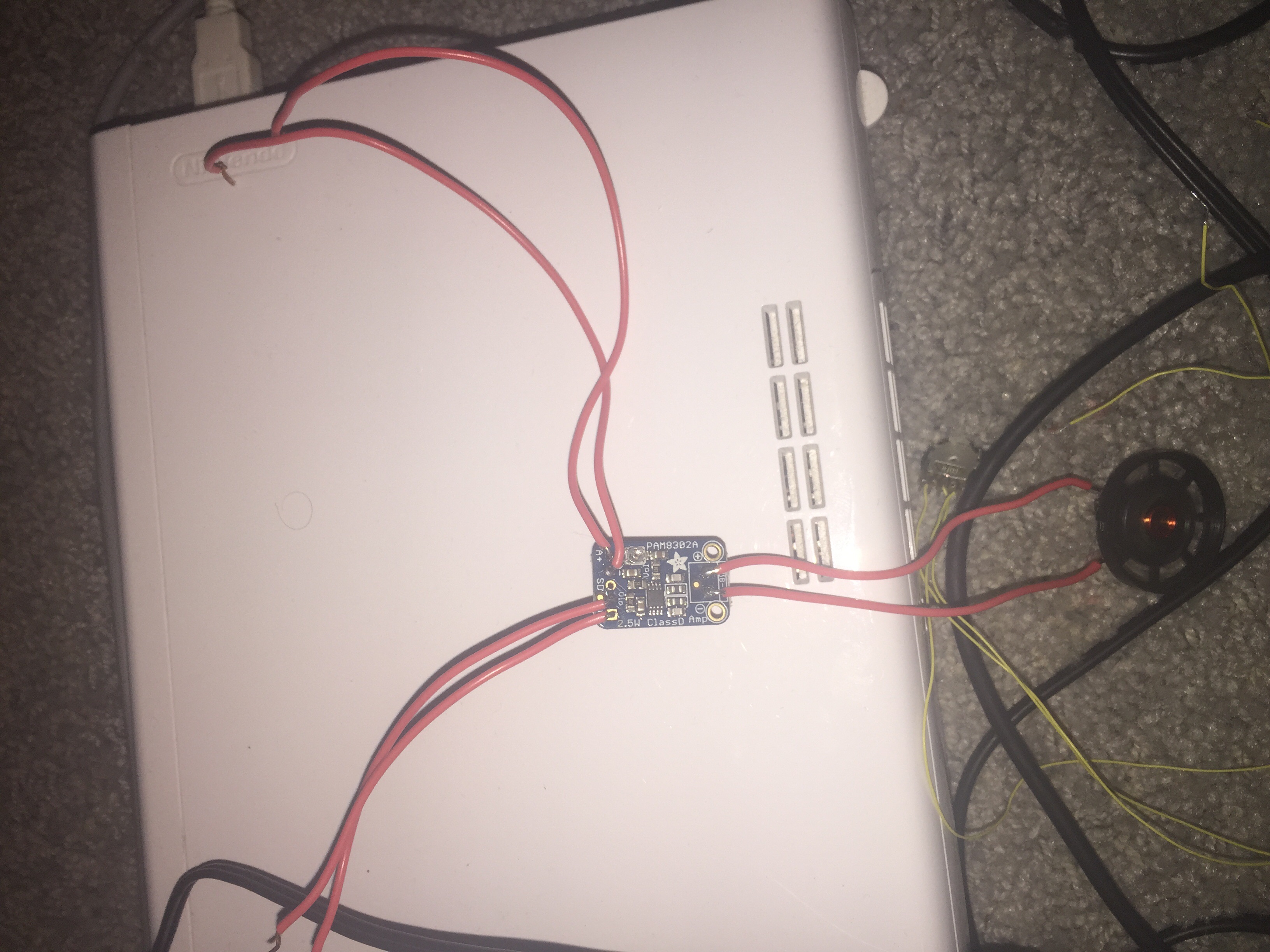

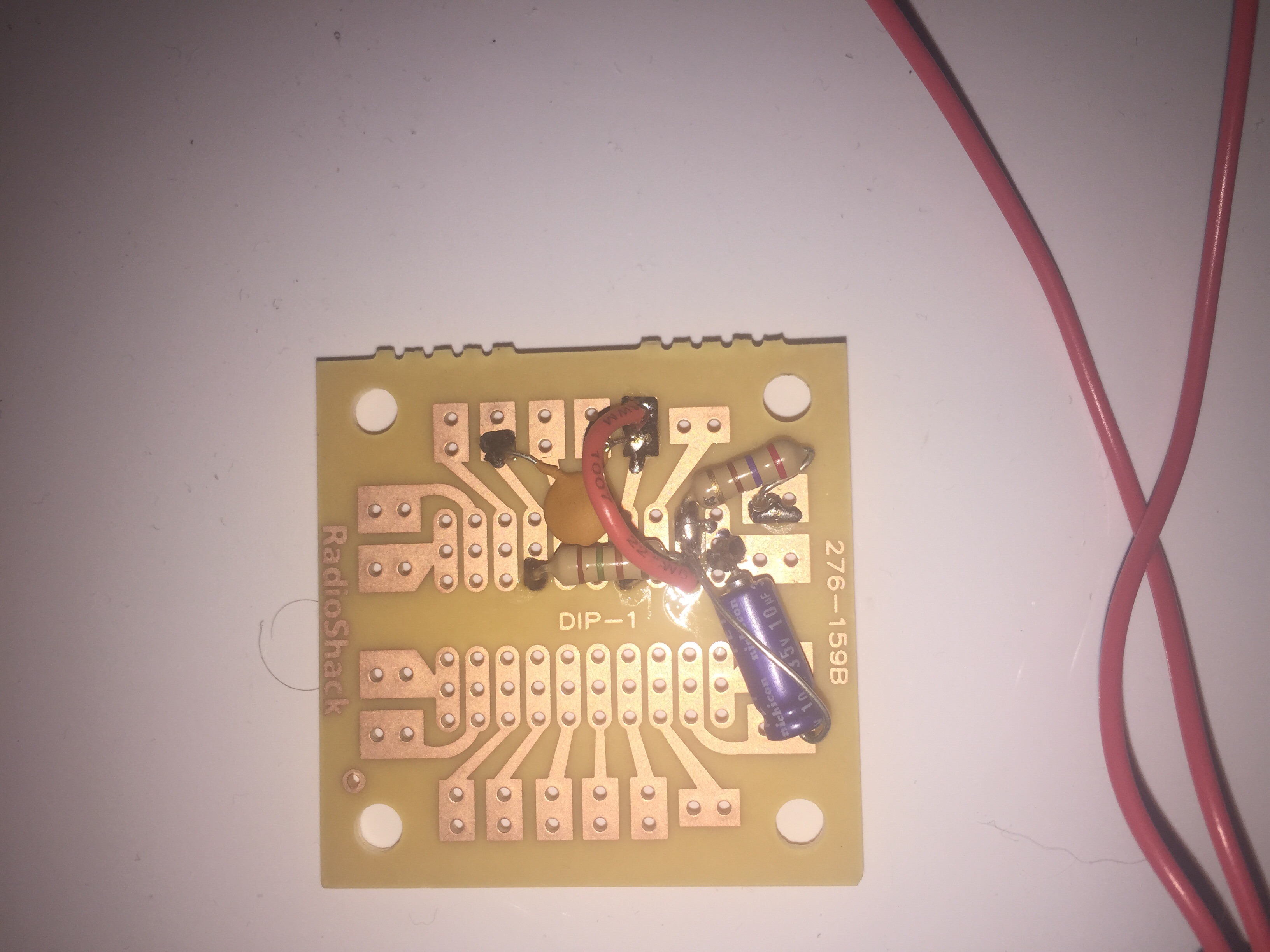

Post by myunholysins » Mon Jun 13, 2016 6:37 pm
So I believe I wired everything correctly also put the code in right to my pi. thing is where do I put the -A wire on the audio amp I put the +A into the filter. with a wirer going into the filter from gpio 18 and gound in the pi to the filter just like wermys video showed but where does -A go, also im and not using a head phone jack.

Post by Popcorn » Mon Jun 13, 2016 10:44 pm
The output of the high pass filter goes to L-In on the Potentiometer. L-Out of the Potentiometer goes to Audio+ and GND on the Potentiometer goes to Audio-

Post by myunholysins » Mon Jun 13, 2016 10:49 pm
@Popcorn ya I def tried that, and have been fallowing a lot of things you've been saying on the forums. Sadly it's still not working did you use a different script, than what wremy used for the config.txt?

Post by myunholysins » Mon Jun 13, 2016 10:52 pm
Btw the potentiometer part did work just wanted to make that clear cuz I figure that out from what you said a day ago just had it unhooked from the amp because j was trying to figure out why there was no sound coming in.

Post by Popcorn » Mon Jun 13, 2016 11:01 pm
The setting for mono is slightly different than stereo. Follow this thread
http://sudomod.com/forum/viewtopic.php? ... 5560#p5560
