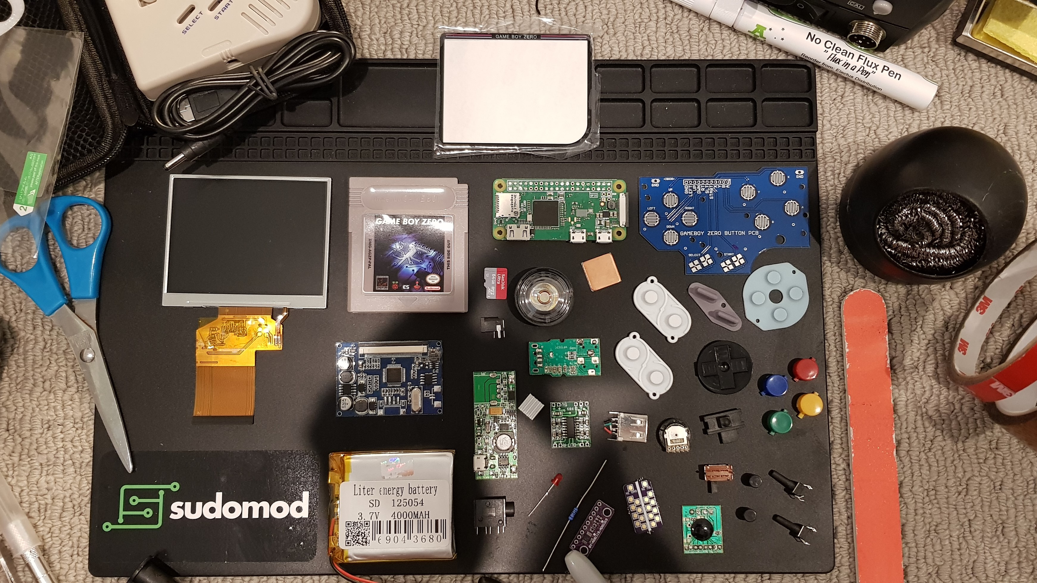

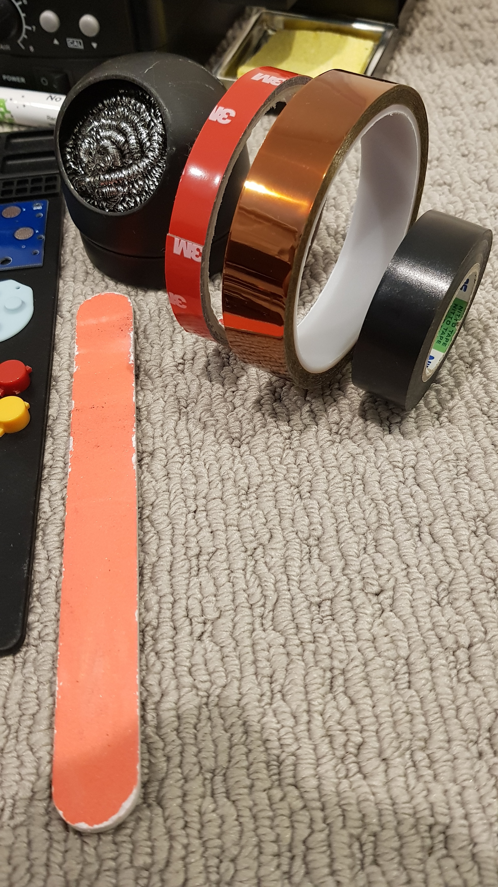

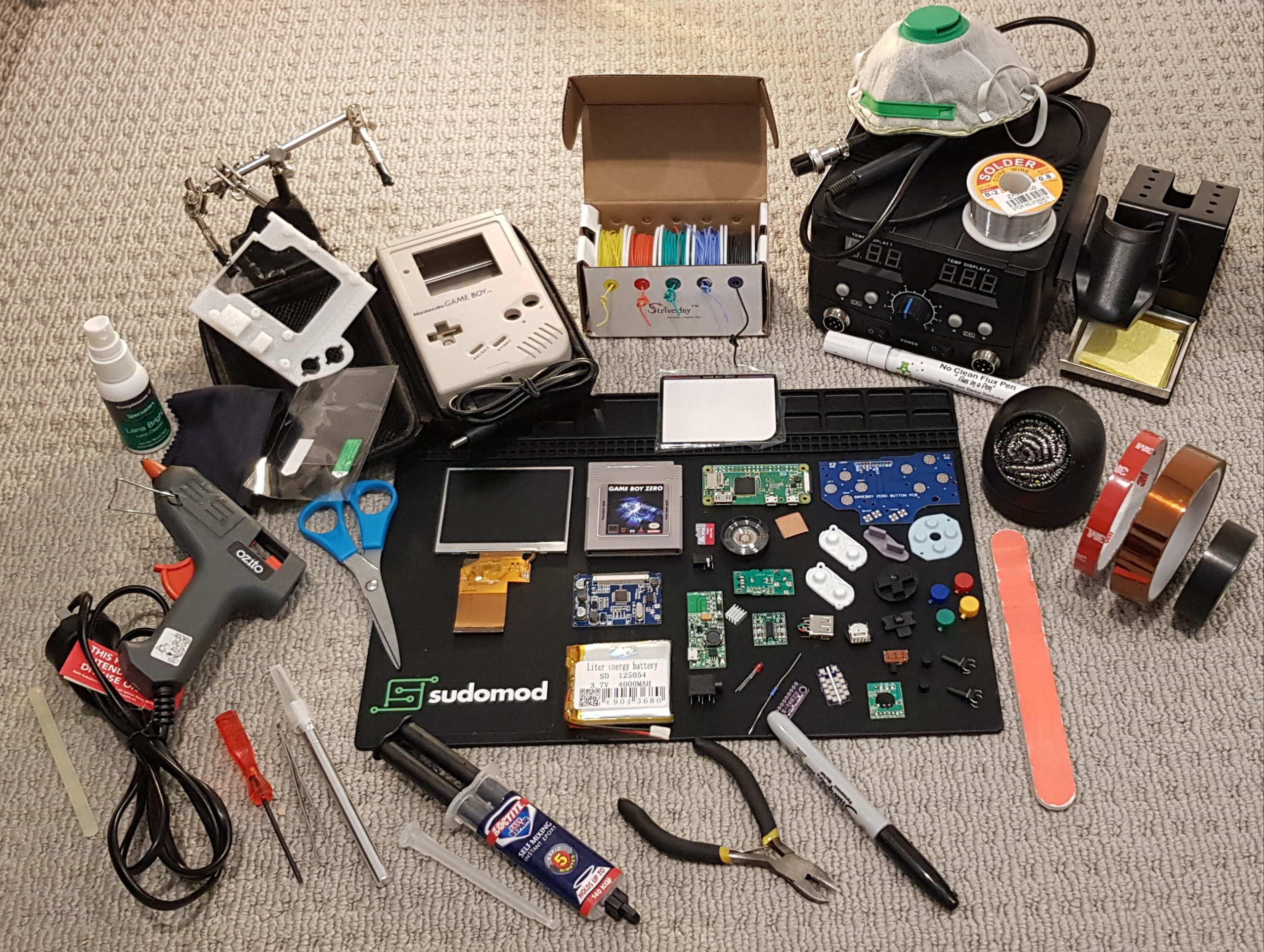

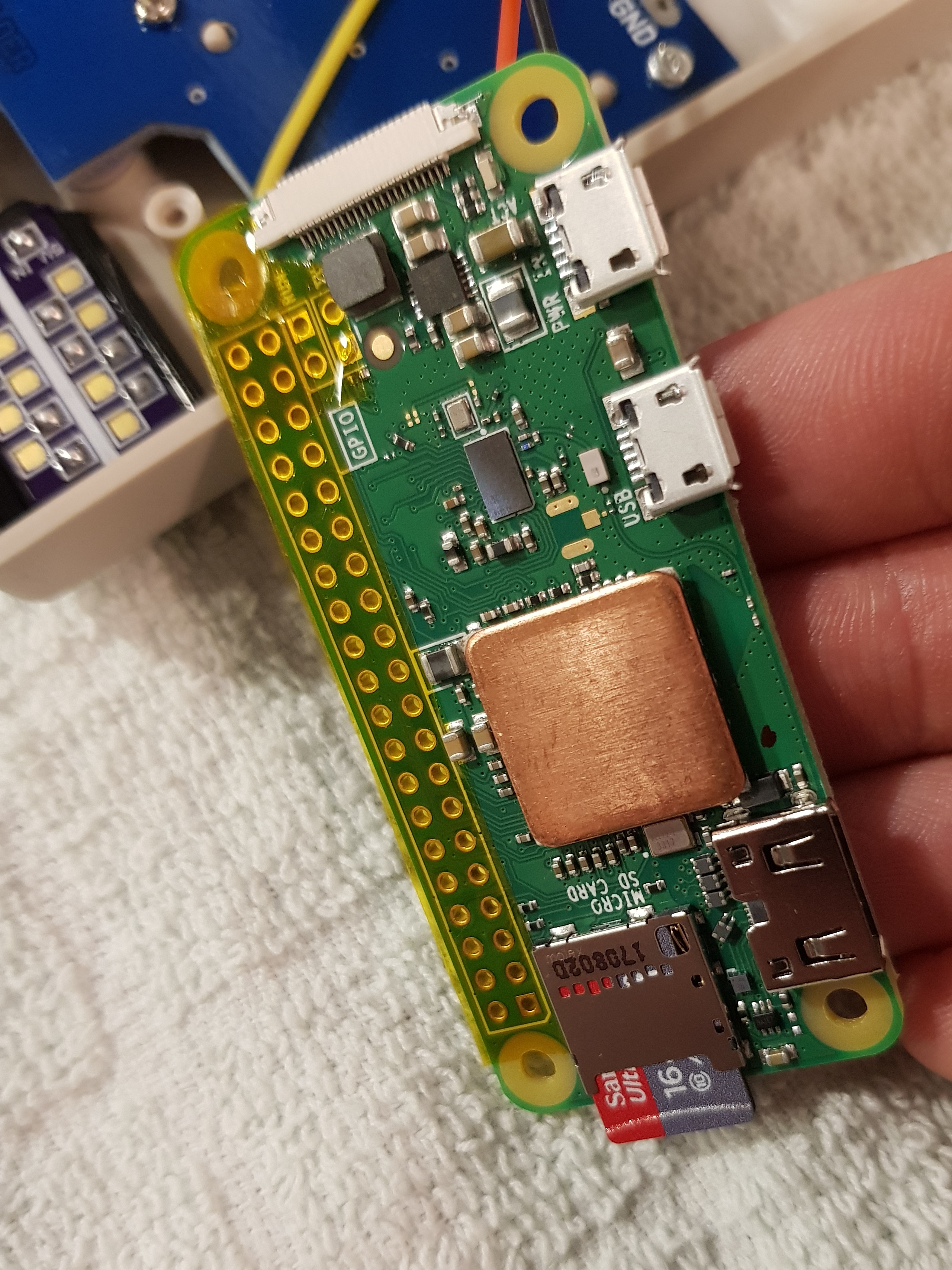

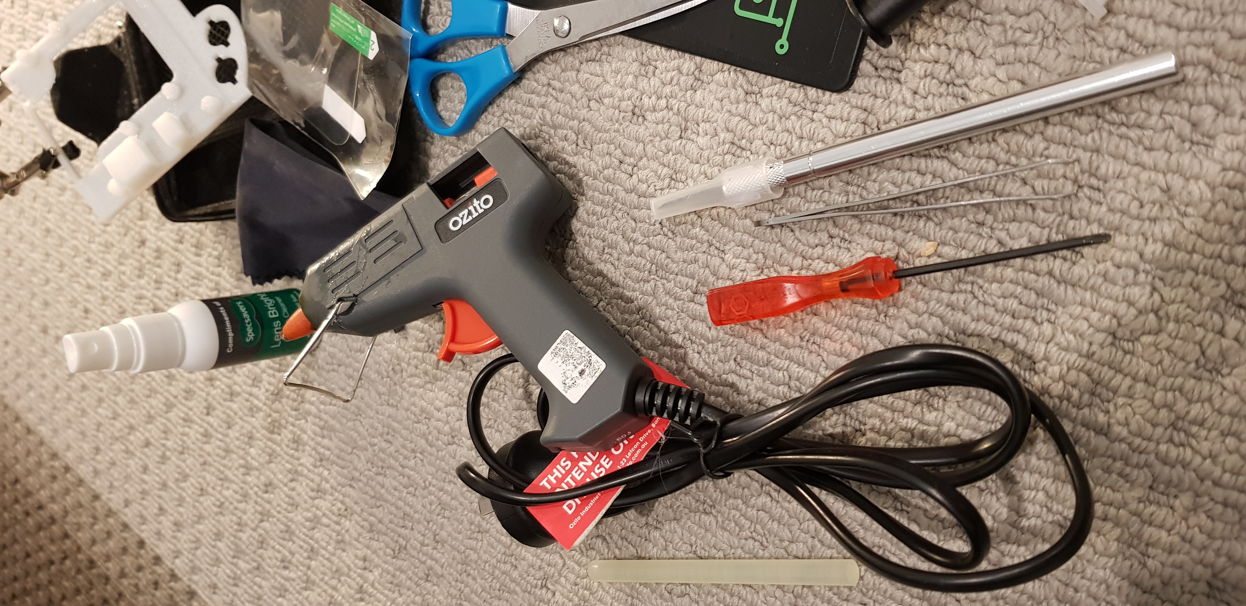

Firstly, some pictures to show everything I use with the exception of my Dremmel, step-up drill bit and Drill. These are fairly generic but just to give you an idea, here they are anyway:
1) Dremmel - https://www.bunnings.com.au/ozito-170w- ... t_p6290175
2) Drill - https://www.bunnings.com.au/ryobi-one-1 ... t_p6210735
3) Step-Up Drill Bit - http://market.sudomod.com/step-drill-bi ... ole-drill/
Parts:
Game Boy DMG01 Shell
Raspberry Pi Zero W - Commonly available (usually 1 per order).
Pi Heat sink
Gearbest 3.5; Composite Screen + Board
Gearbest 3.5; Composite Screen + Board Screen Surround - Jermzz
Screen Protector
Simple Button PCB by Helder
4000 mAh Battery
5V Generic Boost Module
Boost Module Heat sink
USB Hub
USB Breakout (taken from USB hub listed above)
USB Soundcard
DPDT Power Switch
3D Printed Screen Bracket by Hoolyhoo
Power Strip PCB by Helder
Speaker
Amplifier
Headphone Jack
DC Charge Barrel
3mm LED
ADS1015
10k Resistor
16GB Micro SD Card
Original / Aftermarket Game Cartridge Shell
Cartridge Shell Sticker by YaYa
Game Boy Button Membranes These often come with the DMG shells themselves or for custom colours I use: Deadpan Robot
Game Boy Buttons
Screws
Tactile Switches
Tactile Switch Caps
Kapton Tape
3M VHB Tape
Electrical Tape
USB to DC Charge Cable (3.5*1.35mm)
Glasses Cleaner and Cloth :D
Screen Protector

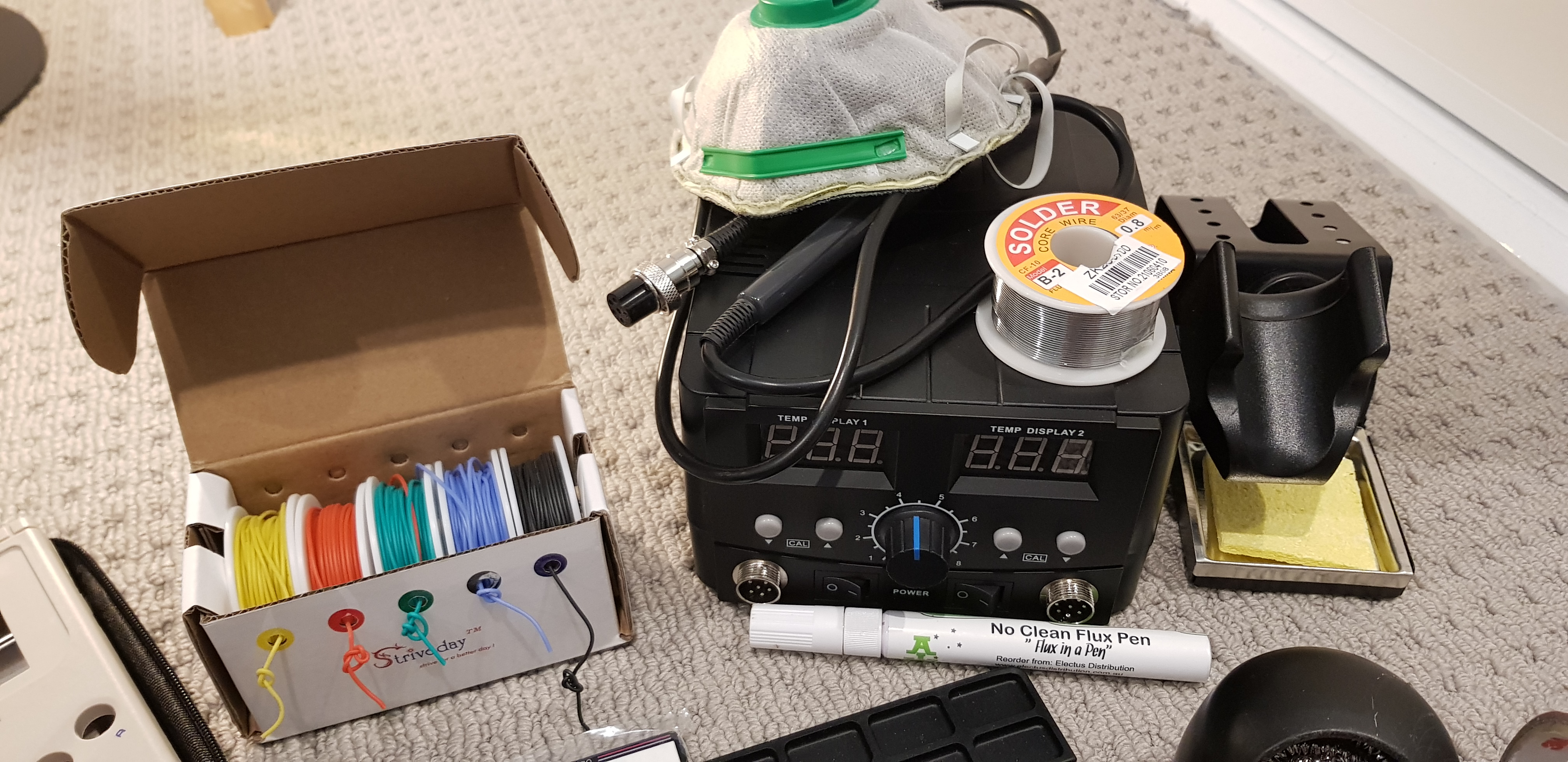

Tools:
Silicone Mat
Soldering Station
63/37 0.8mm Leaded Rosin Core Solder
Liquid Flux Pen.
Tweezers - came with solder station
Respirator Mask - Local Hardware store.
Steel Wire Iron Cleaner
3rd Hand
Nail File - I just got 2 disposable ones from a beauty shop.
Scissors - Kitchen drawer?

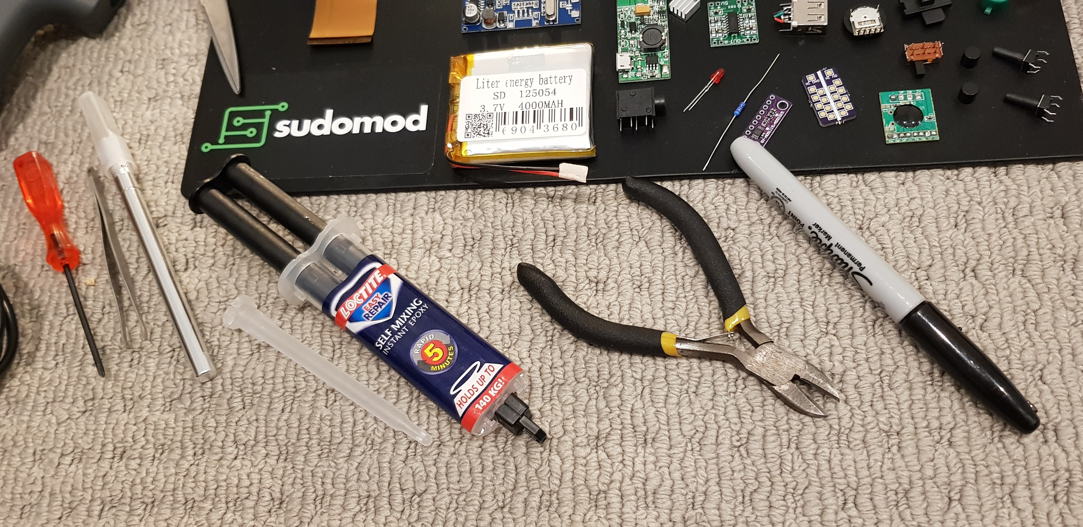

Sharpie - Available everywhere.
Glue Gun - Local hardware store
Epoxy - Local hardware store but I find the self mixing Locite ones are easiest and cleanest to use.
Scalpal - craft shop.
Snips - Toolbox
Silicone Wire - Multi Coloured (30AWG)
Mini Screwdrivers - Tri Wing and Phillips
3DS XL Case
I will edit this post over next day or so to include hyperlinks to all of these items :mrgreen:

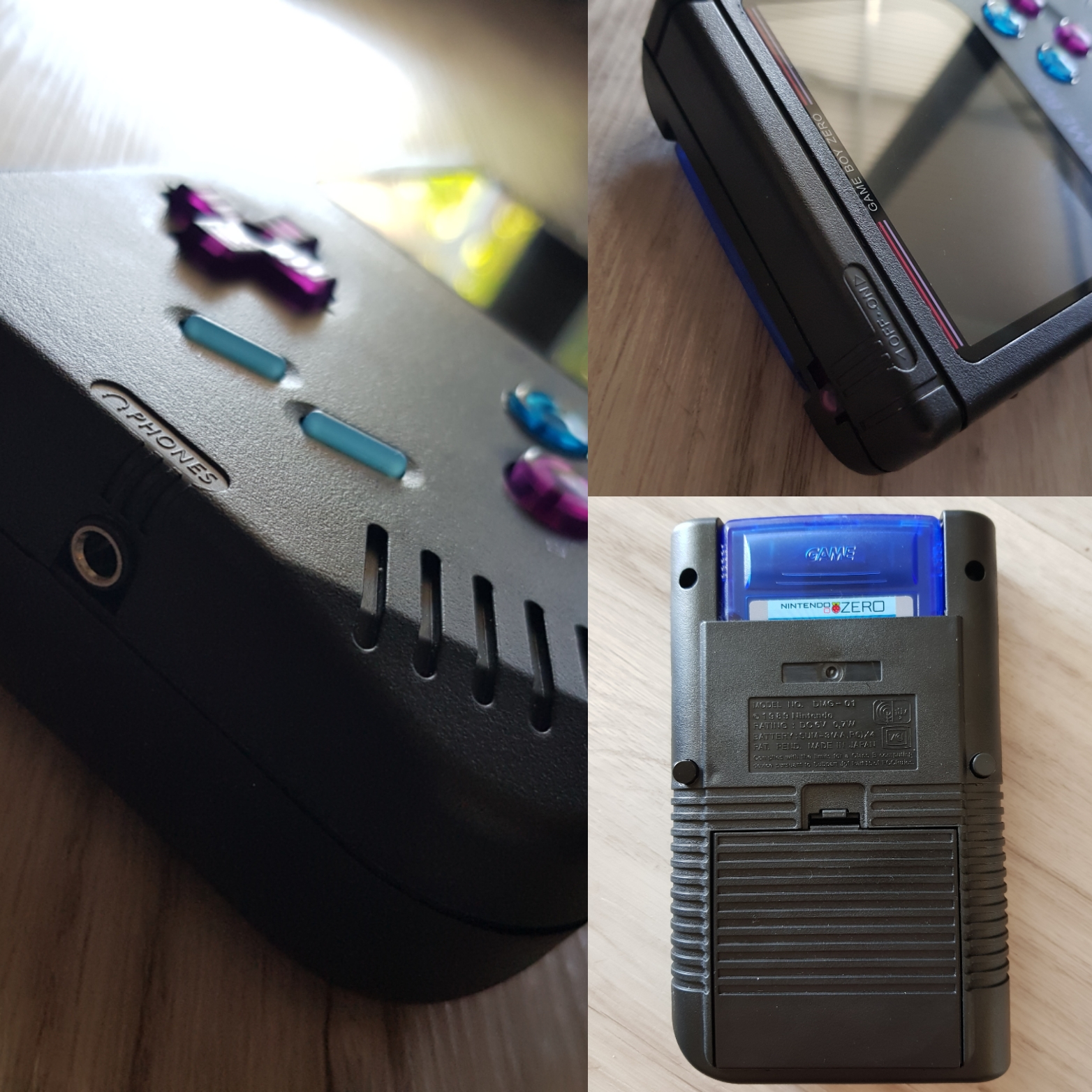

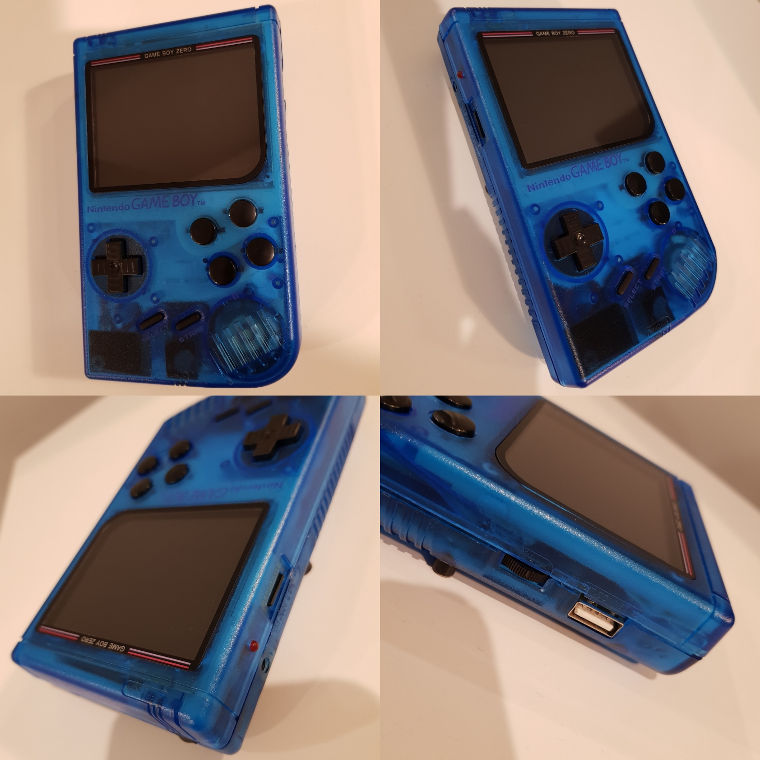

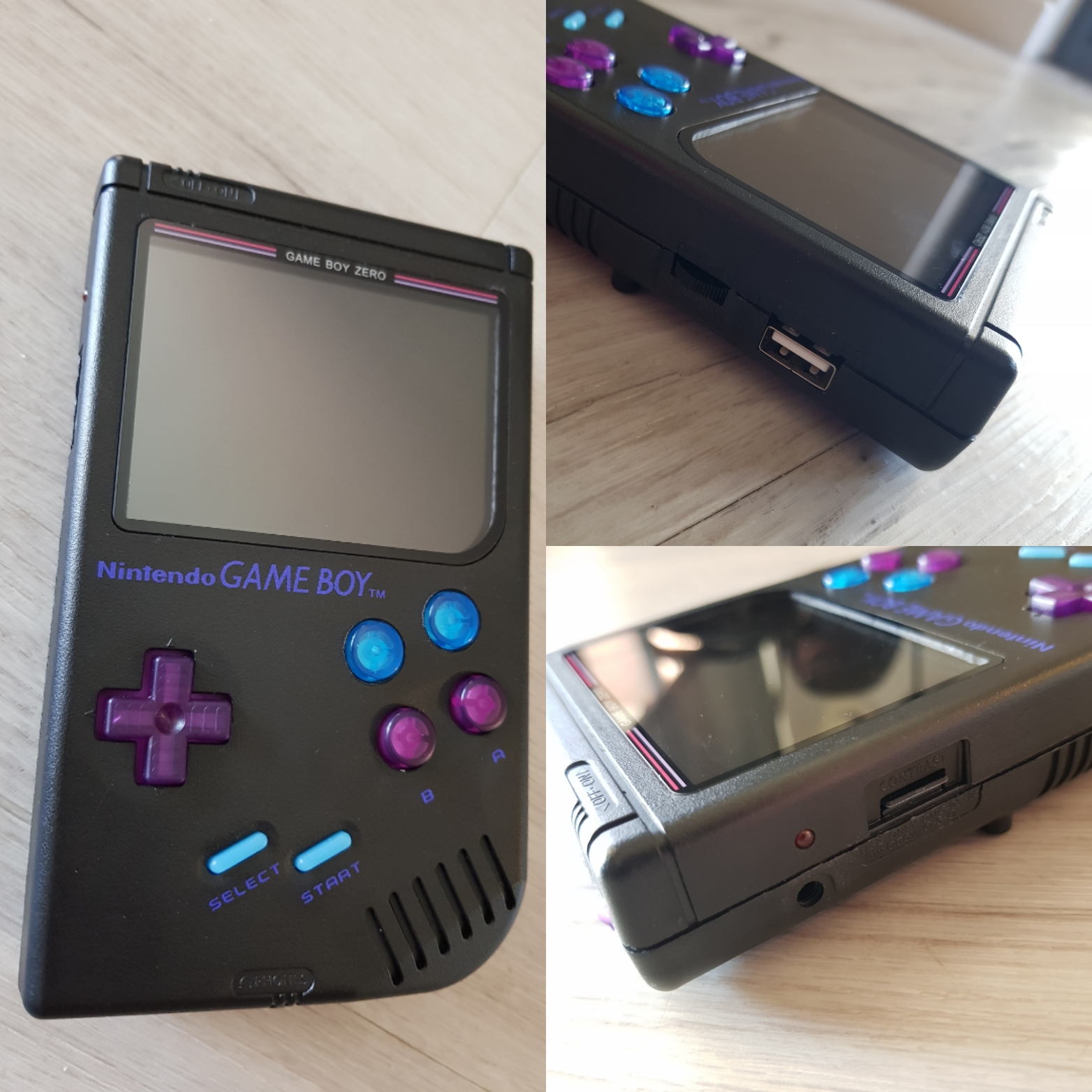

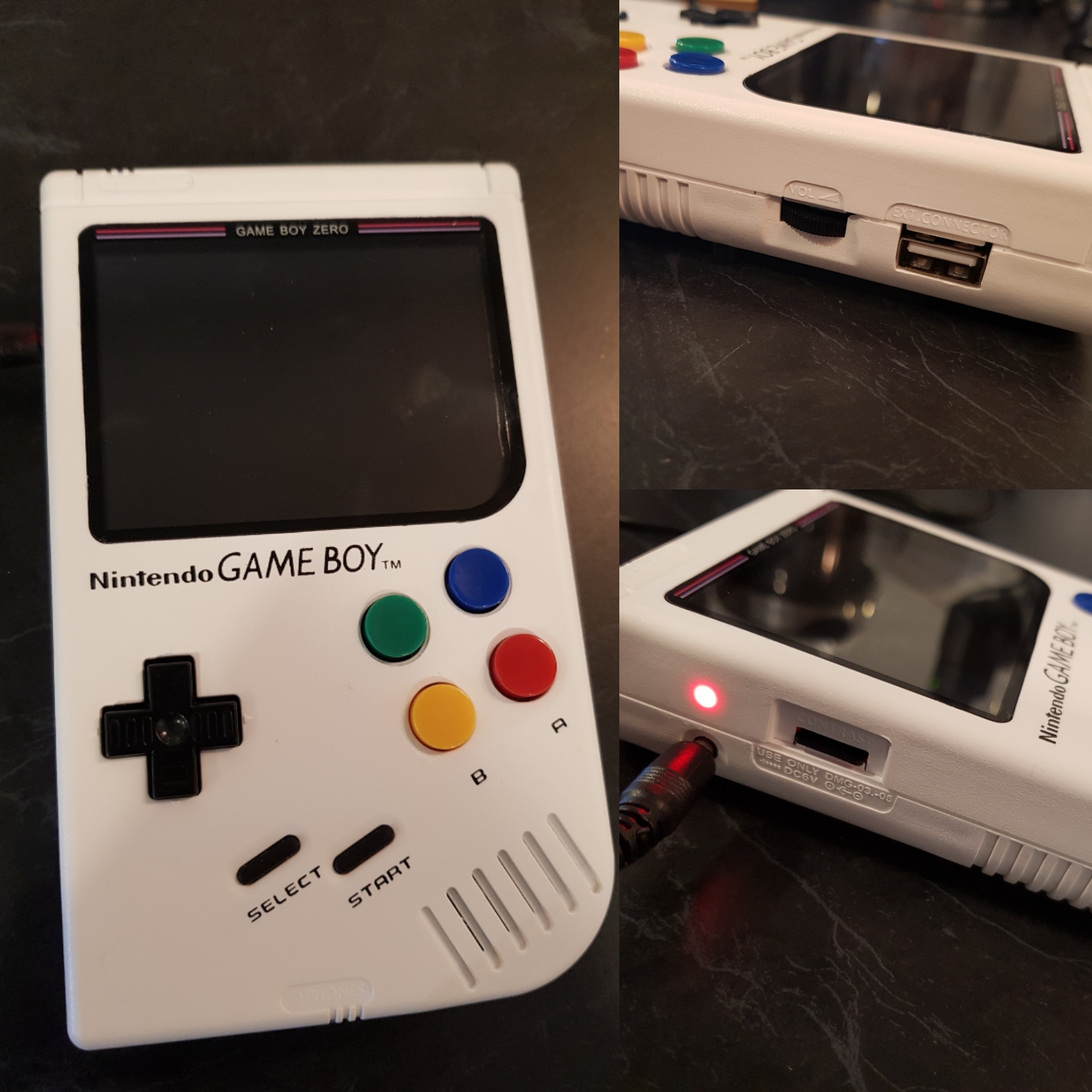

Here are a couple of my most recent builds:
Hope you find this useful guys. I'm looking to create on a wiring diagram next so you can see how I hook things up. Again very straight forward but hopefully useful.

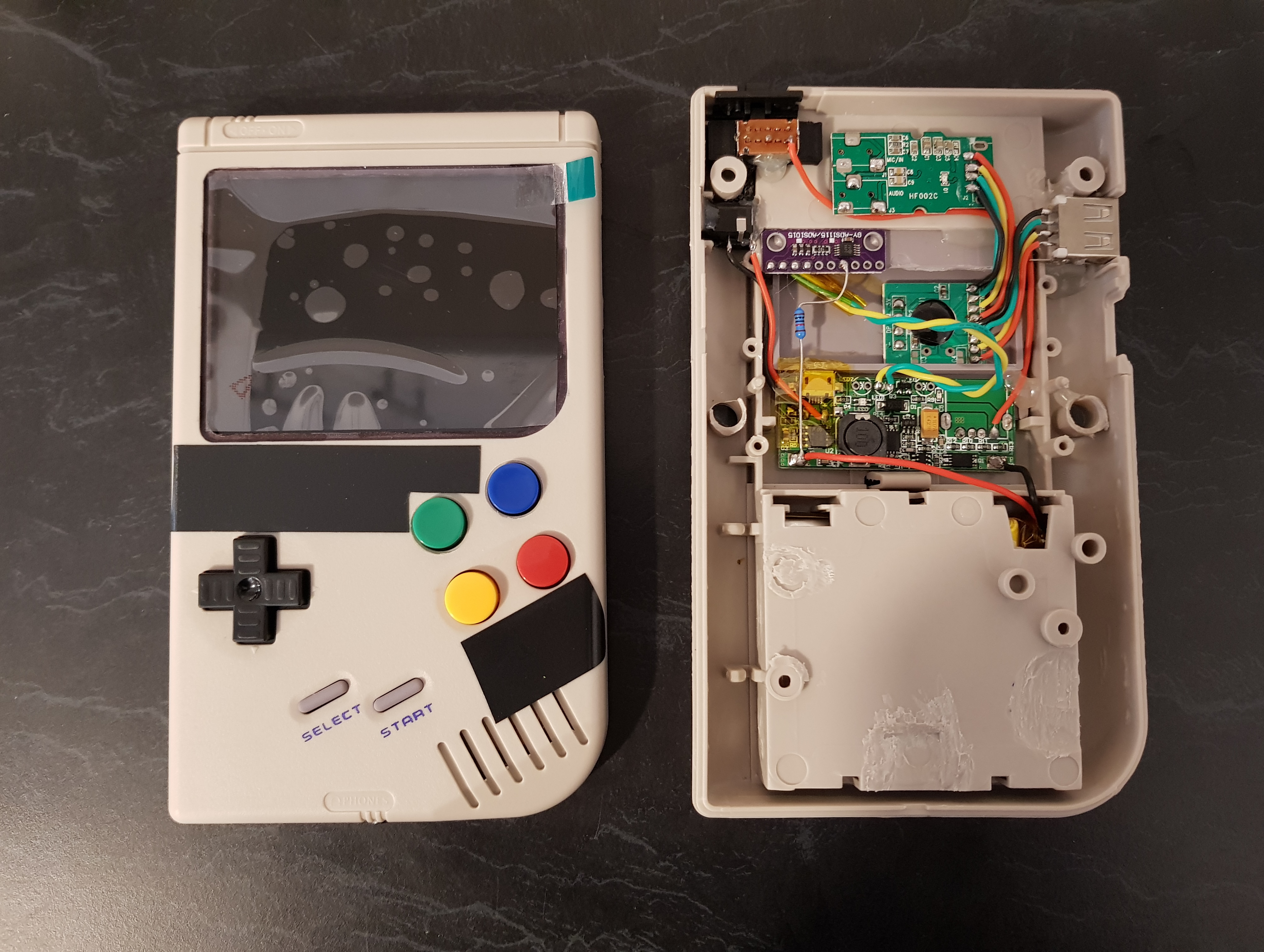

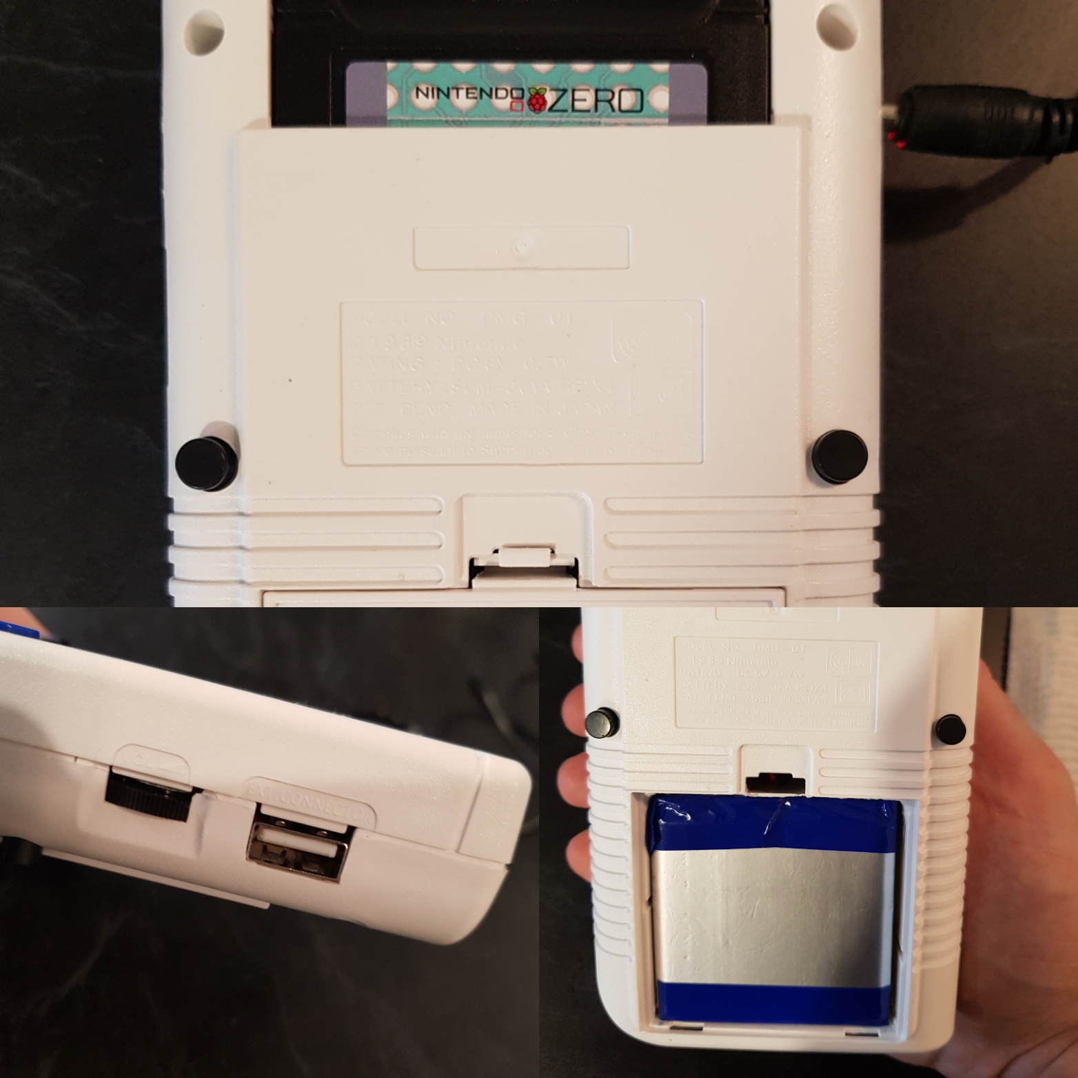

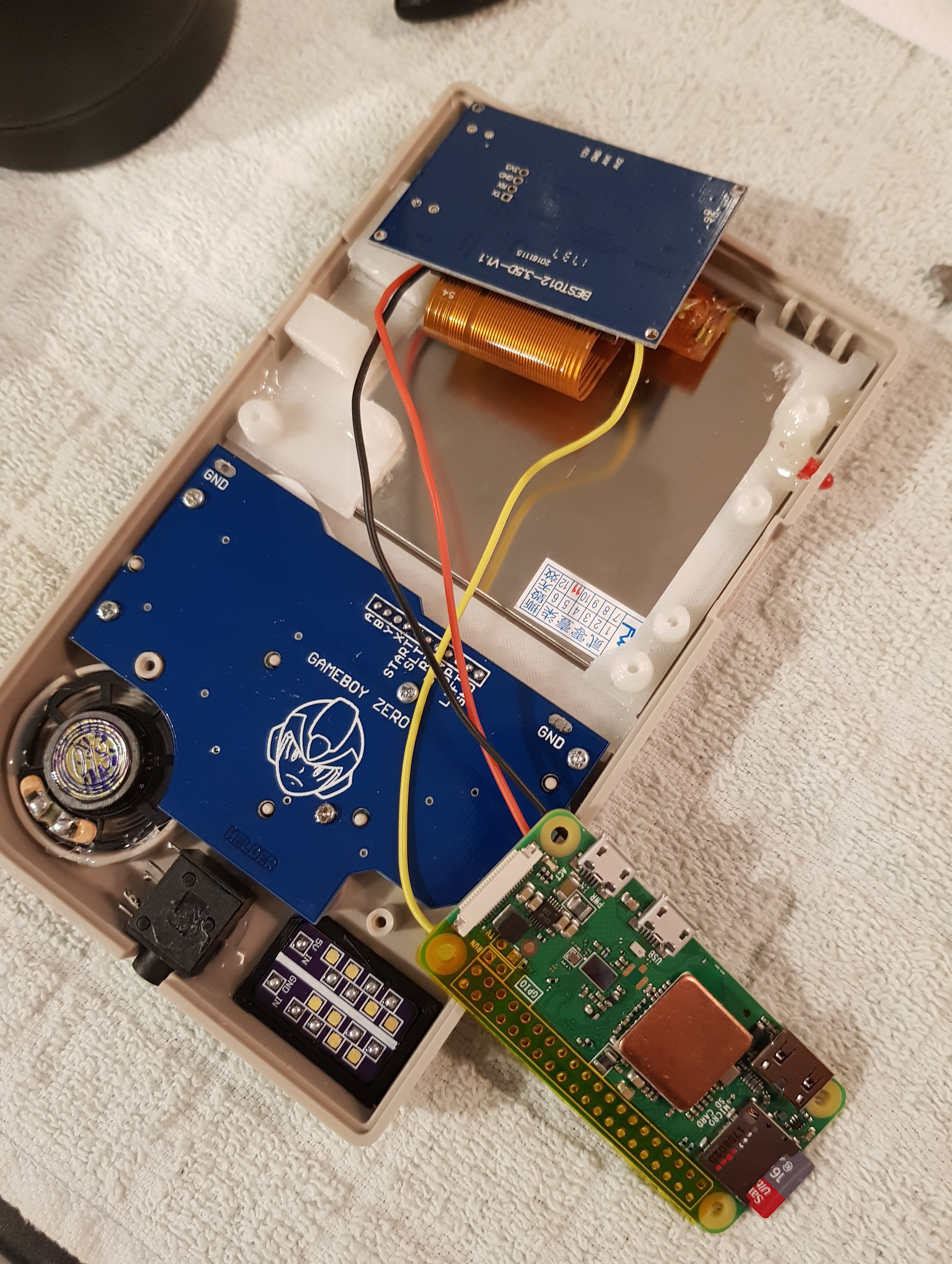

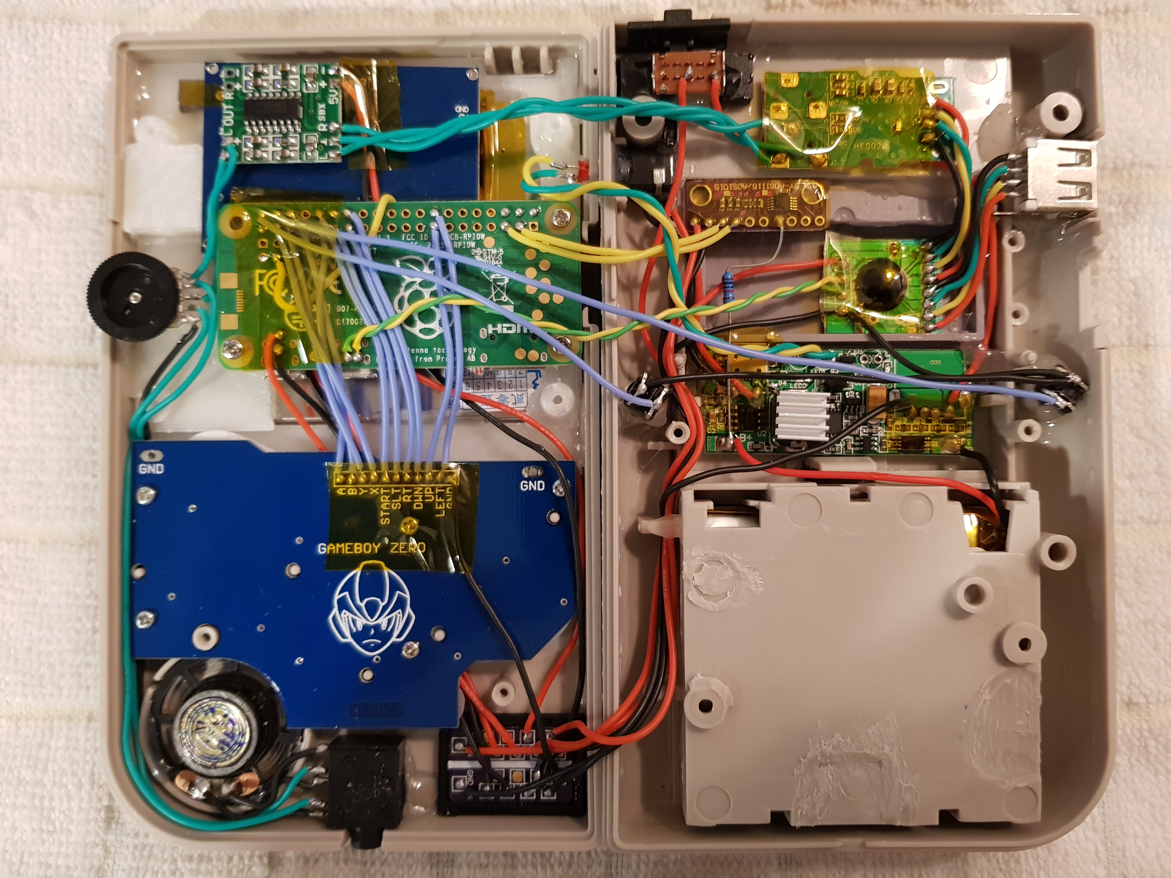

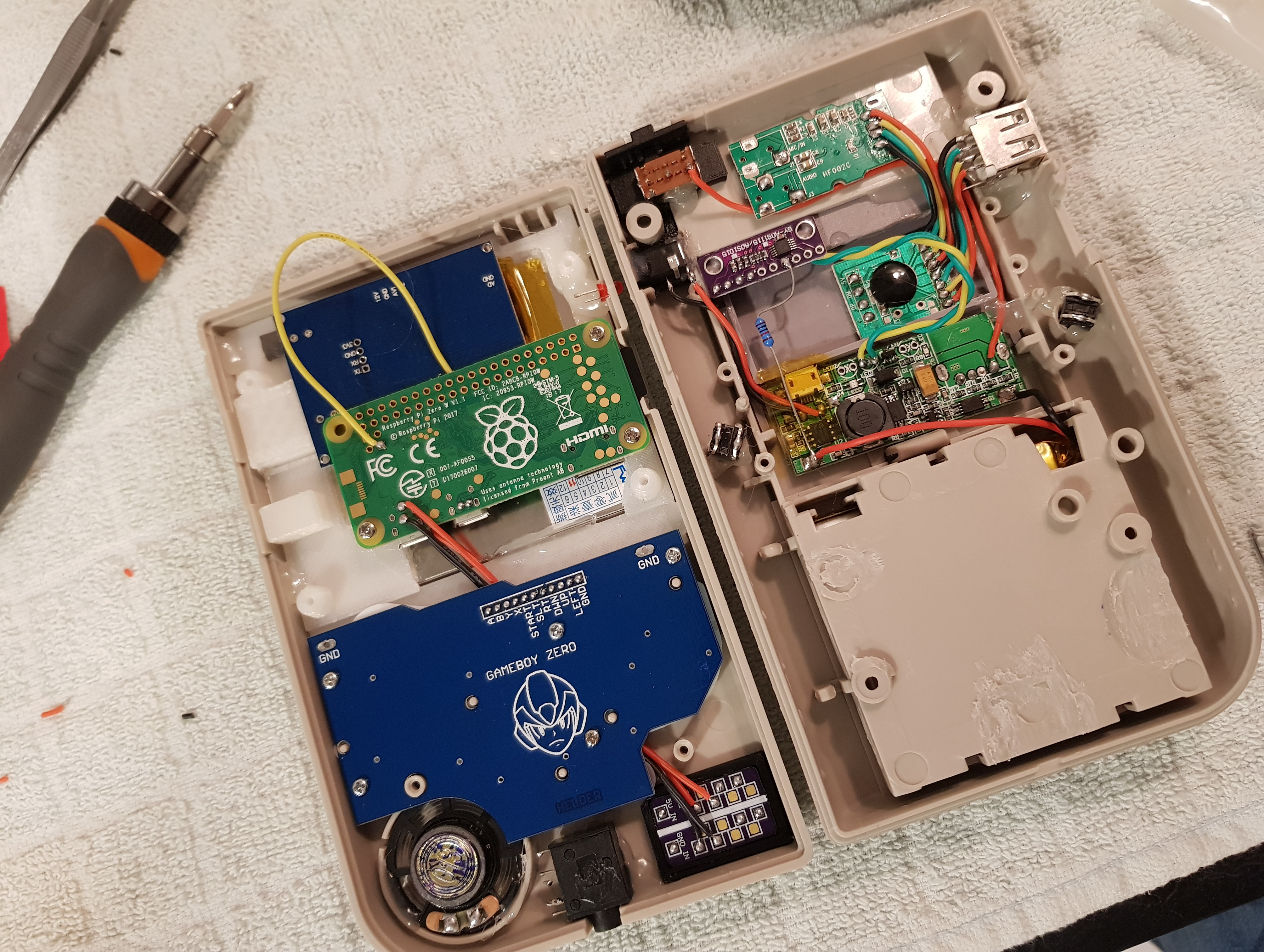

As requested, here are some build internals:

Do you have any images of you build inside? Or a detail process of one of your builds?
Thanks in advance,
Jeffrey

columb0 wrote:
Thu May 03, 2018 10:54 am
Thanks in advance,
Jeffrey
Sure, i'll add some now :mrgreen:

Lovely build, luckily you use a near identical button PCB to one I have lying around! Cant wait for the wiring diagram. :D

What do you use to hold up the headphone jack? Just glue or a bracket of some sort?

That's a pretty good job Lphillimore. Thanks for sharing.
