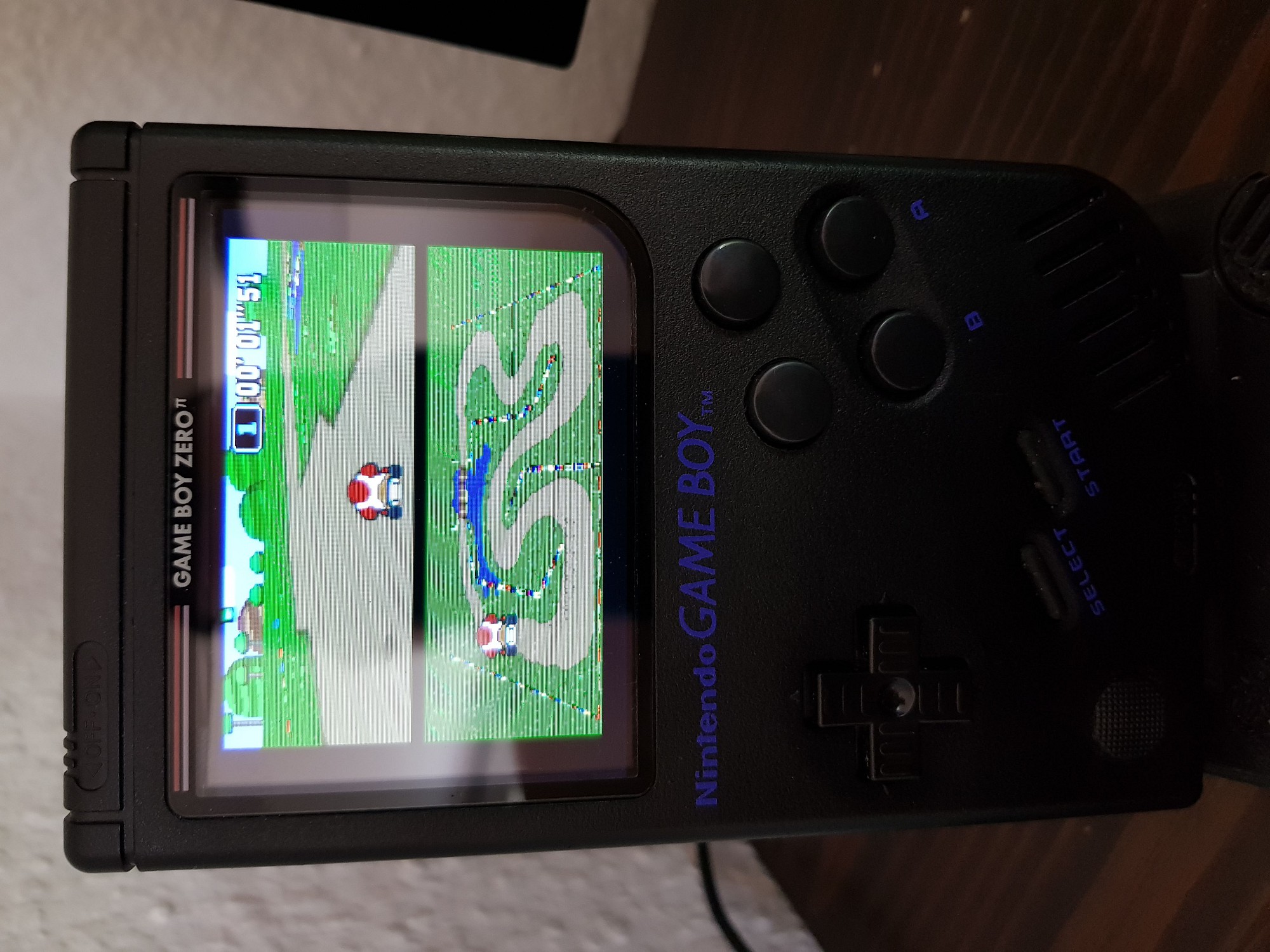

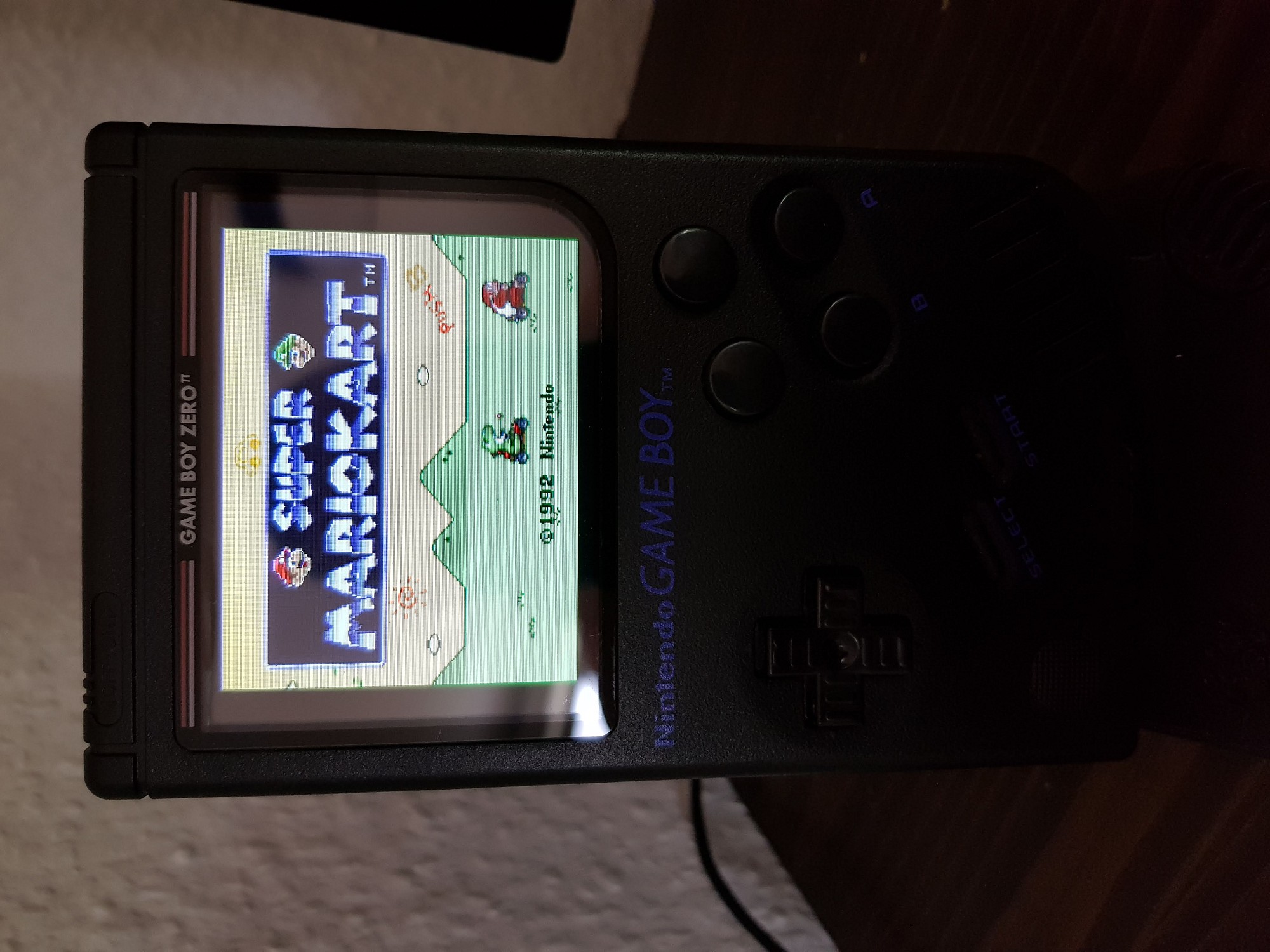

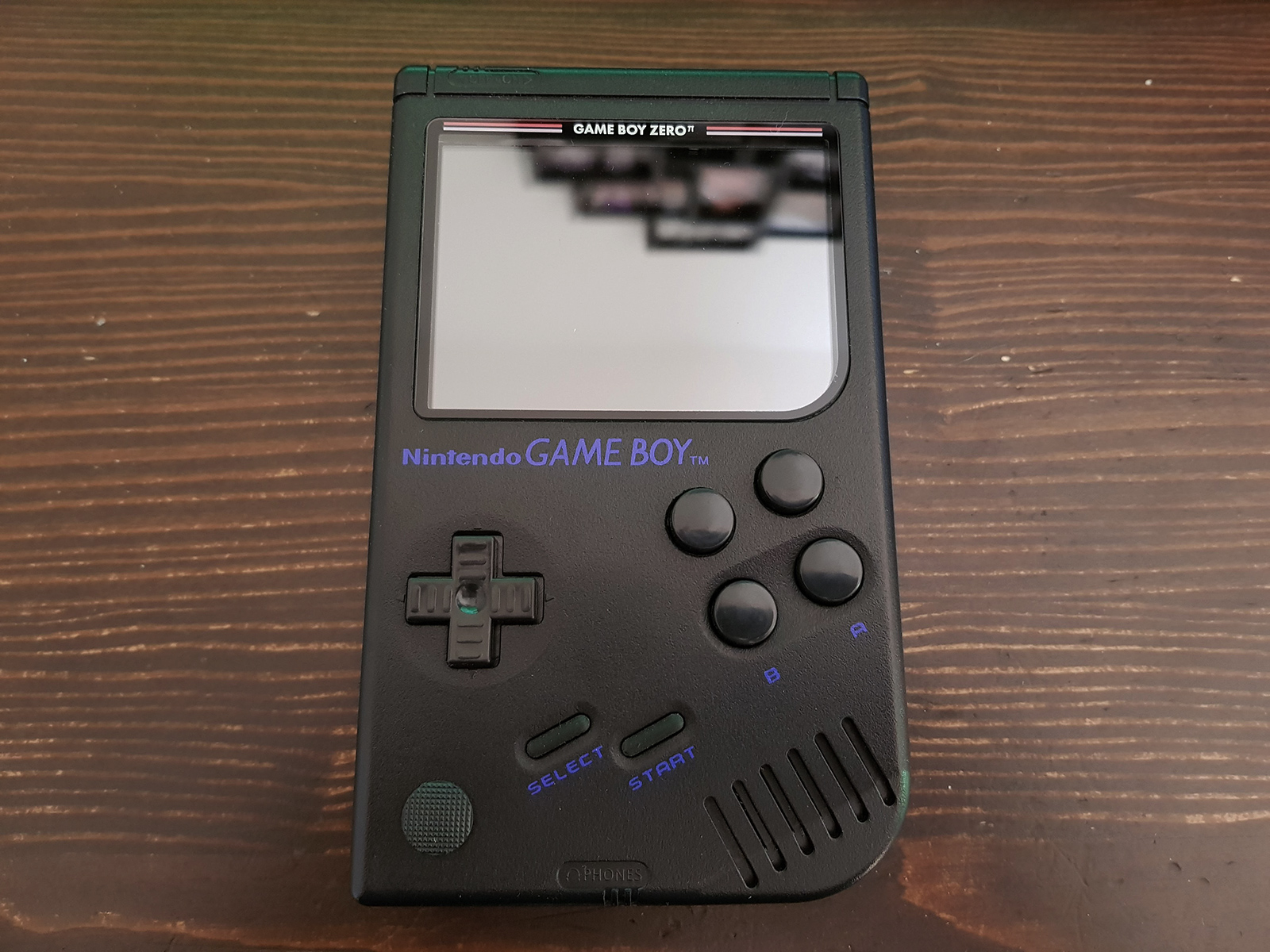

Short introduction to my black "beauty". ;)
It was a very funny project ... and killed a lot of time.
Basically, I'm satisfied, but at one point or another, I could have worked cleaner. I think for my first build, it is okay.

Nice work! I actually like the screws on the sides, subtle so it doesnt look like hack job.

nice build....
for a first build you did really well
and its good to see another HDMI build.....
can you share some of what you did...
how you modified the screen to fit (as its the later version of the Kedei HDMI, which others have complained about fitment issues)
and also how you extended the SD Card on the Pi3 (as it doesn't have test pads like the Pi0)...
also hows the power on the system, are you getting the lightening bolt pop up with your setup....
thanks, nice build....

Ok, I probably did not take enough pictures...and I do not want to completely dismantle the gb again. :shock: SORRY
So I try to explain it.

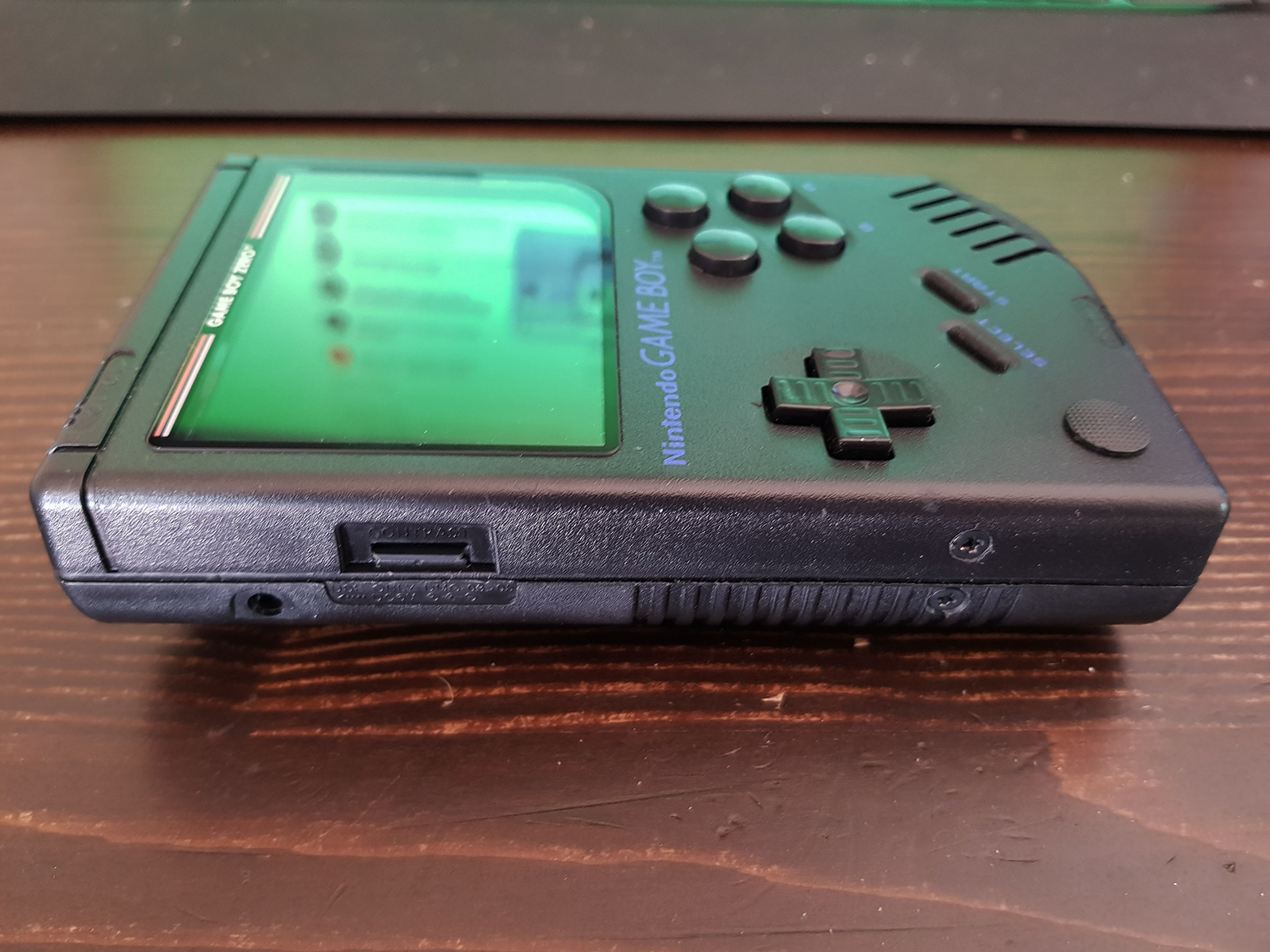

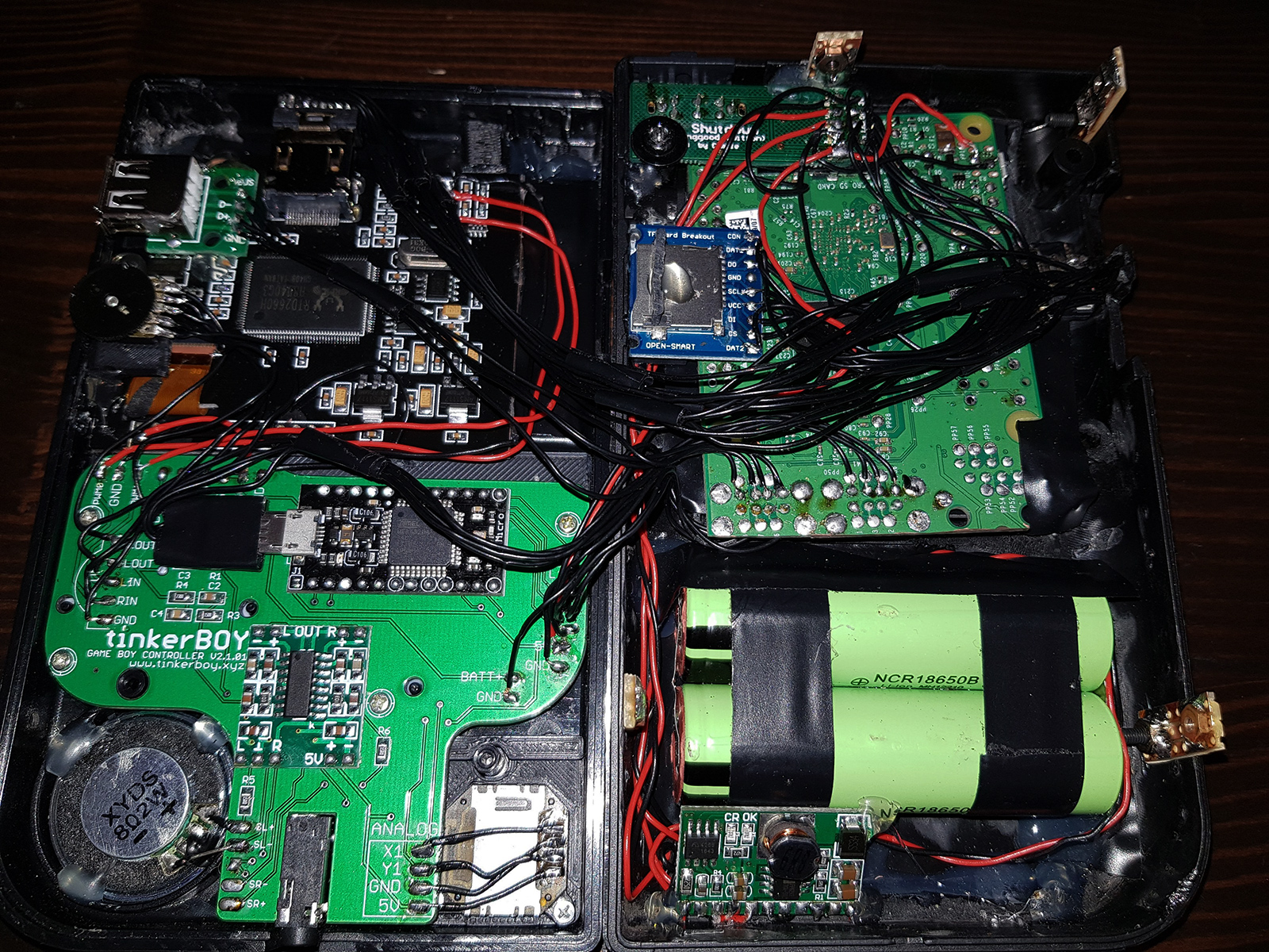

SD Card Socket: I have the aluminum shield bent up by desolder the two soldering points in front...then I soldered the lines directly to the pins and soldered the shield again.
HDMI Screen: I have the screen separated from the lower main board ... with a scalpel carefully solved. I have also removed the touchscreen from the screen, it's like a foil just peel it off (then the picture appears clearer). I cut the pcb accordingly, the labeled area can be completely removed. From the screen itself, all protruding plastic (white) parts were removed with a file. so the screen fits without making any adjustments to the dmg housing. Furthermore, I remove the audio jack, gpio connectors, main switch and the microusb from the pcb.

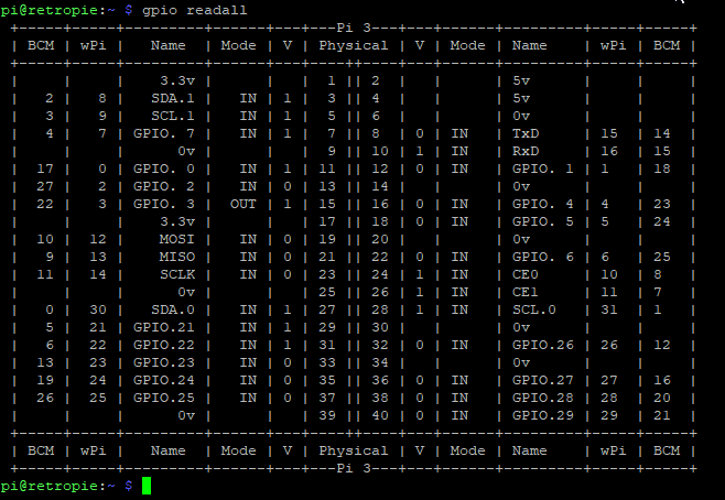

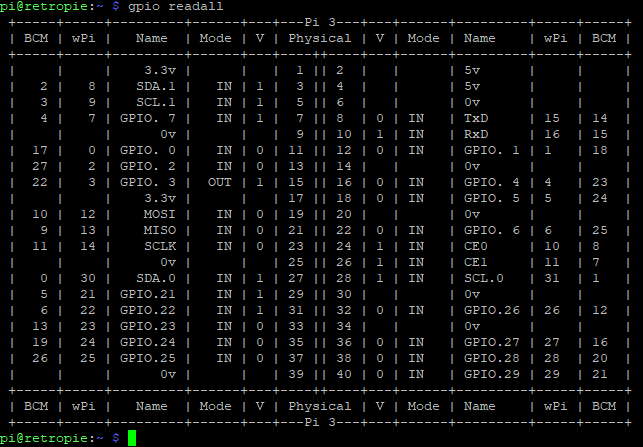

  • Safeshutdown: low Bat detection doesent work (i have no idea why - the power off works flawlessly - it is not noticeable to see in the logfiles) EDIT: i pulled the lowpin manually to ground...but nothing happens. I change the GPIO Pin from 17 to 18 with the same result...that drives me crazy! :x :?:
    EDIT2: i use
    gpio readall
    and the GPIO 17 works ... but the script does not react to that ... why?

EDIT3: ok i use the
watch '(gpio readall)'
to check if the Safeshutdown 1.0 PCB is working...and yes it works great, exactly at 3.25V the GPIO 17 goes into the status "low" (0). The Power Monitor script does not recognize this condition ... but why?
@Camble: i hope you can help!
There is an issue with the current version of the script (https://github.com/Camble/Safe-Power-Monitor/issues/10) so low battery detection should be disabled.
I'm currently writing a new version as there seems to be a few other niggles with the existing version.
Alternatively, the original script is still available: https://github.com/Camble/GBZ-Power-Monitor_BG
