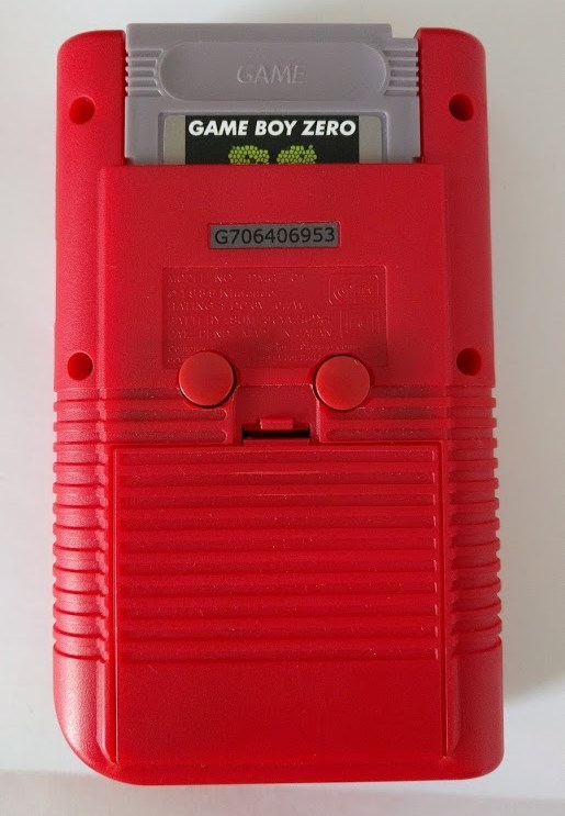

Back (yeah, I messed up the drilling, the buttons are not in line :/ )

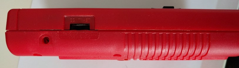

Volume control on the left side

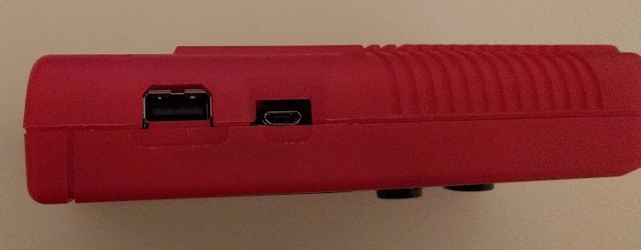

USB A port for external devices, micro USB port for charging on the right side

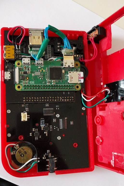

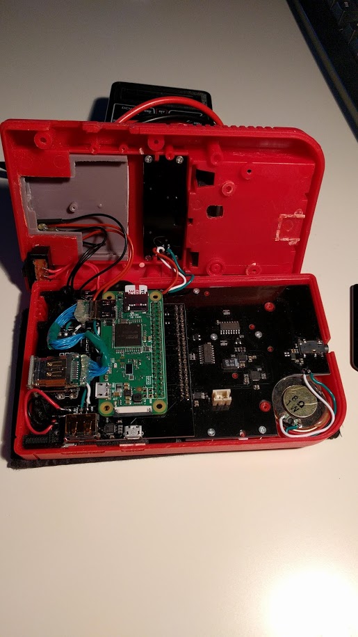

Inside, during assembly

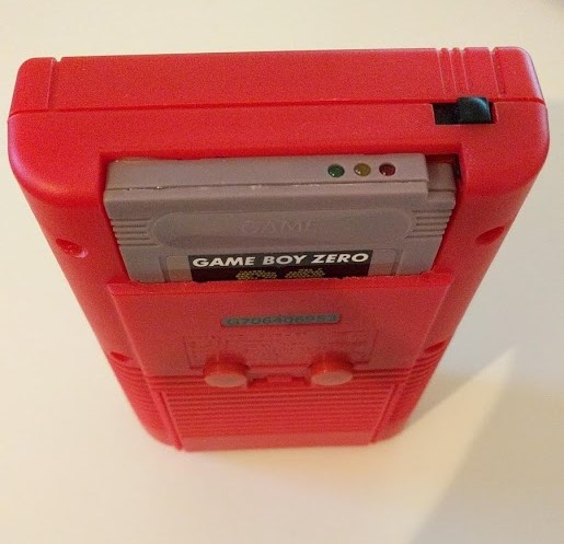

Almost fully assembled, except for the dummy cartridge with LEDs

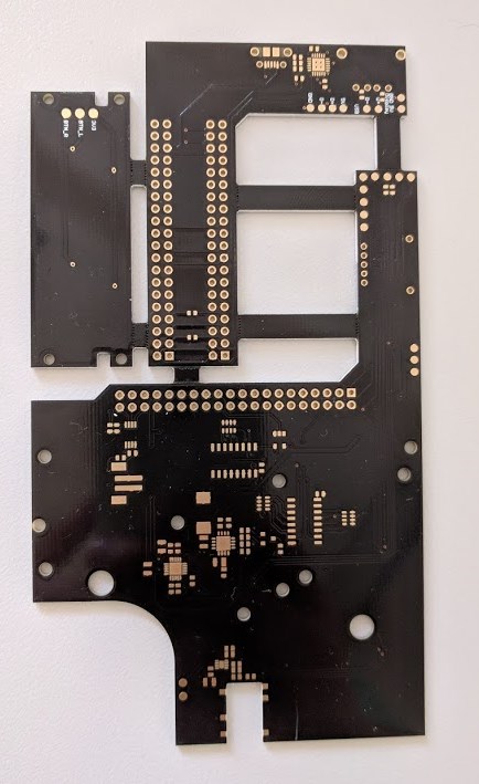

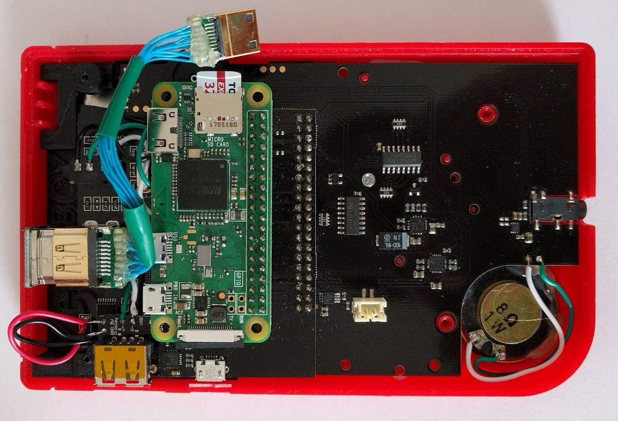

PCB top
PCB bottom

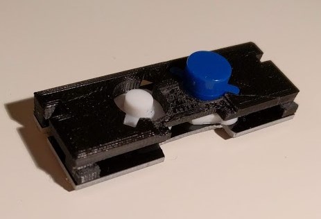

Personal preference. But I prefer the shoulder buttons to be farther apart. These seem pretty close.

Have you guys considered using a barrel jack for charging to fit the original dc port, and then volume wheel where the microusb is and sd in the contrast?

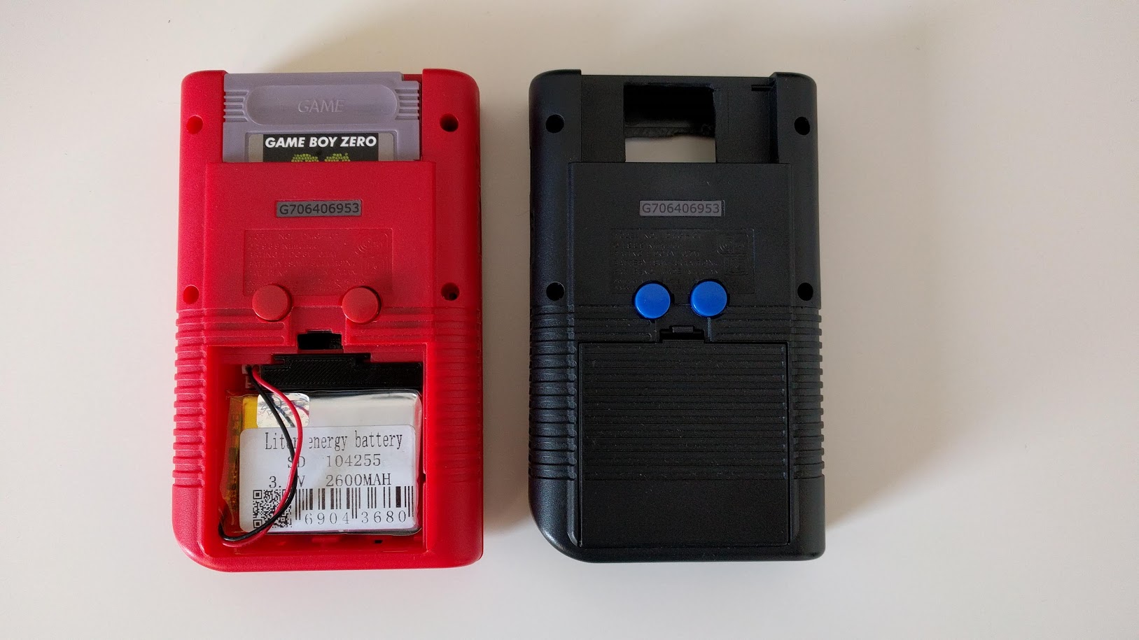

We experimented with the position of the shoulder buttons. I had them even closer together on my first case (the black one):
The closeup photo in my first post of the shoulder button PCB shows the one for the black case.
We will stretch the pads on the PCB to be flexible with the position of the conductive pads. The 3D printed part will then determine the actual position of the buttons and I can make different versions of the STL.

We wanted micro USB for charging as most people (including ourselves) have spare USB chargers from old phones at home. I think we will stay withe the current layout, it took enough time to get all components perfectly arranged ;)

Btw. since you soldered your HDMI cable yourself, if you take a 90° HDMI plug or a very short standard one on the full size end, you could get rid of the HDMI Adapter that came with the display. Than you can plug your cable directly into the display and you should be able to leave the cartridge slot as it is, without cutting the whole thing away.

Totally makes sense. I don't expect you to make changes! If i built one using this PCB I would just place an LED for charging status in the DC port to not leave it empty. I agree that micro USB in more convenient. Since people usually have so many of those cords laying around!

You're right, I could have used another HDMI plug. But we had the flat ones here already so I used one of them ;) If they run out I will switch to the 90° version.

One could use an RGB LED in the DC port and display all three states with it. There are never two or more LEDs on at the same time, just one or none. Maybe for my next build... 8-)
Here are two pictures with the LEDs inside the cartridge:
