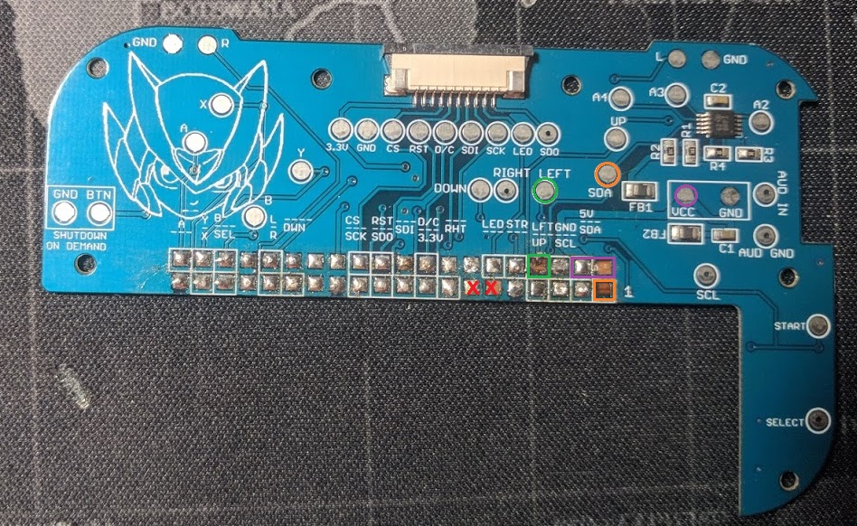

A bit ago when I got my board late last year, I broke 2 solder spots, they are number 1 and I think number 8 if I counted correctly. Is there an alternate soldering point on it so I would have to complete my project finally.

Put a picture, it will be better

https://photos.app.goo.gl/NP8S8JHBLVwhldGh2
More have come off now

It's not that hard to figure out since the silk screen is there along with the test pads. The 2 missing pads I put red X on is not used so ignore those. The 5V which I highlighted purple are connected to VCC and are also connected to the 5V pad so just solder to the one that is left of the missing pad and done.
Green is the LEFT GPIO so solder a wire from the GPIO to the LEFT test pad in green, easy. The number 1 is the SDA for the battery monitor which is highlighted in orange, solder a wire from the Pi GPIO to the SDA test pad and done.
