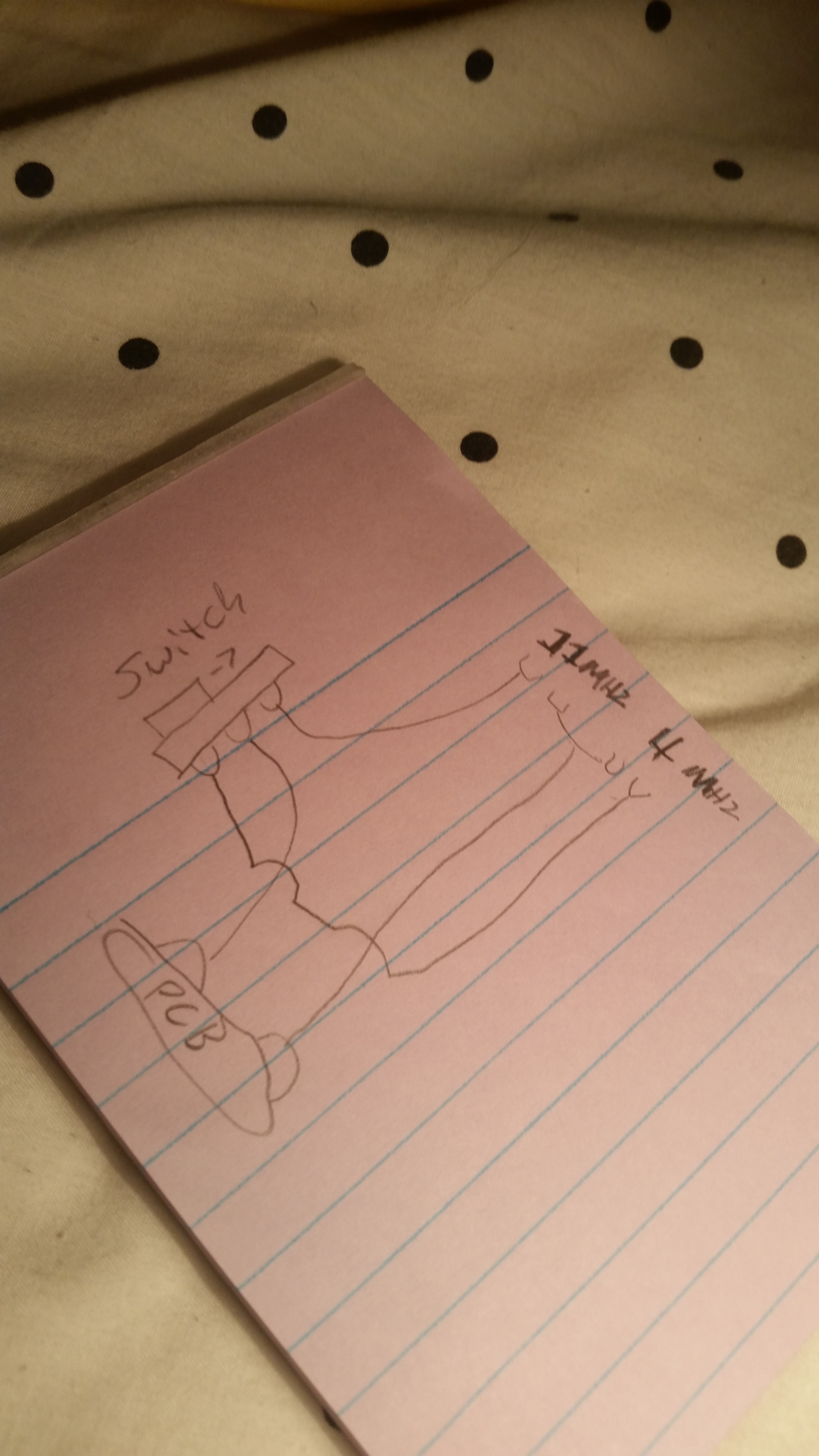

So when I bought these crystals they came in a pack of 5. I desoldered the original crystal tried directly connecting all of them and none of them worked. Then I freaked and though I broke it and soldered the original back and it works fine. idek.
update: Brand new problem! I got it working perfectly for a while without the switch. played some pokemon. funtimes. then I went for the switch with the following wire layout and either switch position gives me 4mhz. I have no idea why it makes no sense. I've exhausted what I know now. and I should say this is all without the casing on so there is definitley no shorting anywhere and I tested the switch multiple times with my meter and it seems to be a functional switch.

This is solved. In case anyone is interested I needed a dpdt switch so I could totally isolate each crystal while the other was working
