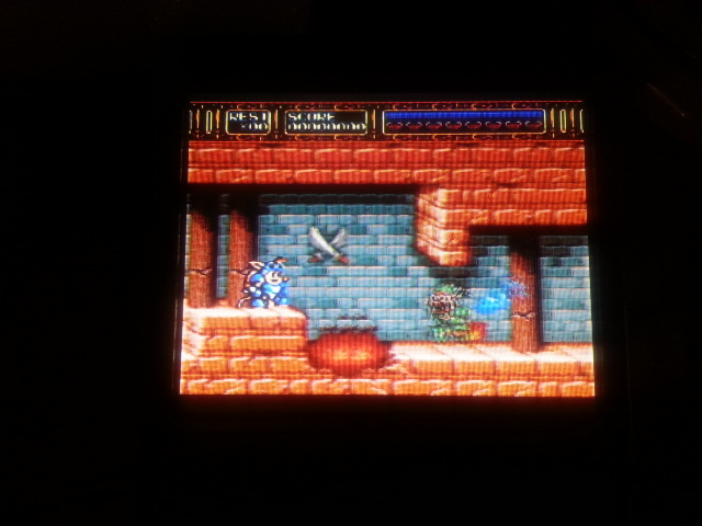

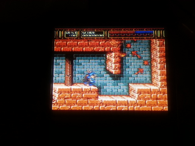

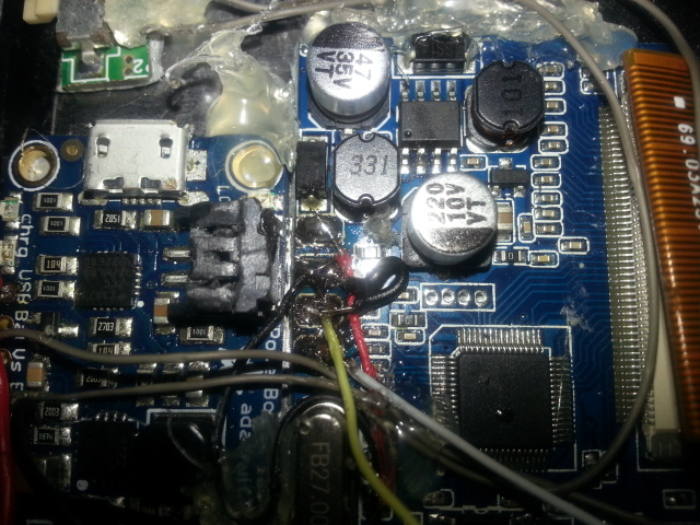

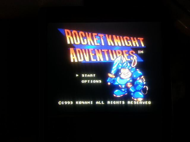

OK :mrgreen: i have a BW 3.5'' Composite Display variant 4. It had a lot of noise on the screen,so i took apart my build about 6 times to see what the problem was after attempted fixes :oops: . I..... don't ask me why i just did it. :? I connected the ground to my video source. A little half loop the yellow to the black turned it on and eureka it cured it no more noise nice clear screen. I hope this helps someone i"m so happy rite now you guys have no idea . I can show my build without embarrassment. :D video to come soon.

Post a picture :oops:

Post by natethegreat28 » Fri Jun 17, 2016 4:51 am

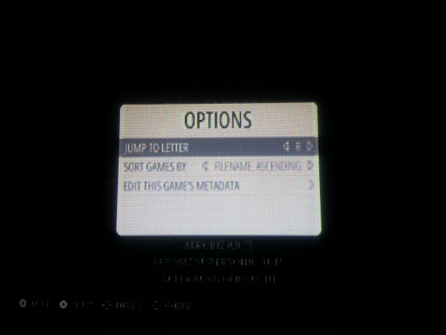

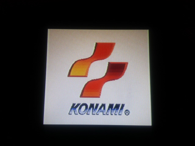

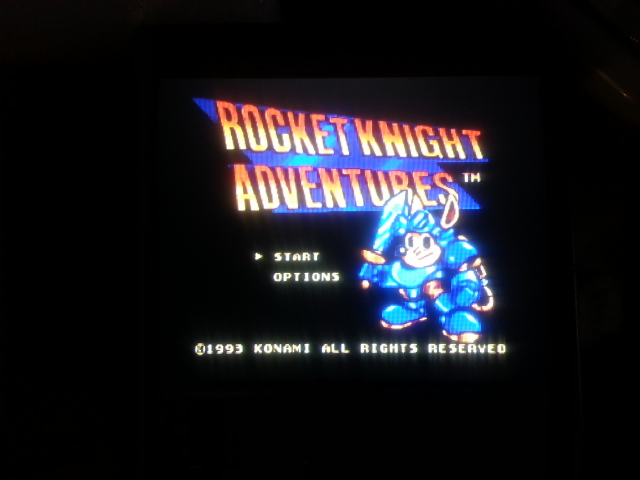

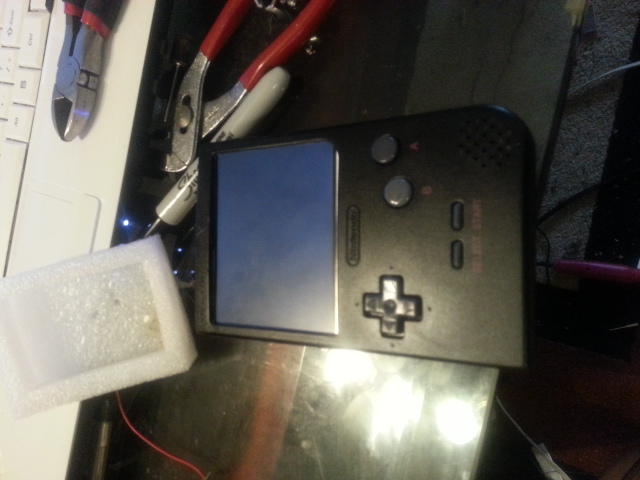

here you go
natethegreat28
Posts: 29
Joined: Sat May 28, 2016 12:35 pm
Has thanked: 22 times
Re: Composite Display Noise gone fixed is no more!!!!!!!
Post by natethegreat28 » Fri Jun 17, 2016 5:03 am
here are screen pics and the build

just noticed the yellow wire is right next to the crystal, try moving it away from that and try again,
and i see your using long wires like the gray ones, try and keep them short, like the quadcopters you should always use as short video wire as possible to avoid interference :mrgreen:

@DirtyBullets thanks for the advise i will try it on my next build
